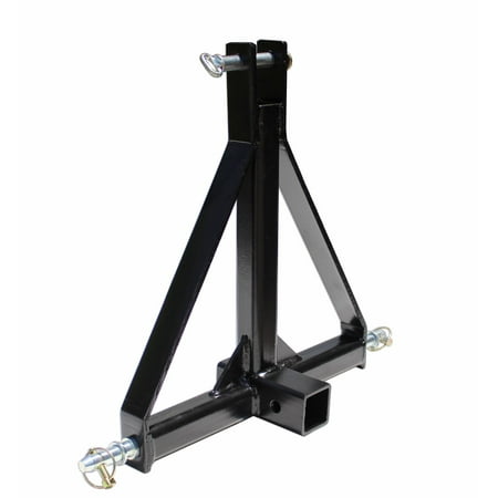

I put a 3pt to receiver hitch on my tractor ($55 delivered) and use it for lots of things.
You can put a spike in the receiver bit or they sell (google it) spikes and spike mounts you can weld onto the hitch.
I got mine off ebay, but harbor freight has them, versions are sold as gooseneck hitch adapters, etc.
Seems easier and cheaper to start with the basic item and add the mounts.
then add this maybe..http://www.agrisupply.com/tapered-bale-spear-nut-included/p/49601/
Googling turned up this site..may have the parts needed
https://hayspear.com/39-spear-w-2-receiver-hitch/
