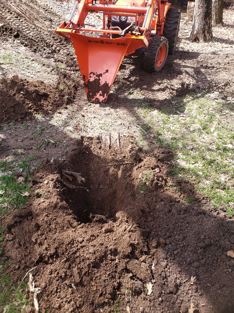

I planted several trees this year with a stump bucket. I don't know how large your burlap ball is but mine were about 18". Easy work for a stump bucket. Also used it for several azalea plants. Here we have an abundance of large potatoes and tree roots to contend with.
Potoatoes:
and dealing with roots:
