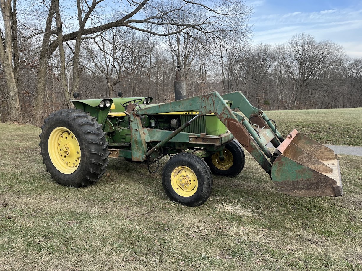

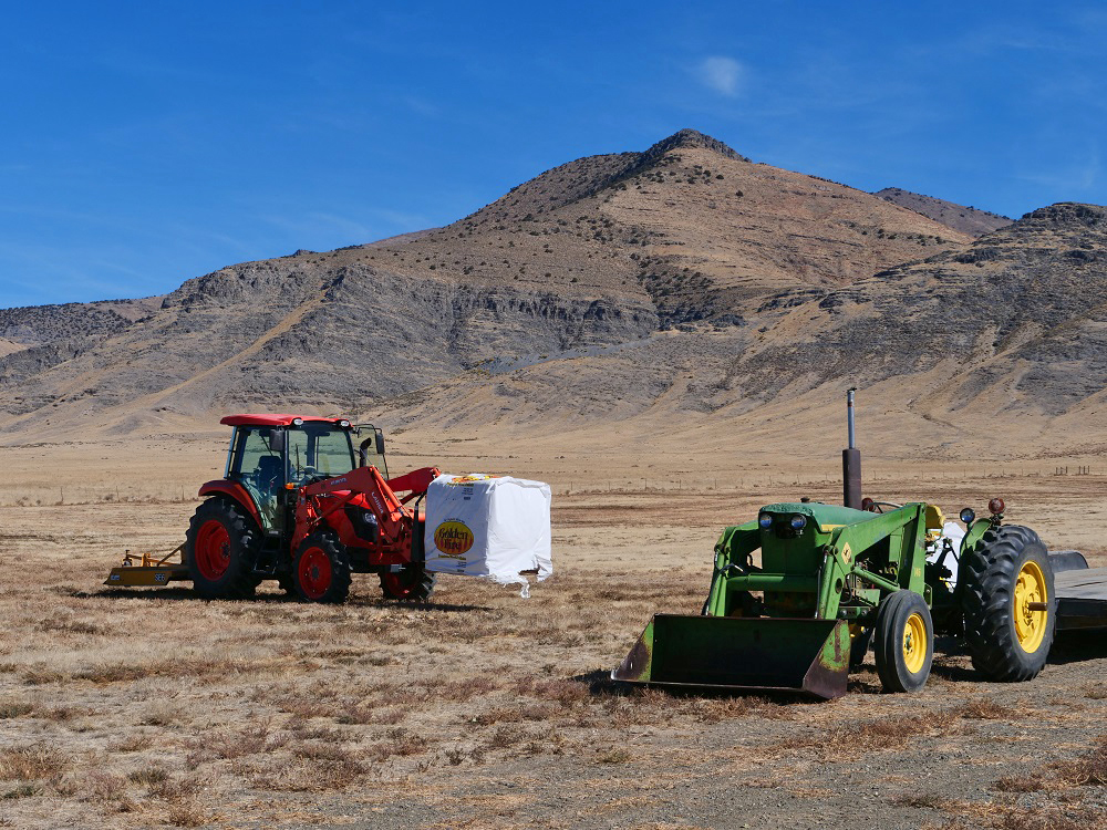

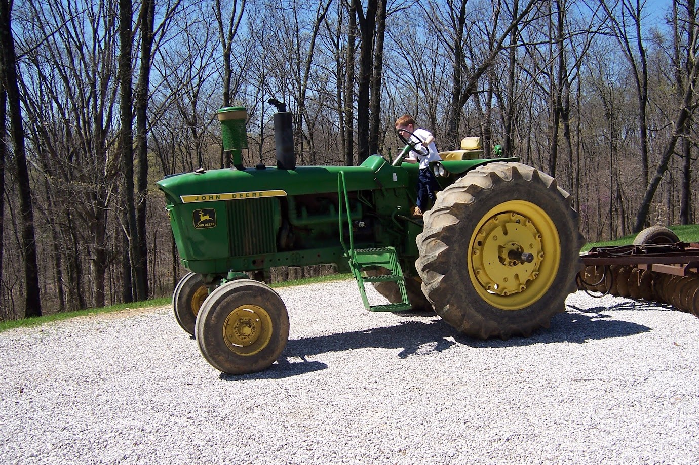

Sorry, I should have explained more about my use. I'm looking to get a MFWD with FEL. Primary use will be maintaining 800' gravel driveway, that is on a pretty steep incline. Currently use HD 8' Rhino blade, which is more than the 2030 wants to pull it uphill loaded with rock. 2nd use is pulling logs for firewood and a little milling. Not many a log the 4020 won't pull out of the woods, may have to cut them down a bit for the 7060. 3rd use is bush hogging about 20 acres hilly ground, and around woods/field edges. Currently have both 7' Woods 3 pt mower and a 10' pull type bush hog. 4th use is snow removal for multiple residences on the property. Used brother in laws Mahindra 5145 for this past 12" snow. It did well, MFWD was nice, but it lacks power. Also be nice to have FEL with bucket or forks for general stuff around the farm. I do have a Case backhoe for large loader work. I know it a tradeoff for a lighter tractor, giving up pulling capability, but would like the ability to be able to move it with 10k trailer and 1/2 ton truck over short distances.
Here is my current stable of tractors.
Dang, you must be pulling some logs! I think the 7060 will suit your needs. The 7040 I mentioned ran a 7' mower to mow pasture and bale spear to handle large rounds just fine. The owner also had a 7060 cab, and brought it out one day to cut a field across the road. He had a batwing, 15' I think, and the grass and brush almost hid the tractor.

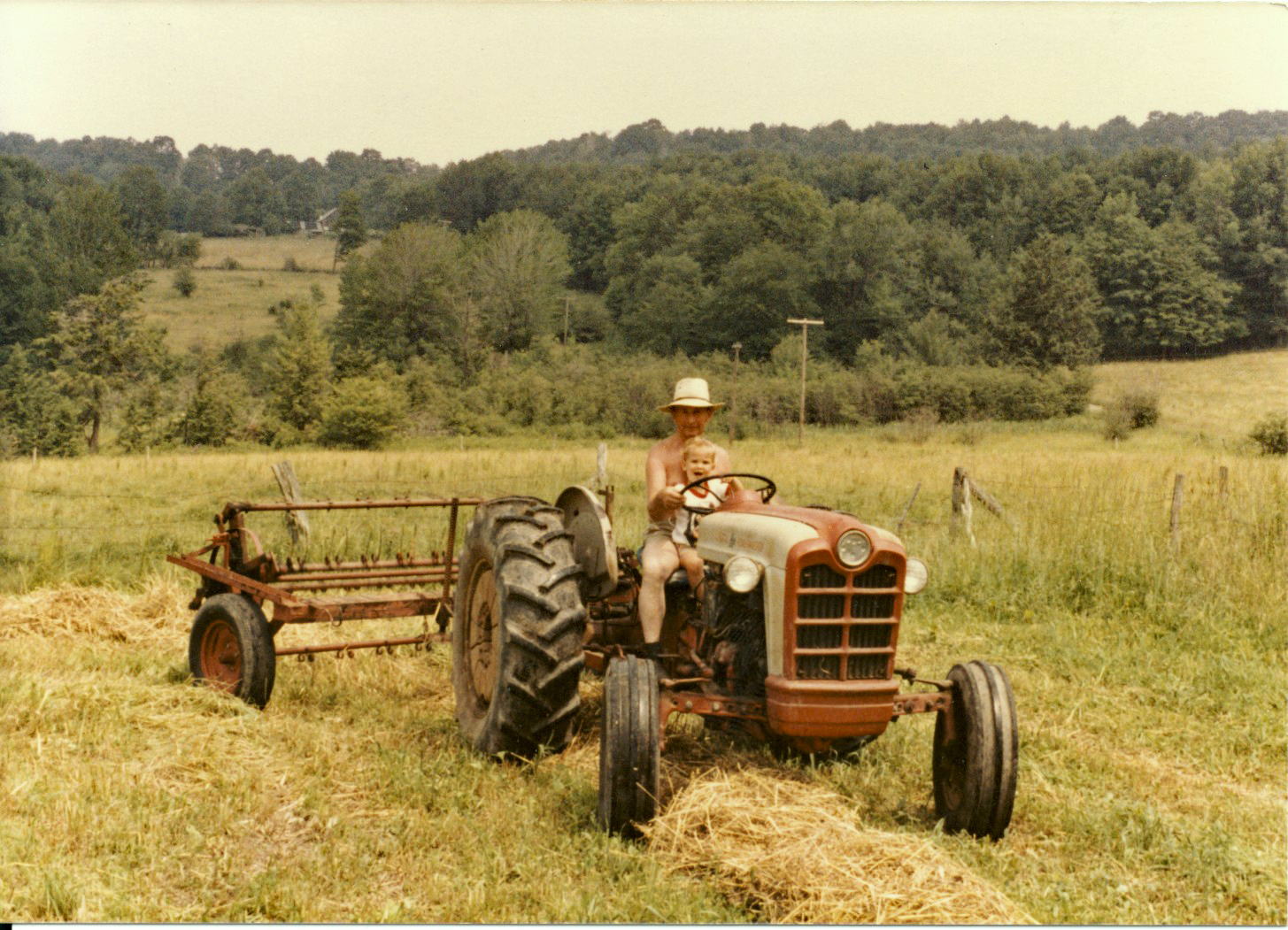

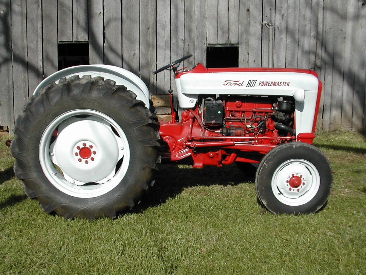

I'll have to post up pics of my 861. I've got similar pics of me on Dad's lap of the 861. Then I restored it and have pics of me and my sons on it. For the size of the tractor, it is a very versatile machine. A pet peeve of mine is when someone tells me I have a nice 8N tractor. They have no idea the 861 was light years ahead of the 8N.
" They have no idea the 861 was light years ahead of the 8N. "
Indeed, it was.
The Ford N series was revolutionary when introduced in 1939, but even the late 51/52 8Ns were obsolete in the late 40s.
The mid 50s Fords, 861 and similar tractors with twice the HP, live hydraulics, live PTO, better brakes, more weight, optional power steering, etc., were state of the art in the mid/late 50s. Indeed, one man on an 860 or 861 could do as much work in a day as two men on good 8Ns while using about the same amount of gasoline. Progress often produces such results.
