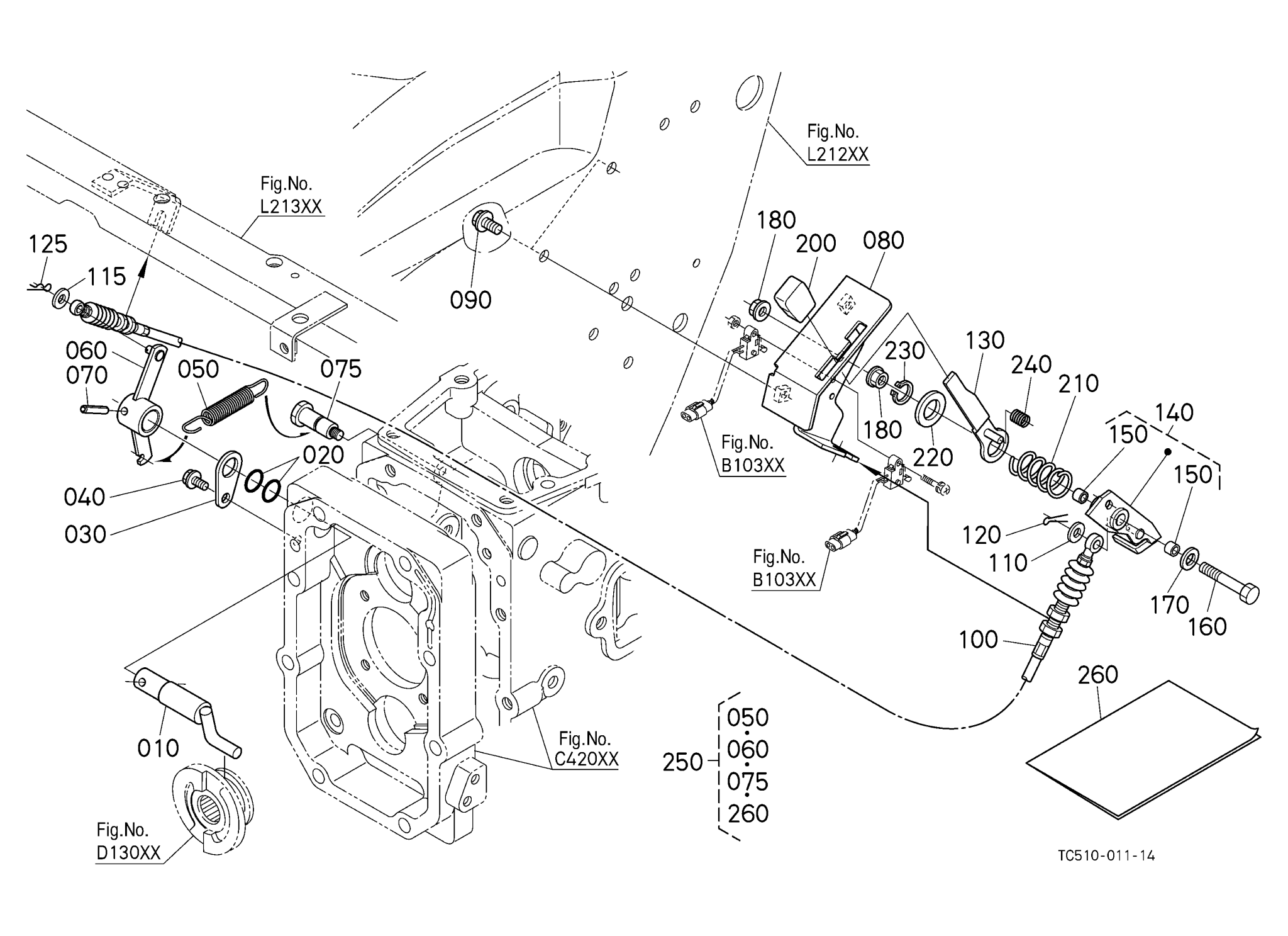

Went to my Kubota dealer today and there is a fix for the pto problem, if you ask there is a bulletin and they have a fix. They have a new lever and spring to fix the problem. If you go to the Kubota parts online they show the new parts. Mar 13/23
whitetiger
Nov 20, 2011
3,258
1,678
Kansas City, KS
lever #60 spring #50 tractor is 2021, L2501 hydrostatic but the parts should be for any model l2501
PTO LEVER KIT for KUBOTA TRACTOR L1-382 / L1361 / L2501 / L3301 L3901 / L3200 / L3800 with HST model
Document ID MA4862
Published Date 09/29/2022
This is for Hydrostat transmission units only as the gear drive units have a different PTO linkage assembly.

TSB-2023-028-E-R1
FIX AS FAIL EXTENSION: L-Series; PTO Lever Does Not Return to Neutral Repairs described in this bulletin may be made only in the event of a failure.
Product Line: L-Series Model: L2501HST, L2800HST, L3200HST, L3400HST, L3700HST, L3800HST, L3301HST, L3901HST
L2501HST 50001 to D7056
Units are covered for 5 years after the original date of purchase.
The PTO lever may become stuck and not return to neutral. Solution: If the PTO lever is stuck and does not return to neutral, install the LEVER, KIT (S-PTO) per the procedure beginning on page 3. Note: If the PTO cable is damaged, replace the PTO cable with the appropriate cable listed in the K-Pad for your model
