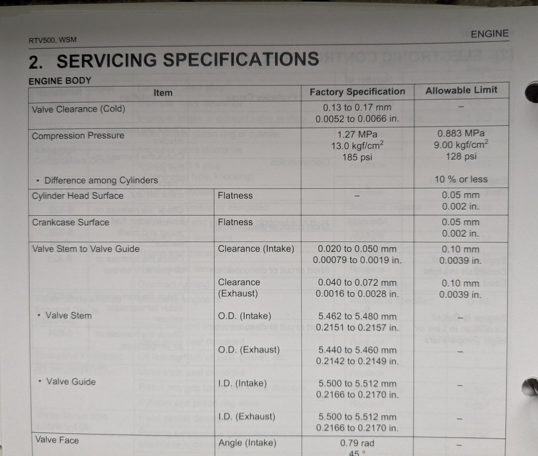

Both of those values are pretty low. Here is the spec sheet from the workshop manual and factory spec is 185.
If you want a project, you might have it.... Might be worth checking on the valves to see if there is something that's an easy fix.
Getting to the timing belt looks to involve pulling the engine out.

Thank you for this advise and information. We won't really know the problem is until the engine is torn down, I hope the problem is something like the valves, which would be easier to deal with. However, since I have no history on this RTV, the timing belt has to be in play. Thanks again for a helpful reply. Bill

Seeing if you have some valve damage as the cause of your low compression might make it an easy fix, but yeah, it may be a larger effort.
If you need other pages out of the manual, I can send some a long for you once you get there.
