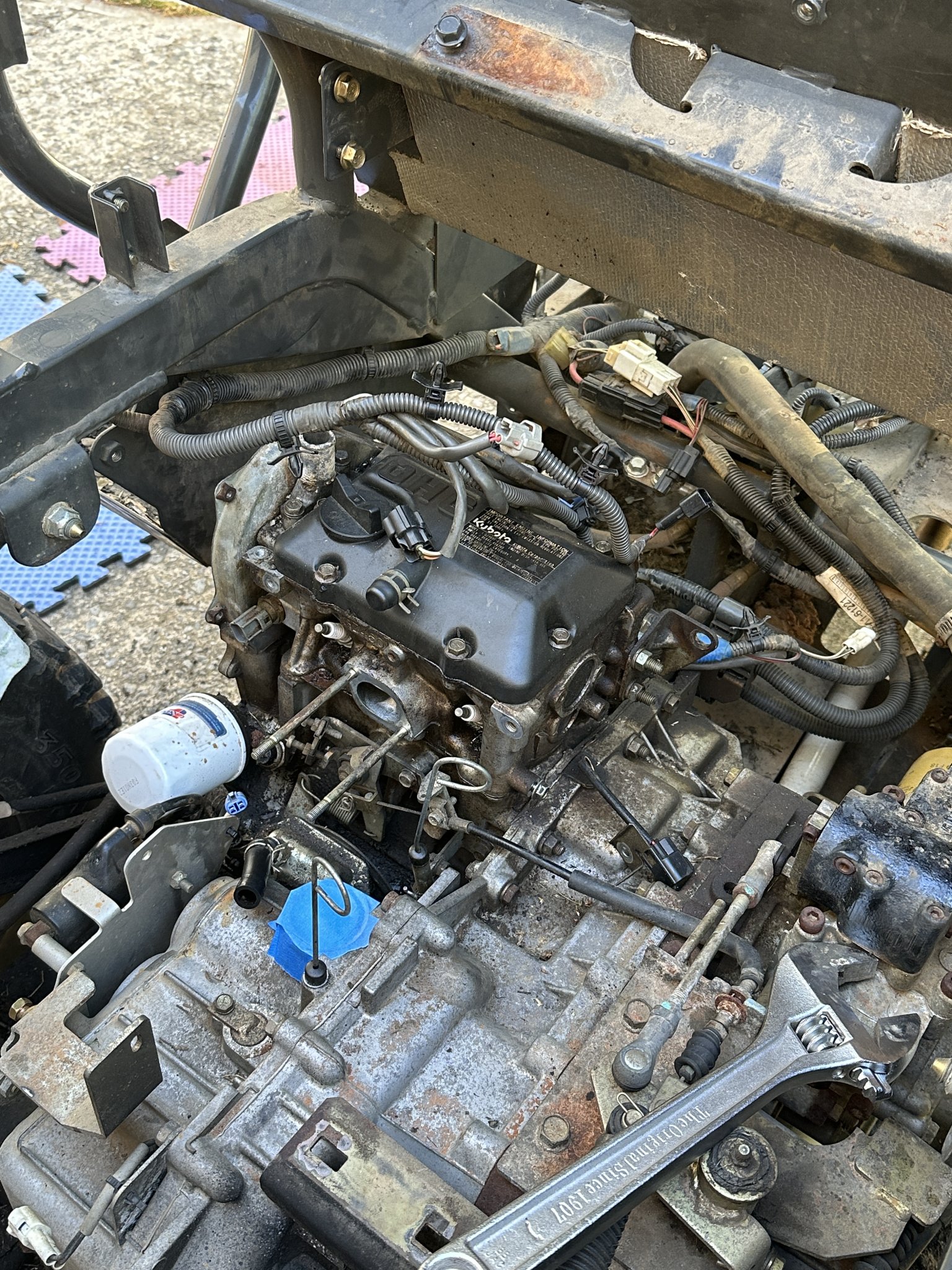

So, I have to get the head off this engine.
I start disassembling. I pull the bed off it 1st, pretty easy. Just have to be mindful of the wiring for the rear tail lights. There are connectors which make it simple to disconnect. Seems like the bed hinge was slightly odd to remove but its been about 3 weeks now so I can't really recall. No big deal anyways.
After the bed was off, I removed the seat and plastic cowl underneath seat. Also, I did remove the battery before starting any of the disassembly. That's important.
I think I removed the exhaust components next, making notes about what gaskets (and other parts) I needed to order for reassembly. The exhaust system for this little motor is "robust". No issues though, everything comes apart without objection.
After that I think I drained the coolant and removed the large coolant hoses from the engine. Also the coolant reservoir. All the cooling system components were both filthy from combustion gases and some heavy scaling. I surmise poor cooling system maintenance at this point. The hoses were on the fringe of ok and replace with signs of dry-rot. One of those deals where if I don't replace them, they will likely fail. If I do, I'm probably wasting money. I'd rather waste money than break down I guess.
Anyways, you get the picture. take everything apart so I can remove the head. No big deal, no drama really. Just have to be patient. Alternator, carb, timing cover, make notes, take pictures.

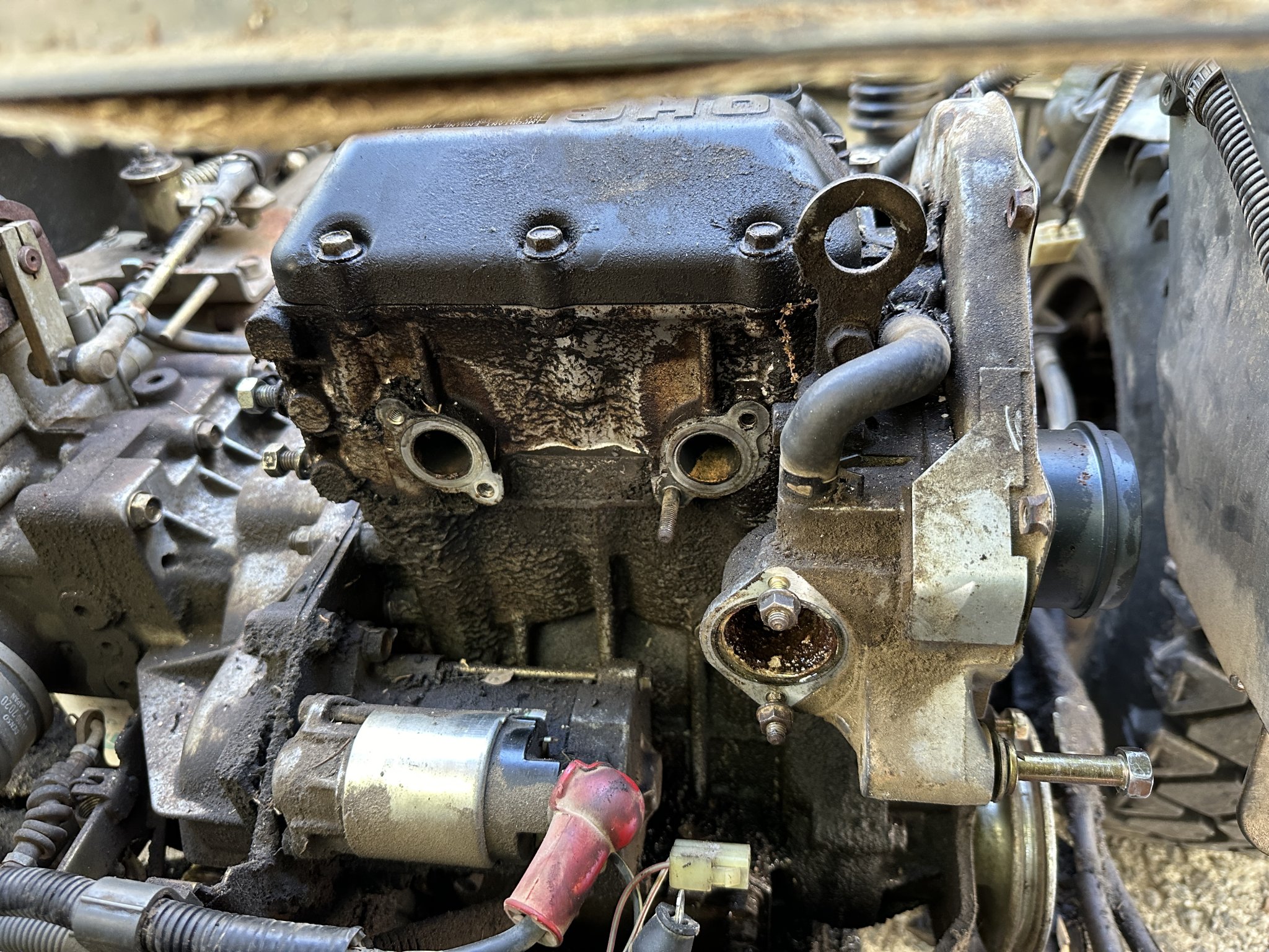

Finally get the head off and inspect everything. Found that the head gasket had succumbed but everything else looks good. The cylinder walls weren't perfect, they showed some visual signs of discoloration but felt smooth to the touch. Pistons looked good, no wiggle. the crank turned freely, and the connecting rods were free of any bearing slop. Good enough for me.
The most interesting thing I discovered was that both pistons move on the same plane. They don't alternate and that surprised me. I haven't researched that design and there are probably other twin cylinder engines out there that work on the same principal, but it is perplexing to me for some reason. I don't get it. Why not just 1 large piston? What is the advantage of 2 smaller pistons acting as one? maybe the ignition is alternating? I don't know the answer to that. Is this design better somehow?

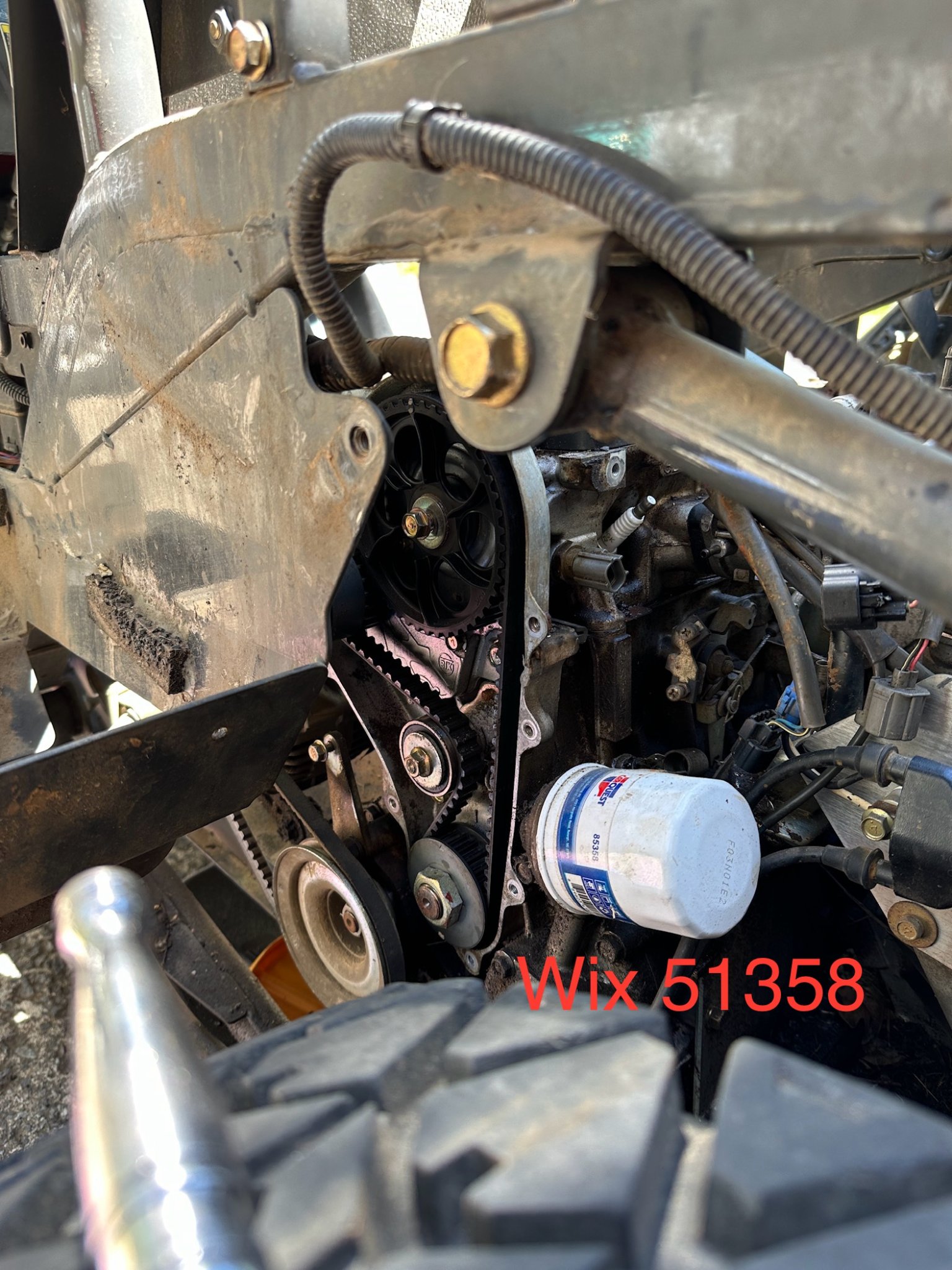

The timing belt was questionable and the alternator belt was badly worn and cracked. I spent some time researching alternates for these because again, Kubota $ was out of line, in my opinion. I ordered the timing belt from Misumiusa.com (part #HTBN800S8M-150) for about 1/2 the cost I think, and the alternator belt from Advance auto (Dayco 15225). Again, worthwhile savings.
I also opted to replace the timing idler bearings. This is, I think, the cheesiest setup of the entire engine so far. Even buying the bearings "outsouced" was overly expensive, IMO. No discount here vs. buying them direct from Kubota either. Well, you could save by buying no-name, questionable bearings but this wasn't a place I wanted cheap components. I think I ended up with Koyo. I ordered these from Amazon, part #koyo 60/22-rs. I would have preferred Timken, but I couldn't find them.

The crank seems strange until you think about the fact that you need a power stroke in 720° of crank rotation, or 2 revolutions. Or one power stroke per revolution with 2 cylinders. For equal distribution one cylinder fires the first time up (the other cylinder is exhausting), the next time up the roles are reversed. If the crank throws were 180° apart, you'd have fire at 0-180-720, unequally spaced pulses, instead of 0-360-720, equally spaced.
Is that the Subaru/Robin-designed engine with fuel injection?
lugbolt
ZG127S-54
Oct 15, 2015
4,865
1,607
Mid, South, USA
yes parallel twin 360 degree crankshaft
2 cylinders. 4 stroke engine "fires" cylinders at 720 crankshaft degrees. Divide 2 by 720 and you get 360. 360 deg means both pistons travel at the exact same plane, 360 degrees apart (in other words they run at the same direction all the time). Polaris 600, 700, 800 sportsman and Ranger use this design as well. A lot of 4 stroke outboards too.
You can have several ways to arrange the crankshaft/engine on a parallel twin. 360 degree, 180 degree and 270 are the most common.
180 degree, one piston is up, the other is down. 180 degrees apart. But it is an oddfire engine, in that it fires a cylinder, then 180 degrees later fires another. Then the crank must turn 540 degrees before it fires the first one again. It has an odd sound too. Polaris uses this design a lot, on the 900, 1000cc engines used on the Rangers and rzr's.
THe 270 design is a good one, and my favorite. One cyl fires, then the crank must turn 270 degrees to fire the other one, then there is a 450 degree pause til it fires the first one again. Note that the 270 has an exhaust sound very similar to a 90 degree V-twin. And, it runs VERY smooth as long as the counterbalancer is set up right. This design is gaining a lot of popularity. Rzr turbo models are 270, as are the Polaris sportsman 850 and 1000, Yamaha uses it on the Wolverine 850 and 1000, the Rmax 1000, and the 700cc naked bikes. Good design, smooth and very torquey. And is audibly pleasing.

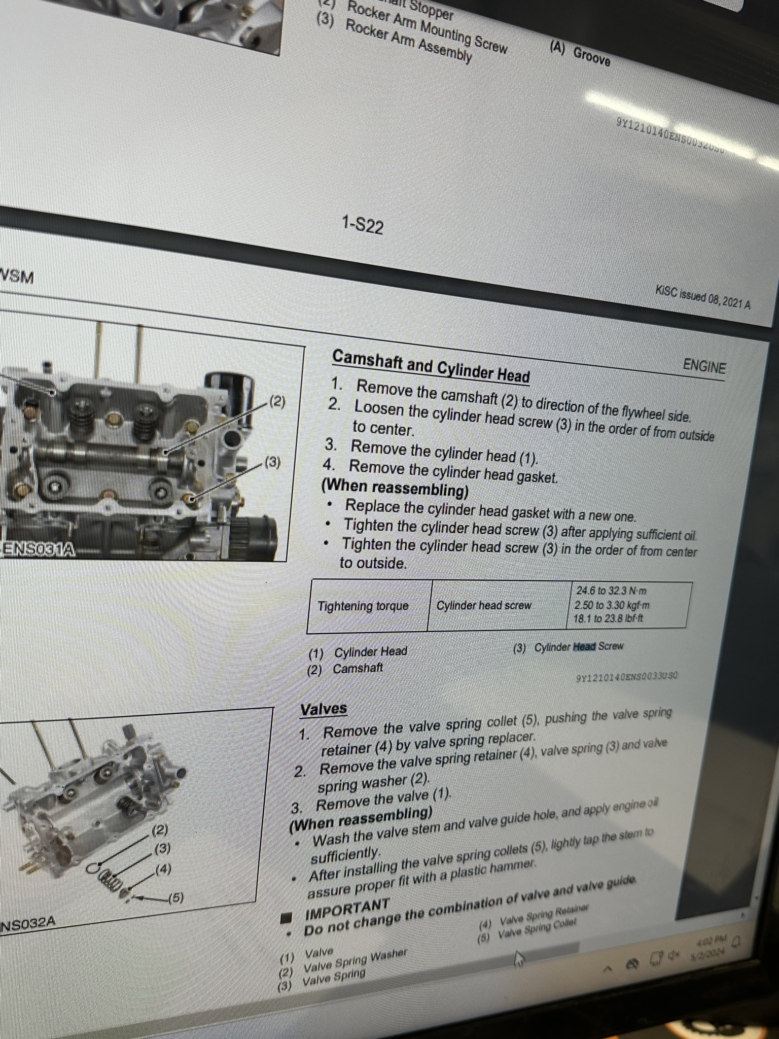

Thank you for the information. Interesting design. I have run into a problem with reassembly and it revolves around torquing the head bolts down.
The only torque specs I could find online for this engine are 46-50 ft-lbs and I'm guessing that is not correct or even possible. I managed to get a couple up to about 25 before the fastener began stretching. I looked up general torque specs for a 7mm bolt after that and found they were somewhere around 10-12 ft-lbs. So, Ive ordered new bolts and now I'm thinking I may have ruined the new head gasket with over torquing the bolts. They all went to 20. It was the next sequence where the trouble started. I don't think Ive damaged any threads thankfully. Anyone know what the correct torque specs are on the head bolts? Also, should I buy another new head gasket?

I've got new head bolts and a new head gasket on the way. Anyone know what the factory torque specifications are for the head bolts? I'm guessing 18.9 Nm, or 167 in-lb, or 14 ft-lb?
