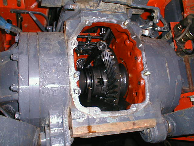

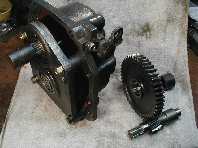

The pto gearbox is at the back end of the tractor driven from the clutch housing up front. Attached pic shows the pto box removed and its driveshaft coming thru the differential housing. If a ball bearing or gear anywhere in this drive is damaged, there could be an audible thumping or clicking noise that telegraphs through it.
The attached pics are from a pto modification thread from 2002. Take care, Dick B.
