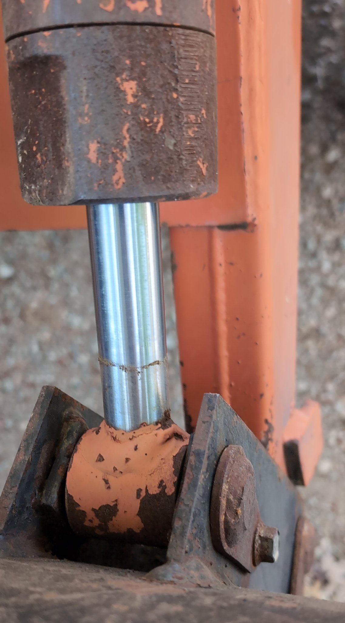

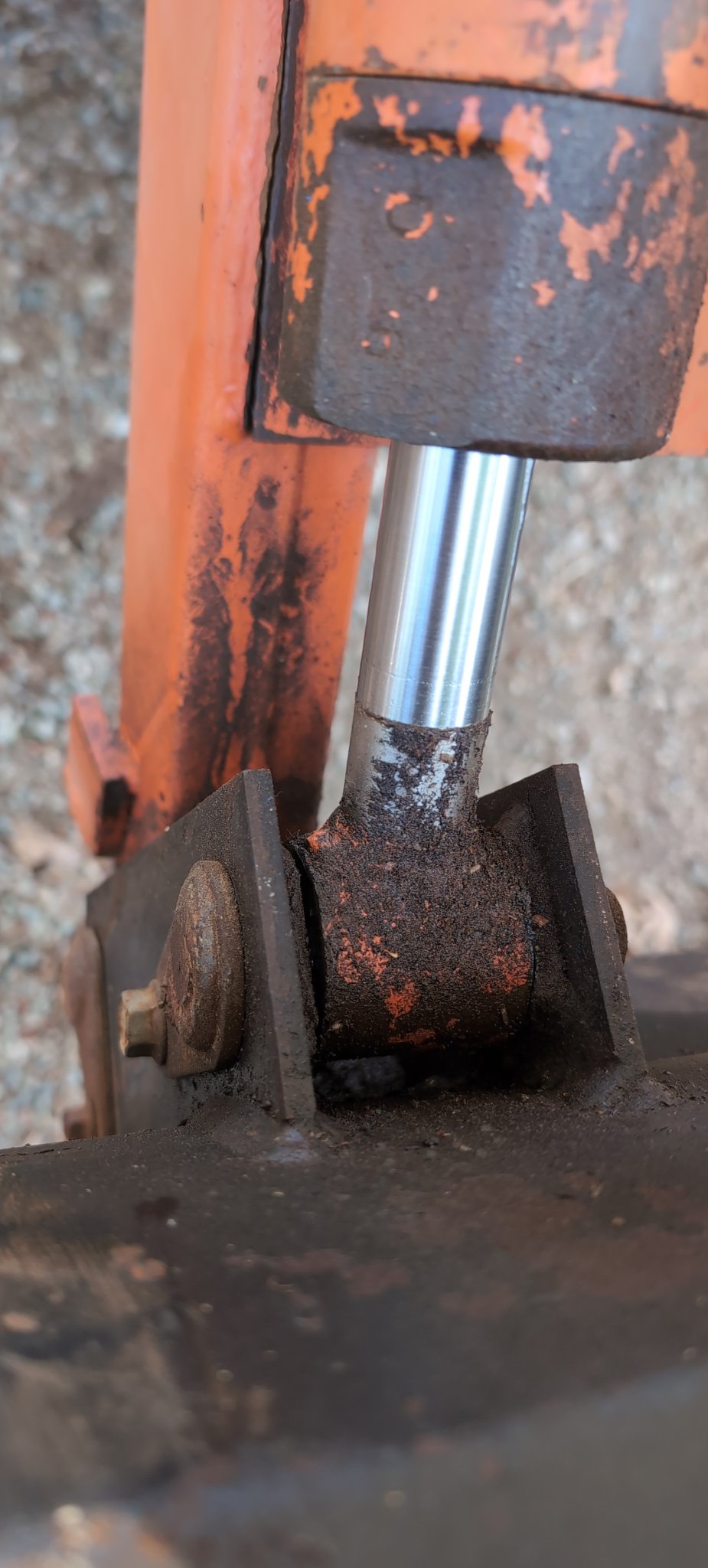

1) One of the loader's lift cylinders leaks/drools where the rod exits the cylinder head. While I'd love to DIY, time constraints have me trying to find a competent shop. The other cylinder seems fine. Do I have both done at once anyway?

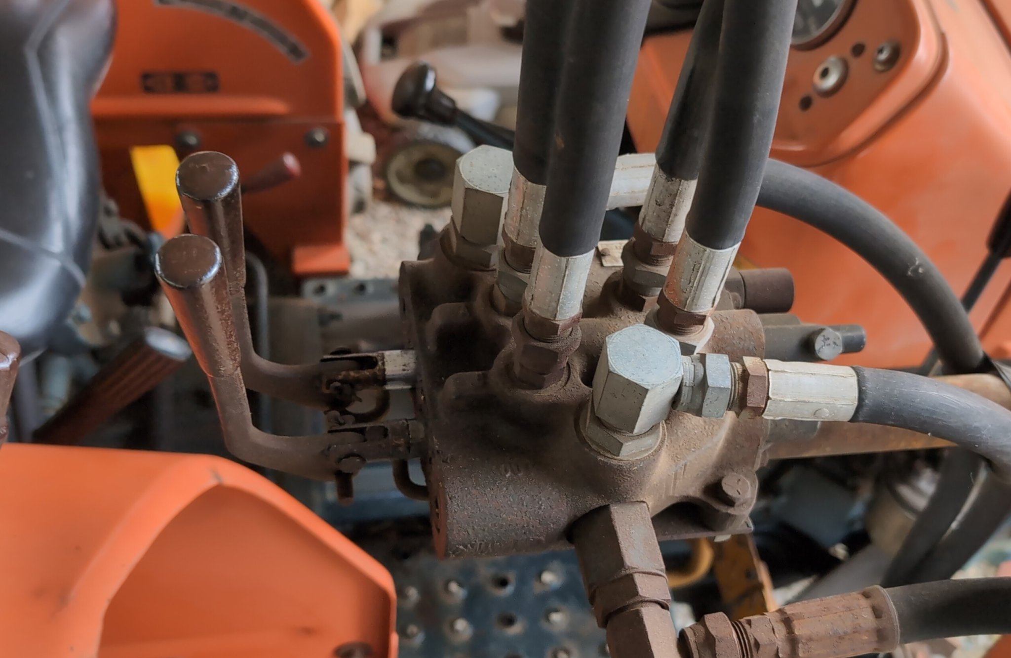

2) Both loader control valves leak slowly out the front of the spools. Diagrams show o-rings just inside. Simple fix? Buying a Summit unit is on the table but I think I'd need gauges and such to set the relief valves, no? If I go with a replacement, do you find unifying both spools to a joystick easier/faster? This two-stick was my first loader.

  2. I dont know what a seal kit costs or if its even availavle but replacng the stem seals is not a big job. If you are contemplating replacing the valve just forget the seals. No need to adjust pressure on a new loader valve but a gauge is only $20 and well worth having in your tool chest. Joystick with float on the lift circuit hands down.
  3. Sounds like one or both bucket cylinders may have bad piston seals. If you roll a loaded bucket back to the stops does it hold or does it drift down? If it drifts how fast?

Nothing on this tractor drifts, at all. I was surprised. Every time I've been absent minded and left something up, it remained there until I returned. Includes the bucket with gravel and a 500lb finish mower on the 3pt for a week. Haven't actually measured for movement - it's always accidental - but it's as if they lock in place until I hit one of the valves.

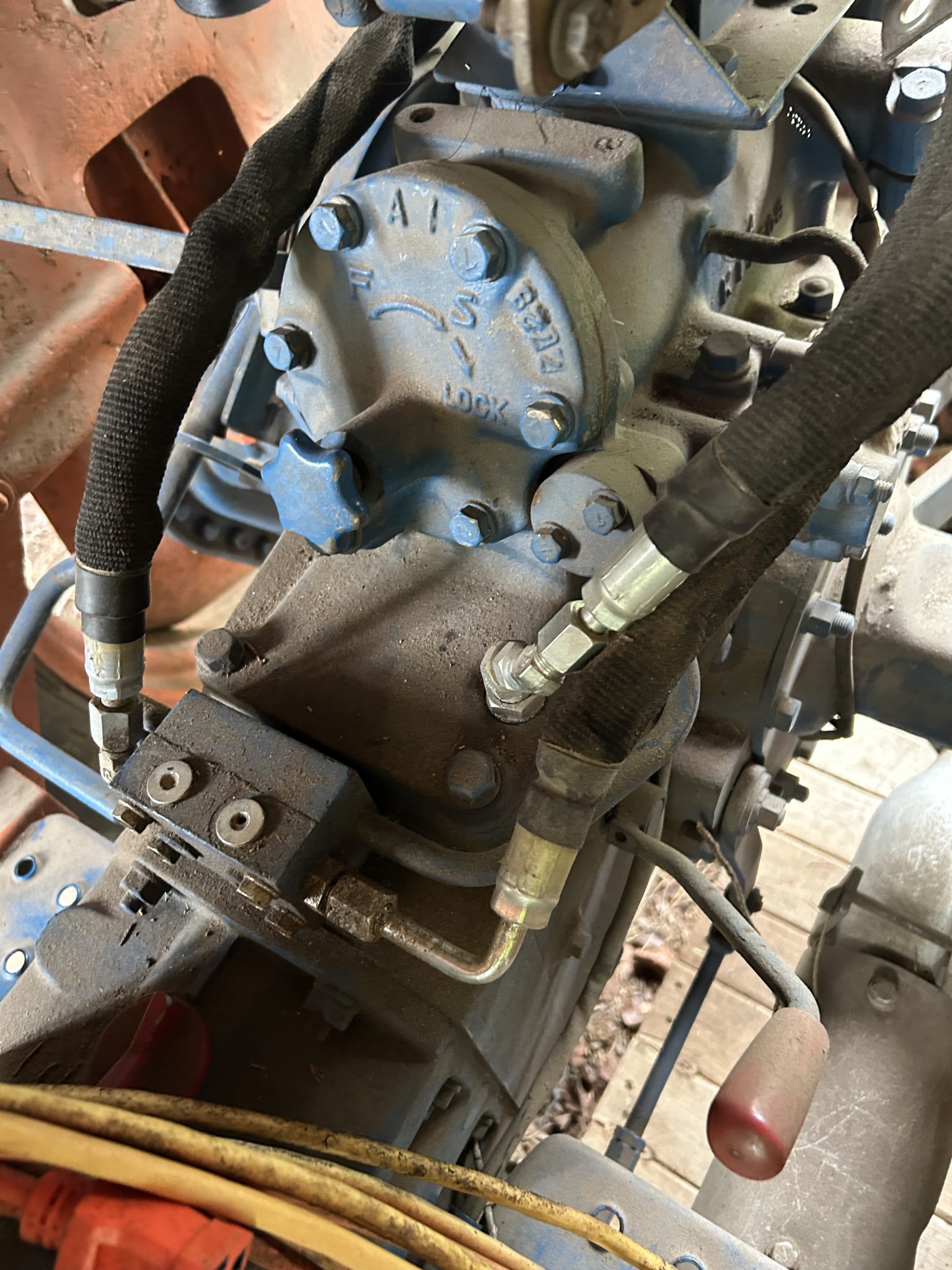

I dont know what you have but the hydrauluc outlet block goes on the left rear of a L185 tractor and is AFTER the internal pressure relief. Picture of an L185 below. You could use a loader valve without a relief if you wanted.

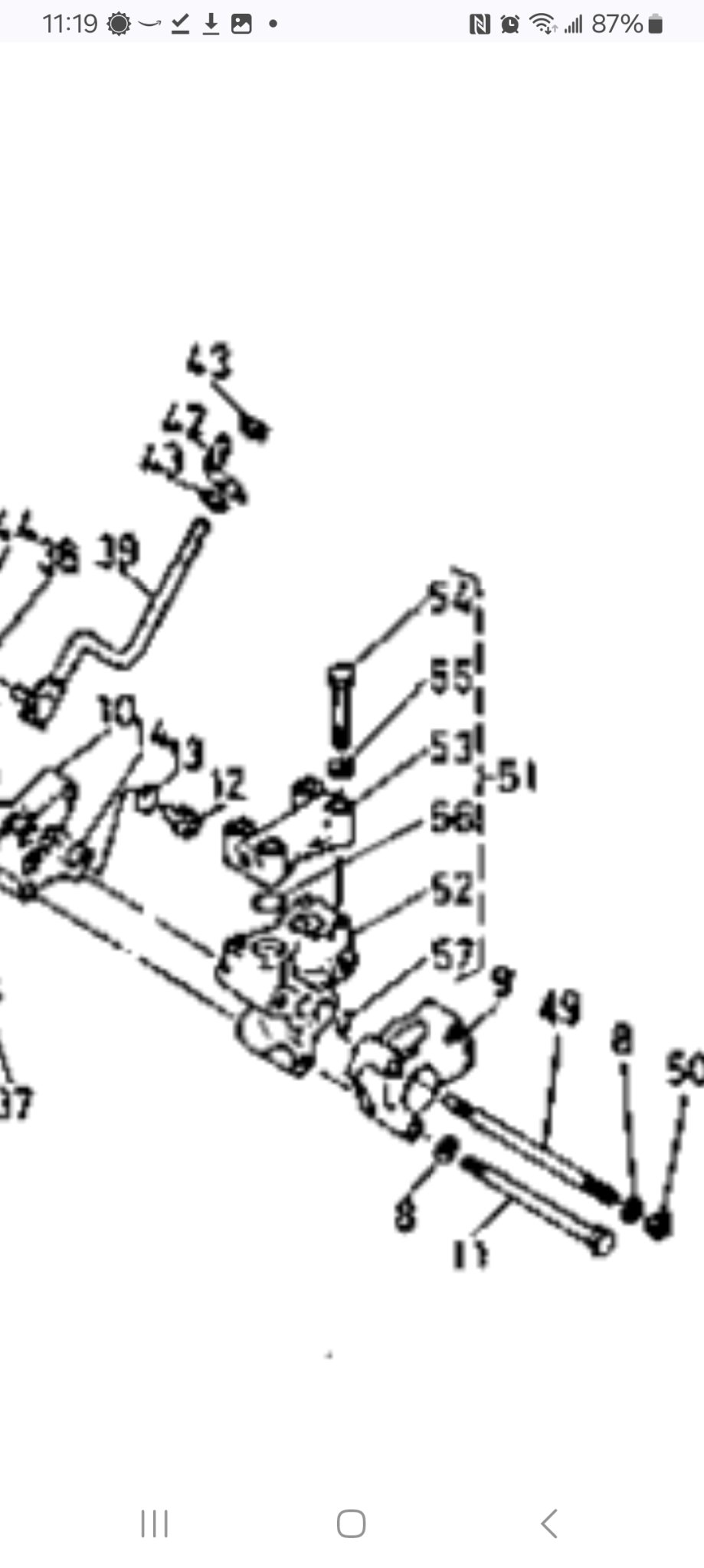

I just today mailed a block to a guy with a L185. It replaces cap number 53 in this parts diagram.

That is interesting indeed! My valve does not have that attachment cover. It looks like this

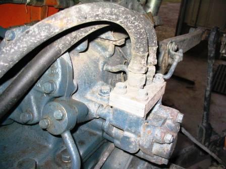

The block is in the tube as it crosses over the tractor underneath the seat, you can see your universal port block prototype installed in this picture.
But I was incorrectly thinking of the flow path only! I now see that is all really a pressure vessel with ports (now includes the rear remote hoses and valve) that has the pressure relief valve (Kubota calls it a dumping valve) in one of the ports so it is ”pressure connected” back to the pump even though it is way farther in the flow path. I was incorrectly thinking it needed to be early in the flow path to protect the pump.
In the parts diagram you posted, my arrangement is shown in the upper right hand portion of that page and I had never thought about that cover being the adapter mounting position. I thought that either it was like mine or did not have a place to attach the adapter plate.
So good for me, I learned something today (actually two things)! Thank you.
