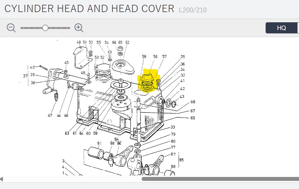

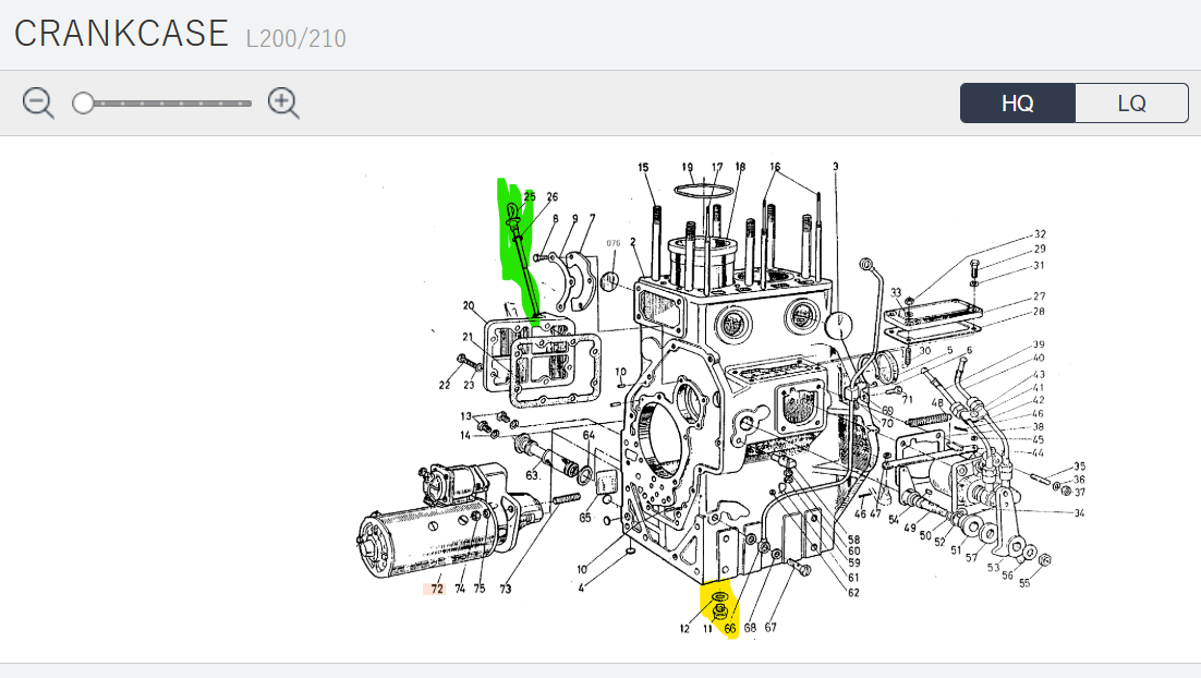

H Havens New member Equipment 1969 Kubota L100 Jun 10, 2025 1 0 1 Disney27 Jun 10, 2025 #1 can anybody tell me or show me a pick where the oil drain plugs and fill port are on my 1969 Kubota L100 tractor
R Russell King Well-known member Lifetime Member Equipment L185F, Modern Ag Competitor 4’ shredder, Rhino tiller, rear dirt scoop Jun 17, 2012 6,409 2,043 113 Austin, Texas Jun 10, 2025 #2 Bottom of the engine block. Looks like a bolt head. Lay down on the floor and look up at the engine.
North Idaho Wolfman Moderator Staff member Lifetime Member Equipment L3450DT-GST, Woods FEL, B7100 HSD, FEL, 60" SB, 743 Bobcat with V2203, and more Jun 9, 2013 33,456 8,738 113 Sandpoint, ID Jun 10, 2025 #3 Fill point: Drain and Dipstick:
