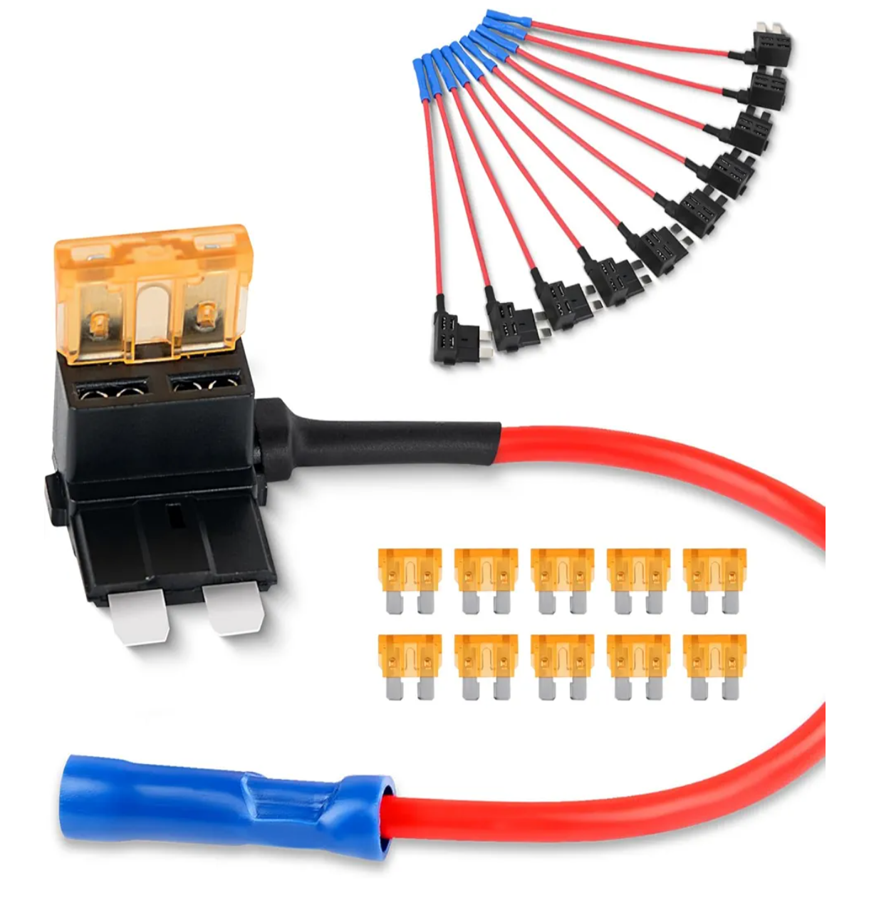

My L35 had an extra space in the fuse block, but it didn't have any contacts. So I just used a fuse tap and a 10A fuse. My fuse block is under the dash, so it was a short run. I did have to trim the cover a little to get it back on. You can get one at Advance, Amazon, etc.

I looked at the fuse block but there's no contacts in the empty spots to get hot.
With the fuse tap, you remove an existing fuse and put it in the tap to power the existing circuit. Then install a new fuse in the other slot of the tap to power the pigtail to your new circuit. Make sure the tap is oriented correctly, the instructions tell you how.

The fuse block should already have a hot wire from the battery to power the fuse block, correct? So then I need to slide one of these in then run that wire to the 12v plug...the plug is already grounded.
Possibly more than one supply. Nothing.in there should be electricslly grounded.
I've used one before on my dash cam, but im not sure which specific fuse would be best to tap into.
It does not matter - you are not using the fuse. You are extending the DC+ buss contact to supply an additional fuse.
BTW, you can acvomplis the same thing using an inline fuse with the cc supply wire wedged into the buss contact alongside the OEM fuse.
