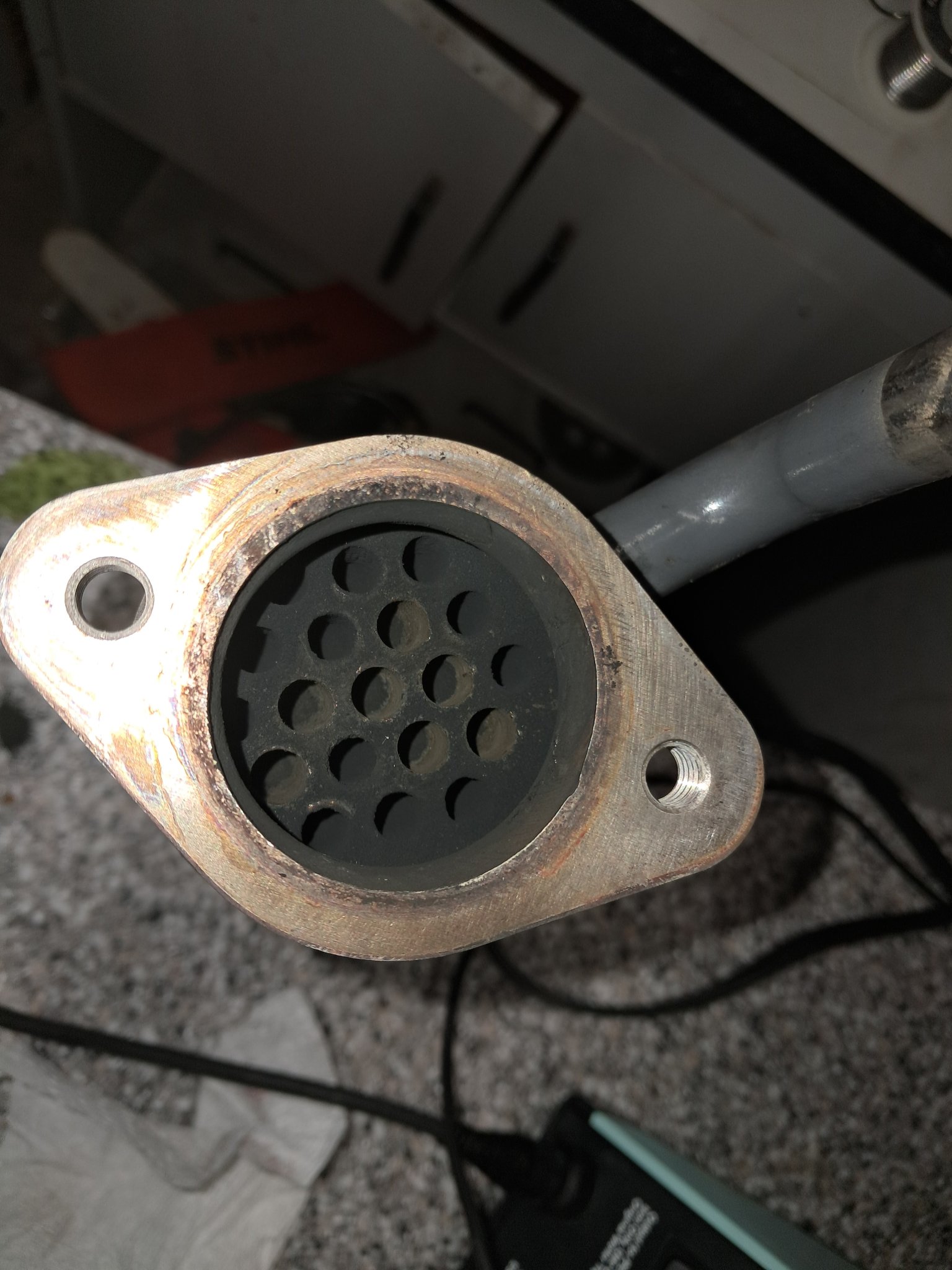

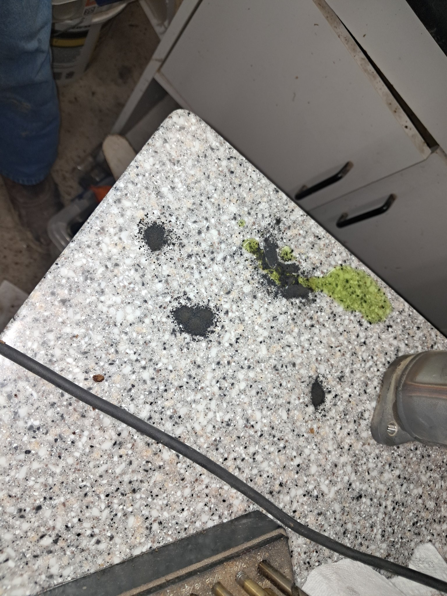

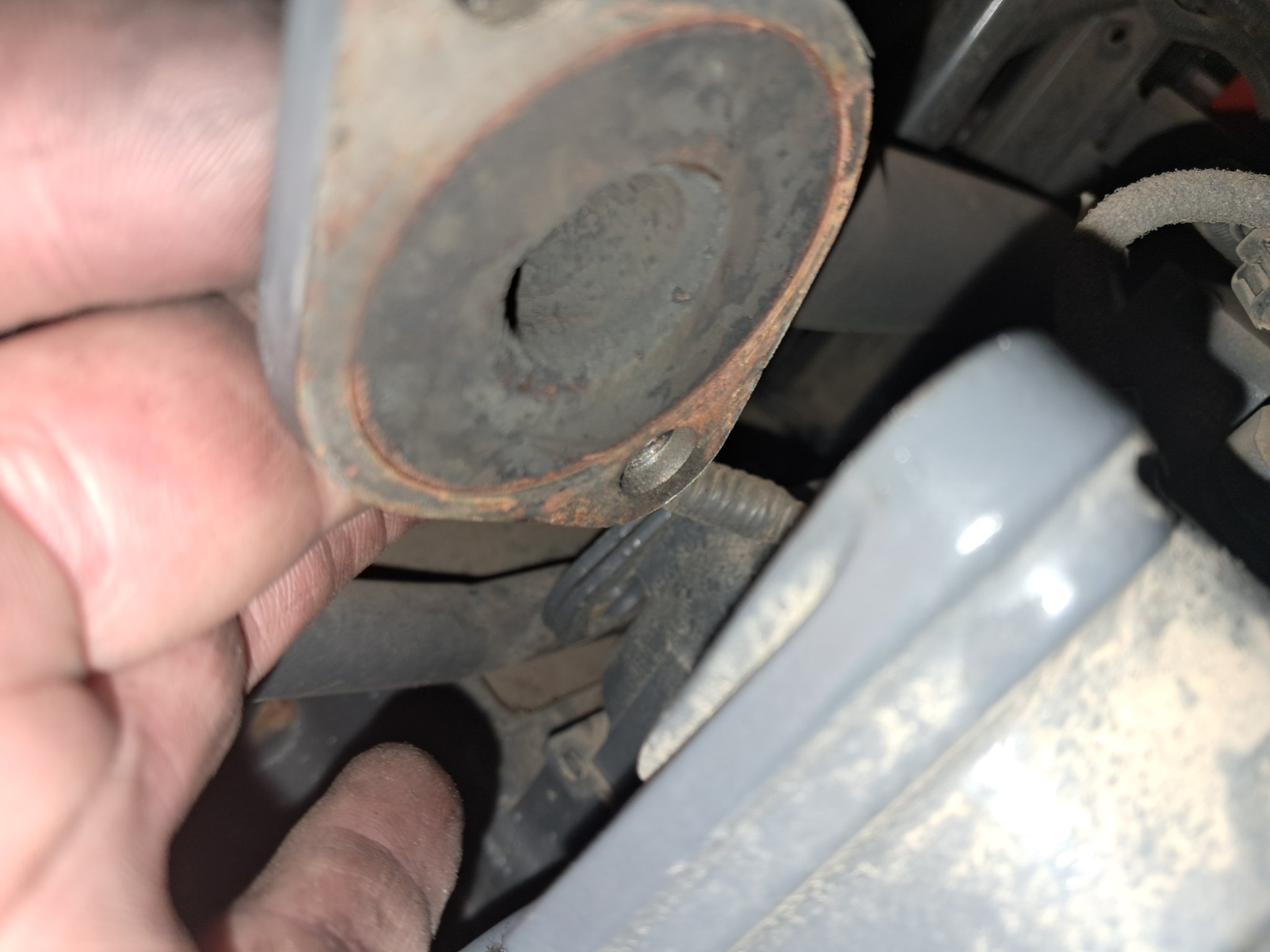

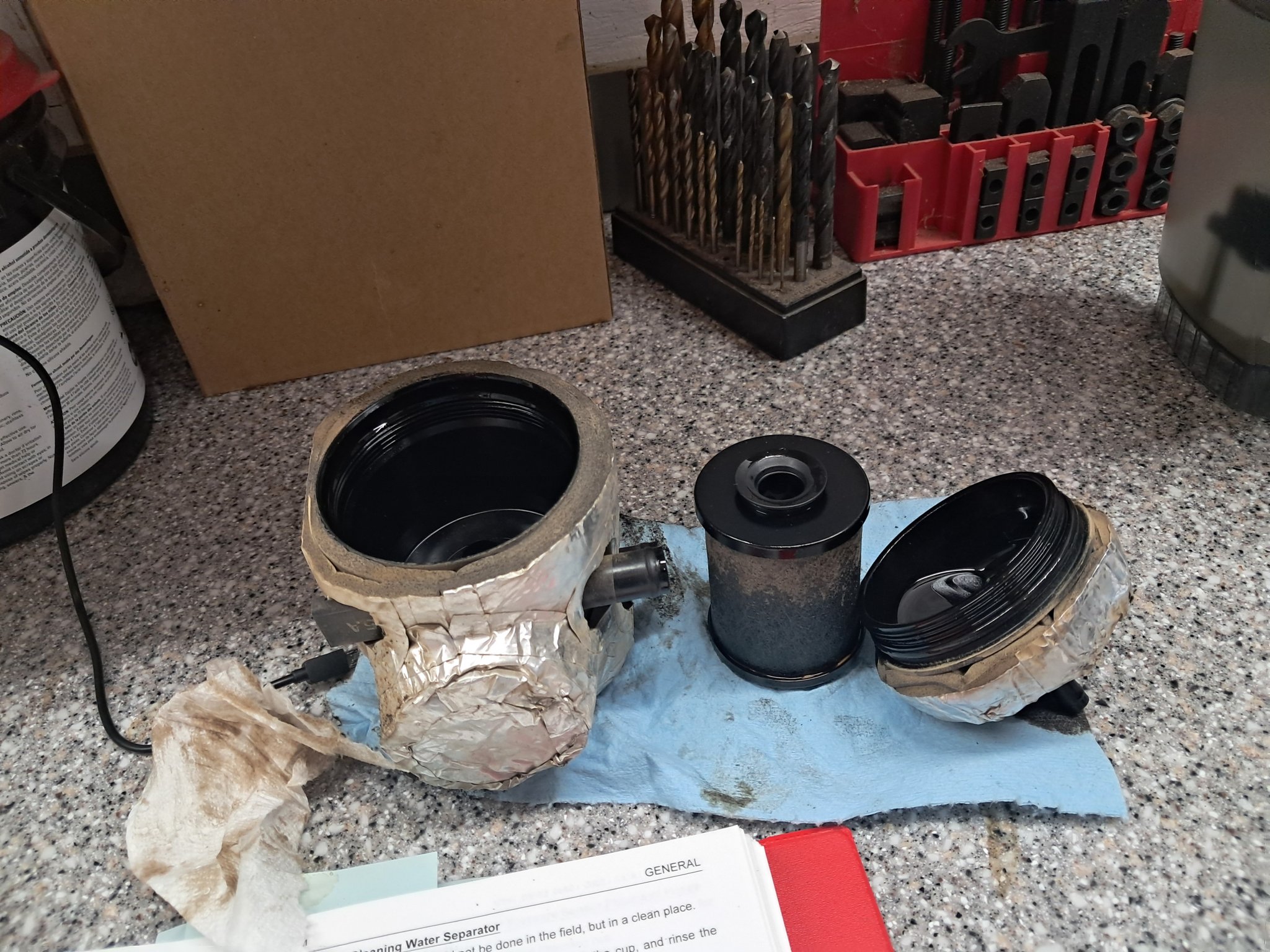

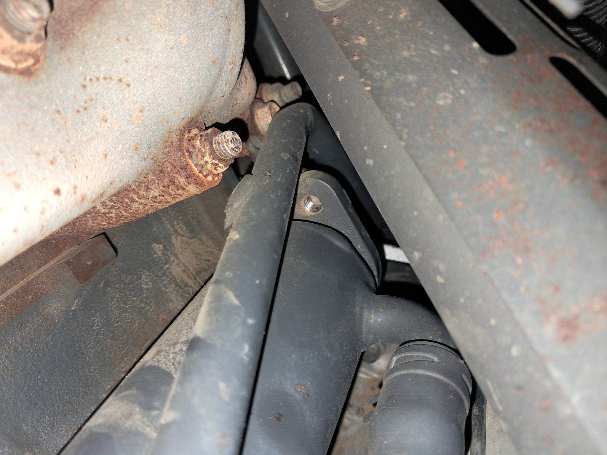

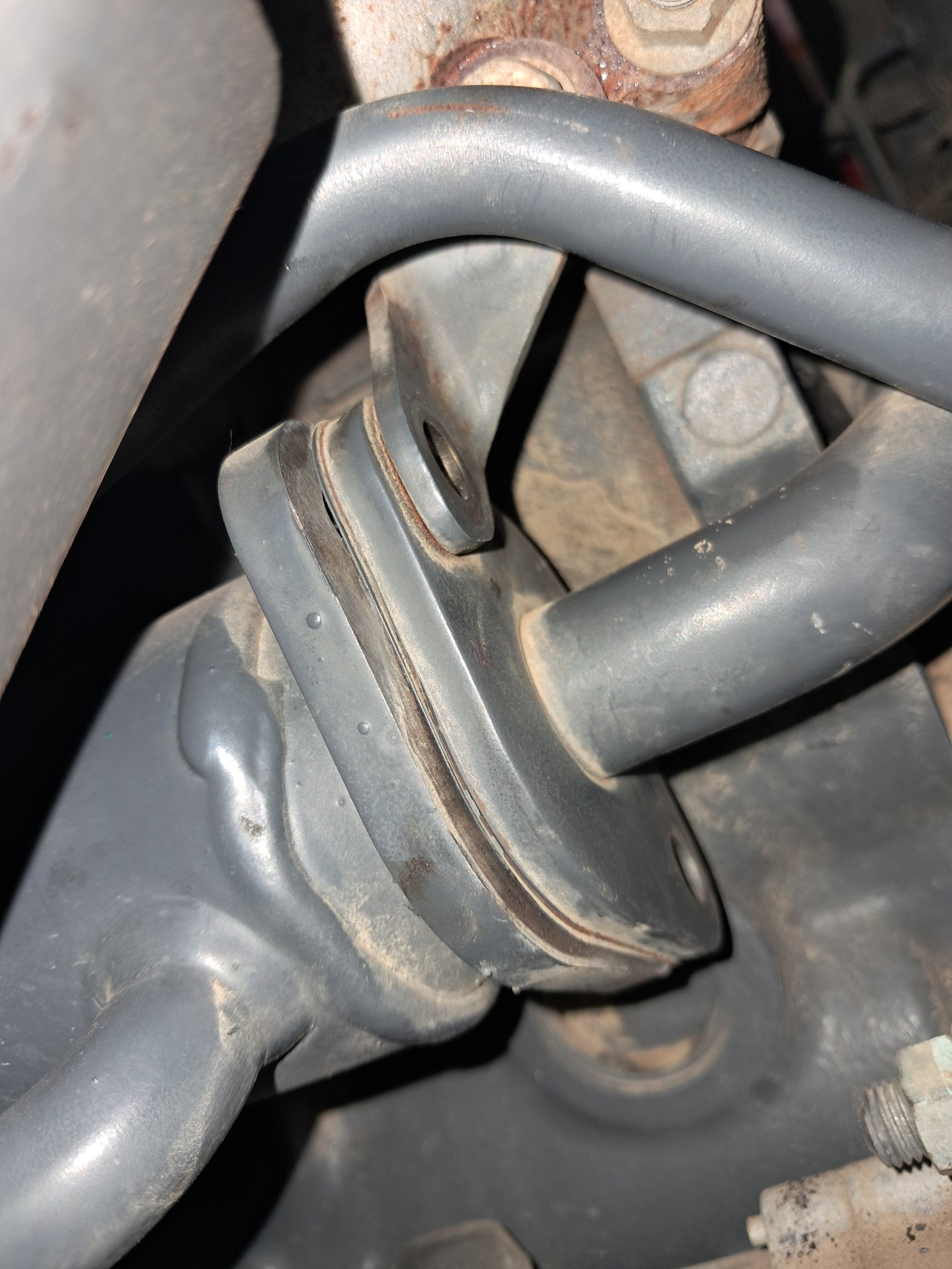

I have 1,200 hours on the tractor. At 1,500 hours you should clean the EGR cooler and replace the Oil separator element.

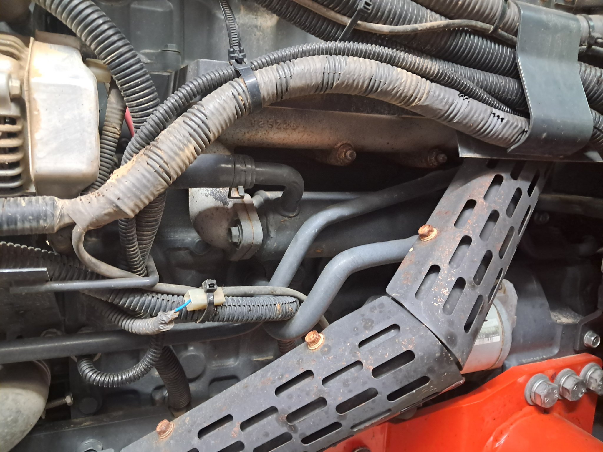

It is not easy to get EGR cooler out. The bolts are hard to get to the coolant lines were stuck on.
There is a bracket that hooks to the exhaust manifold that you can not loosen that bolt because a steel hydraulic line is in the way.
That soot goes all the way to the combustion chamber. We would never let that get thru the air filter.
