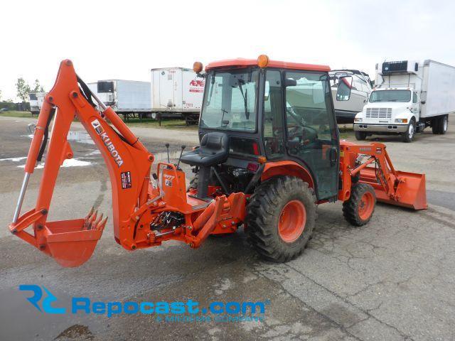

Hey all, I have an 08 B3030 HSDC, I got a smokin deal on an BH77. I know that according to the factory, a BH77 isn't an option, but I have seen pics and videos of them installed, but no one explains the combination of what it took, subframes they used, or how they hooked up hydraulics. The BH77 does come with a set of subframes for a B3350, and with a bit of fabricating, I'm sure could get to work. Has anyone on here put these two together? Does anyone know where to plumb in the hydraulics, or have a hydraulics schematic? A PTO driven hydraulic pump with a reservoir would be my last option. I'm also looking for a set of subframe extensions, and a seat, if anyone has them laying around, and would like to sell. Pic attached for reference.

I cant help with the subframe but the hydraulic hookup is just a two hose loop with a male & female quick coupler. It typically replaces the power beyond hose on your loader valve. Remove existing hose between loader PB port and tractor and install two new ones:
Loader PB -> BH72
BH72 -> tractor
If you have a loader 3rd function valve or rear remotes the tap in point is a little different but the same idea.

I don't have a third function, or rear remotes, those will come later, as I want to add them before Kubota quits making them for my tractor. I have been looking through the Kubota parts site, and the BH77 install manual, it looks like the same subframe part numbers for a B3000 that i would need for a B3030, with the frame extensions. I'm sure i will need to have hoses fabricated, or at minimum, have the proper ends put on them, if they aren't the correct ones.

Well yeah. The hoses will be 3/8 with JIC-8 female swivel ends.. You can buy those premade for a lot Iess than having them made.

Here is a link to Messick’s parts pages showing the Mounting Kit for the BH77 to put on a B3030.
Here is the link to the installation instructions. Staring on page 8 and continuing for a couple more pages, it shows exactly how to hook up the hydraulic lines to the tractor.

Just got back from the Kubota dealer, apparently, the BH4972 (B3000) nor the BH4975B (B3030) are offered in a kit anymore, time to scour the internet. I already put a post up on the Buy/Sell

Found a BH4972 kit, one of the dealerships had it sitting around collecting dust, and not in their inventory. Unfortunately, I wont be able to see it till it gets here.
