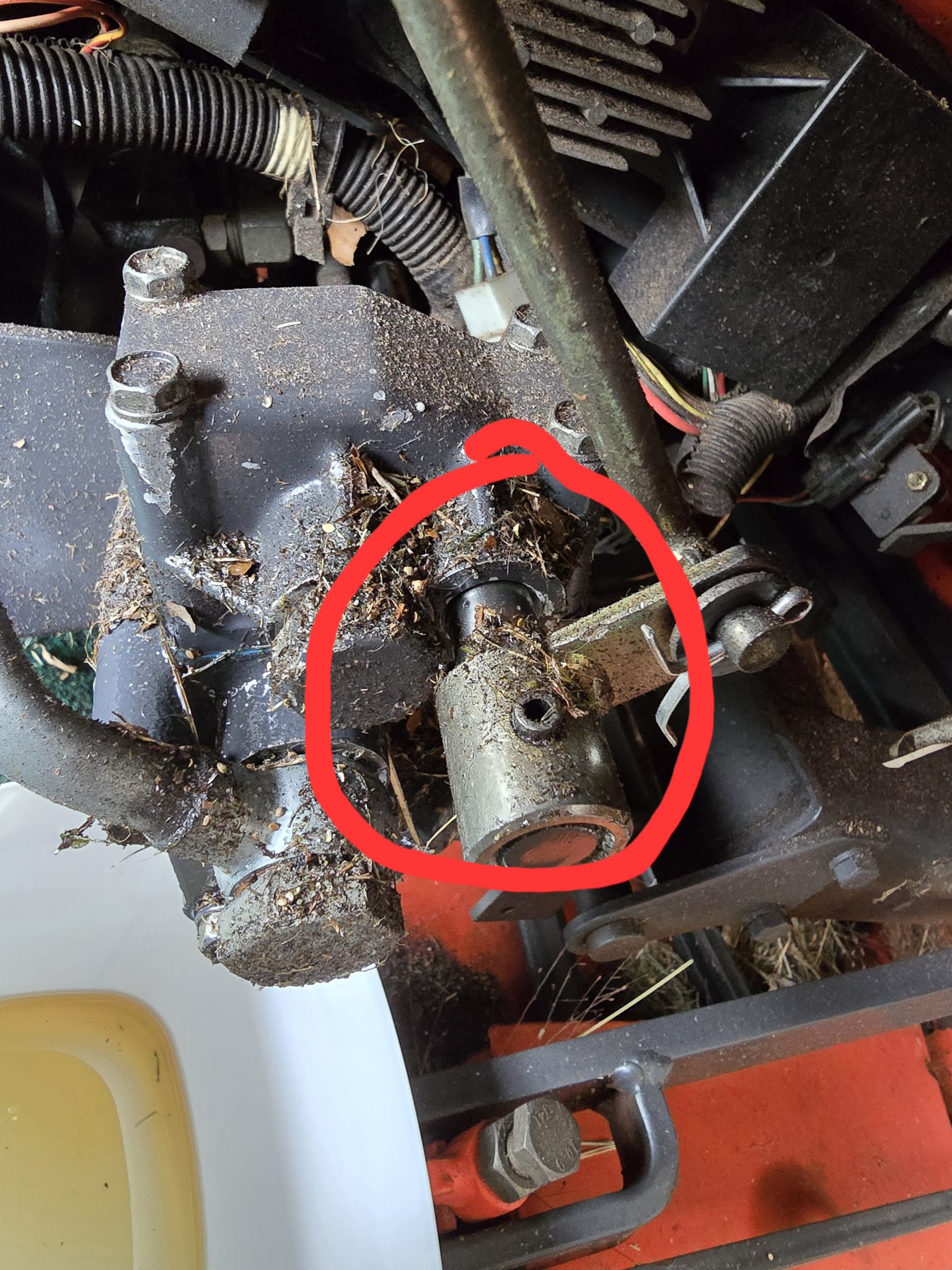

I can't figure out why this hydro leak keeps happening. Last time it was in kubota they said they replaced all the seals.
Every time I throttle up the leak gets worse

If the seals were replaced and it still leaks past the seal lip
then most likely the shaft has an issue or the bearings or
bushings have excessive play.
I would first clean the entire area and confirm exactly where
the oil is coming from.

It's definitely coming from this area. If I put some pressure inward on it, it seems to slow
