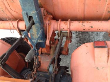

this pic shows the tensioner pulley that engages in the bend in the belt you describe, although it does not show the belt itself. It should help you understand how things are connected.
