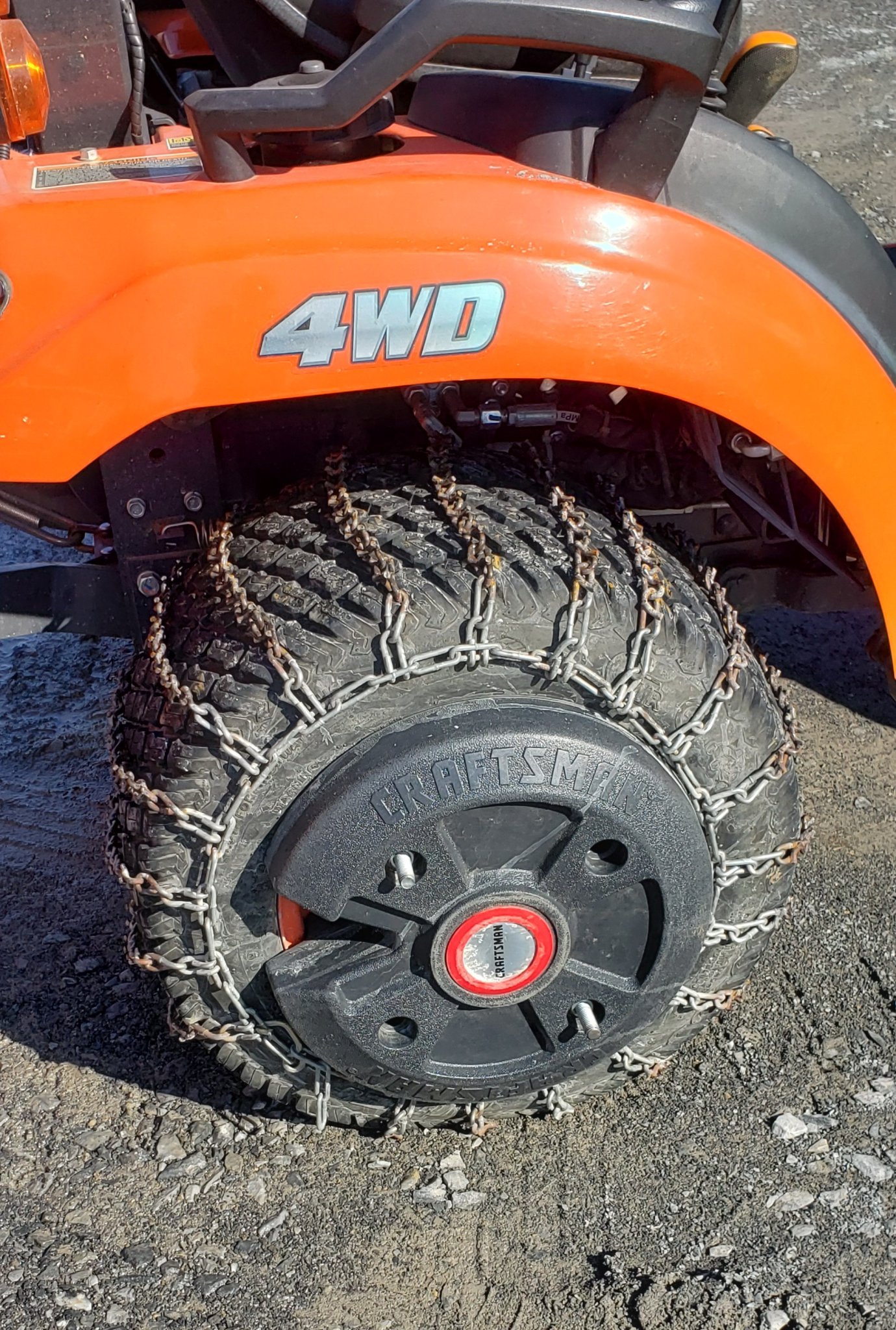

I had weights (50# each) from the Craftsman 6500 the BX replaced – fit like a glove. I used two 1/2" threaded rods and mounted them without removing the tire. The max mixture of slush free calcium chloride at -47F equals 97# per tire so I think I’m pretty safe with 50# each. And I can remove them easily - just four nuts – for mowing and such. If I need more I hook up the ballast box to the 3 pt.

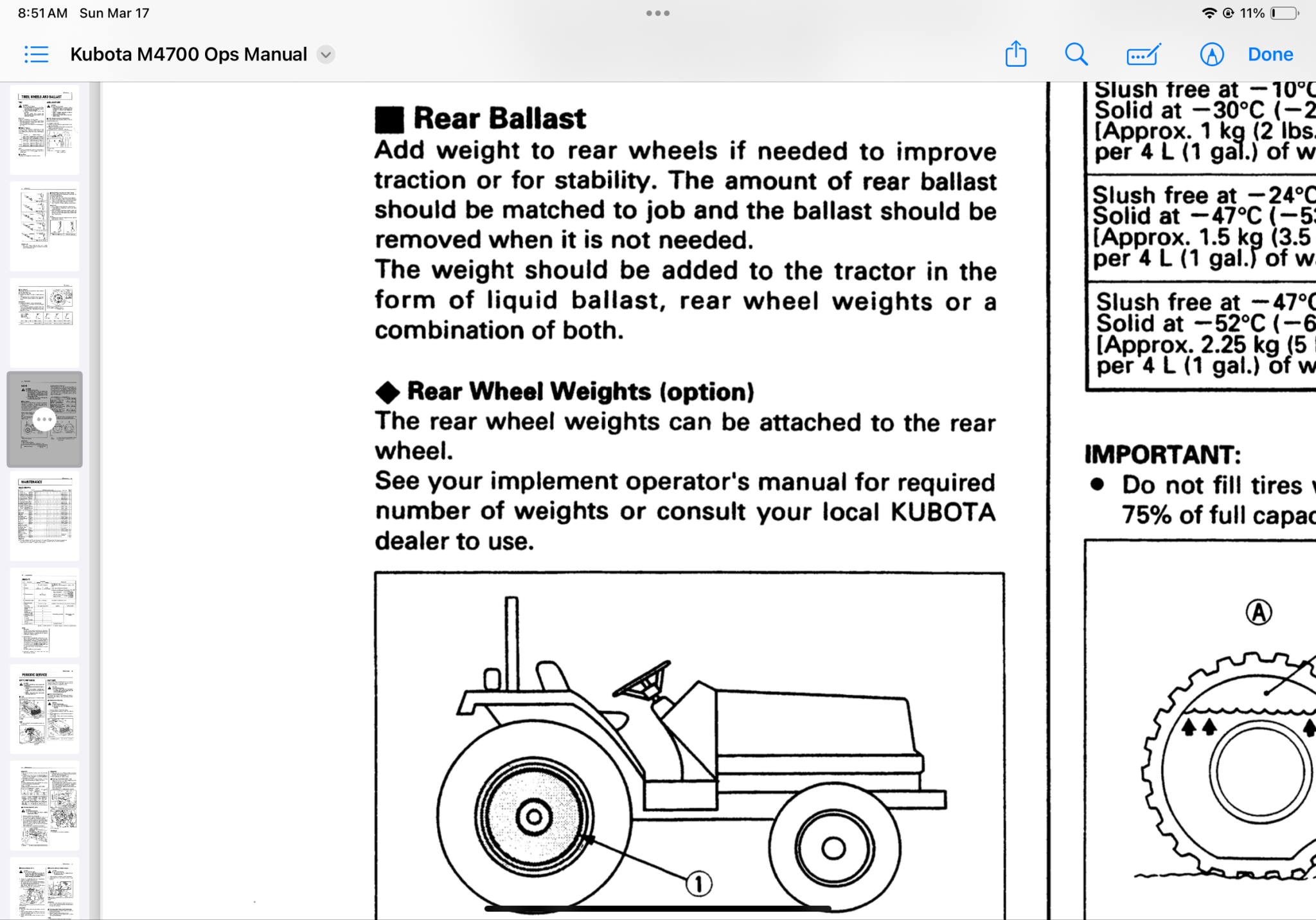

Gibberish.
5,849
3,124
your Literature is for an M4700
we are talking about a small BX
That doesn’t answer the question. My post was only to show that adding weight to the wheel that already had filled tires…is NOT a general prohibition by KUBOTA….as was previously indicated.
—- "Kubota tells you not to do this!”
It MAY be a prohibition on certain models…but NOT a Maker/Brand-Wide prohibition…. and your response, John T, did not provide any useful information…. BUT THANKS TO BEE-POSITIVE…for doing so.
