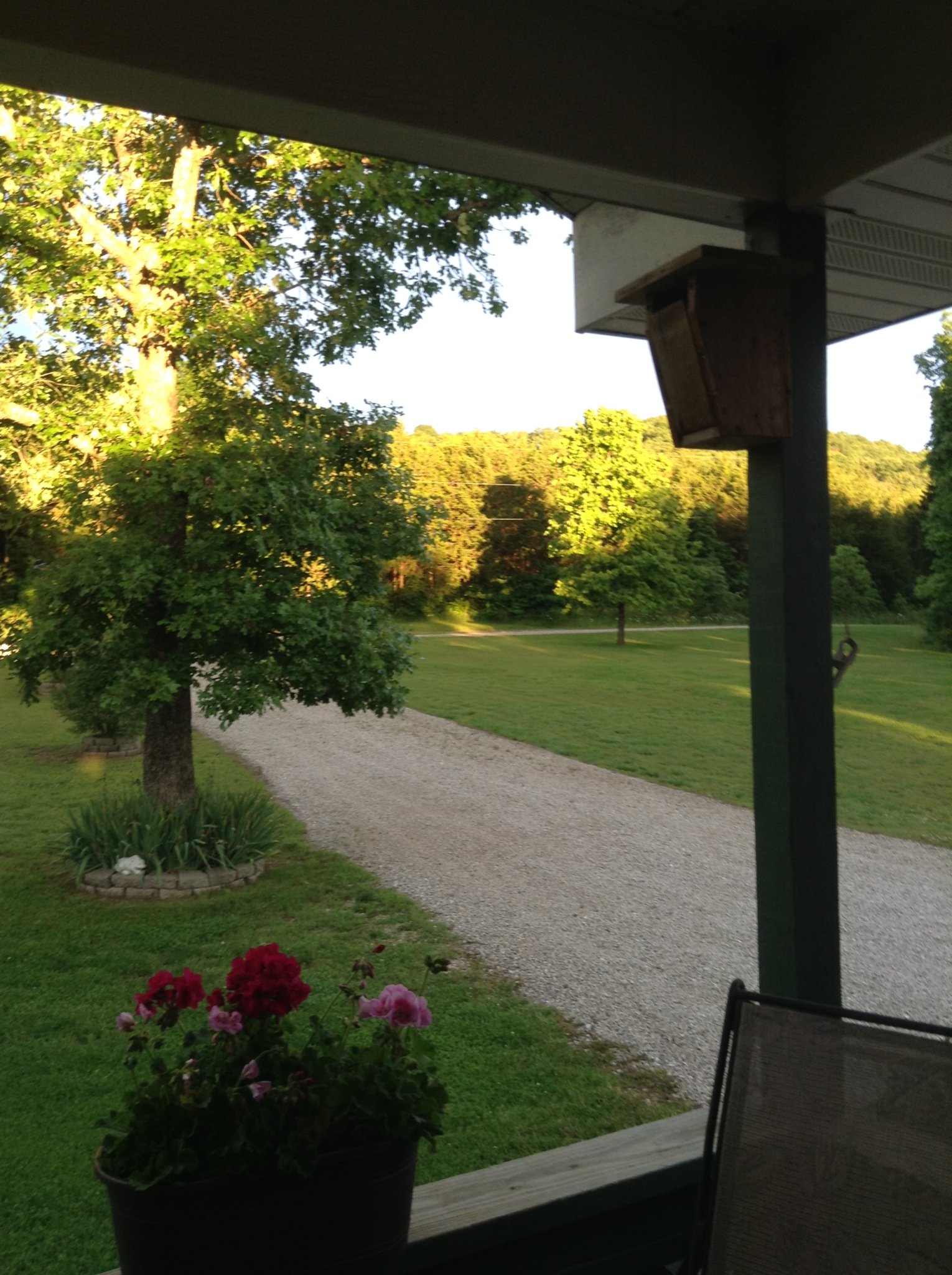

Regarding any implement that you purchase for grading purposes, try to get something that is 100Lbs per foot of width. Heavier is better. Here is what I consider the perfect box blade for your tractor.
Biggest downfall is the cost, but you get what you pay for.
