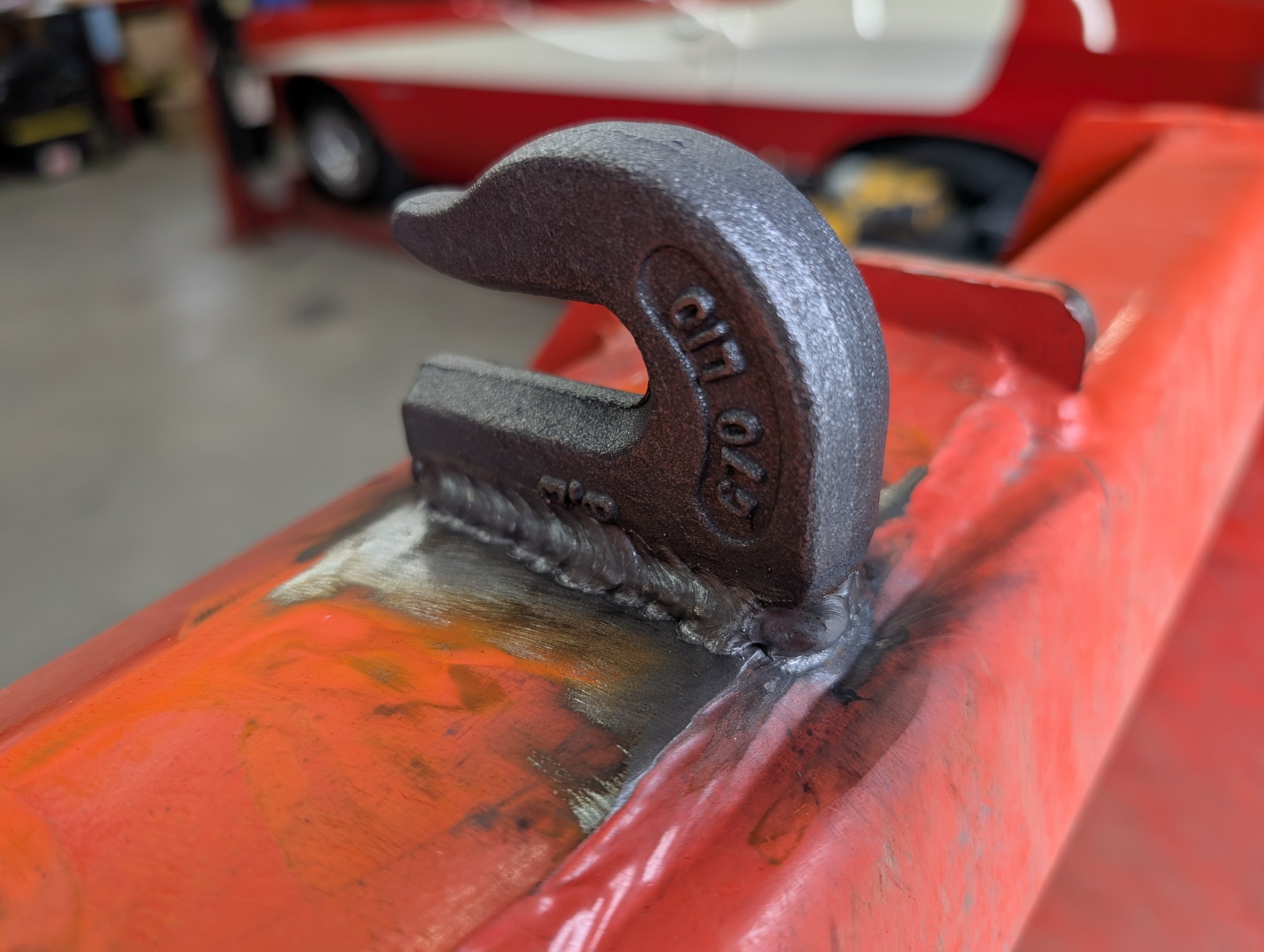

Also welding on the bucket hooks this morning...I'll share later how they come out!

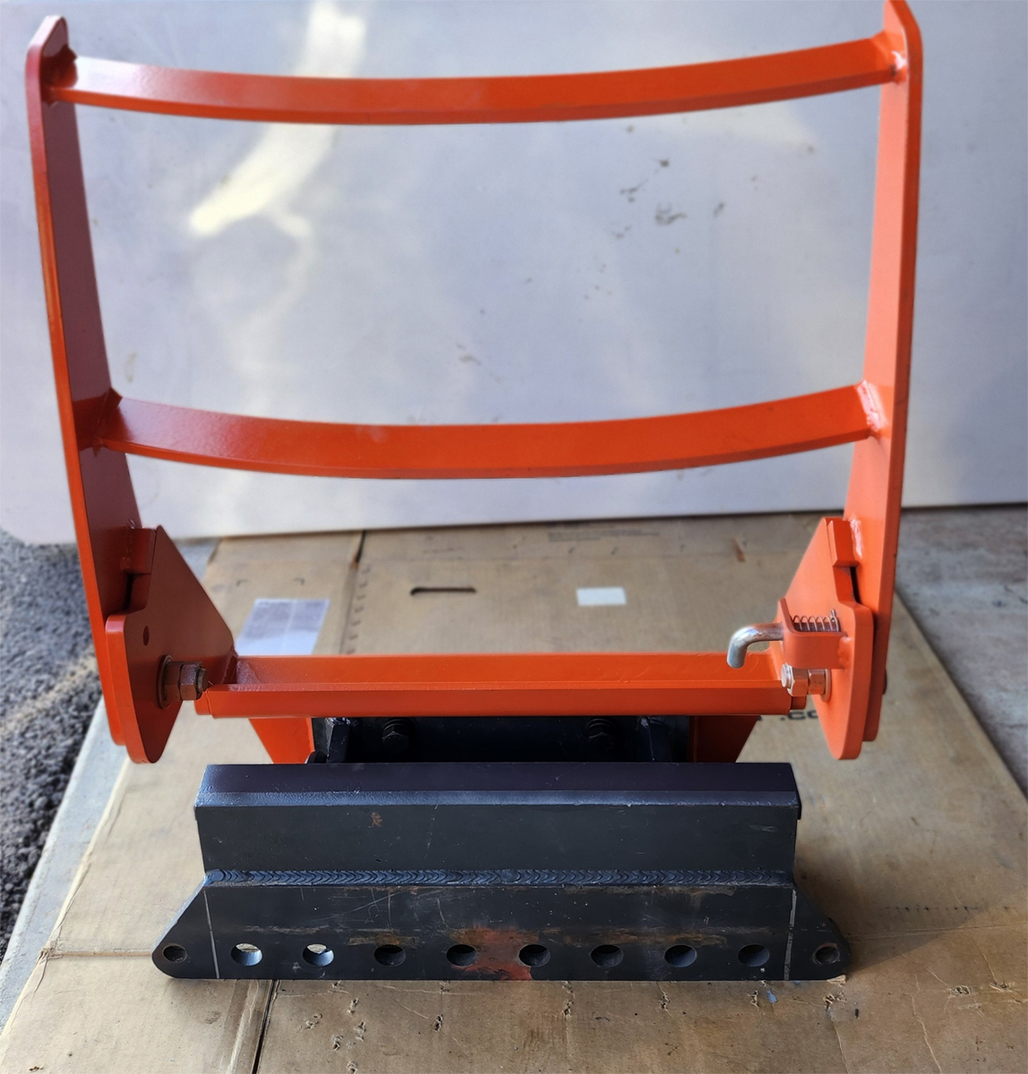

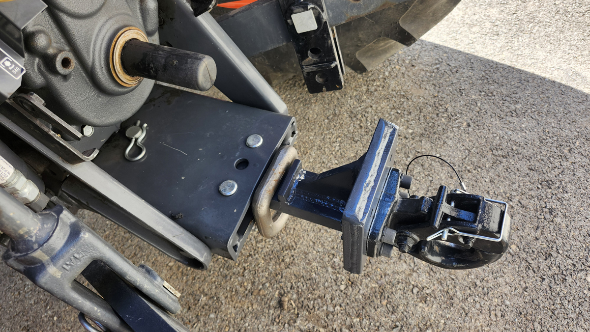

I finished making the M6060 pintle drawbar yesterday afternoon. I double up two pieces of 6"x6"x1/2" plate for pintle mounting, drilled four 1/2" holes and drilled/tapped two 1/2-13 threaded holes either side of the bar. There isn't enough clearance for nuts on the back side of the plate either side of the drawbar. This design allows for four mounting heights of the pintle. This is a stout drawbar but the M6060 needs it.

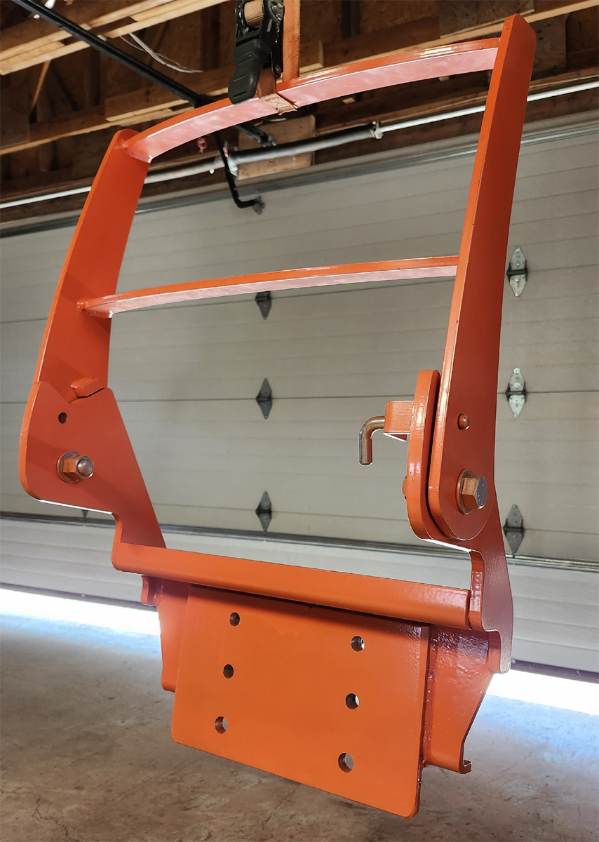

I also finished modifying the brush guard and weight bracket. The front weight bracket is bolted to the brush guard and ready to install on the front of the M6060 this morning. I'll need to use the MX to lift it into place. It is heavy, and virtually impossible to install as two separate pieces without a lot of messing around and probably some help. The 5/8" spacer will allow me to get the suitcase weights on the mounting bracket with the brush guard in place. That's something I couldn't do before and explains why photos of the M6060 with the front weights on show the tractor without the brush guard. I still intend to weld up custom brush guards for both tractors, but I can do most of that with the bottom half of the brush guard and front weight bracket on the tractor i.e. I don't intend to ever take it off again! 😂

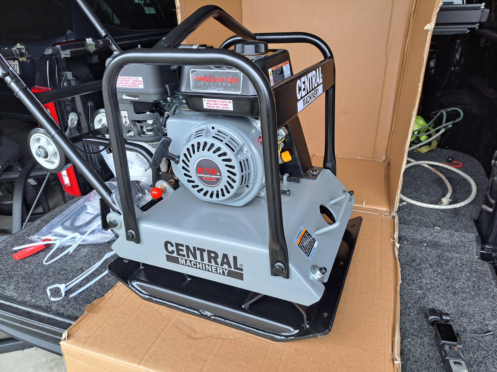

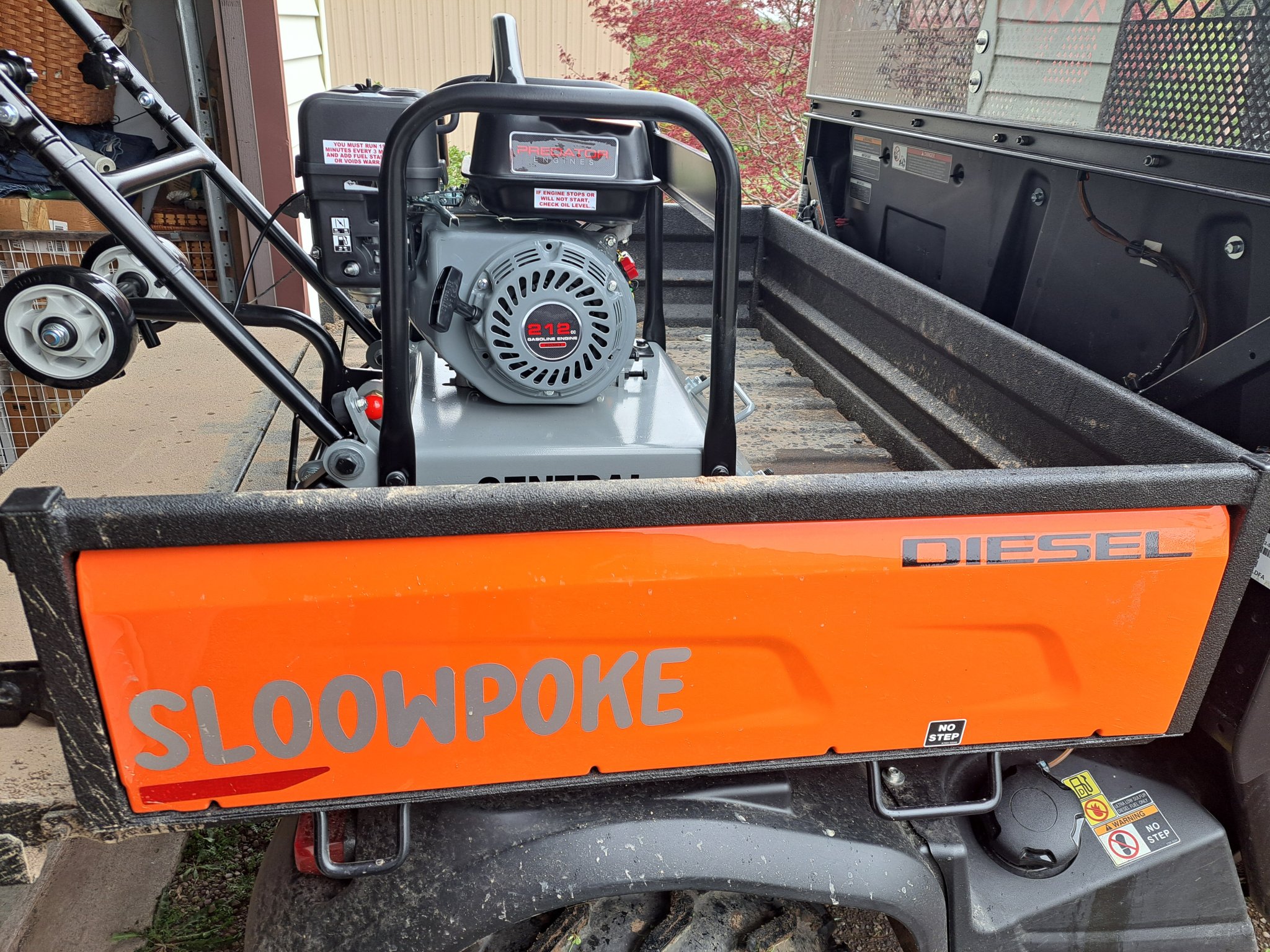

Hard rain all day so ran th HF to grab a cheap compactor. I'm slow so renting one would have cost the same. I decided to take a chance with 3 different projects lined up. Luckily the RTV is the same height as my truck so was able to slide it right on the RTV and bring it down to my shop to prep. Hopefully it works. I have been watching craigslist for years for one but most were totally beat or overpriced. Can't use the 2 hand tampers I have anymore with the muscle problems from long covid I was diagnosed with.

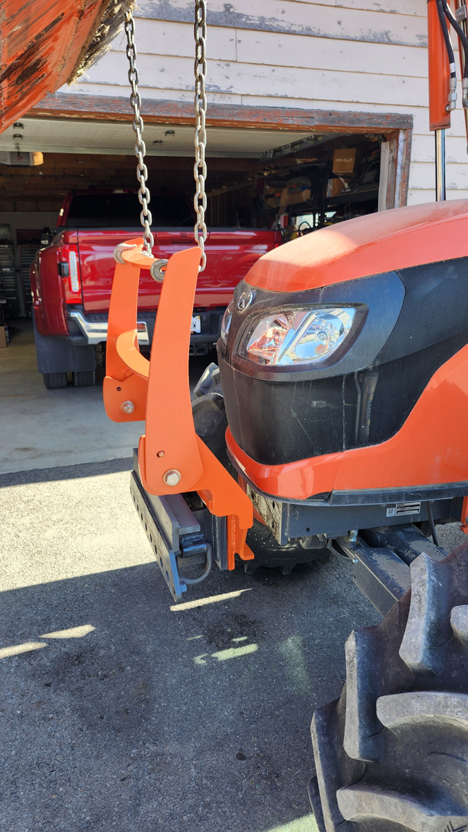

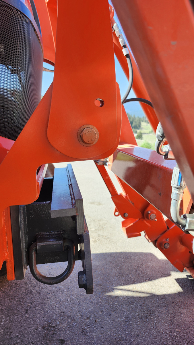

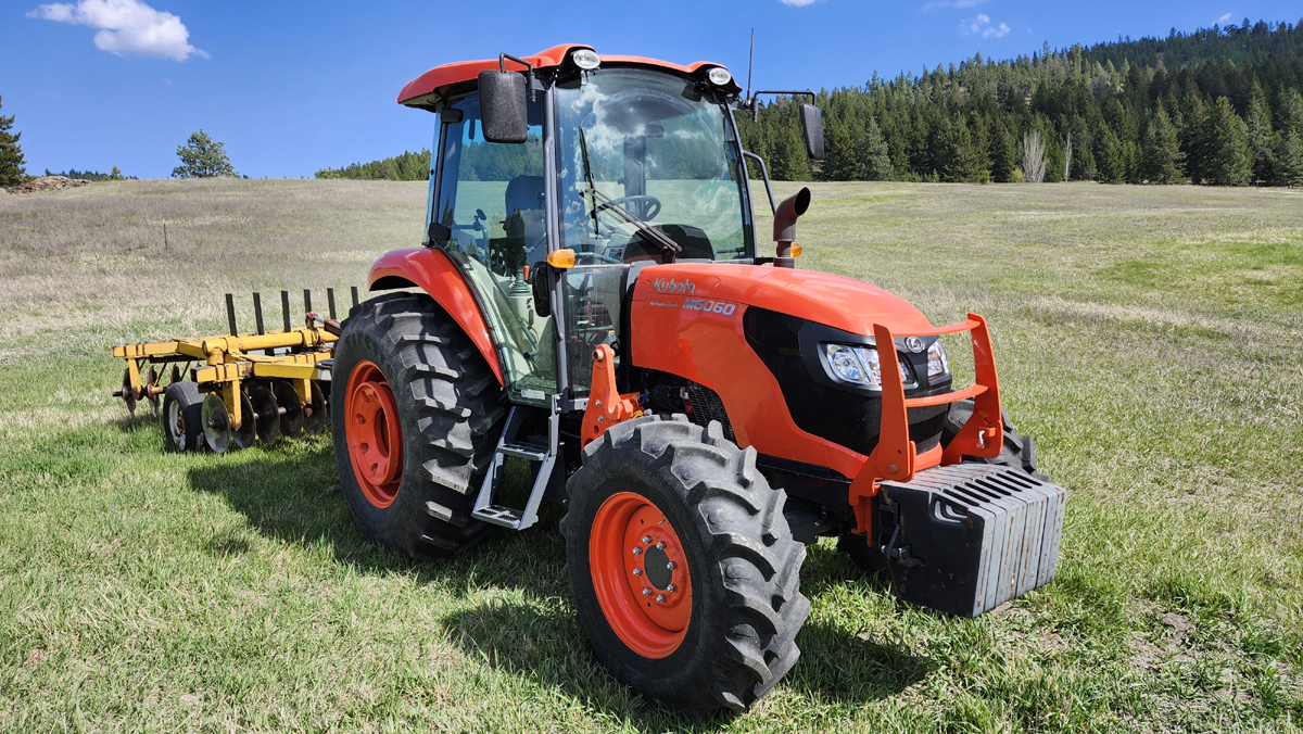

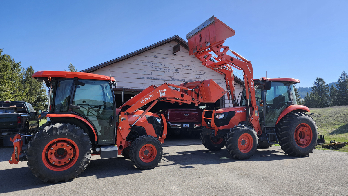

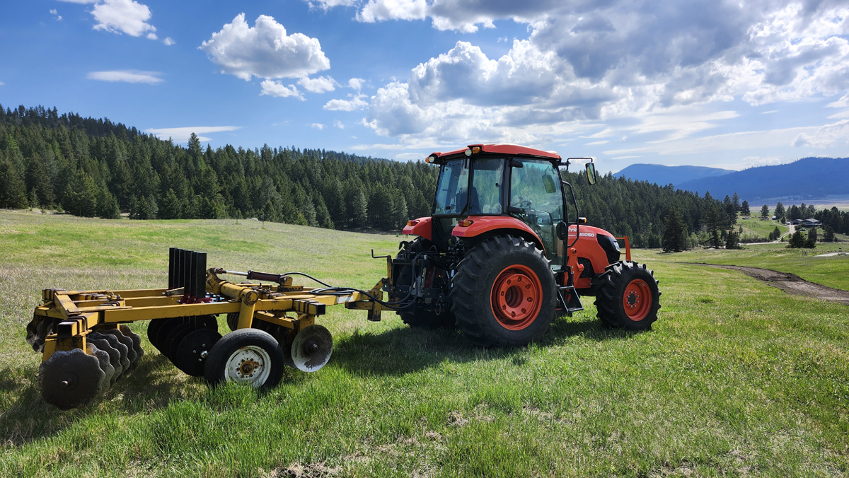

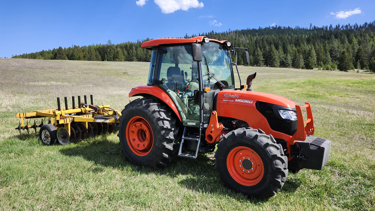

I got the brush guard and front weight bracket installed this morning with the help of the MX and some chains. There's plenty of clearance between the loader and weight bracket, but obviously you can't have weights and the loader on the tractor at the same time ... but why would anyone want to do that anyway!
I removed the loader, got 8 of 10 weights on the tractor, removed the PITA PTO cover, greased a bunch of components, filled up the windshield washer fluid reservoir, blew a ton of dust out of the air filter, radiator, condenser, oil cooler etc., and finally got the disc hooked up. I'll be loading up the trailer in the morning and heading to the discing job after I've topped off the M6060 fuel tank.

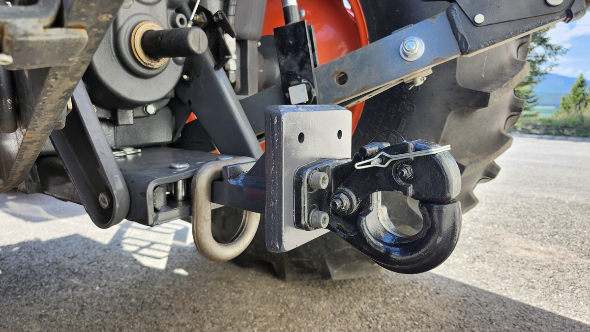

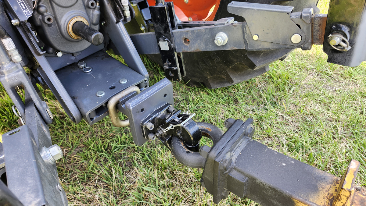

I added one more feature to the pintle drawbar. I've wanted to add rear tie down points on both tractors for more than a few years, and today I took a step in that direction. A bit of flat bar welded to the drawbar (as a stop), and a large D-ring will do the trick. The D-ring slips over the drawbar and is free to rotate as needed.
All in all a productive but tiring few days. Sitting in the tractor for a few hours tomorrow will be a cake walk compared to all of the cutting, grinding, drilling, tapping, lifting, welding, painting and wrench turning I've been doing over the past few days.

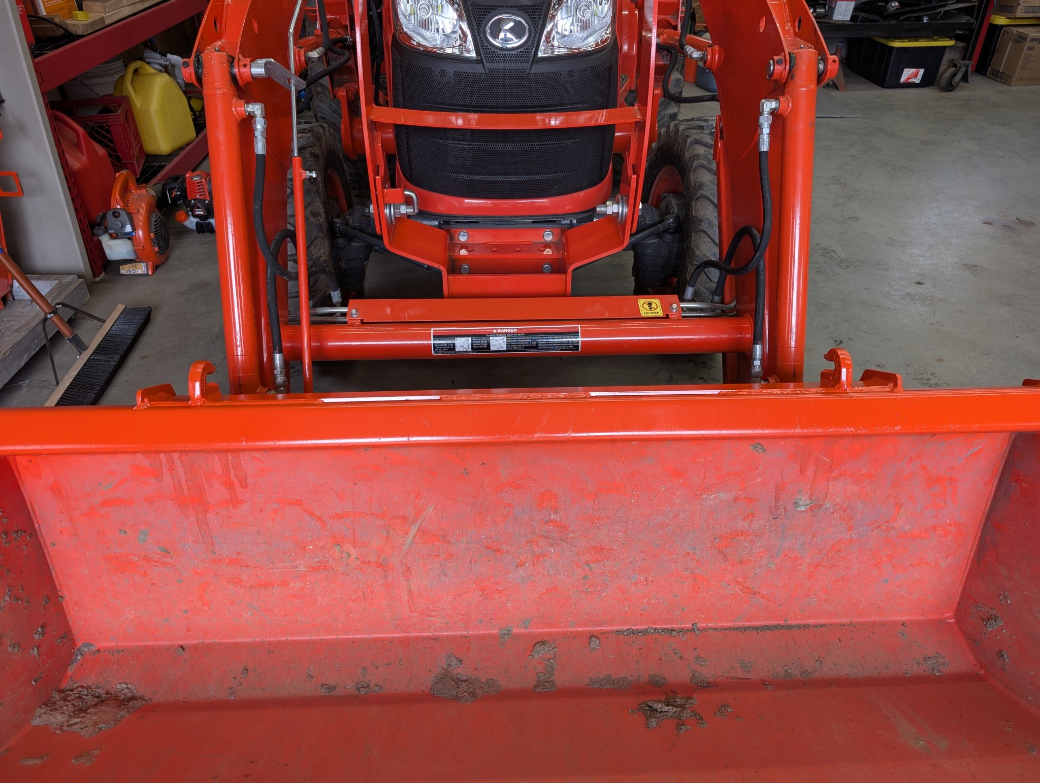

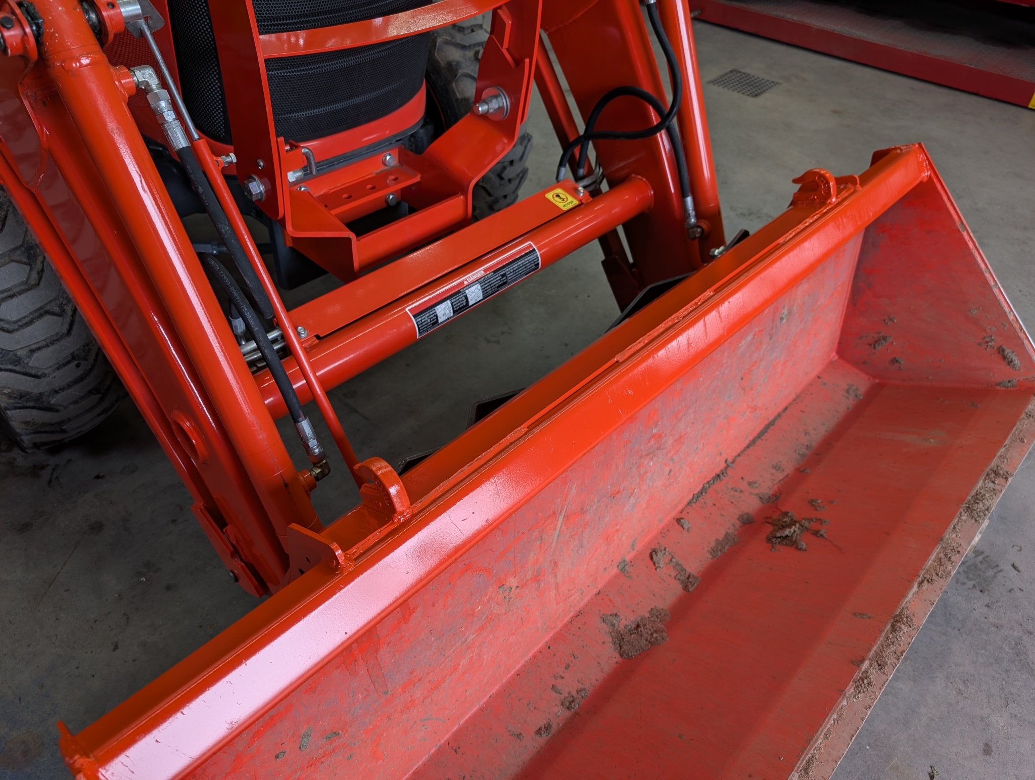

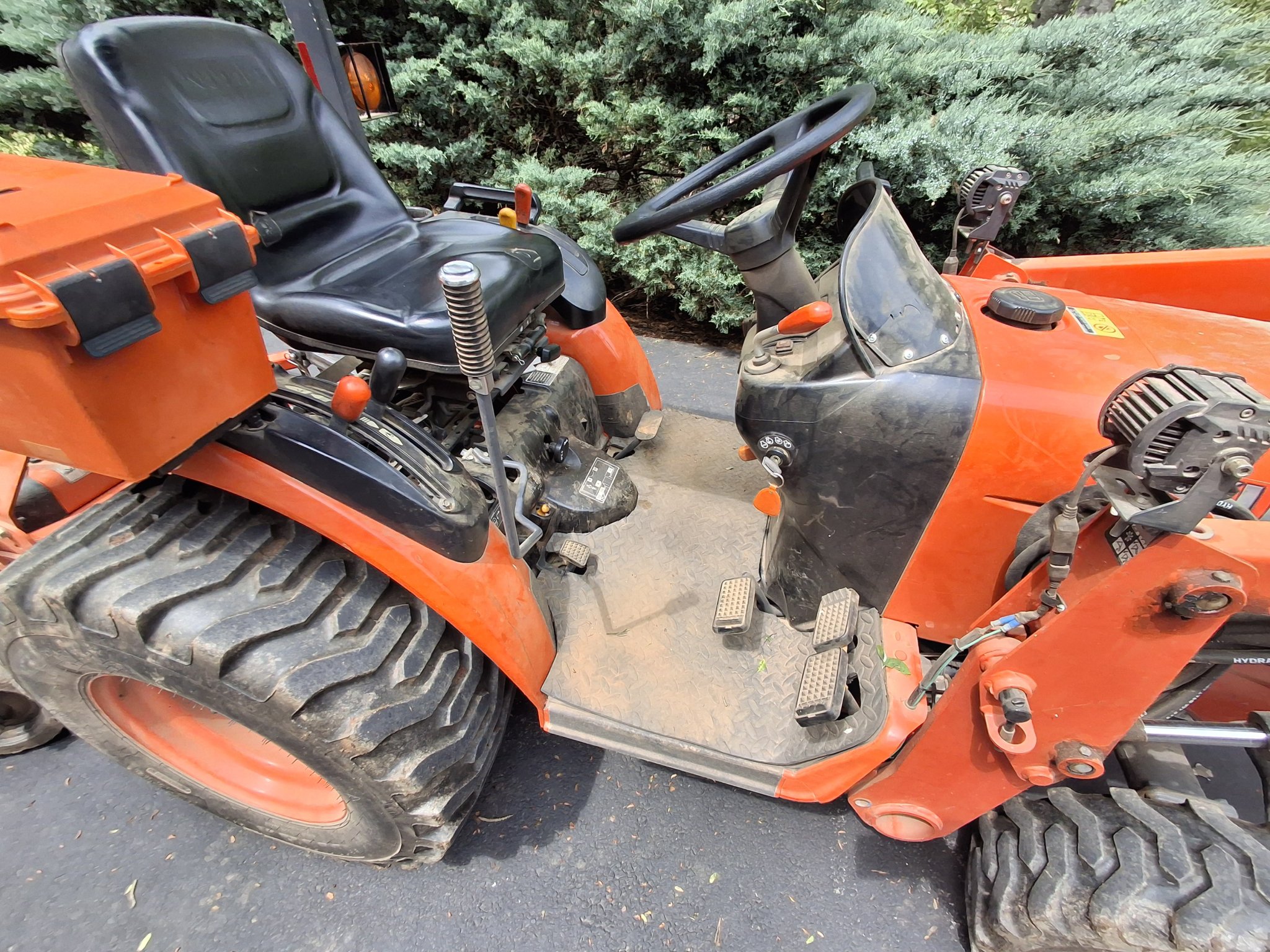

It started down pouring so I decided to clean the tractor..put some wax on it. Cleaned the suet off the loader (I'm bored ok). I learned from Messicks it's not recommended to use regular grease as it attracts dirt and debris in the 3 point so I cleaned out the grease and used lubed it with multipurpose spray lube, I'll get some dry lube for the balls but should be fine for now. Found a squeak that's been annoying me in the 3 point linkages, fixed that now it's quiet! Haha. It was just the stabilizers.
I even cleaned the rims and the tires. The tractor looks brand new again haha.
I need to sand down the flat face of the quick attach..it's so rough. I'm not the first owner of the tractor...it almost looks like the previous owner pushed stuff without an attachment on. Easy project for another time.
I want to make a "receiver" for the drawbar that slides over the drawbar to have my trailer ball attached so I can use a draw bar pin to remove it easily instead of having a trailer ball directly in the drawbar. I want to put a rugged clevis pin on the drawbar that I can use for tie down and pulling logs. I don't like the 3 point trailer attachments, don't need it honestly. I only move my trailer once in a while. So having something I can put on the drawbar quickly will be nice!
Now I wanna try out the bucket hooks 🤔

I've been happy with the one that I bought a few months back. It did throw one of the belts for some reason. Easily wrapped it back on.
I was surprised that it came with an extra set of belts, airfilter, and carburetor jets for high altitude. Hopefully the rubber isolators holding the pad last. I was thinking about trying to grind some radiuses on the plate long sides so it doesn't catch when turning.

That hitch looks great.
Maybe I missed it but looks like you maybe a hiding a big red machine, no?
Love seeing the tractors stretching before heading to the field. 😉

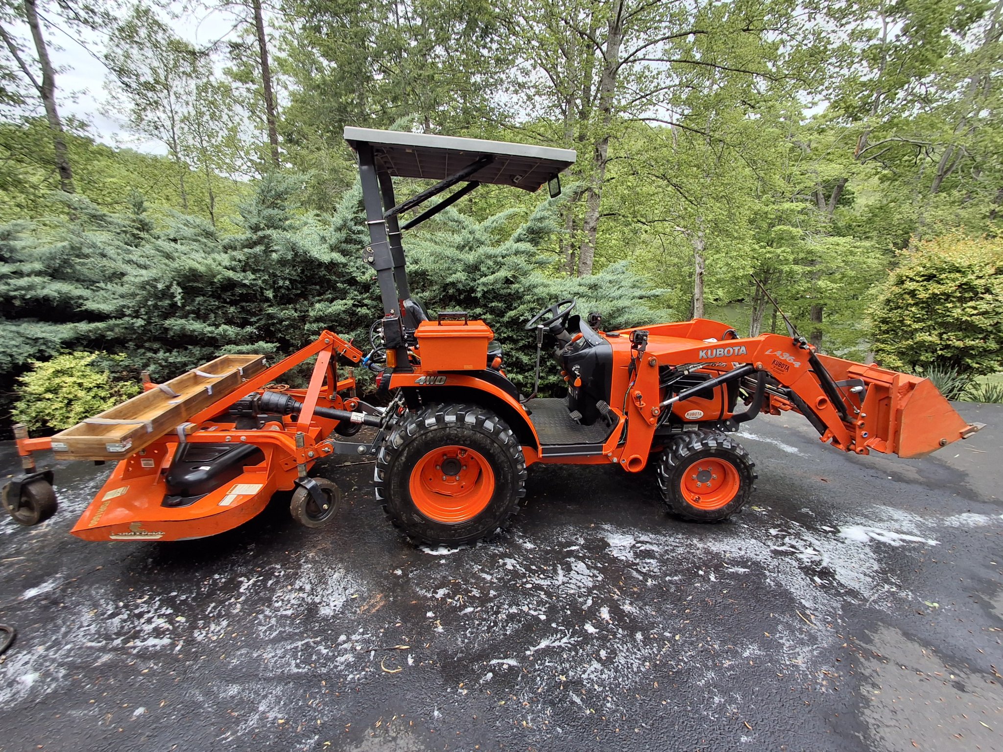

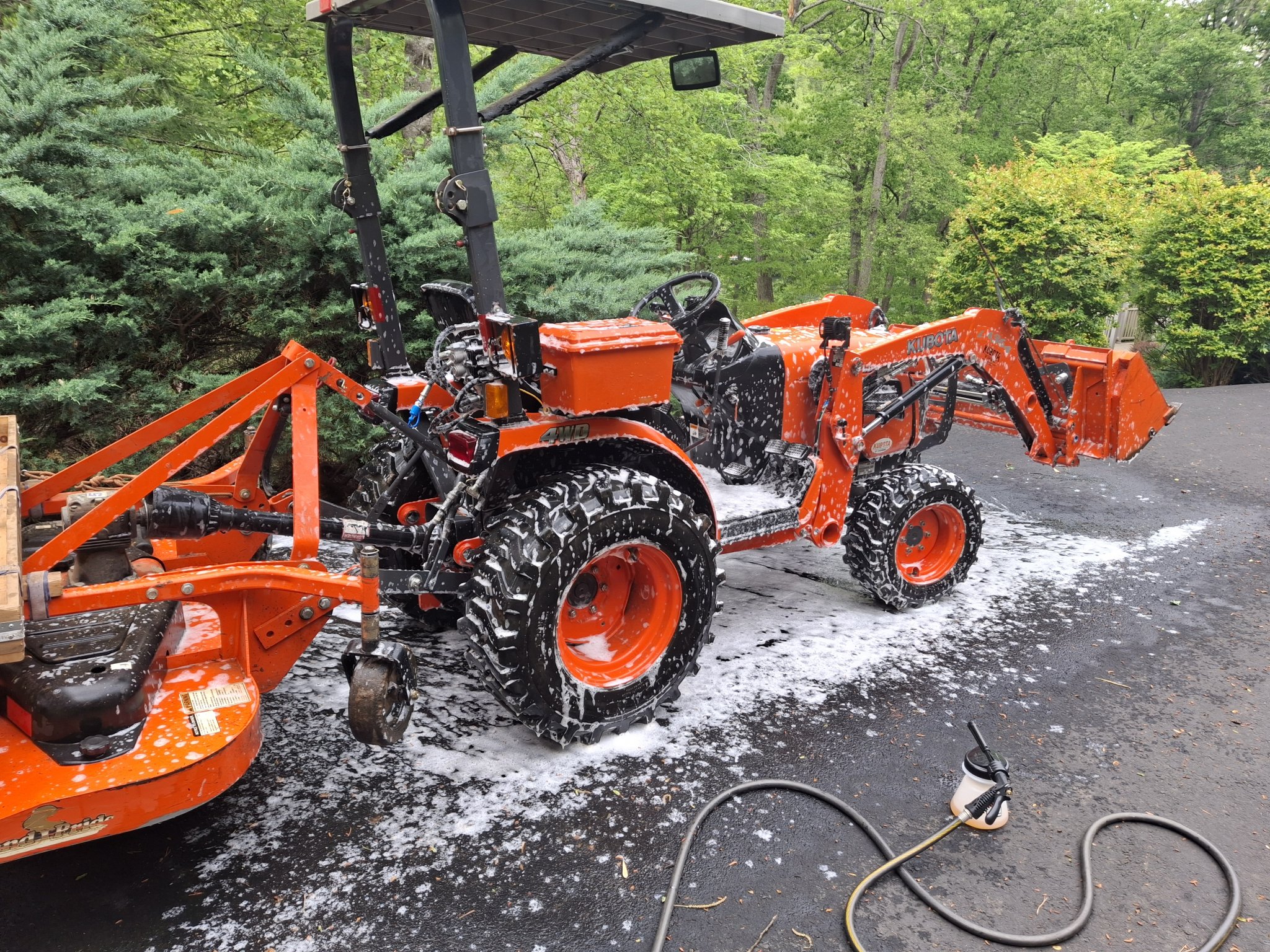

My b2620 has not been washed in waaayyy too long. We had some epic pollen this year and the tractor lives in a covered shed with no walls. Add in dirt from regular use and the first big mowing of the year and it was time.
I had bought a foam cannon previously for washing the Transit so I gave it a whirl on the tractor.
And here is the after. I used hot water via a garden hose. I think I could get better results if I pre-treated the greasy residue at the joints and did some scrubbing/brushing at the worse spots.
