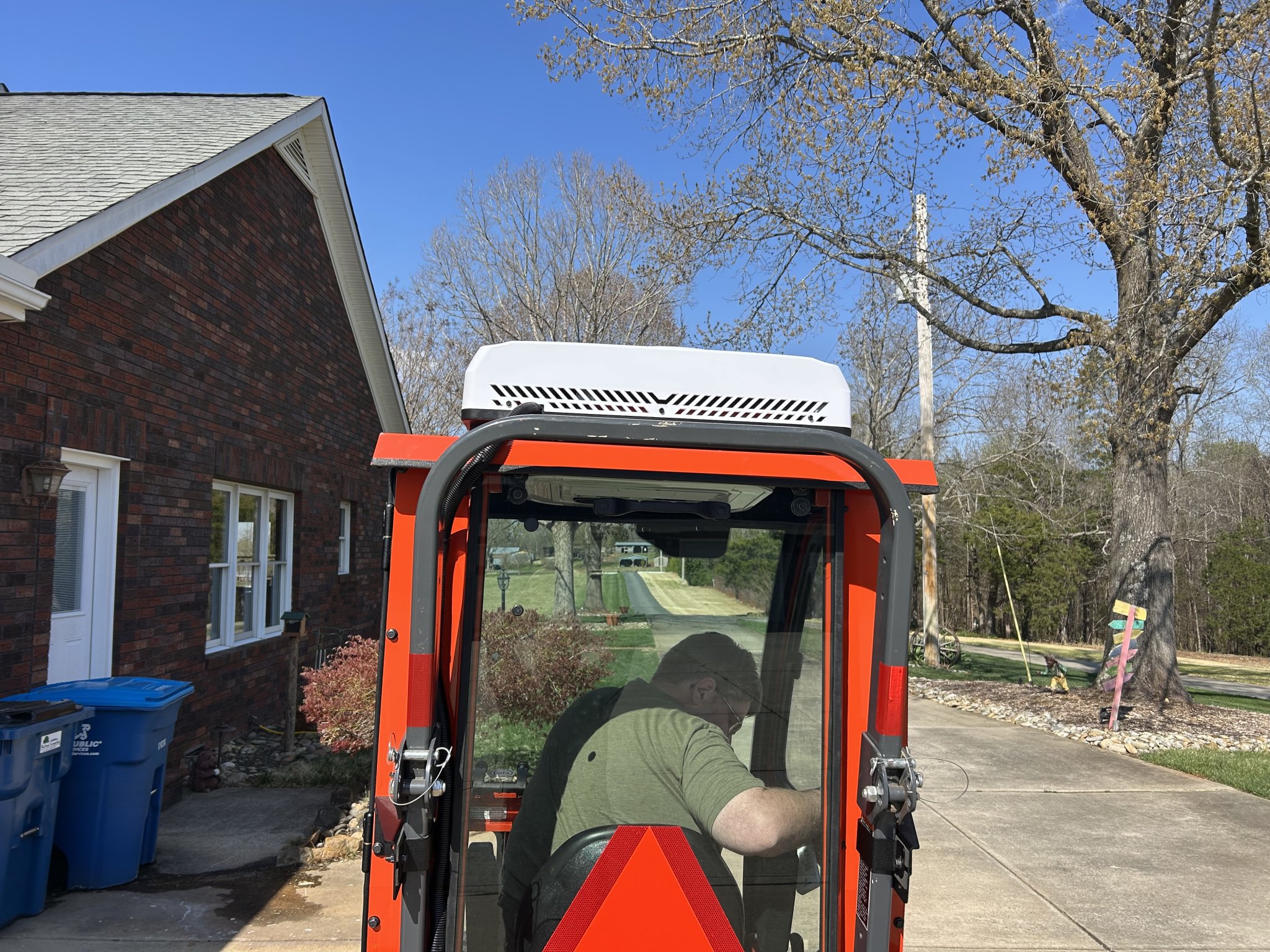

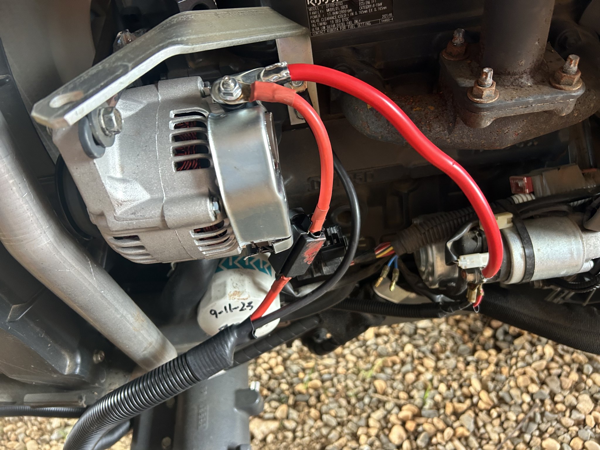

Well today I got my roof top ac heat unit delivered to my farm. I hooked the positive wire right onto the alternator and ground to the block. I set the unit up in its box and started the tractor and the ac unit. I let it run for one hour at 1400 rpm’s. The ac unit has a voltage setting which shows the current level and you can set a level between 9 and 11.5 volts to stop the unit if voltage drops that far. I checked the voltage every 10 minutes, the temperature of the battery and cables and all was cool and normal. The voltage on the unit was 13.9 to 14.1 the entire hour and the air was very cool coming from the unit. I would say it was a successful test and now to order my cab.

hmm. was the hood open all the time ? If so, repeat the test with the hood down(normal operating mode ).
you should also check the alternator's temperature during the test.

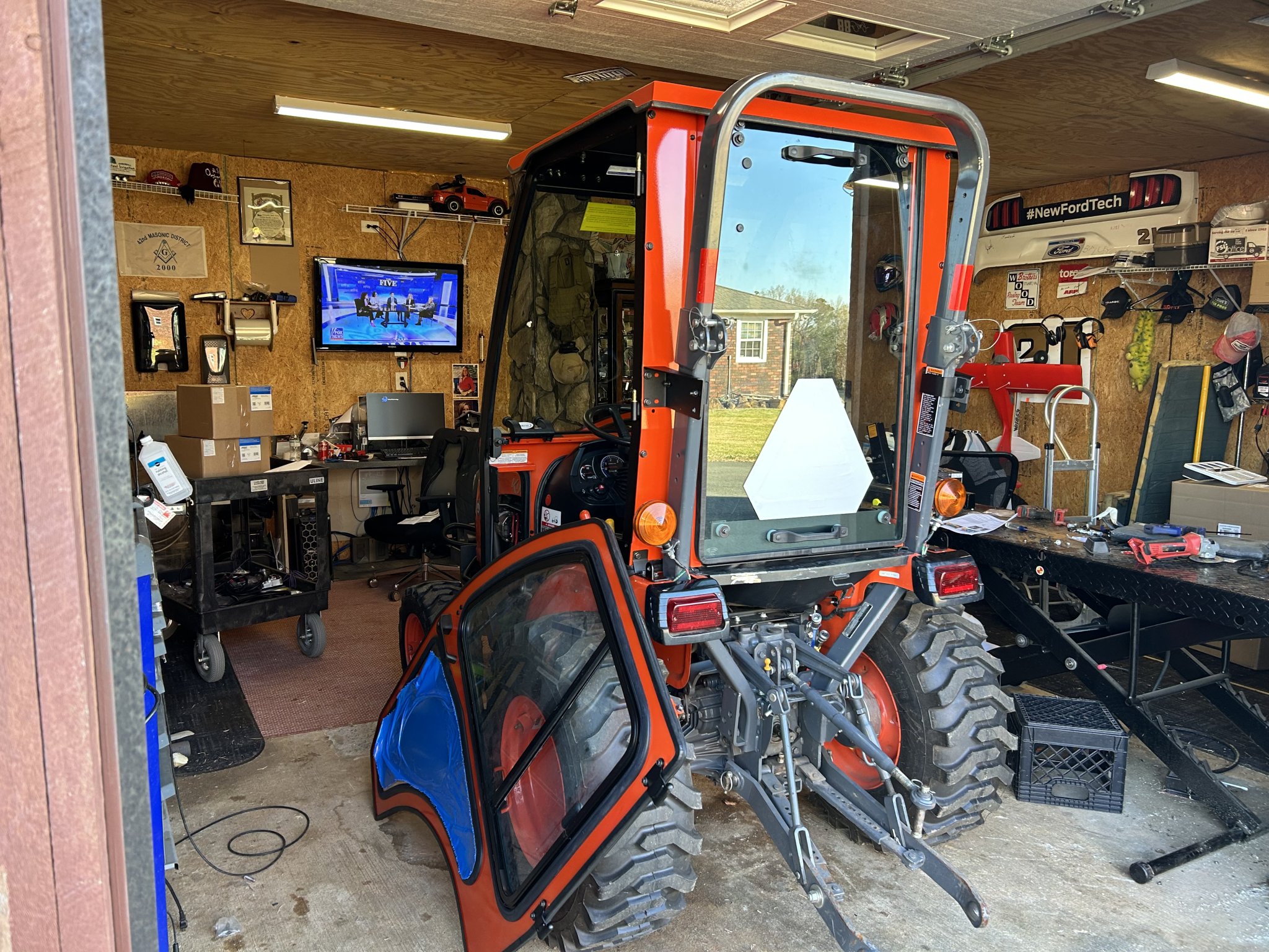

Well , yesterday I’m picked up my cab so the next few days I will be getting it installed into my tractor and then the ac.

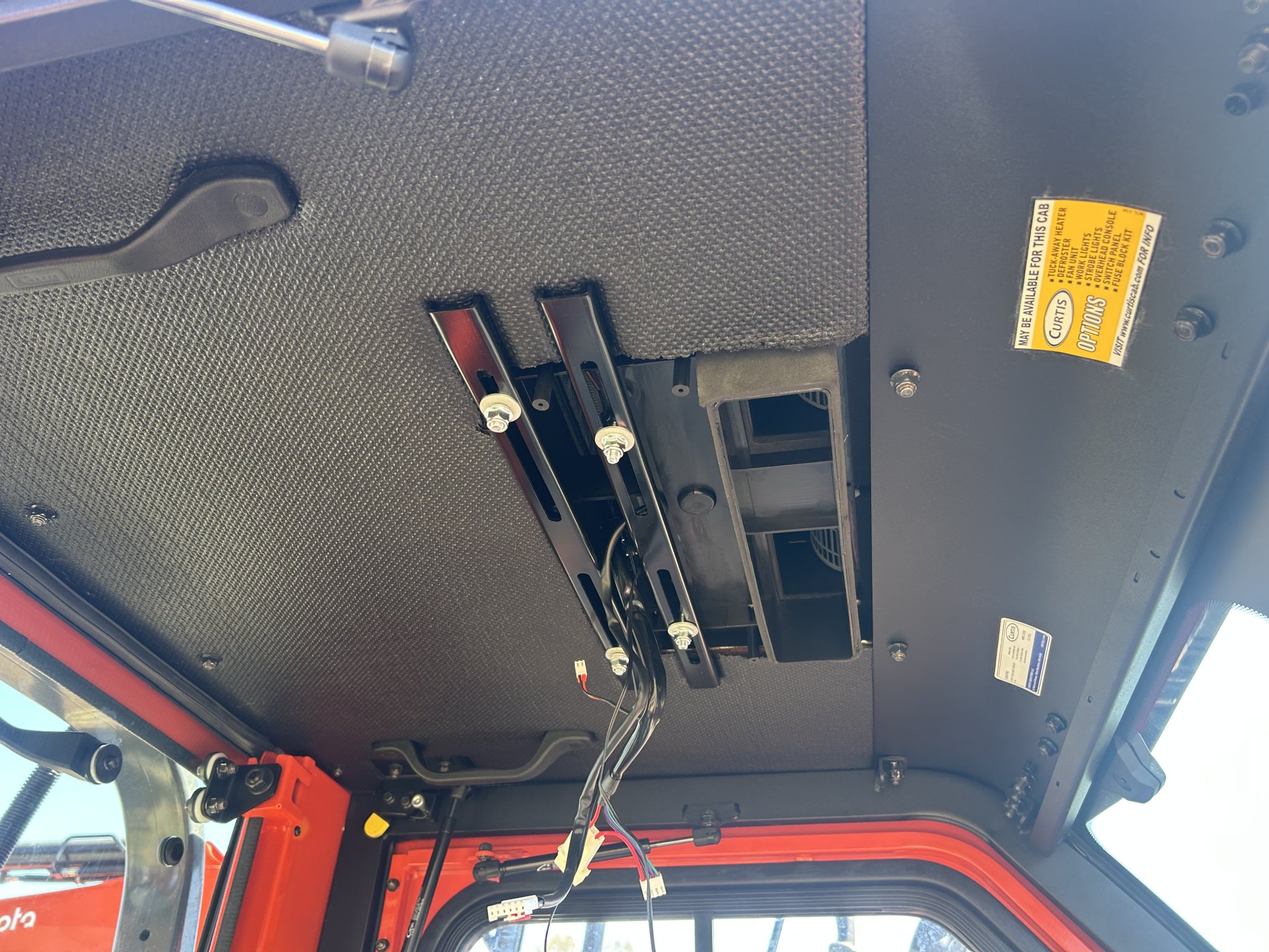

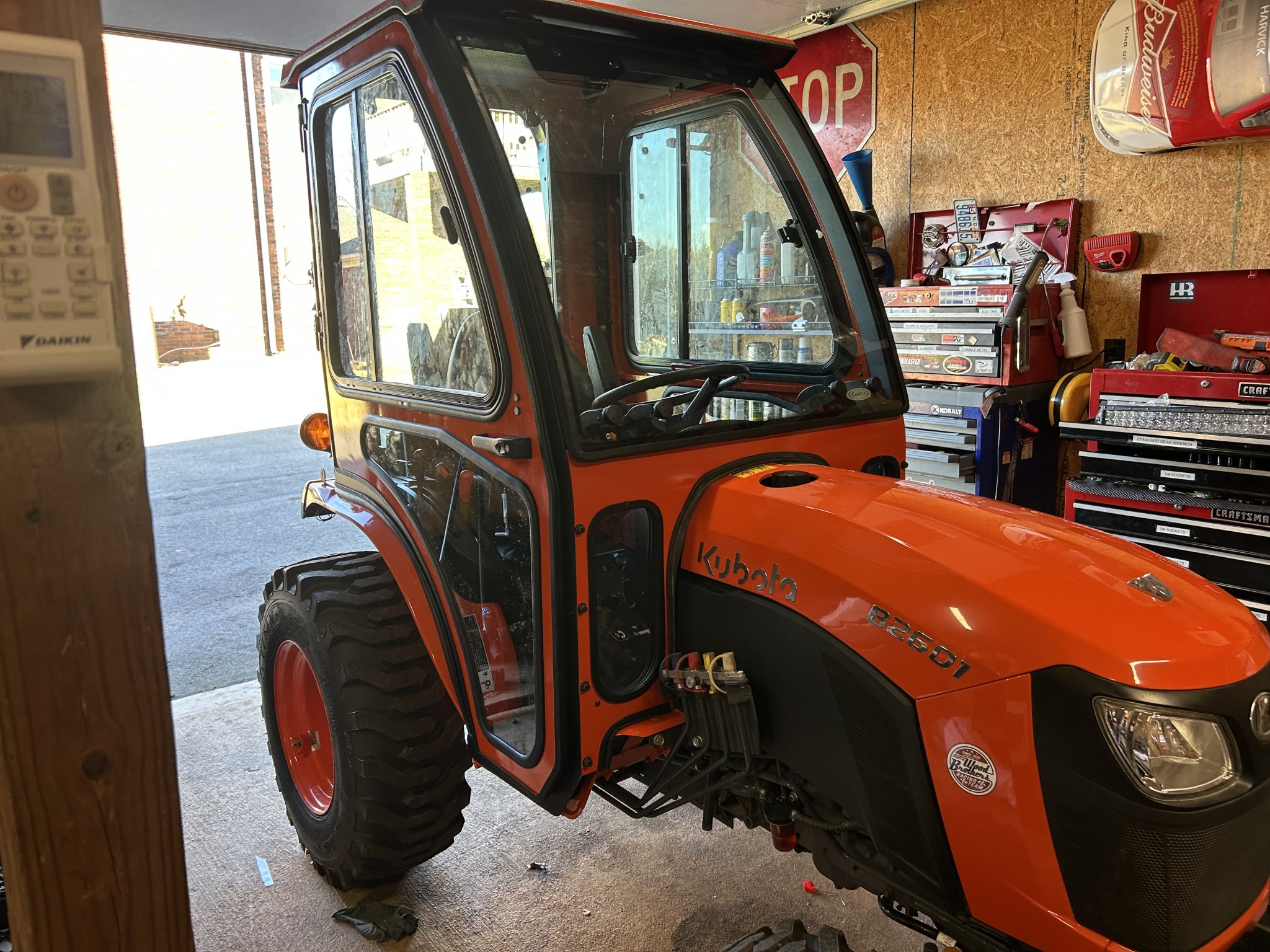

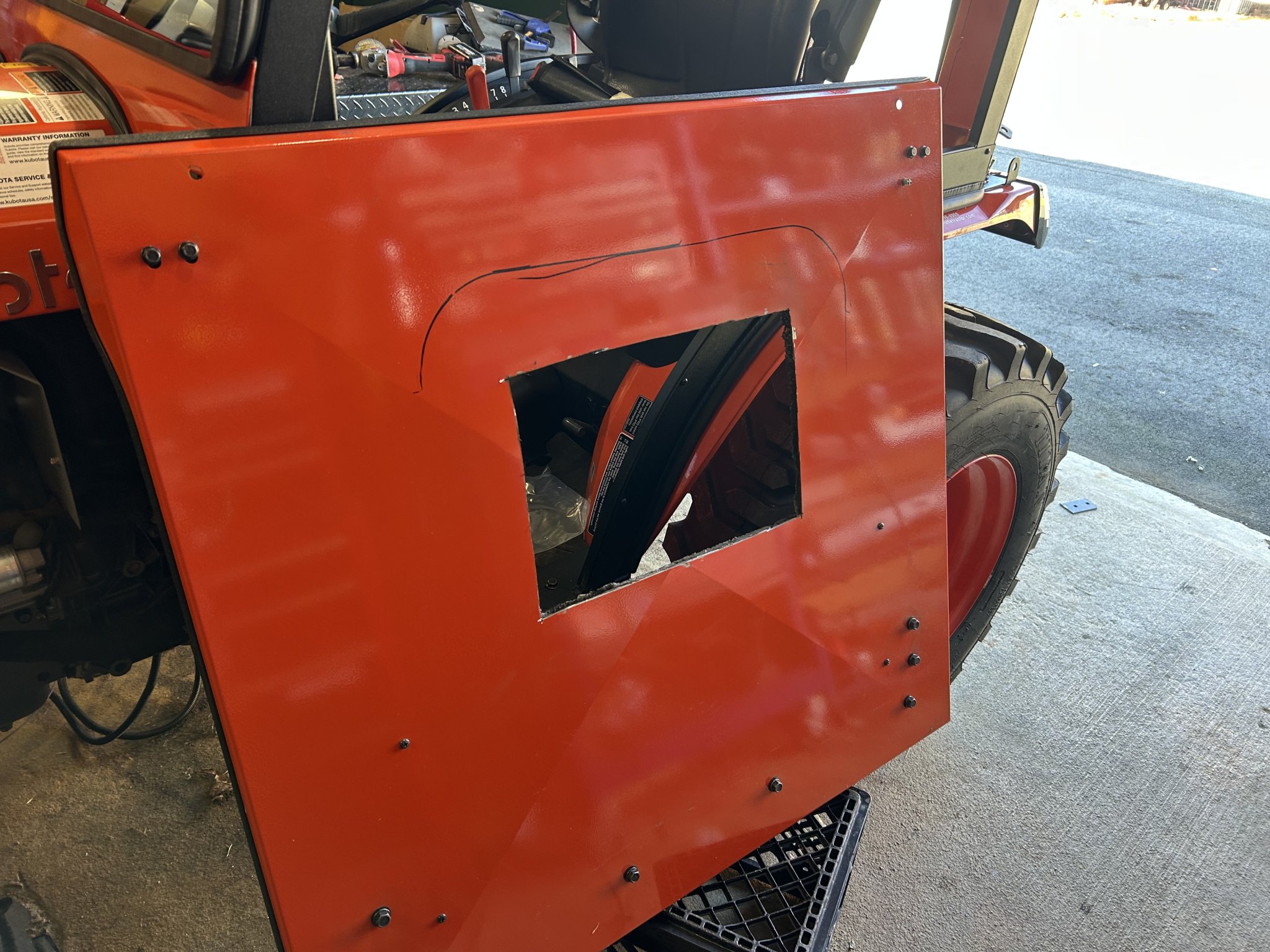

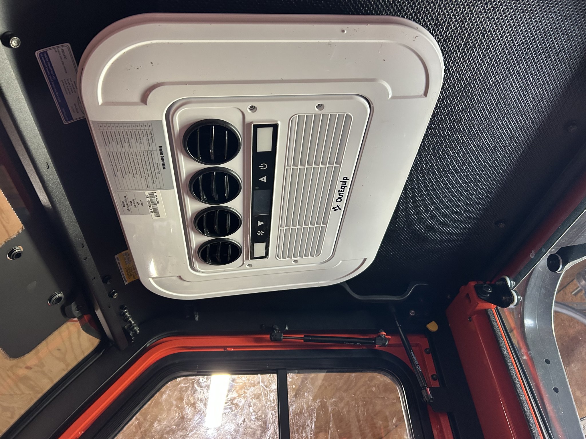

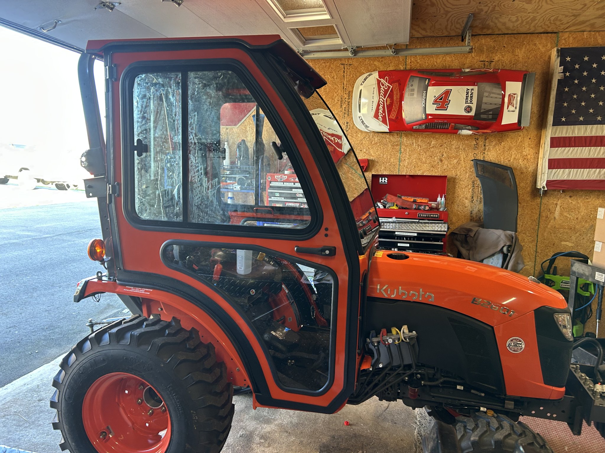

I got the cab installed on my b2601 today. It took me about 4 hrs. Tomorrow I will put the ac unit on the roof and see what happens. I already cut the hole in the top.

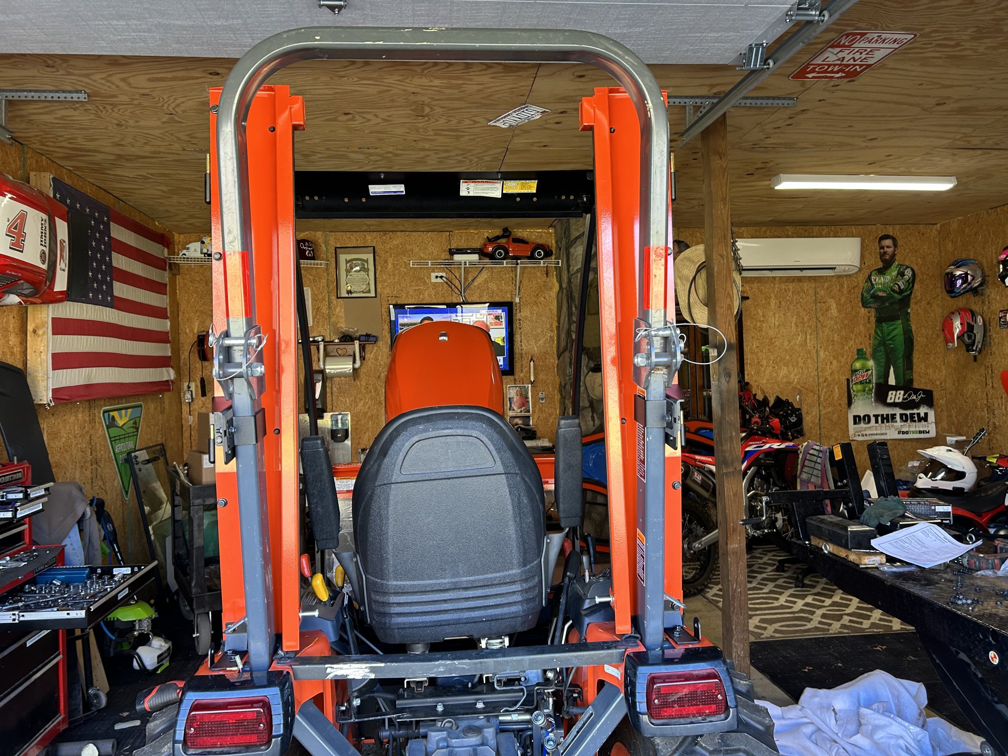

That's some rapid progress. You'll appreciate the real glass instead of plastic.
How does the area under the seat get closed off? When I built a cab I cut a cow mat to fit. It worked well, but was a wrestling match to get it into place.

nice , have to ask the $23K question.... can you get tractor in/out of garage with the AC unit on top ??
also ,please remove drill BEFORE you drive tractor too far !!

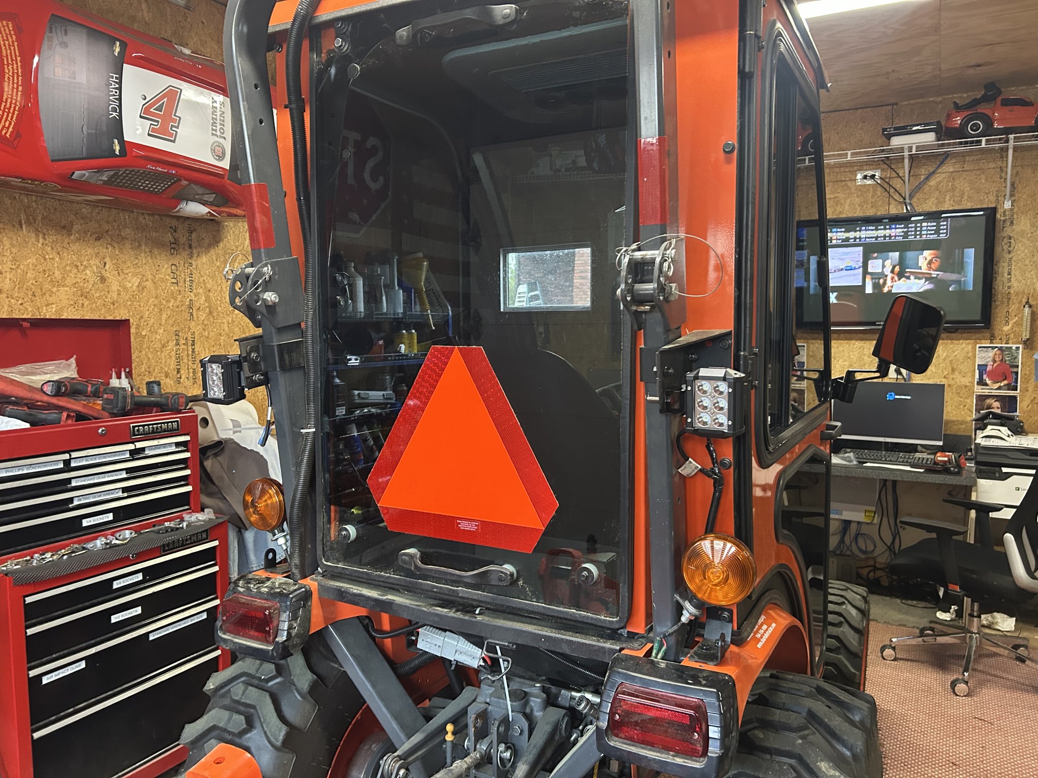

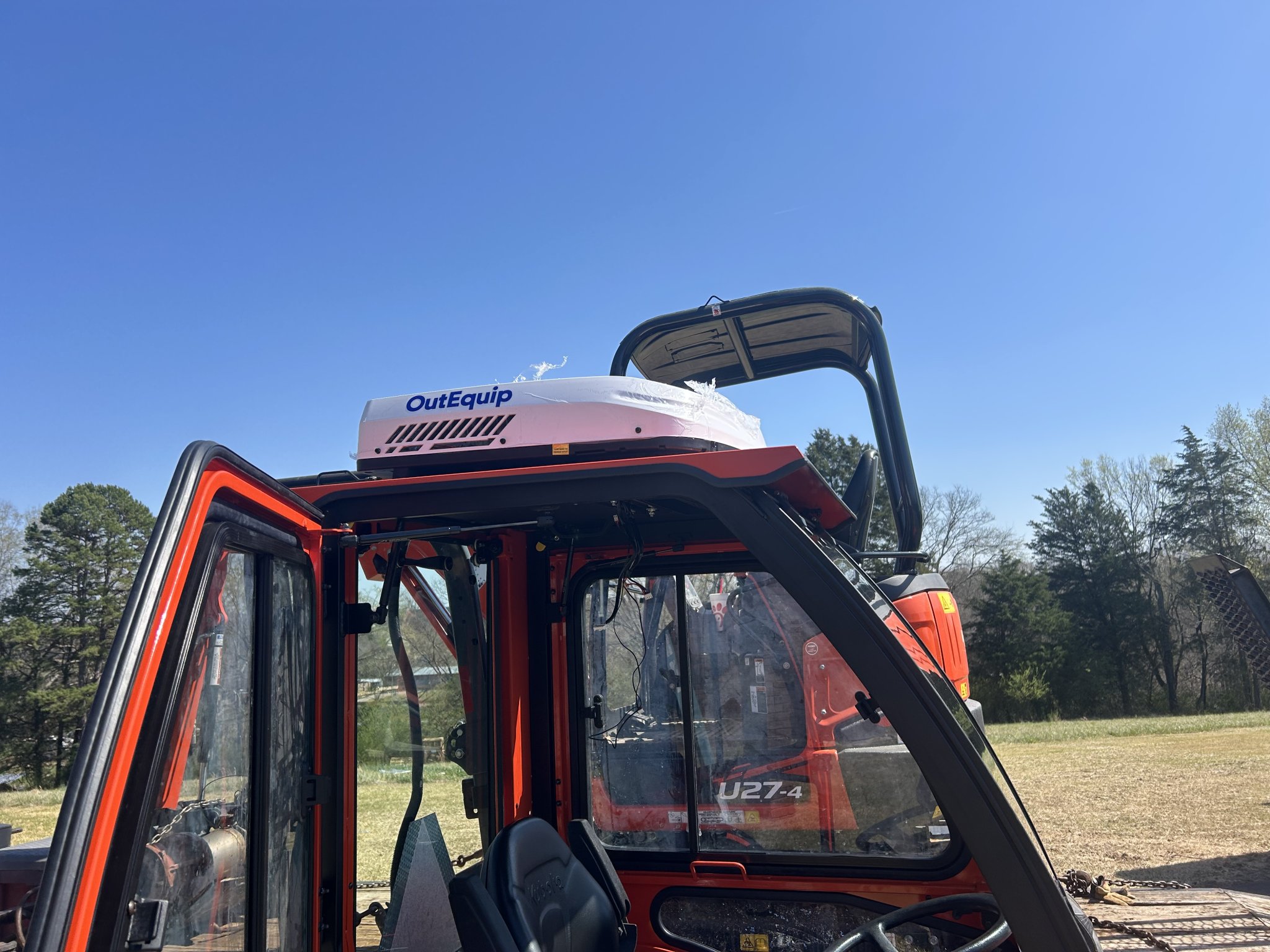

I guess I found the drill , I used it to put my mirror on just now. Had to work this morning to pay for my crazy ideas but I finished the ac project for now. I didn’t install the windshield wiper so I didn’t run the wiring for that. I may put a Rigid Light bar on top later. I sold one of my John Deere front mowers and Tuesday I’m going to pick up a Landpride 1660 finish mower and I will be all set. The cab really amplifies the engine and transmission sounds so I guess I will wear my stereo headphones. The ac works great, it should since it’s made for a big RV and I’m cooling half a phone booth. The cab kit comes with a vinyl piece that velcros around the fenders and back window to block off that area. I will report back after I mow during a hot day . The cab cost me $5800 , mirrors were $168 and ac/heat unit was $900. Like I said before , no wife , no kids , no payments and I own a plumbing company so I can piss away money on my projects with out regard. lol.

That's a nice rig. I'm happy for you that the A/C works well, but admit to being a bit surprised that it does.
The noise in my homebrew cab was a bit much as well. Earplugs or headphones were helpful. With the vibration isolation applications I'm familiar with through work - it is entirely to be expected. Add-on cabs lack the proper mounting to prevent the noise transmission. Some people have the idea it's as simple as bolting the cab in place using hockey pucks for spacers/isolators not realizing the bolt just eliminated and isolation value and now they sit inside a "speaker enclosure" anyway.

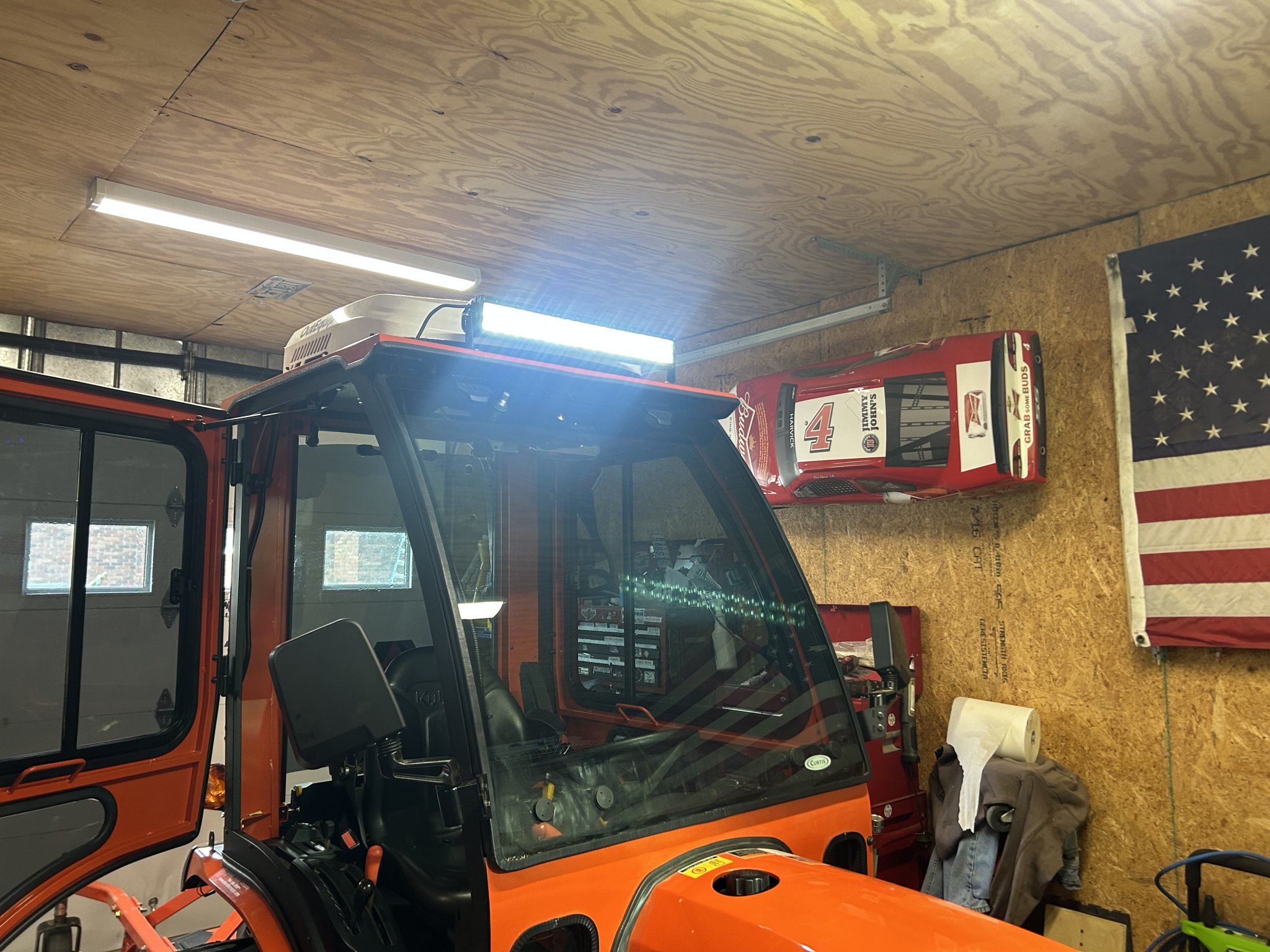

I sold one of my front mount jd mowers to help fund my project and picked up a yr old Landpride fdr1660 finish mower yesterday and completed my project. I serviced the mower and set it on 1” to mow a couple acres of zosia turf today. Everything worked fine. Maybe tint the windows next

I had tinted (factory privacy) door windows on my F150 for 27 years. Finally replaced them last summer with clear glass as it was a royal PITA driving it from dusk to dawn. After a few 'night trips' , you may want to consider 'side' lighting.
Still impressed it drives in and out ! Curious as to how much clearance do you have ?
About 4 inches. That’s just my little shop , office , man cave. The tractor usually parks in the barn.
