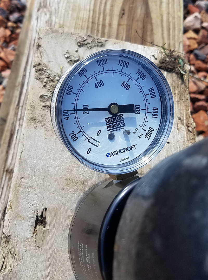

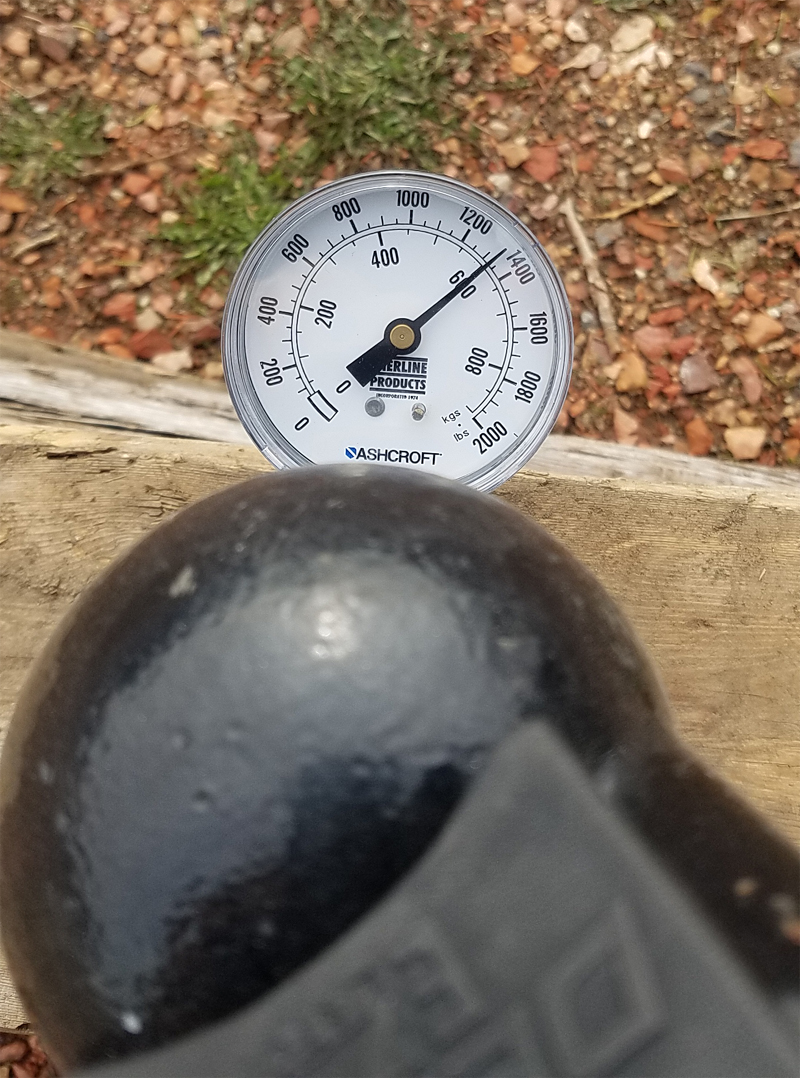

I have a 1000 and a 2000 Sherline to eliminate guessing.
7,122
9,757
Before I set off on a 600 mile trip pulling the M6060 from Sheridan, WY back home, I measured the tongue weight (~450lb) of the unloaded MidSota trailer (3,360lb) and found that it was 13.4% of the total weight. I knew the weight of the trailer plus the M6060 was 10,720lb because I stopped on a scale in Sheridan. I had to move the tractor a few times to get the tongue weight where I wanted it which was around 1,300lb. The truck with gear, trailer and tractor was a little over 19,000lb.

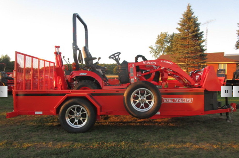

Anyone have experience with the Kubota K-Haul series of trailers? My ATV trailer is too light by about 750 lbs, local marketplace crap is extremely overpriced for any used or u-built junk, but my local Kubota dealer has a '22 K-Haul KHU12-3.5, brand new, for what looks like a reasonable (in 2024 CDn dollars) of $4300. It appears my Bx23S would just fit, with bucket over the front and the Bh swung to the side. No apparent room for any other implements. I'm waiting on a price from them for a 14' K-Haul dumper as well. I'm contemplating starting up a "tractor services for hire" side gig. Pic from some dealers combo package ad. Towing with a Tacoma (6400 lbs max) , or my old 80 series diesel Land Cruiser which is rated for 3500 kg, but sure wouldnt want to see any hills.
This trailer will get really small, really fast in my opinion, but if your going with that size, definitely get the "dumper".
I have used my Sherline scale a decent amount. Once I figured out where to place stuff in the toy hauler to achieve 1,700 lbs on the tongue, I just kept loading it the same way every time. I'll check it if a add more bikes or "stuff" just to be safe.

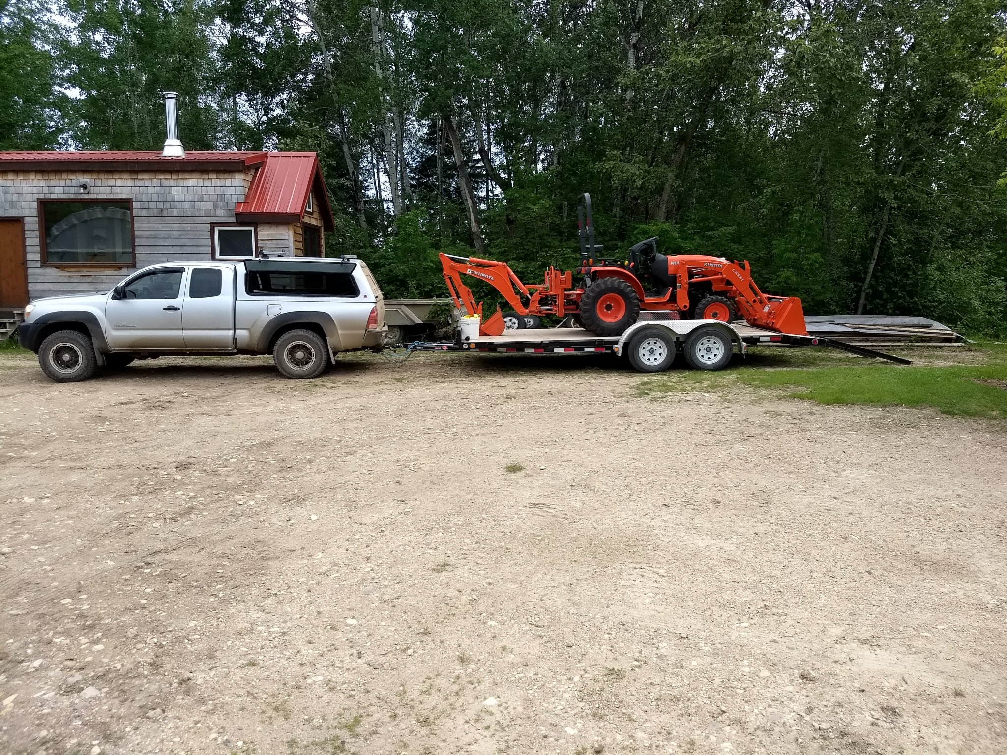

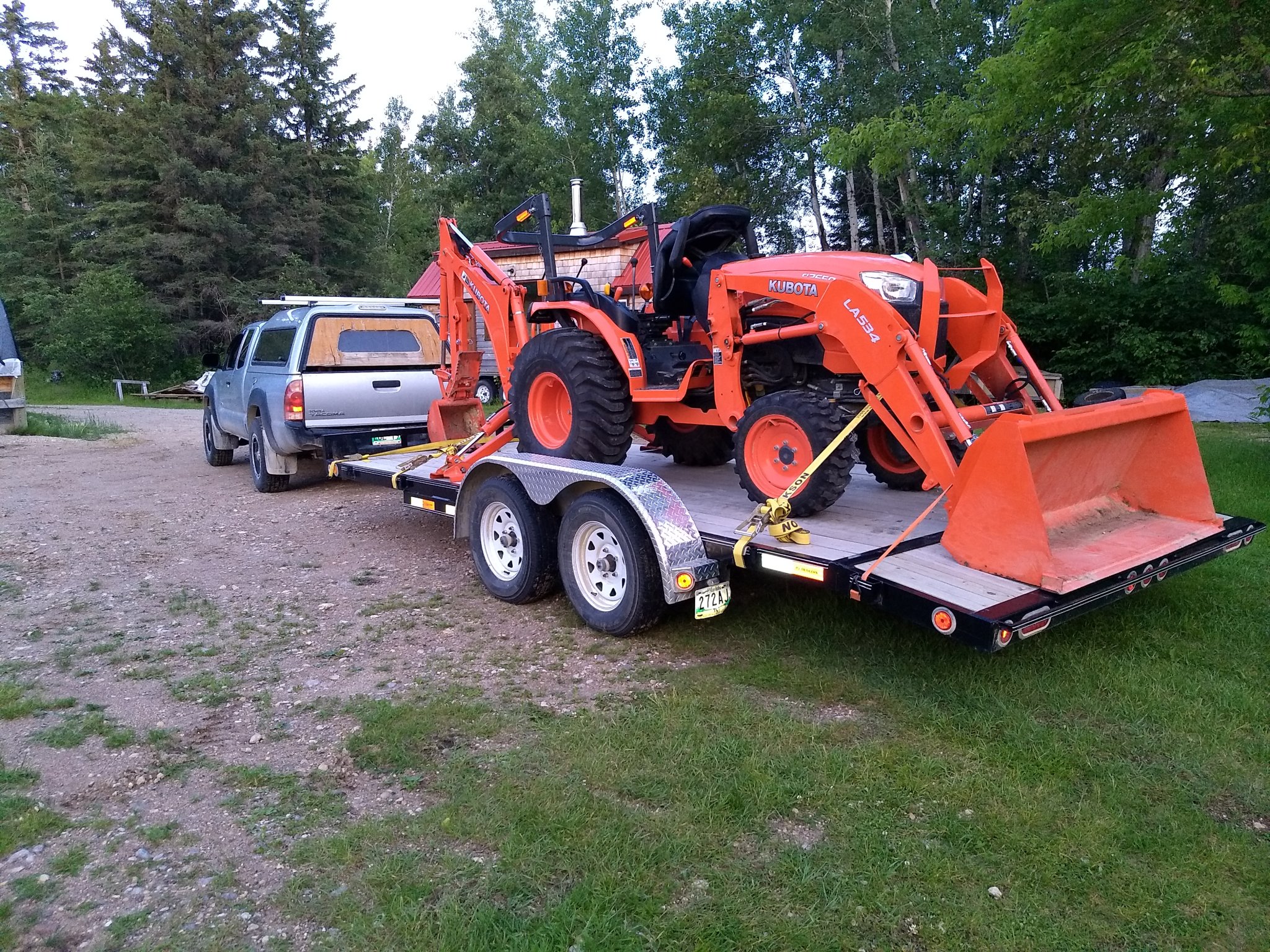

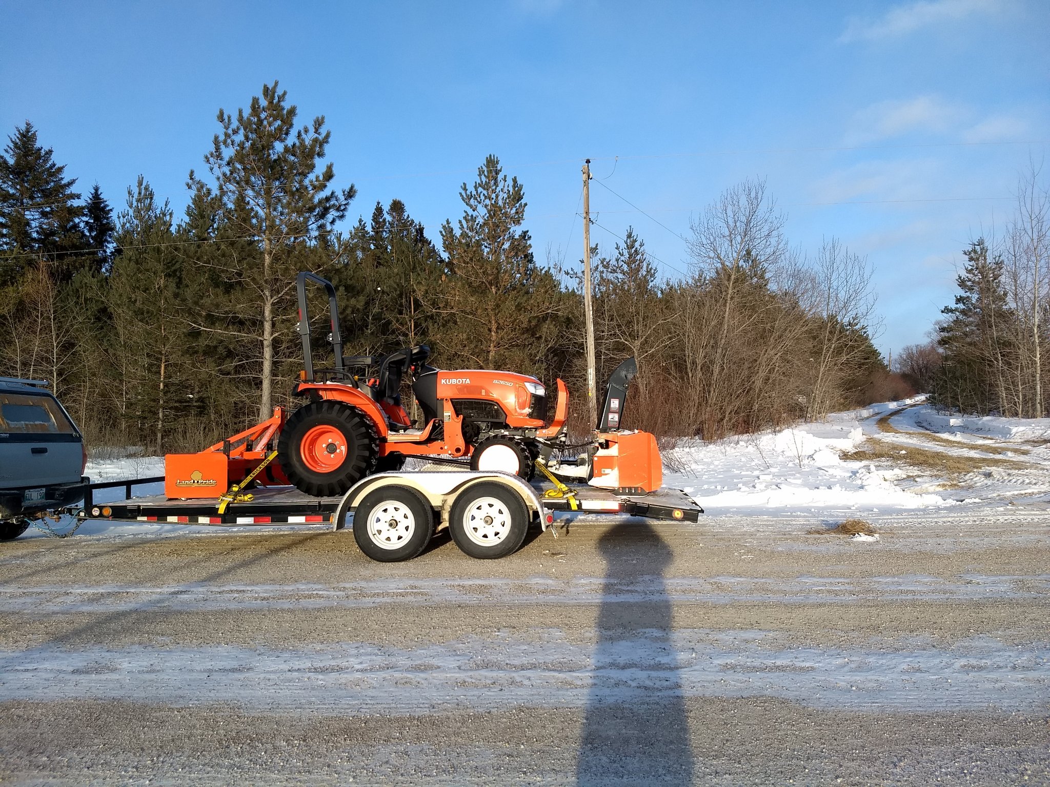

My 18' PJ car hauler dual axle 7500lb gvw with beaver tail can hold my B2650 with BH77 backhoe and FEL all attached, with backhoe pointing straight back, no need to turn it sideways. What's with this supposed 22ft trailer, smaller BH and tractor, and way less room than my 18ft unit?
I also haul using my '06 4L Tacoma 4x4, runs the rig great.
I'll post a couple of pics of the setup here again. The trailer cost me about $3500 7 years ago. The sales rep at PJ Winnipeg was great!!
I painted marks on my deck for proper locations.
7,122
9,757
That's the way to do it when you haul the same load time after time.
