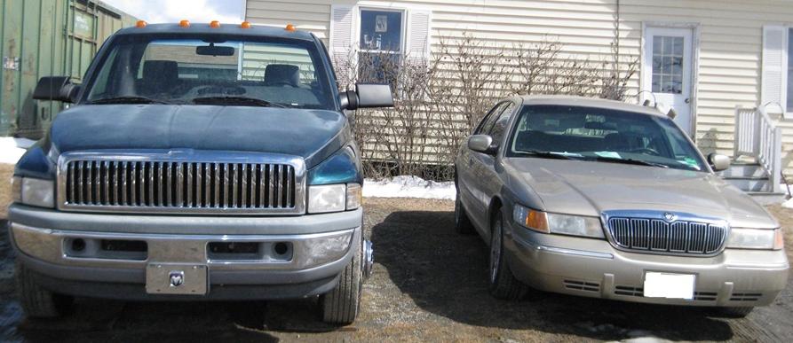

hmm.. I though all trucks made today are 4wd, 4 door pickups with 4' boxes on them.....
I KNOW there are ZERO 2022-3 reg cab, short box ,2wd,V8 F-150s in Ontario
Maybe that is why my rigs are older?
I went to rust free Florida to get both of these. My rig has a 154.7" wheelbase and is 244.1" long. It is only a 2 door club cab and has yet to be used in winter.
Since then I got a newer car but it is the same model just newer.
I did add some better mirrors to see past the big hips.

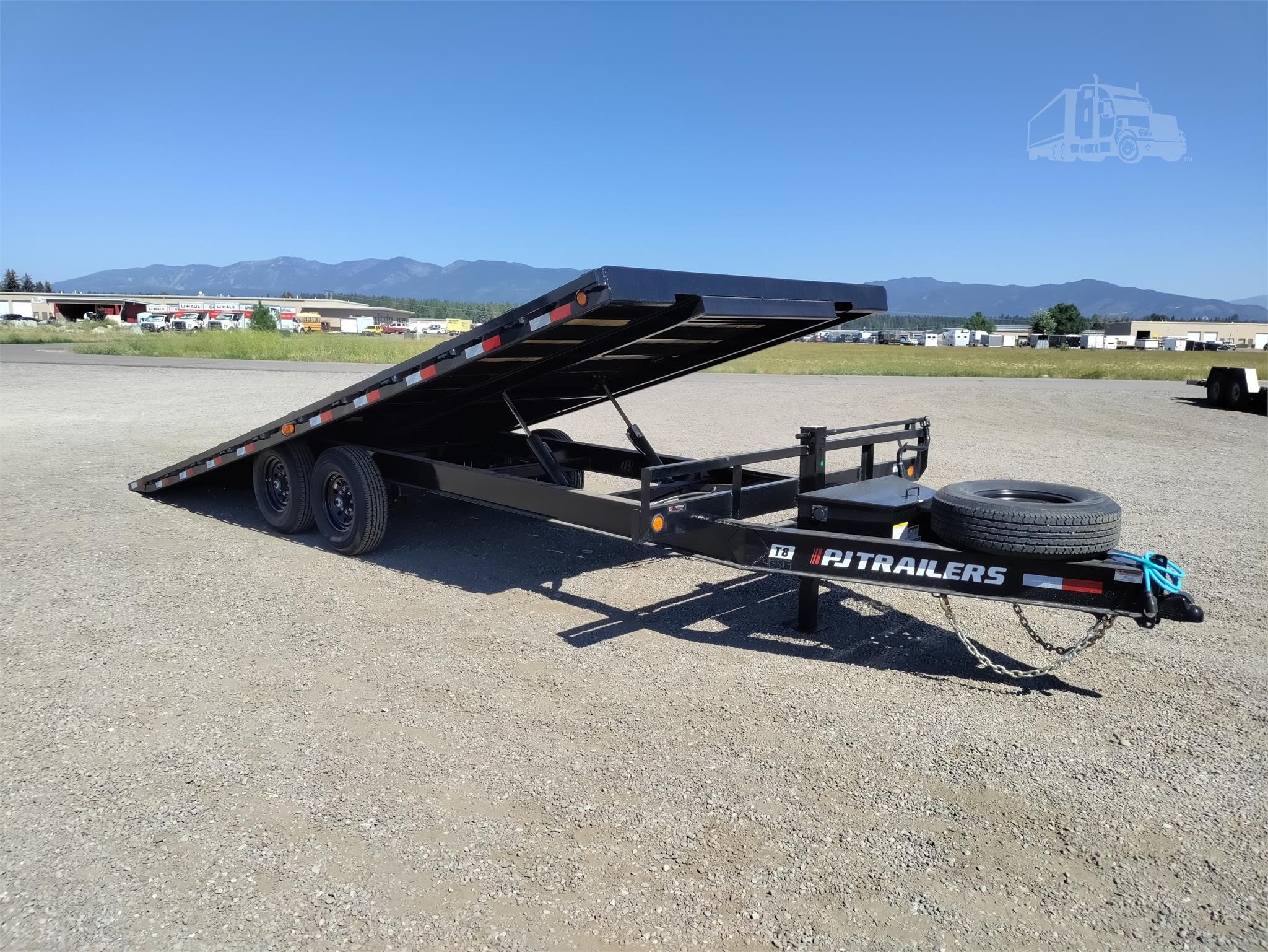

So true. :cautious: When I bought a 22ft MidSota equipment trailer (15k GVWR) two years ago I figured I was done buying trailers. Nope! I like that MidSota but tomorrow I'm looking at a PJ 22ft deckover hydraulic tilt trailer. I really hope this is it for trailers.
Do you want to sell your trailer? If so, shoot me a PM
7,131
9,769
Right now, today, I'm thinking of keeping it because it'd be near impossible to replace the MidSota for what I paid for it and it's a really good trailer. I committed to purchasing a PJ 22ft deckover and it's possible that after using a tilting trailer I'll never want to go back to one with ramps. If that happens I'll PM you.

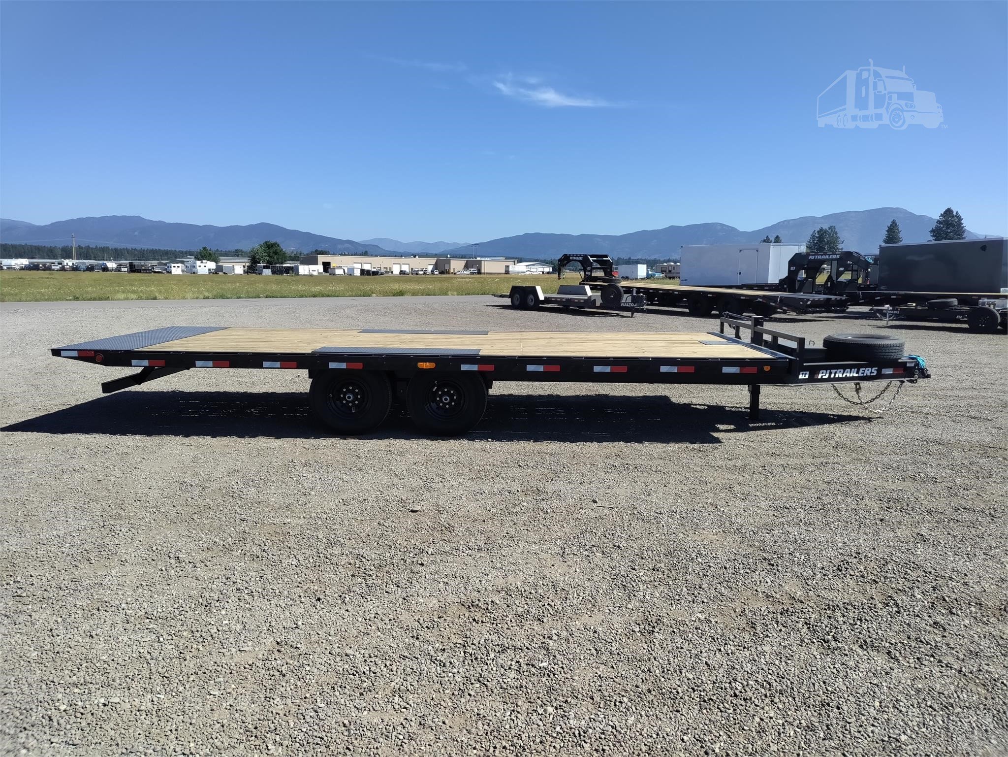

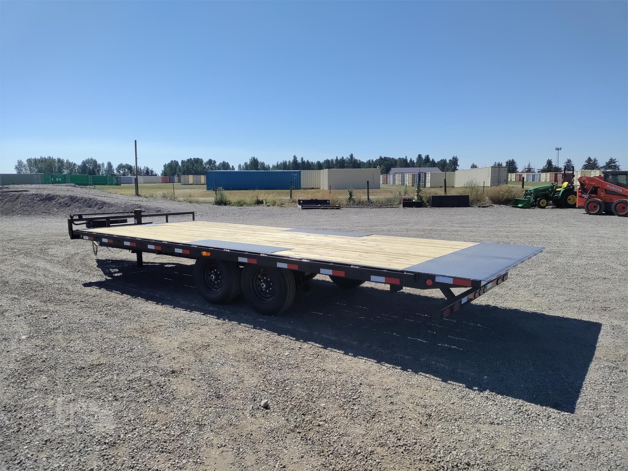

This is what I'm going to pick up. The deck height is 32" and the trailer weight is around 4,200lb. GVWR is more than enough to handle what I need.

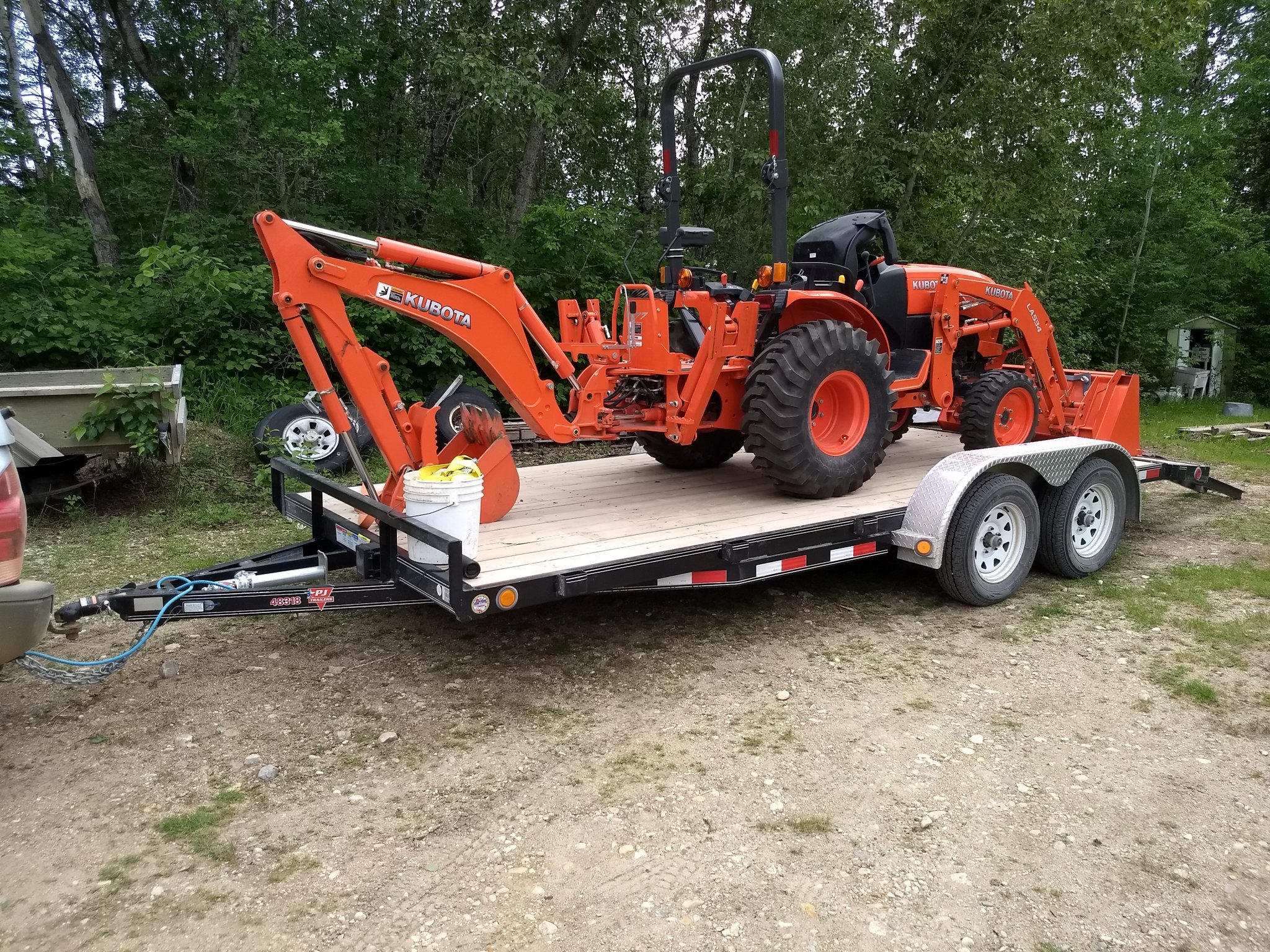

Hello. What type of trailer would you recommend for moving B2601 with some attachments? I see equipment, car and utility trailers. Thank you
My PJ 18' car hauler 7K dual axle with beavertail handles my B2650 with loader and backhoe attached without a problem.

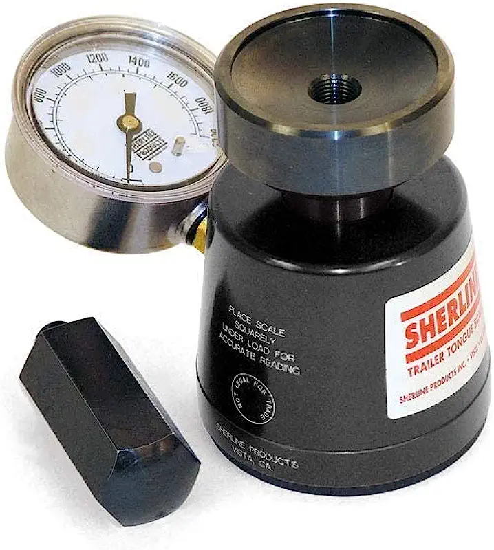

I have a tongue weight scale that I bought from a member here and it's amazing how much tongue weight can change even moving the load 6 inches forwards or backwards. At the end of the day, if you haven't visited a scale and measured tongue weight it's just guessing i.e. feel of the pants. Add liquid ballast, a FEL/bucket, wheel weights etc. and it's all guess work without actual data.

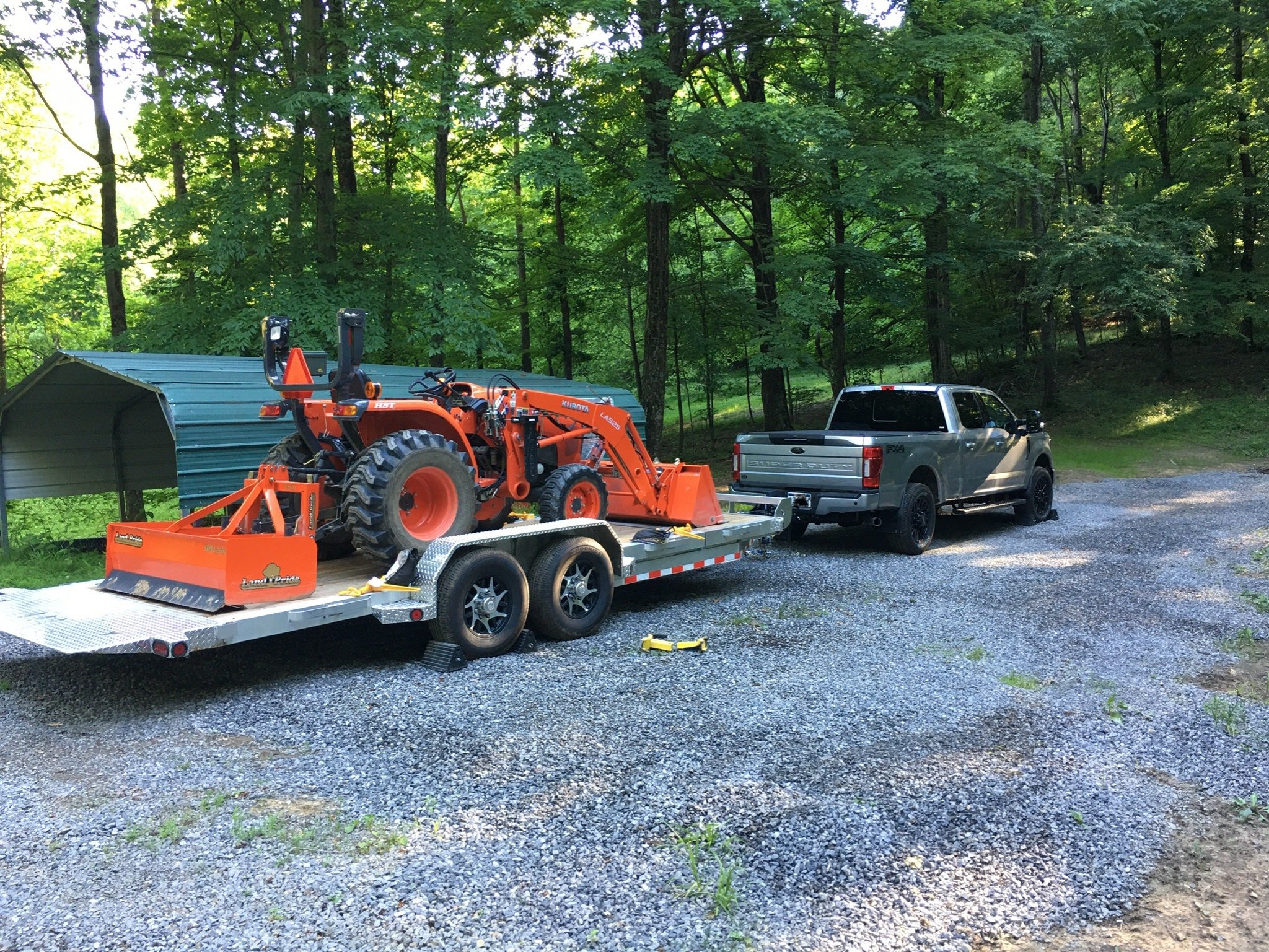

With a bad back, shoulders, and new knees, I’m personally a big fan of tilt trailers.
This is a 20’ 14K Aluminum Gravity Tilt:
If you go too short, you don’t have much wiggle room for positioning to get the tongue weight right.

How do you MEASURE your tongue weight?
You should have 10-15% of the loaded trailer weight on the tongue.
The eyeball (guesstimate) method is really not satisfactory.

I’m using a hitch ball setup that has a scale built in it, and aim for about 10-15% of the total weight of the trailer itself (2500#) and contents (varies). Doing so makes it much easier to drive (safer too, obviously).
I've seen those setups and they look awesome. (y)
7,131
9,769
Drive at 55MPH and if you get scared or crash move tractor forward or backwards as needed. :eek: Ok, being serious I use a weight distributing hitch as it seems like this helps with poor load placement(please tell me if I am wrong) and have a level gauge on the fender. I also only load on level ground(or load then slowly move to level ground). If I drive and it feels unsafe I will move load. Also some sharpie marks on trailer for various tractors/implements. When I have a hundred bucks laying around this is in the future.
That's the model I have. I bought if from a member here for $75 and it seems to work well.
