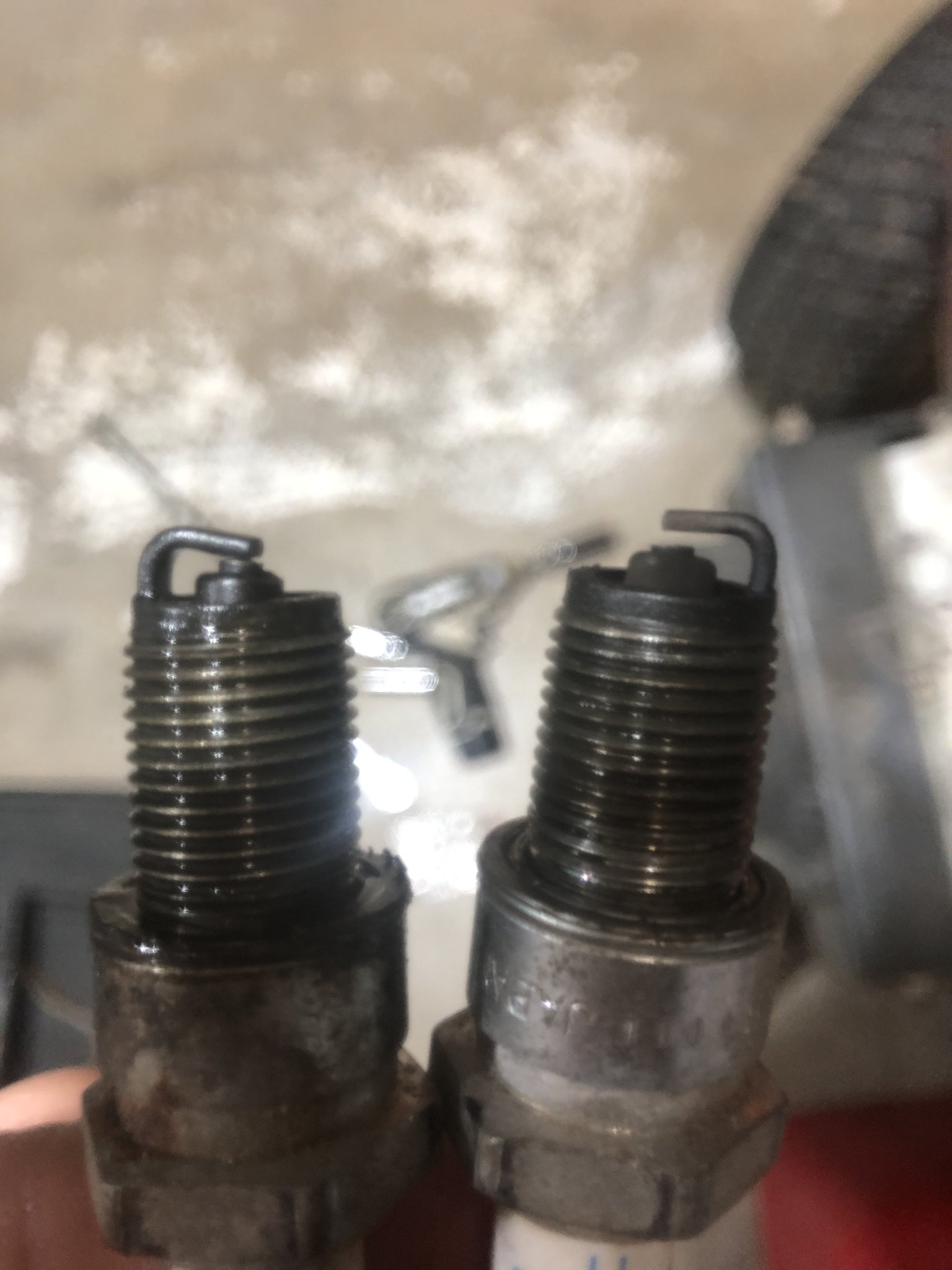

needle nose pliers, bend it open to make about a 50 though gap
if that IS the way it was, engine only running on 1 cylinder ! maybe a pop or two from the left, MAYBE

Just checked right now! You might be right. View attachment 145131
This could be an issue I oversighted. Is there a way to fix the bend?
Wow! That certainly has to be your problem. That happens when it is dropped on the floor. There is a tool for straightening these, but pliers will also work. You should use a gauge to set these at the correct gap.
I fixed the bend and used my feeler gauge to bend them to spec. Fixed much of the idle uncertainty but I still am missing 1000 RPM that it usually has at high idle.

I think those plugs are wrong. Those are long reach plugs and IIRC these engines require the shorter reach plugs. If you're using the long plugs in there where the short plug should be, the pistons will smack the ground strap and close the gap up exactly as I saw in the picture. I have done this in the past.
Isn't that an FD590V engine? I'm 90% positive that those all used the BMR4A (or BMR2A) spark plugs which are half the reach/length of the BPR*ES plugs that I saw in the pics. But that leaves 10% chance of me being wrong....
I wouldn't deny your idea since I didn't drop the plugs for sure. But when I check the Kawasaki FD590V specifications, it claims its the NGK BPR4ES.
Decided to take the spark plug confusion to the parts diagrams and I got that it’s a BPMR6A or something like that. I bought them and they seem to work fine. I do have a vacuum leak right now though because I broke the intake pipe boot to the carb, but that’s already on the way.
