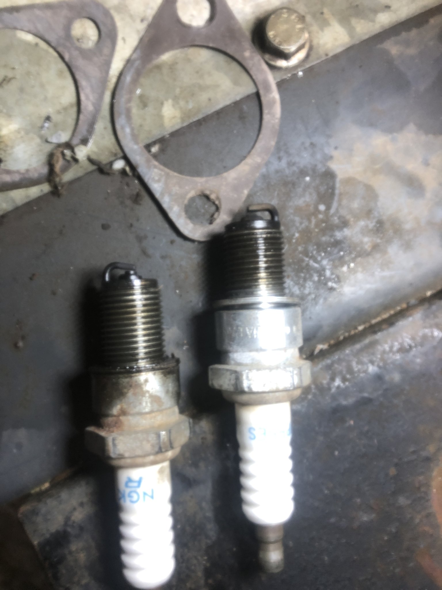

I adjusted the valves but I am considering opening them back up in case I mis-adjusted them. Spark plugs could be in better shape and are technically the wrong ones (BPR5ES but specs say BPR4ES) but they fit and provide consistent adequate spark I would imagine.

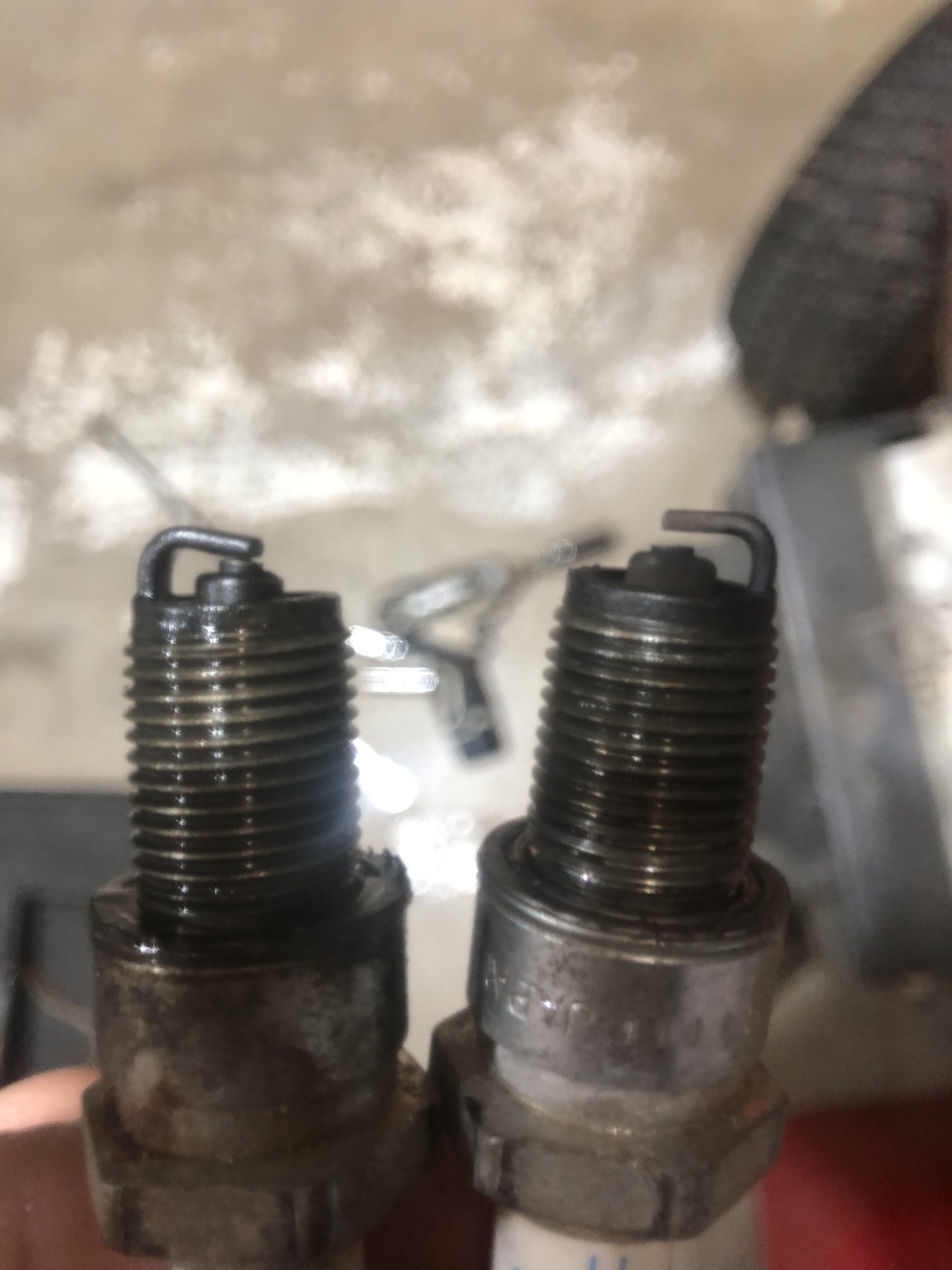

is it just my blind eye or does that LH spark plug look like the gap is closed up?
I thought these things used BMR4A plugs, which are a lot shorter reach? Maybe I'm thinking of something else.
Just checked right now! You might be right.
This could be an issue I oversighted. Is there a way to fix the bend?
