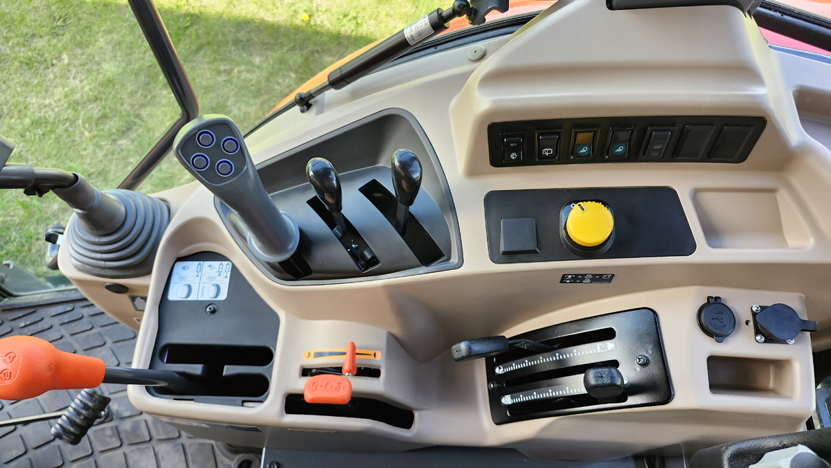

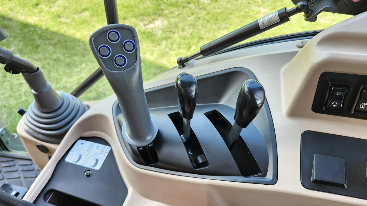

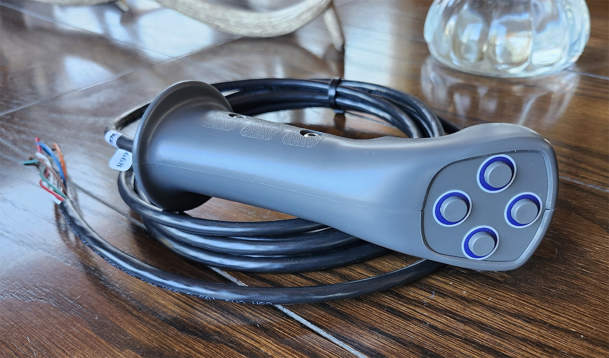

I was slow to catch on, but @MtnViewRanch made the point that I could operate all four cylinders on one implement using one lever in the cab and a control grip from Scorpion Technologies or similar. Last November I ordered a Scorpion X Series grip with four momentary buttons in a diamond pattern to make it easy to remember which button controls which cylinder when running the rear blade. Basically, you hold down a button (momentary) to allow oil to flow through one pair of outlets, and then move the lever to control a cylinder or motor connected to those outlets. Summit Hydraulics provides switch boxes or rocker switches that allow the lever to control multiple cylinders at the same time, but that's a not a function that I need or want, so momentary switches works for me.

When I spoke with the salesman at Scorpion Technologies this afternoon I asked if he knew whether or not the solenoids that were coming with the multipliers had diodes in them. He didn't know so I called Summit this afternoon and the person I spoke with wasn't sure either, but assured me that he'd find out and send me an email once he knew. As I was going down another rabbit hole doing my own research re the solenoids, I received an email from Summit stating that the Hydraforce SV10-41 solenoids do in fact have Zener diodes in them to protect the buttons used to control them. Phew! Good news and great service from Summit and Scorpion both. I sent and email to Scorpion Technologies informing them of this since they regularly get calls from customers asking about Summit Hydraulics and Scorpion control grips.

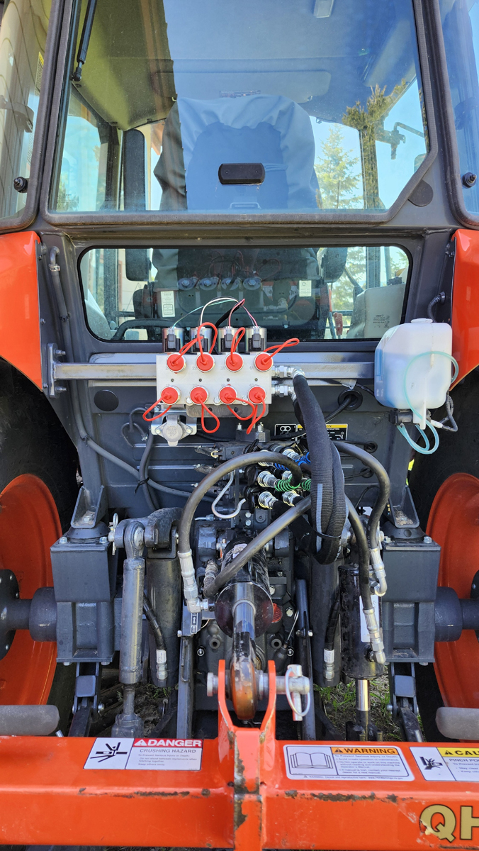

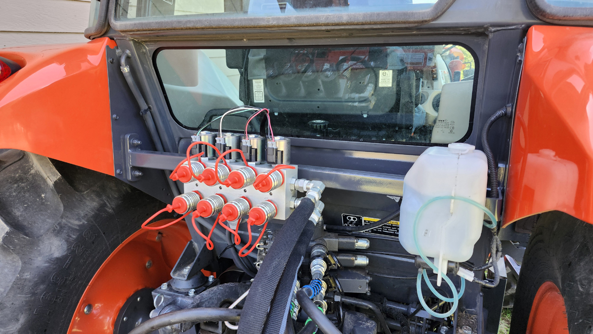

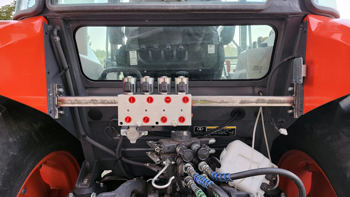

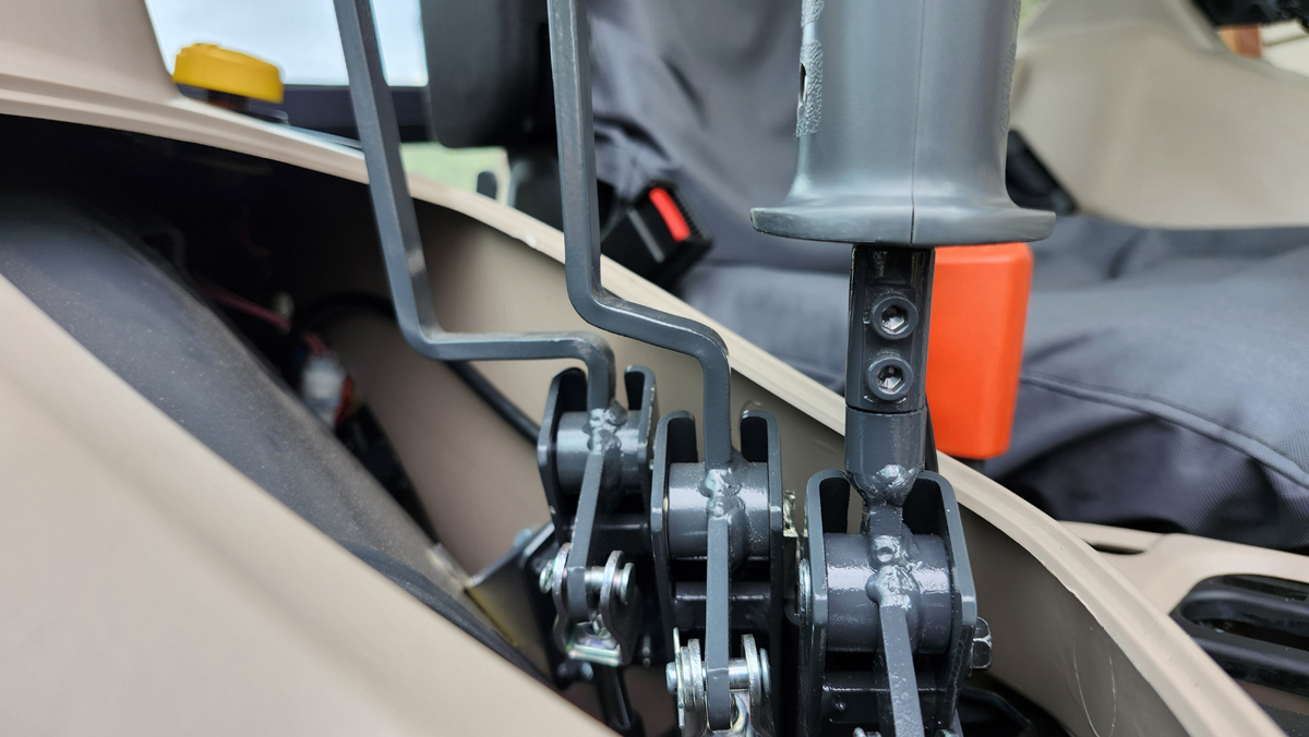

I'm looking forward to making up custom brackets to bolt these chunks of aluminum to the rear of both tractors. Here are the pieces of this puzzle to be installed in the Spring. I'll update this thread as I accompish various parts of the installation such as the mounting brackets, modifications to the levers in the cab to accept the control grips, hoses to run from one set of remotes to the valve body, wiring, testing,etc.

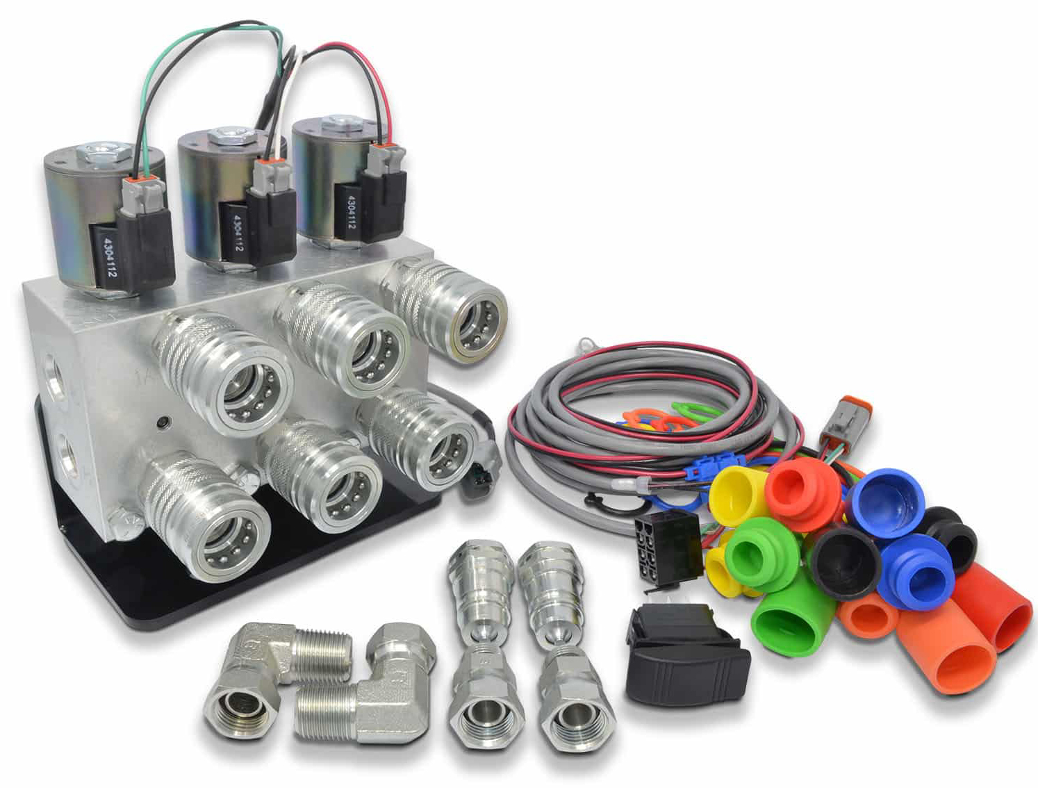

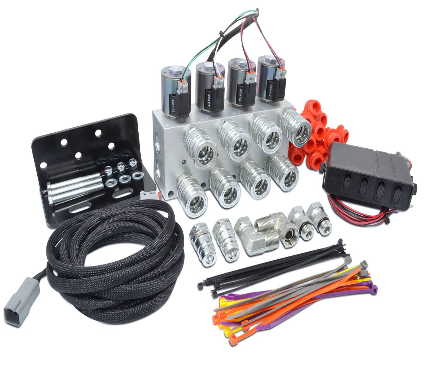

Summit Hydraulics 3 circuit and 4 circuit hydraulic multipliers.
Scorpion Technologies X Series and S Series control grips.

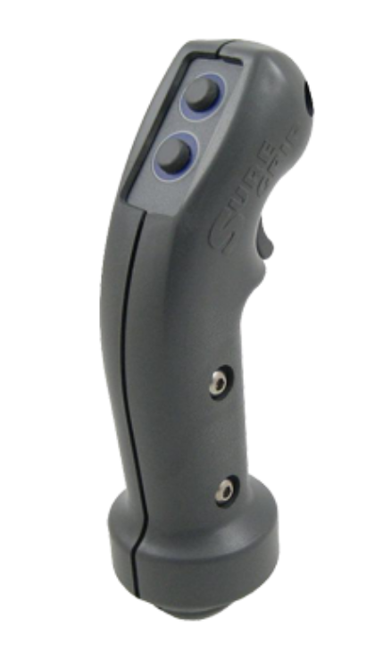

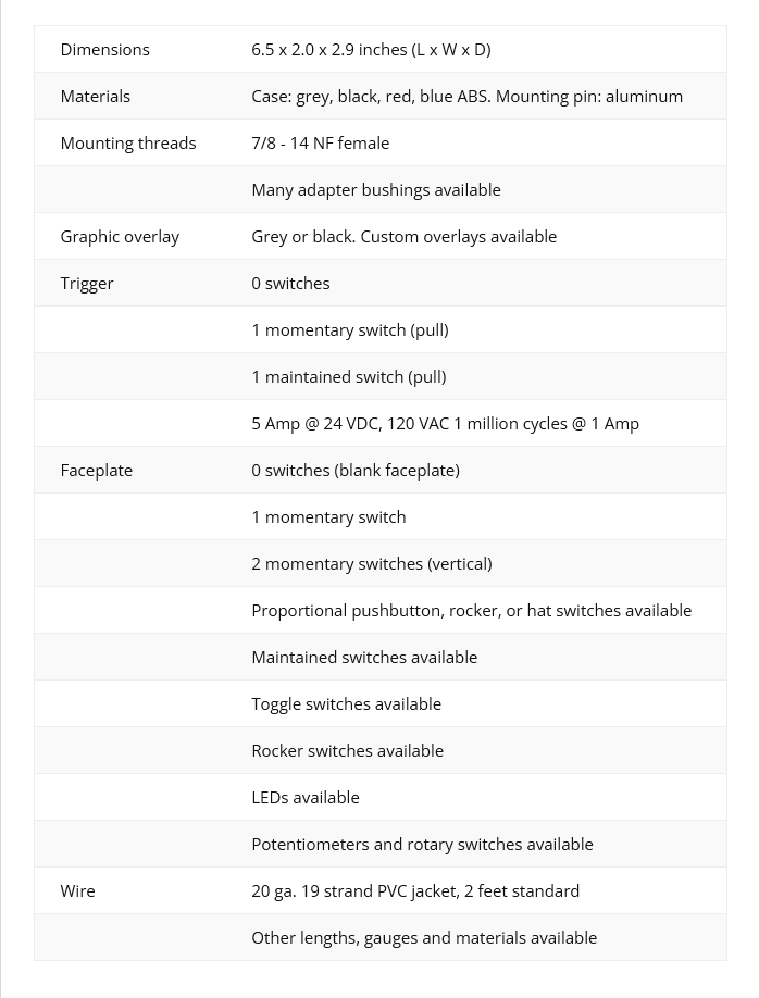

Thanks for posting! I've been looking for one of these clamshell joysticks to convert my BH thumb actuator from mechanical to electric. Do you have a part number for this?
