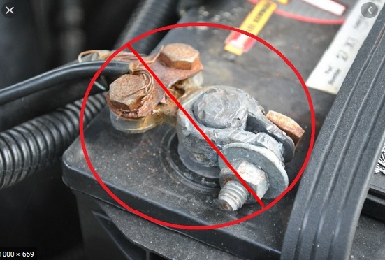

Before deciding to pull the starter off and then apart, how about a thorough review of the most basic things.
Battery cables and their connections at each end of the two cables. A poor connection (such as the ground cable connection to the tractor) can produce a hot connection with a strong smell while not being able to pass enough current to turn the starter over.
Do you have any battery cable repair ends at the battery end of either + or - cables? These are often another source of high resistance connections.
I would avoid the hammer test on more modern starters as many have ceramic magnets inside which can easily be shattered.
If you have a multi meter and can follow well laid out test procedures, this one from DENSO for starter/battery circuits will quickly show you where the high resistance/voltage drop is occurring.

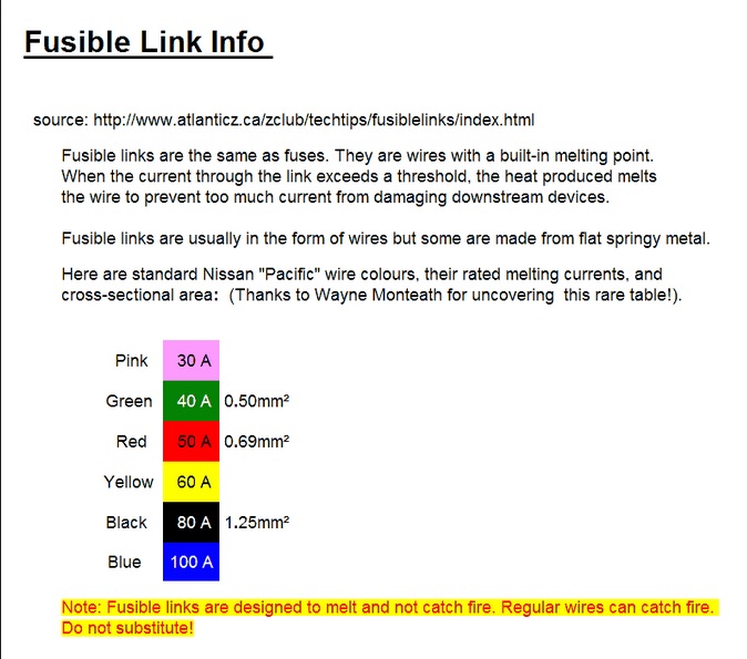

Glad to hear you have the knowledge to look for voltage drops in poor connections.
Since you now report smoking in the area of the fusible link, the presence of the proper link and then its connection to the harness need to be verified.
The proper fusible link should be red in color designating 50 amps.

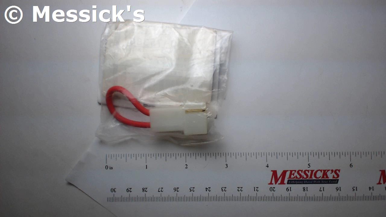

Whoops, too late to swap to MAXI fuse setup as the fusible link is on order from my brand new Messick's account. I do wish to learn more about that however, so I will pursue it. I sure am feeling guilty right now though. I have been reading the posts concerning TractorGals hydraulics issues, and, MAN she has her hands full! The reason I feel guilty is that I seem to have my tractor starting reliably every time so far with a little improvised repair. I wrapped a rubber band tightly around the harness connector that holds the link thereby putting tension on the fusible link contacts and it has started without incident all day, what maybe a dozen times. Several of which were warm start ups up at the haunted spot where "the project" is.

Thanks DaveEng! It is red and the failure appears to be at the backside of the fusible link between the actual link and the connectors inside the male connector. I don't think the problem is with the female/harness side of the connector.
