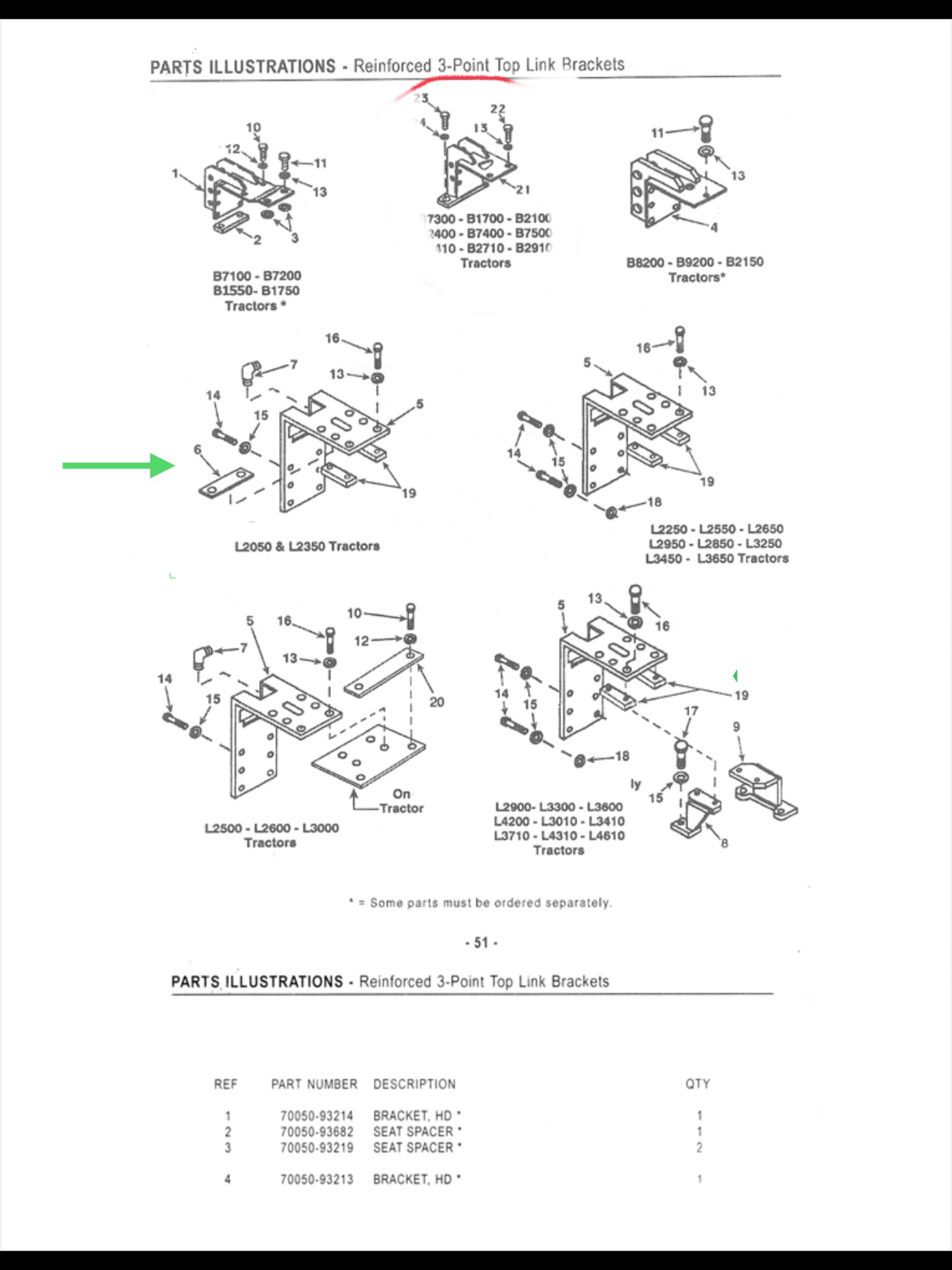

Thank you for the reply. It’s good info. What I have going on is this….. I bought a 4672A Kubota backhoe secondhand. No paperwork. It looks brand new. I need info on whether I need a subframe, or a beefed up top link, or it’ll just go on what I have now. I’m rather new to this tractor stuff. I’m not even sure how it mounts
5,709
2,911
edit: I couldn’t remember where I got the following drawing, but after posting it I see it’s on page 51 of the operators manual linked to above… I have a BL 4690A, and haven’t looked at the operators manual for a while. Got interested this morning after reading your post…🙂

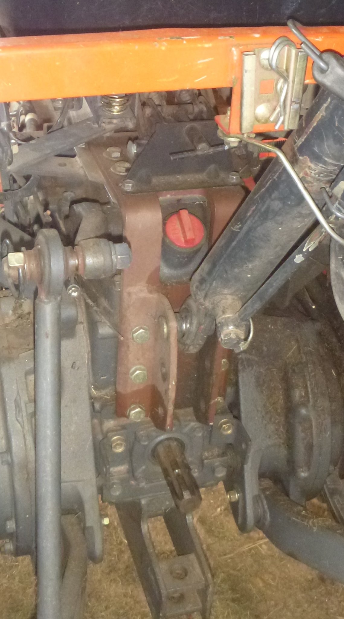

You could get away with not having subframe or heavy duty top link, but you need to be very careful... I bought the heavy duty top link when I purchased an old Long 1199A backhoe. Put it first on a small dozer where it ripped all 6 bolts out of the top link :oops:
Decided it was too powerful, gave it away to someone with a bigger tractor, but glad I have a heavy duty top link mounted!! Brown colored thing, wraps across the top. I welded my "ears" for the top link to it. What you can't see is behind the 90* bend, are welded gussets for even more strength...
Thank you. Yes, I also have seen that drawing. Now I just need to find all those parts

I appreciate all the input that’s been generated. I didn’t know it was such a controversial subject. For me, the backhoe would be used for planting and some stump/bush removal. I also plan on using it for some short trench work. So I’ll be careful. I did order the beefed up top link bracket kit and I only have the 6’ hoe. We’ll see how it goes
