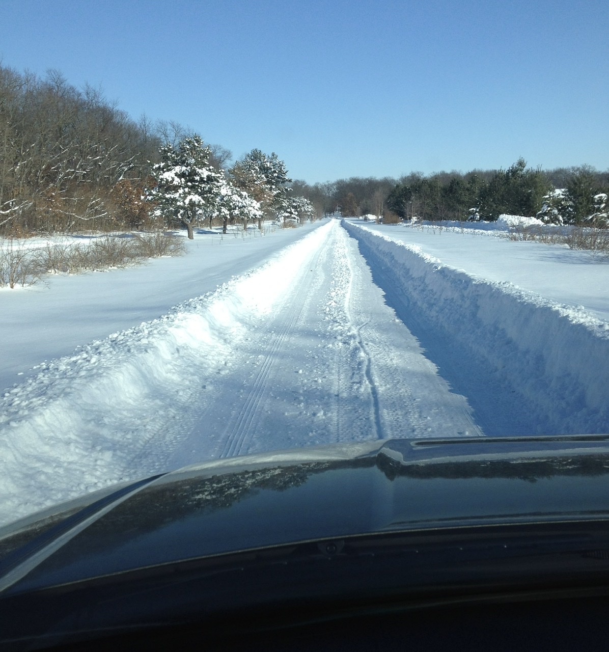

This was with my now gone 4WD Simplicity Legacy with a JD54” front blade mounted to the tractor. A lot less tractor than my BX which I have not plowed with yet. About a 1200’ driveway. This was a heavy snow we get every 5 or so years. May be a normal snow for Tomah!
6,076
4,653
That is the type of snowfall that is best with a snowblower on the front of the BX. No built-up snow on the sides when the next snow drops another foot of snow and the driveway keeps getting narrower because of the snow build-up on the sides.
