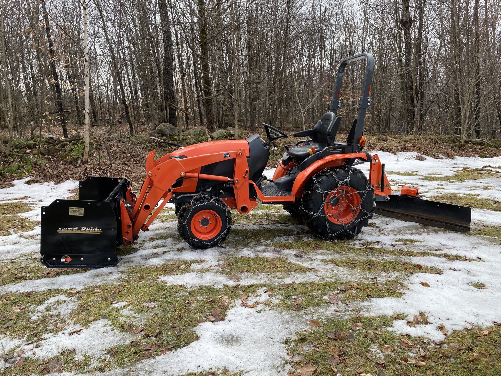

I have a B2601 and want to know if it can really handle plowing snow.
Currently, I take care of a couple of gravel driveways at home, 600' of it on a hill. I use a 1976 CJ5 that is nearing the end of its time. The Jeep can struggle with heavy snow because it is so light.
My Kubota has an old heavy back blade and the front end loader, but I'm interested in removing the snow before driving on it. I'm a little worried that plowing with a FEL attached plow may damage the arms of the FEL and I'm not sure how the small tractor will compare to the Jeep.
Please let me know how you feel about the B2601's capability in asituation like this.
Thanks.

I love the Jeep but the frame is getting so bad that it's increasingly hard to keep it together. I suspected the little tractor wouldn't handle as much snow, but snow removal was one of the strong arguments I made to my wife for replacing our Simplicity lawn mower with the Kubota. I need to make an honest attempt to use it for snow if/when the Jeep finally cracks up.
I am sure the front mounted blade is superior to the FEL blade but I really don't want to lose the FEL for 5 months every year. I have read and watched many accounts of plows and snow blowers while thinking about this and am really interested in the 3 point snow blowers. So, what do you guys think about these options?
