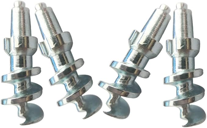

Now THERE'S an Idea! I've seen seriously-studded snow tires used on a snowplow truck.
Has anyone ever studded tractor tires??

THANKS Mikester...
Most I just read was studs in Ag tires. Has anyone studded Turf tires??
I think one might not want to do that because turf tires don't have the deep lugs agriculture or industrial tires have. The studs need to screw and bite into tough rubber, turf tires are usually soft and have thinner rubber for matching the lawn surface and not digging in.
Even putting chains on turf tires seems a bit questionable as the sidewalls (from what I gather here, not personal knowledge) are thinner than industrial or agriculture tires--maybe someone can fill me in on this.
SDT
B1750 with MMM. Everything else sold prior to relocation.
Apr 15, 2018
3,720
1,441
I think one might not want to do that because turf tires don't have the deep lugs agriculture or industrial tires have. The studs need to screw and bite into tough rubber, turf tires are usually soft and have thinner rubber.
Bingo.
I would not try to stud turf tires.
