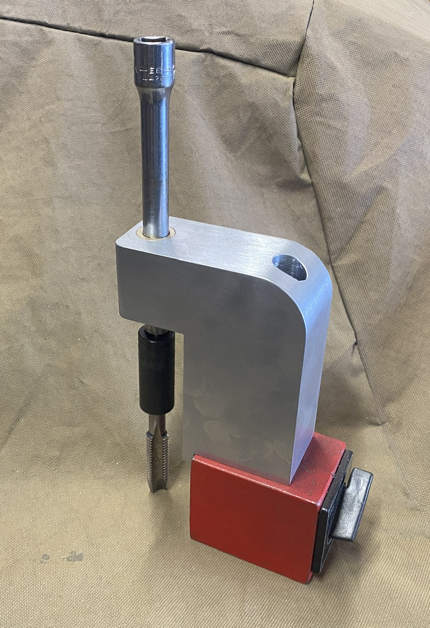

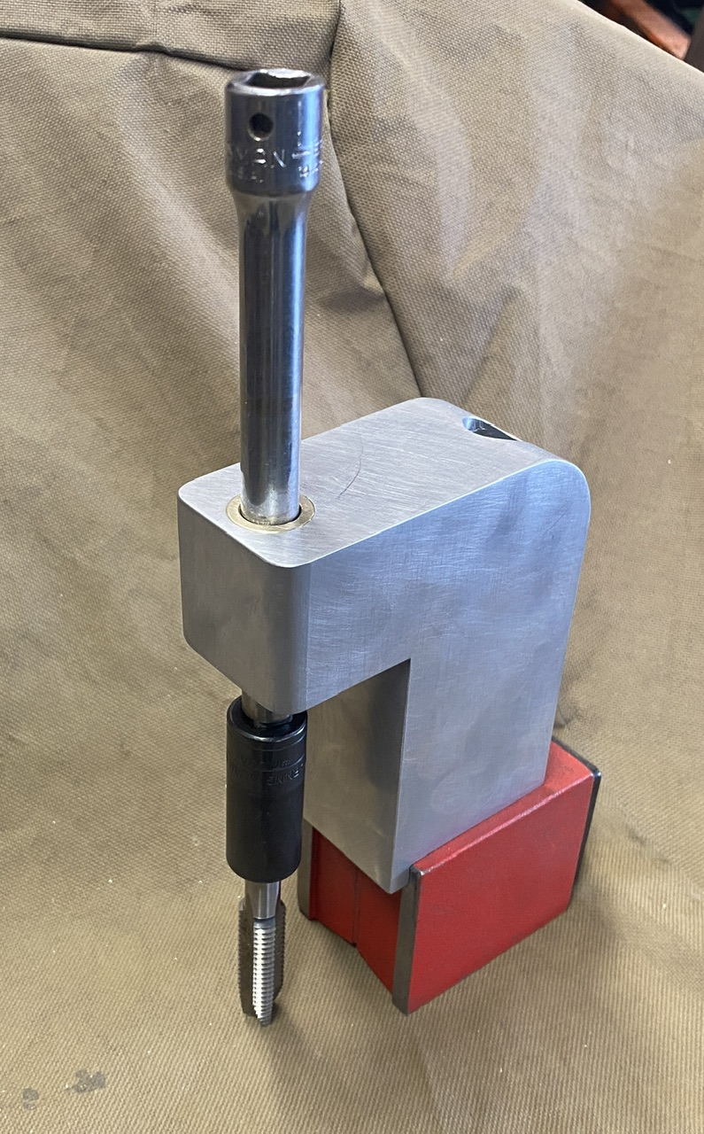

The cordless drill mag base works great. I used it to drill and tap around 40 3/8”-16 holes through 3/4” steel.
Today, I made a mag base tapping guide. It uses a 3/8” ratchet, a 6” extension and tap sockets. I have a Gearwrench ratcheting T handle tap wrench and a 3/8” square adapter that I can use in place of a 3/8” ratchet. Again, I had to get creative with setups on my lathe to machine it.

Might have to steal that design, looks pretty handy!

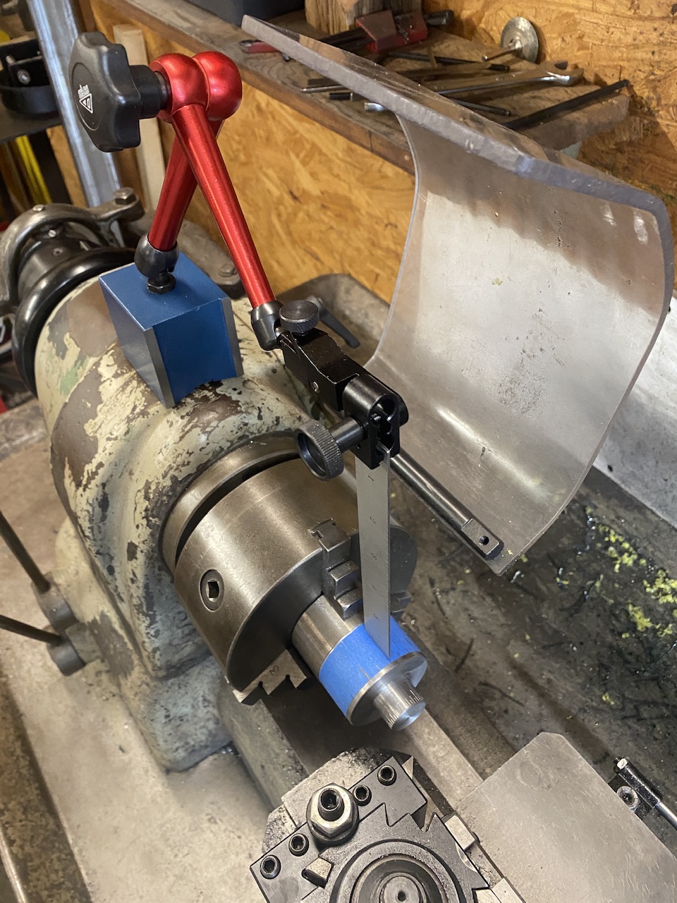

I’ve been thinking about buying or making a milling attachment for my lathe just to have. I picked up a nice 2-1/2” vise and yesterday I sketched the pieces I need to make. Today, I made the adjustment knob and cut 0.001” graduations on it using a lathe bit, magnetic indicator base, 6” scale, and masking tape with graduations on it.

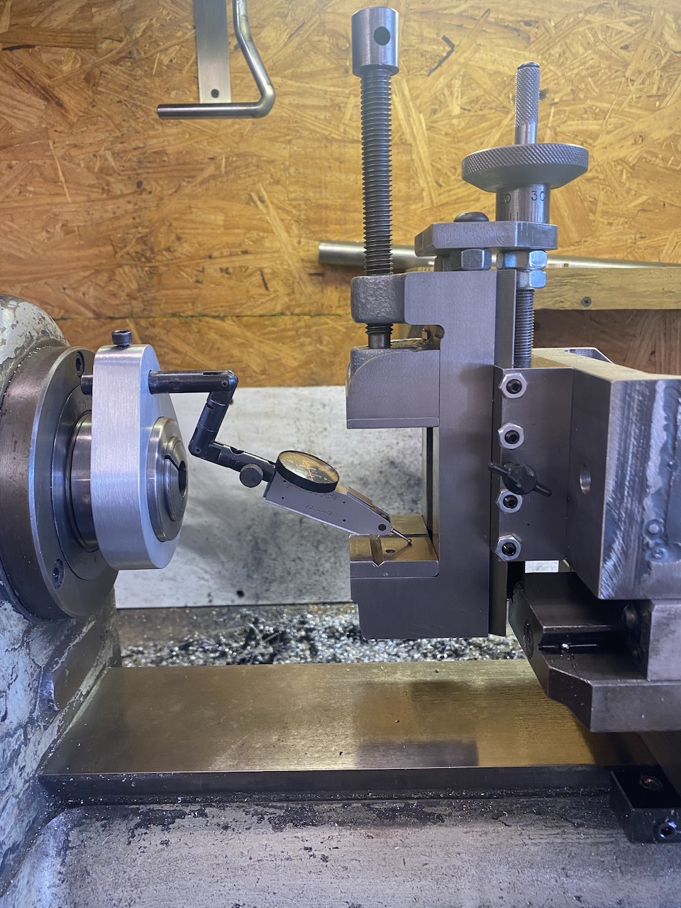

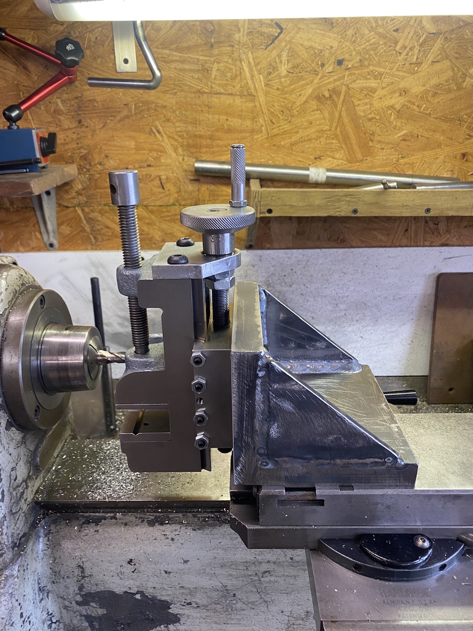

Ground the vise, milled the ends, and cut the dovetail. Made a plate for the lead screw and mounted it to the vise.

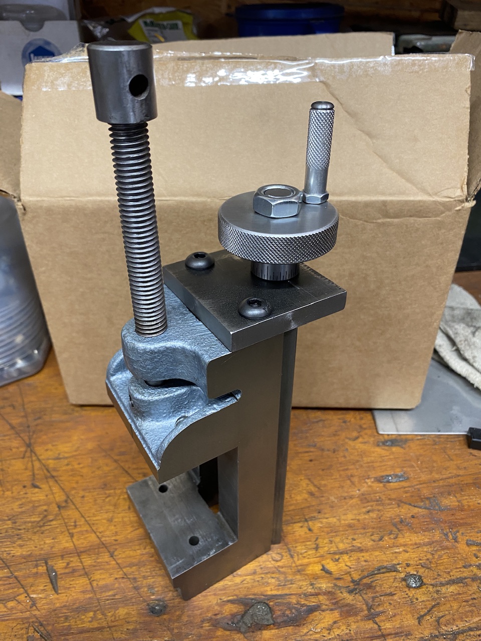

Almost finished. Just need to cut about 3/4” off the top of the welded bracket.

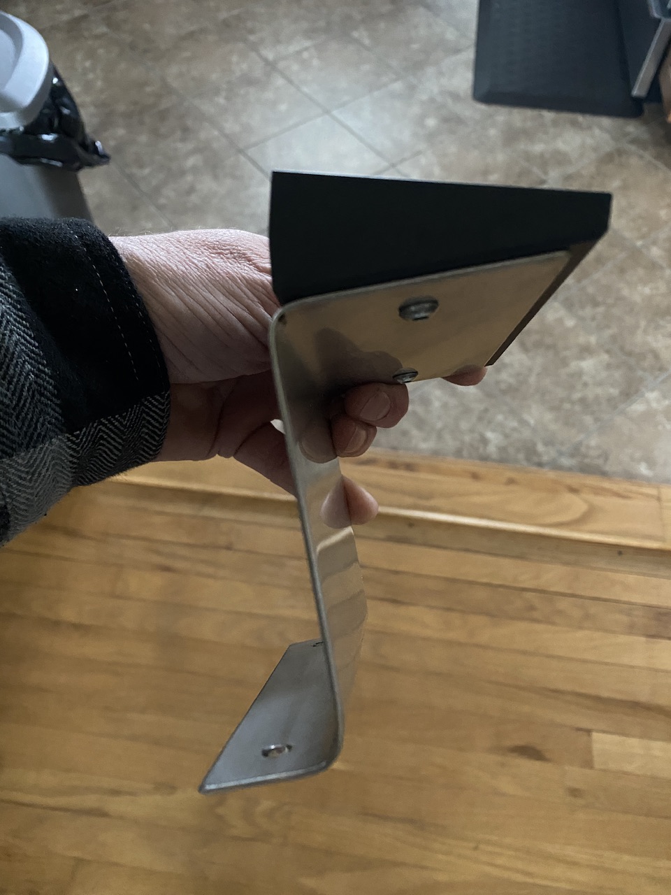

Got tired of chasing my jewelers screwdrivers around in the bottom of the screwdriver drawer:

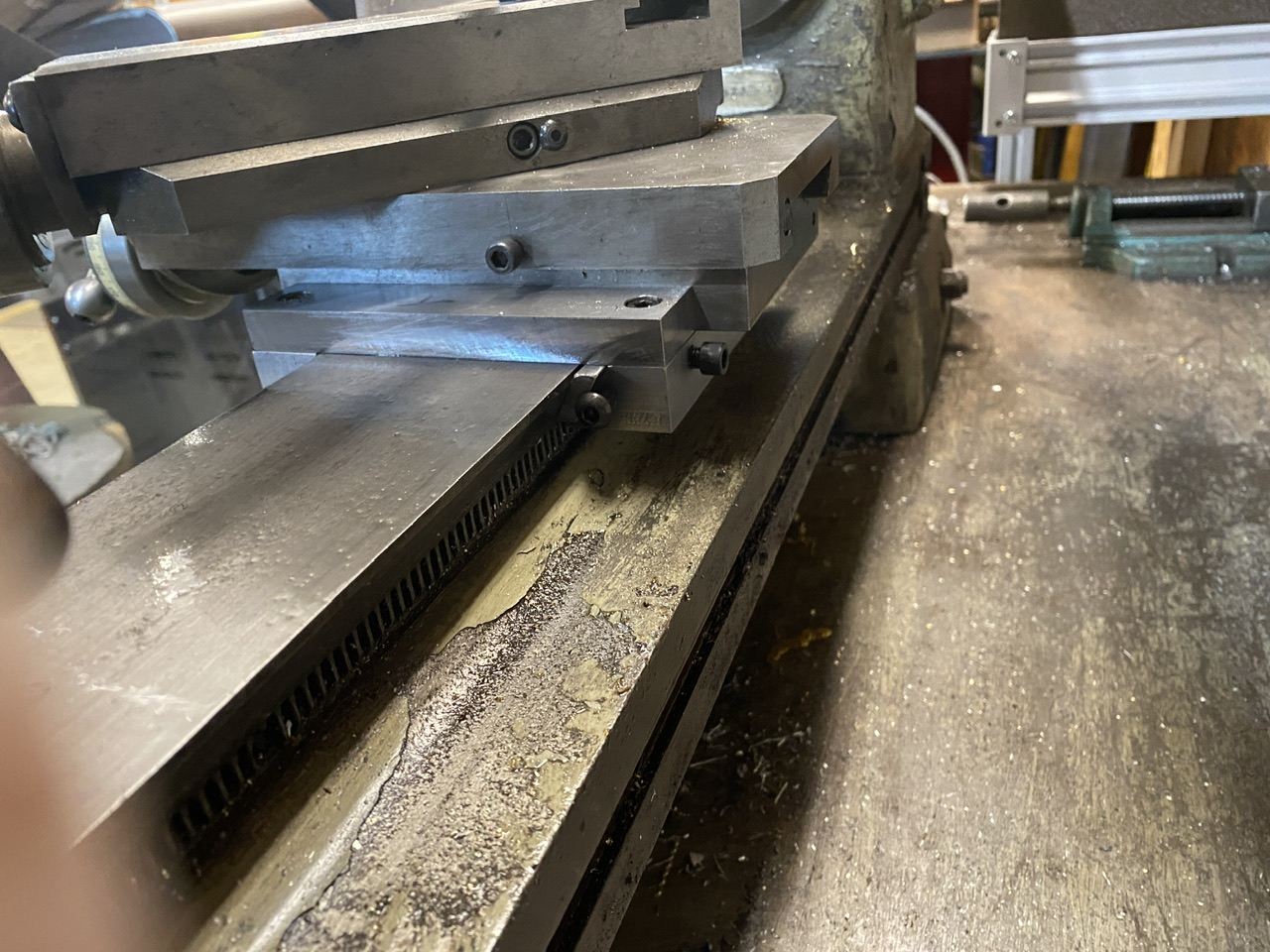

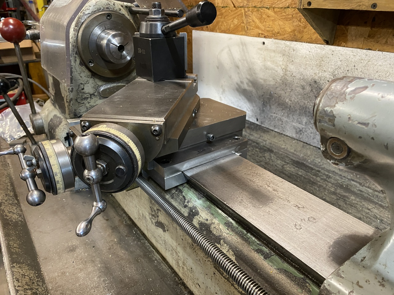

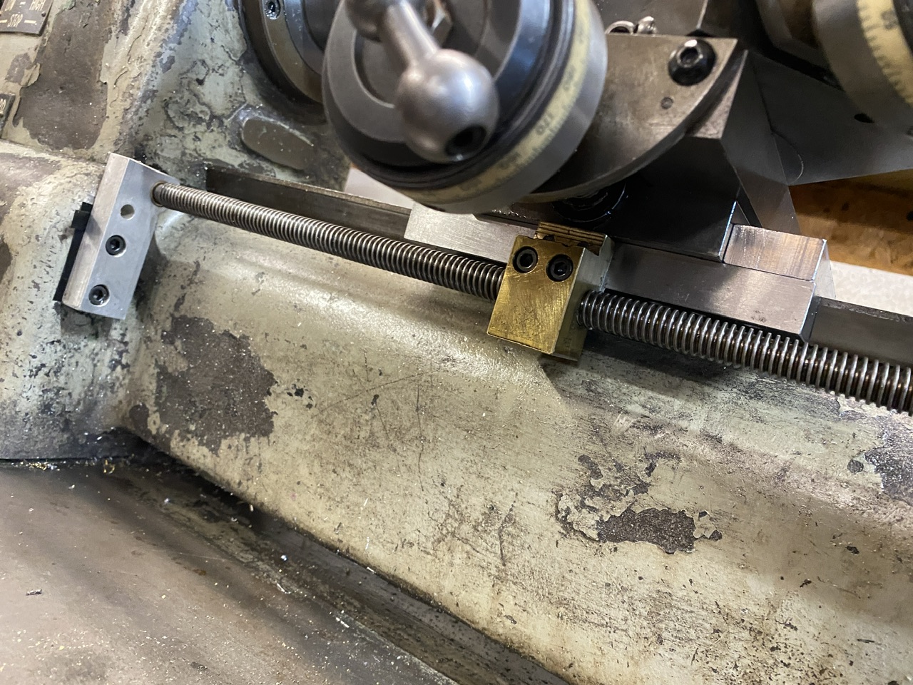

Made some improvements to my Hardinge lathe. It’s what’s referred to as a second op lathe. The carriage doesn’t feed left and right like a traditional lathe. It slides on the ways and is locked in place with a handle at the back. I made new dovetail pieces and a gib to replace the lock and added a lead screw and handwheel.
