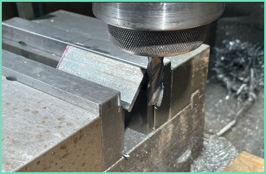

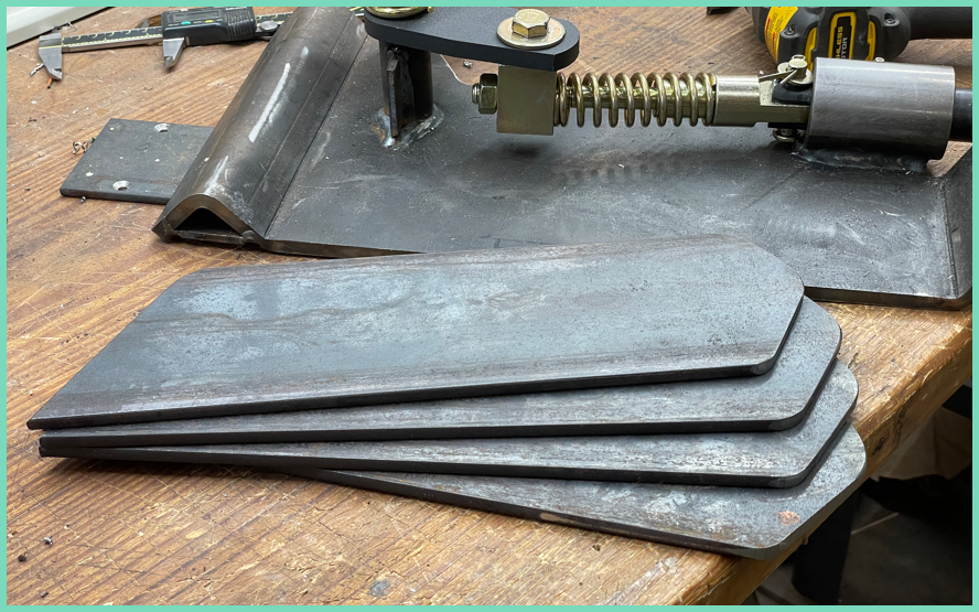

I went ahead and cut the 4 brackets that'll get welded to the latch plate. They are cut from 4 x 1/4" stock.

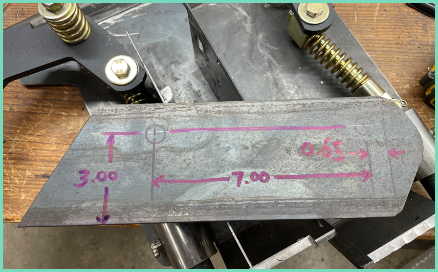

The critical dimensions to the hole positions. The angles are all 30 or 60 degrees.

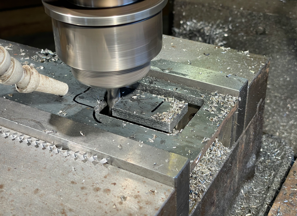

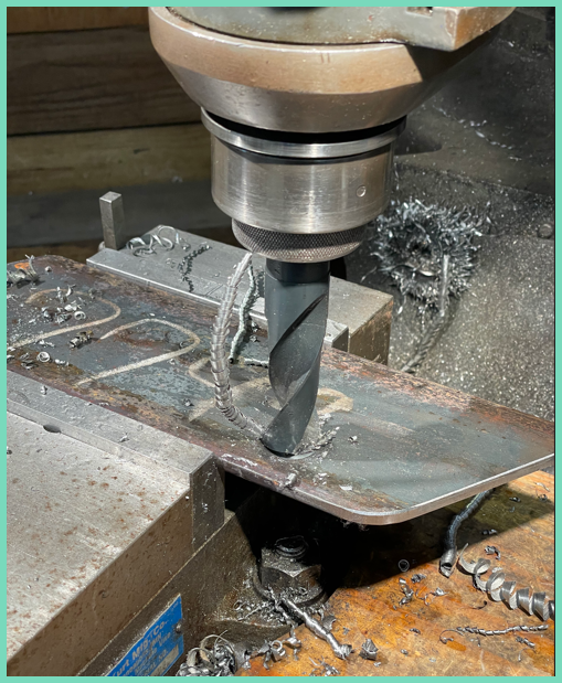

Drilled a pair of 1" holes in each to accommodate the pin bushings I showed above:
Then I cut and squared a set of 2.42" spacers that'll be useful when welding the brackets - 2.42" being the inside space between the brackets:

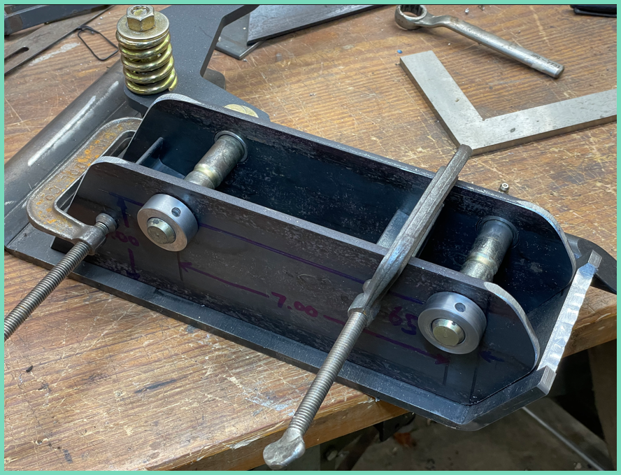

So, here's how they fit - pretty much ready for welding - hopefully I can keep things from twisting out of shape!

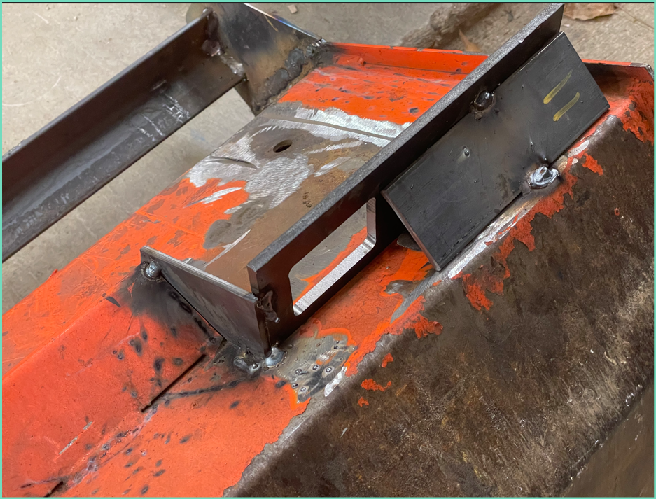

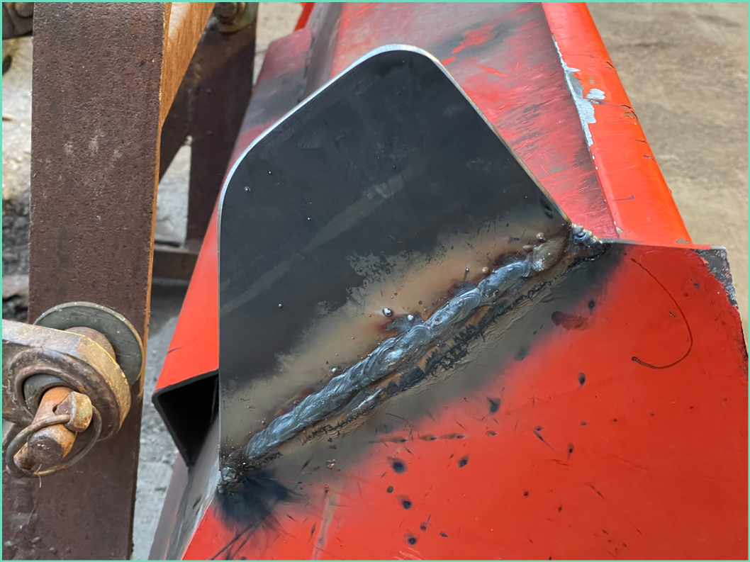

Here's a pair of bucket ears out of 4 x 3/16 stock:
Stuck them onto the bucket:
Tacked on a 2x2x3/16 angle iron lifty thinger between them and a quick fit test:
Next - adding a little structural reinforcement to the above, finishing the welding, and then on to the bottom 30 degree 'catch plate' for the bucket...

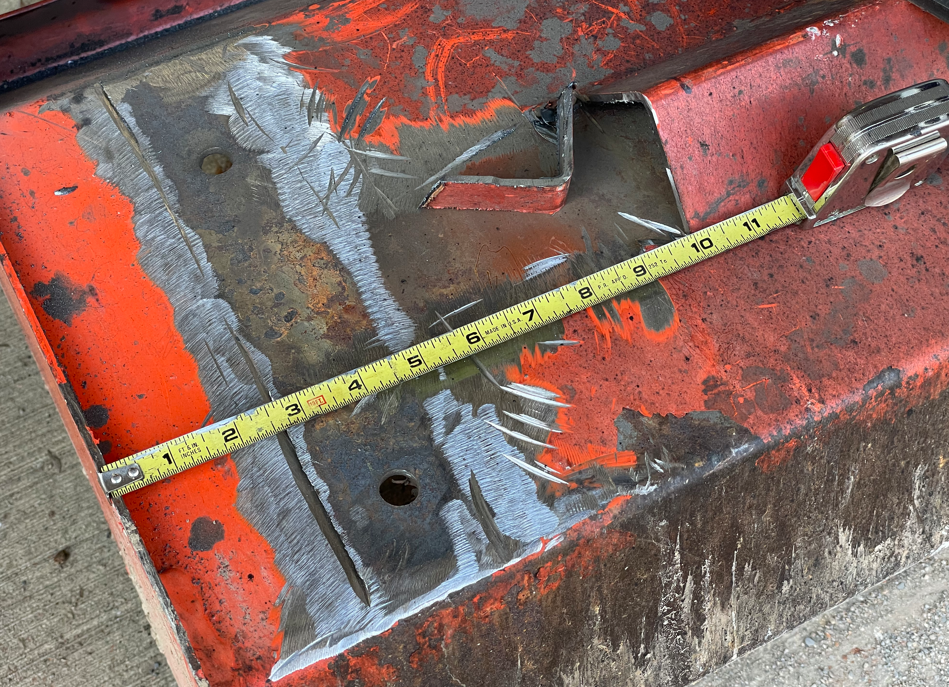

Todays update - I'm finished hacking up the bucket with the angle grinder. I had to cut back the reinforcing brace a bit:
Then put a cutout in the bottom 'lip' piece to accommodate the SSQA pin. It's 1/4 x 3" stock.
And here's the bucket with the bottom lip plate and reinforcement plates tack-welded up:

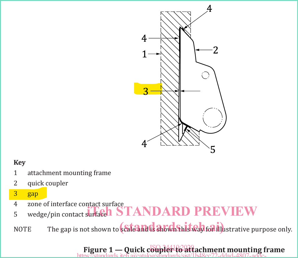

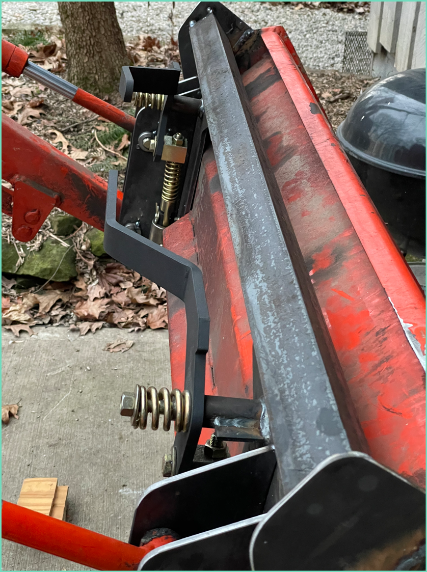

I put the bucket on the SSQA adapter, and it looks decent - no glaring issues, but there's some fine tuning needed to get the 'gap' between the back of the bucket and the front of the latch plate set properly. It looks like the ISO standard says there is supposed to be a gap, but I don't have access to the full spec and don't know what the gap ought to be.
1/8" to 3/16" is normal
Keeps the bucket tight
