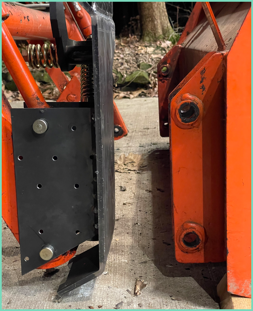

So, the first step seems to be to figure out where to locate the brackets and holes to pin it to the LA302. To do that, I put together a mock-up by tack welding some scrap 1/8" steel to the latch plate, like this:
After a few attempts, it looks like the above is the best location for the pins - it minimizes the pin-to-front-face dimension, which seems like a good goal, but still allows full extension and retraction of the curl cylinders with no colliding parts.

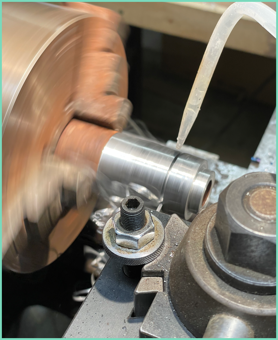

So, to avoid that lurking dragon, last night I made up the 8 little bushings that'll eventually get welded to the brackets, and receive the 4 LA302 FEL 3/4" pins. They're 1-3/8 mild steel, bored to 0.77" (the same as I measured on the bucket pin holes) and with a 1" shoulder that'll slip into holes in the bracket before they get welded in place. Four of them have cross-drilled holes to accommodate the cotter pins, just like the LA302 bucket has in its original form. A few hours of quality time with the lathe, and voila - the easy part of the project is done.

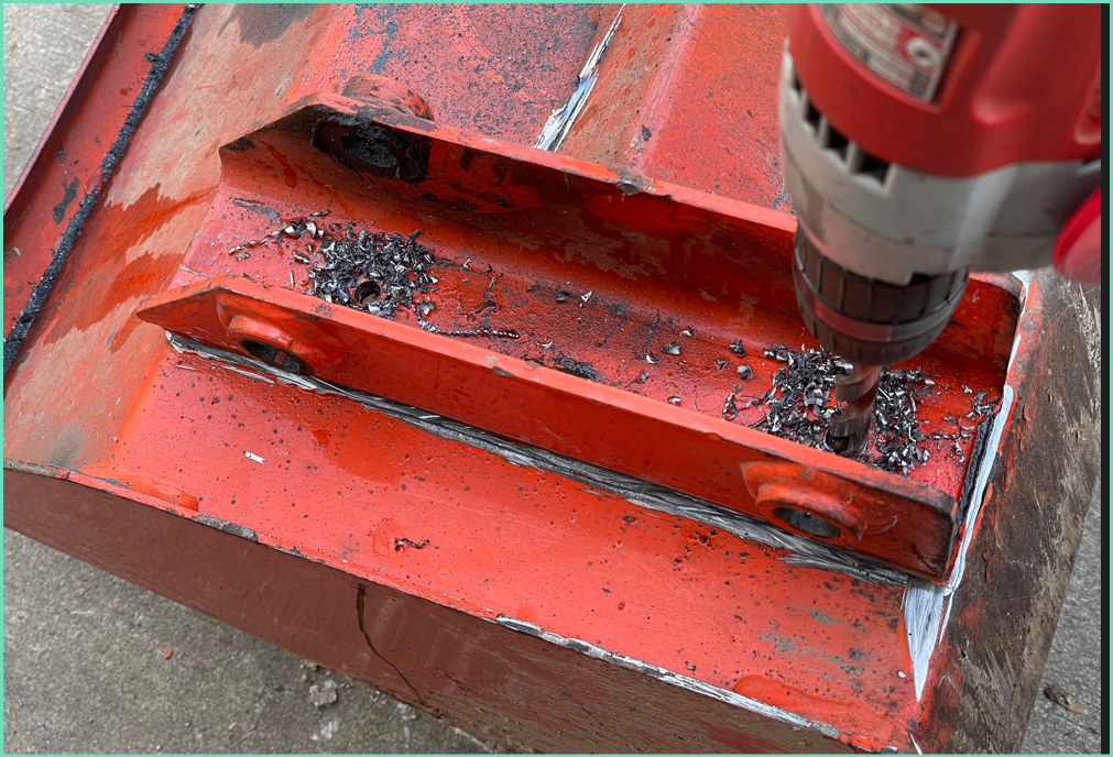

So a trip to Harbor Freight resulted in this following me home:
I fitted it with some 1/16" x 6" cutoff wheels, and was actually pretty impressed with how well it ate through the brackets on the back of the LA302 bucket. It took about an hour, but one of them, as well as a little bit of the angle iron brace is now off.
There are a few gouges I made in the bucket, easily welded up later. There were a pair of 1/2" 'plug welds' in the center of the bracket - the grinder wouldn't reach them. I decided to just drill them out. So that's why there's a couple of 5/8" holes in my bucket now.

I had the same design philosophy when I built my FEL and bucket. In order to keep things as light as possible and as close to the pins as possible (both to maximize payload capacity) I incorporated the bucket itself into the SSQA. Relavent pictures start here: https://www.orangetractortalks.com/forums/threads/yet-another-b7100-fel-build.26262/post-215013
It has worked out well and think you are on the right track. Just make sure you will still have a sufficient height when you are done. The lower pin on the bucket must be high enough that the bottom of your adapter does not interfere with connecting and using the bucket.
Also, I'm not sure about the bottom of that adapter (on the tractor). I would prefer to see a solid wall all the way to the bottom flange, and fear that leaving it floating in mid-air like that will eventually lead to grief when it somehow gets bent upwards.
Yep - I had the feeling I might need to adjust the pin vertical position. I'll give it some more thought.
Yes - that's the plan - my mockup adapter plate was too short, and I had to lift it up to get the geometry right, but when I make the 'real' plates, they'll extend all the way down to the lower 'lip' on the latch adapter plate and get welded securely.

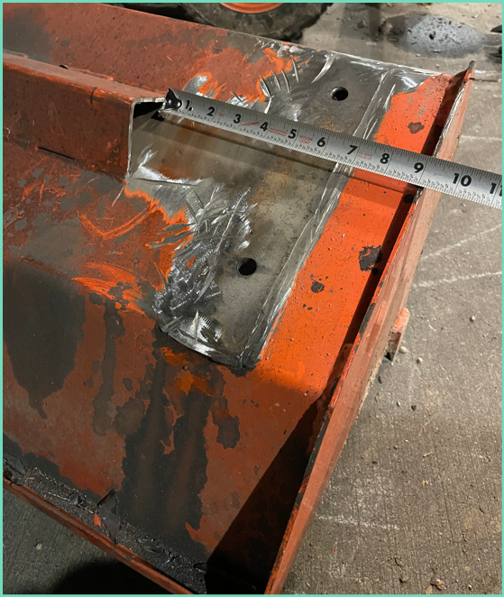

The deed is done - glad that part is over! My bucket now has flat mounting surfaces on the back to accommodate whatever adapter plate I need to put there.

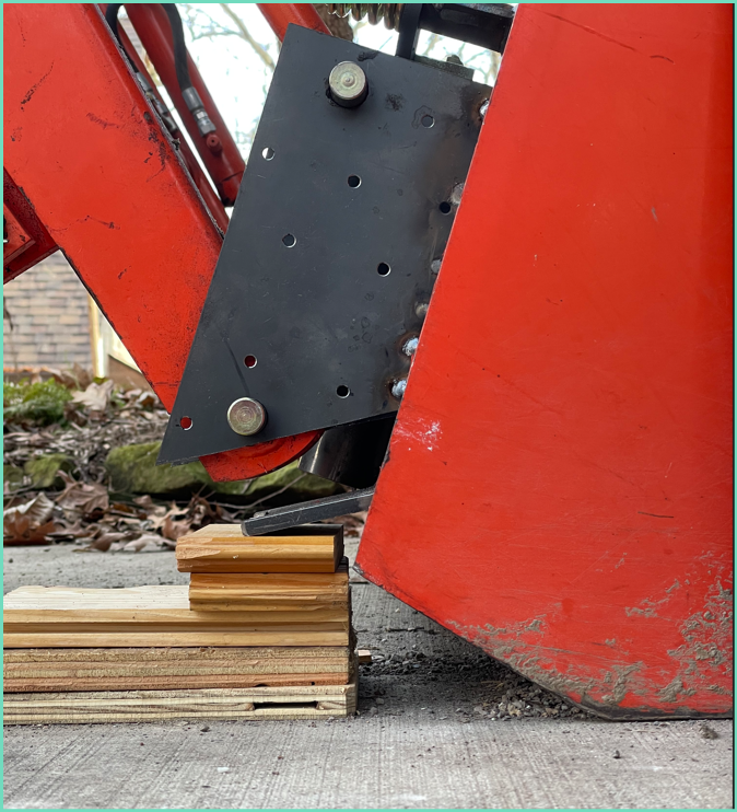

...Just make sure you will still have a sufficient height when you are done. The lower pin on the bucket must be high enough that the bottom of your adapter does not interfere with connecting and using the bucket....
I want to be sure I understand the concern here - Is it that once the bucket is attached and the loader arms are lowered so the bucket is sitting on the ground, I need to make sure I have another few inches of loader arm 'travel' to lower them in order to release the bucket from the adapter?
Here's what I'm thinking. In the picture below, the loader arm sits on a pile of wood blocks - otherwise it could be lowered another 3.5". The bucket is on the ground. So it seems like there would be ample travel to be able to release the bucket.

3" to 3-1/2" sounds about right. Not only do you need that to release the bucket (even on uneven ground), but you want to be able to dig a bit (with the bottom of the bucket horizontal) too.
