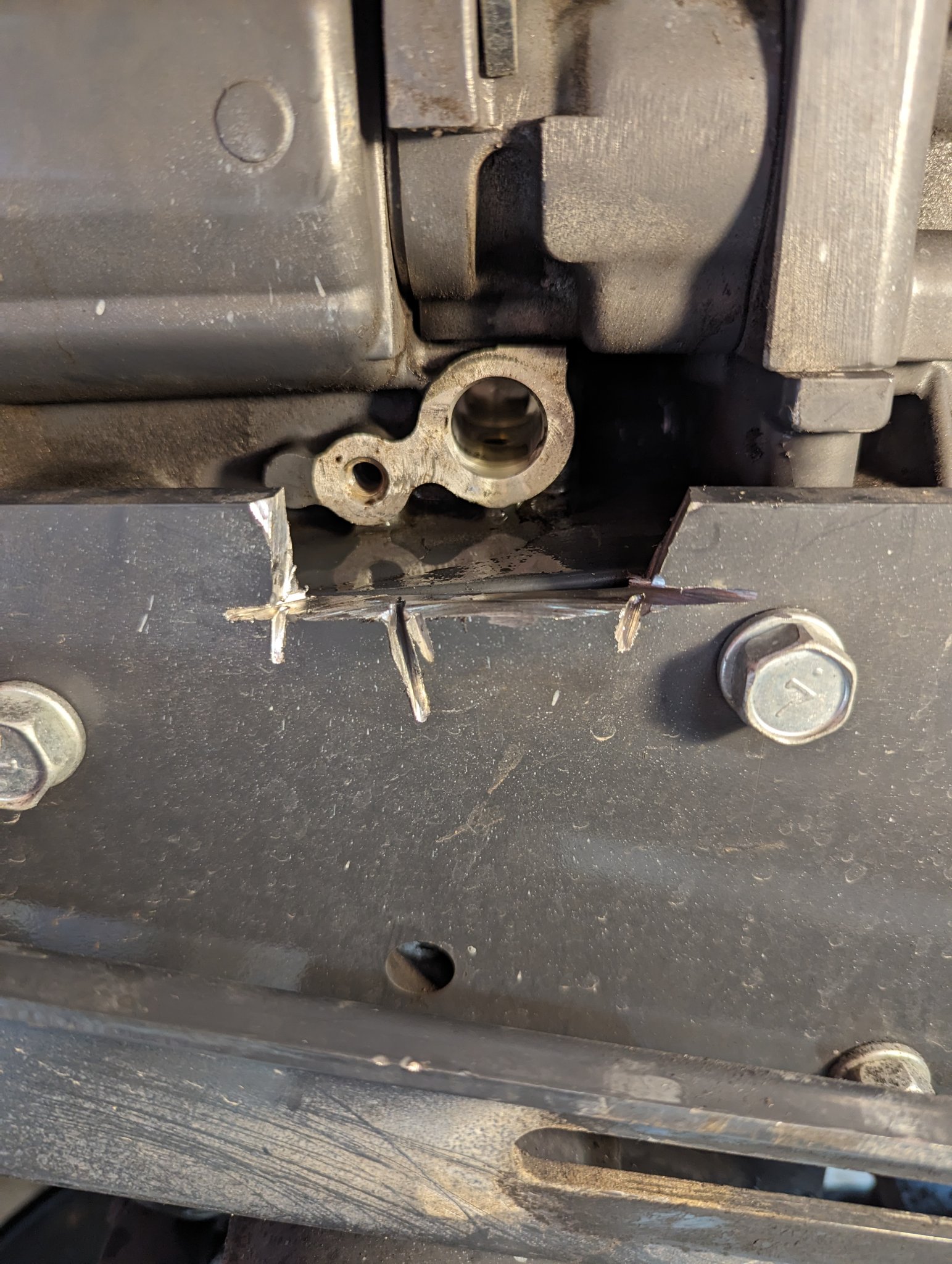

The spring connects to a small hole in the lever and a hole on the flange of the hydraulic pump. it is missing on a lot of Kubota's and often causes a no-start condition because the pto lever isn't held firmly against the neutral switch!
Yeah I went out there and messed around with it until I figured it out. The hole on the hydro pump was throwing me off, but I could see that it really was the only option since there was no other place to hook the spring to. It works so much better with the spring... Before I had to pull the lever up and into the latch on the fender plastic, now you can just release the lever and it sucks it right into place.

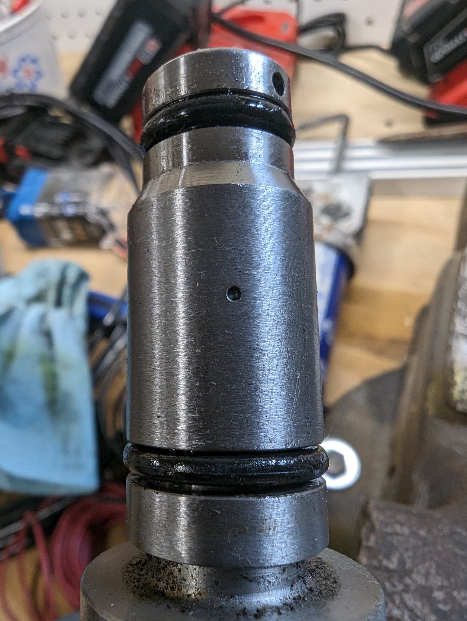

I'm not sure drilling that out was the right thing to do! Usually the drill is the last thing I get out when I'm repairing hydraulics. Guess we'll find out when he puts it together!
My concern with drilling it out was the possibility that there is an orifice in there to control PTO engagement. I don't have a new one to look at but the illustrations in the service manual don't show one.

This was already a super small hole. I can't imagine why it would need to be any smaller.
Anyways, I put the belly mower on and finally got to mow my back yard before the rain came in. Absolutely no issues as of right now.
