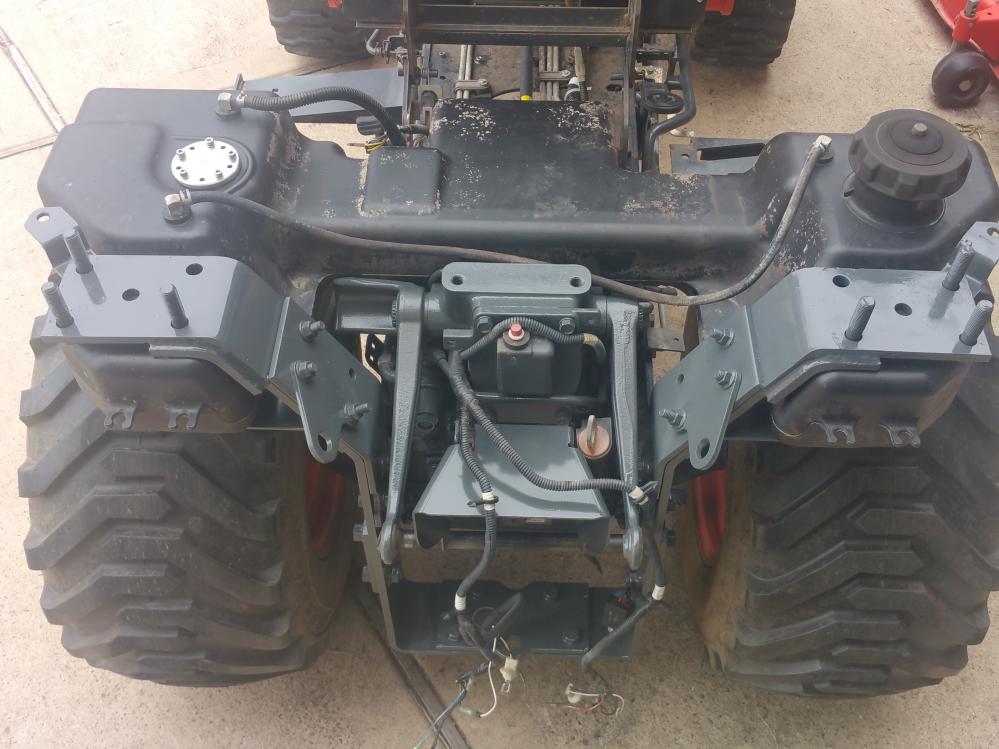

first off I have .82 acres. I mainly use the tractor with the 60" belly mower. The second most used attachment would be the FEL which has never been for anything more than the tractor can easily handle. I also have a 48" tiller to keep my garden up. Every now and then it has had a post hole digger on it, so I can't imagine why I would ever need a bigger tractor for anything I have ever done.

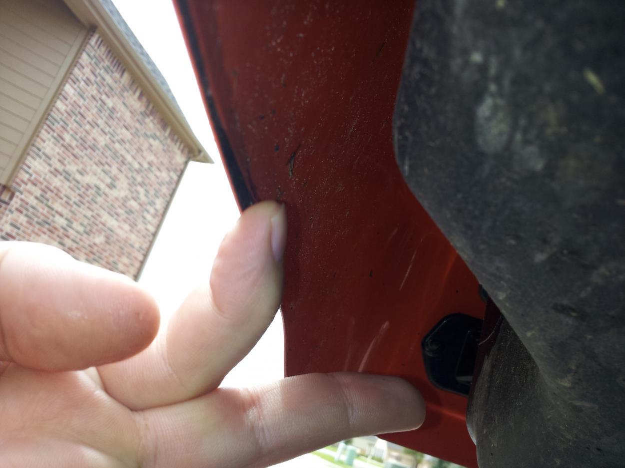

3. Paint flaking off in large sheets on floor pan, and rear fenders causing severe rusting. Caused by ZERO paint preparations/no primer: Replaced under warranty the first time. 1 year later it was doing the exact same thing which by then it was out of warranty of course. Fix (2nd time) I took everything off and had everything sandblasted and powder coated.

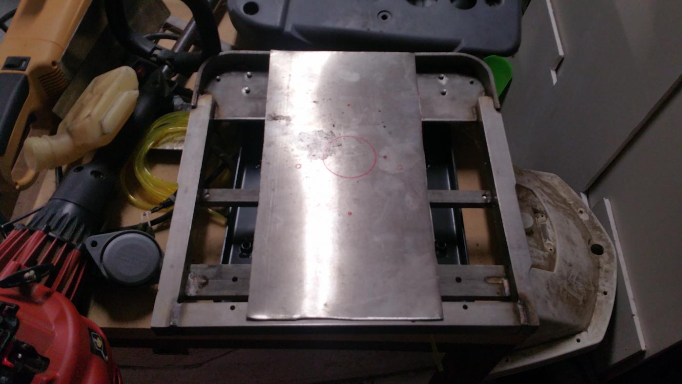

4. Severe rusting on seat frame. Again, very poor/no paint preparation. Fix: Throw away entire OEM seat frame and build brand new one from all stainless material. See pics in next post. (Can only upload 5 pics at a time.)

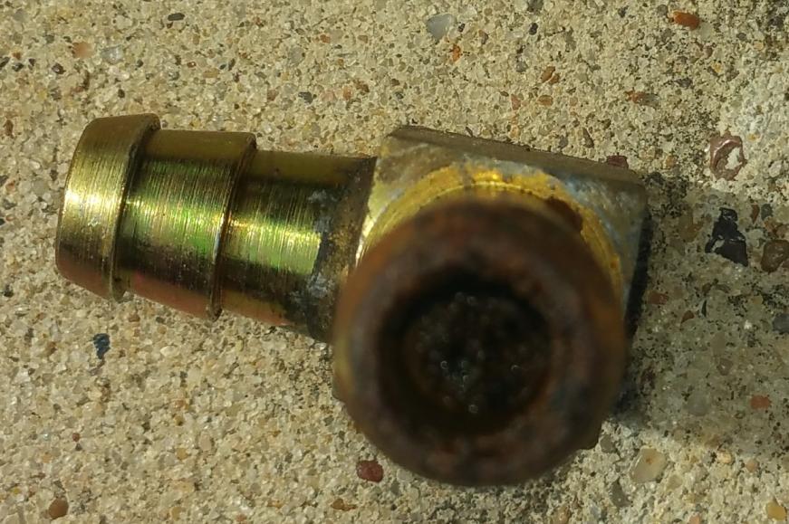

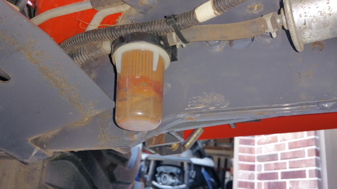

5. Engine had no power, and eventually would not run: Caused by very low to no fuel flow due to severely rusted fuel sending unit which the rust all accumulated at the outlet port on the fuel tank restricting the fuel from flowing out of the tank. First fix, replace sending unit. A little over a year later, the exact same thing happened so I removed the fuel sending unit and machined a SS block off plate (which of course now my fuel gauge does not work, but there will never be anymore rust in the tank!) Also added a clear fuel filter unit that I can easily see the condition of the filter and any water in the fuel.

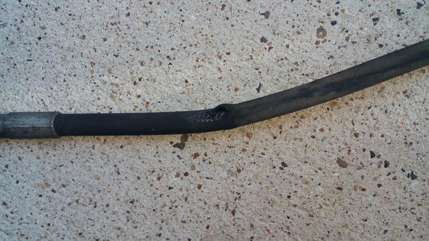

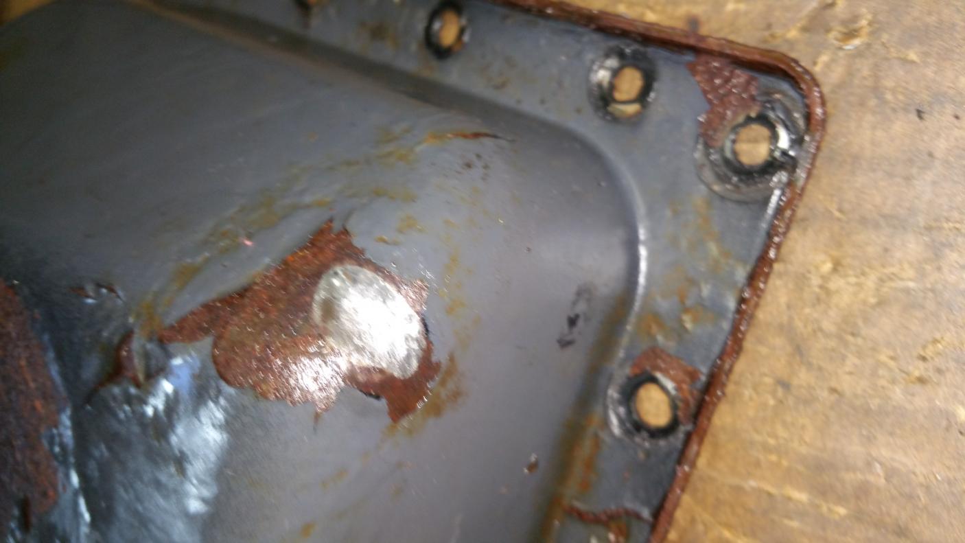

6. Hole in oil pan. Caused by power steering hose rubbing due to bad routing from factory. Fix: Remove engine in order to remove oil pan, weld up pan, sandblast and repaint, reinstall.
7. Leaking steering hose. See #6 for cause. Fix: Replaced with new hose and properly rerouted away from oil pan.

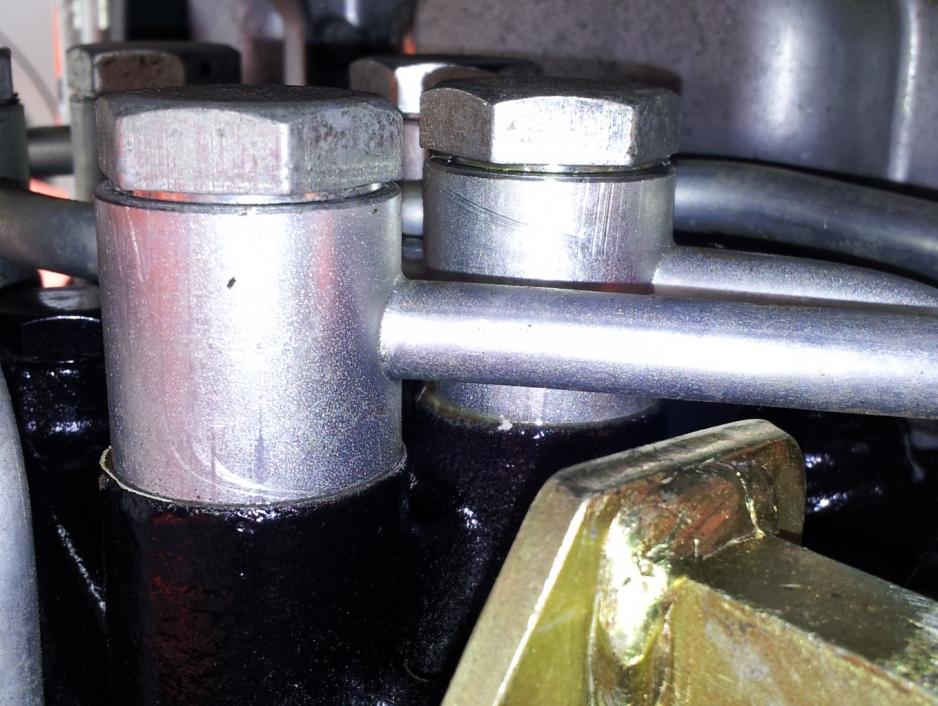

15. No PTO output. (The reason for this thread originally) Cause: Plugged oil passage in PTO clutch valve. Fix: Notch frame in order to remove PTO valve, drill out oil passage with 1mm drill bit by hand.
I am POSITIVE I probably left out several things, but as you can see, I have had one problem after another with this tractor! I do not believe that any of it was caused from me abusing it in any way or using it beyond it's capabilities. One thing is for sure... I know this tractor VERY well!
