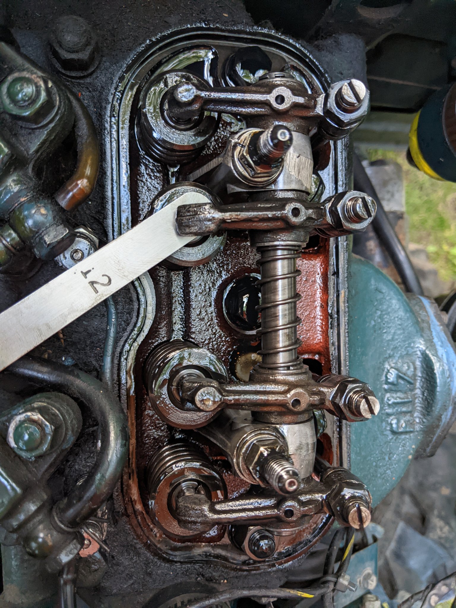

I adjusted the valves tonight.
They were all between 12-17 thou. Spec is 8-10. I adjusted them all to 9.
I think that was the easiest valve adjustment I've ever done.

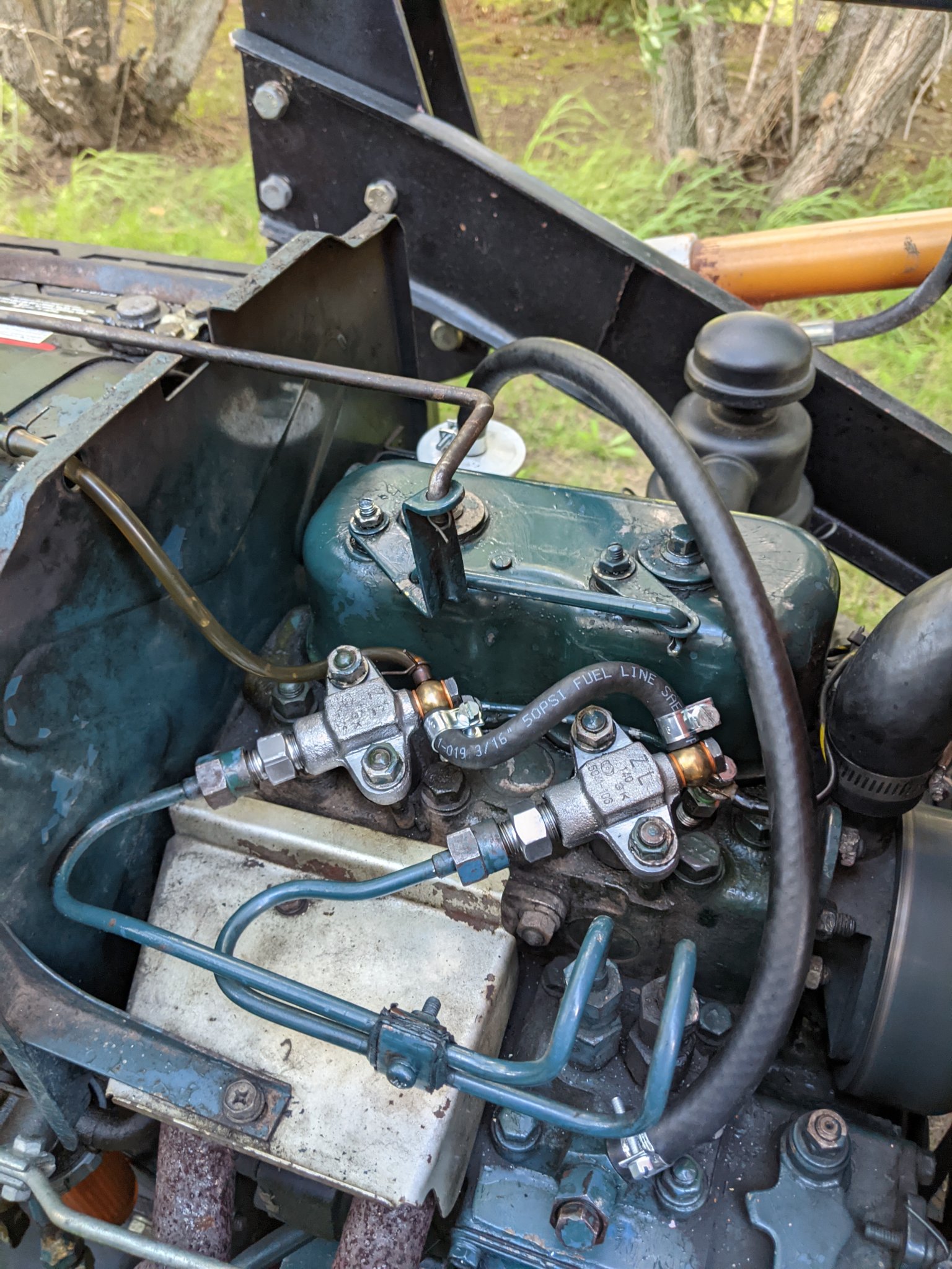

Also replaced the fuel hose and clamps going over the valve cover since I had to remove it anyways.

After the valve adjustment it seemed less clacky, especially after it warmed up.
But it could have been the equivalent of butt dyno ears...

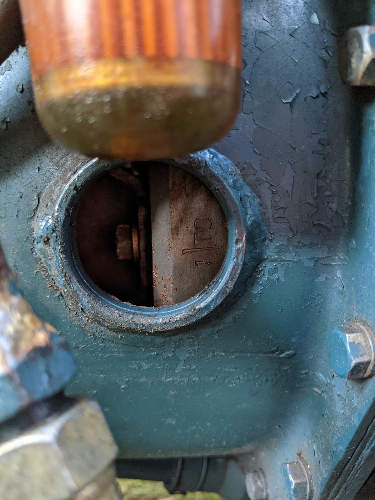

I forgot to take a picture of the timing marks on the fly wheel yesterday, I was worried they would have been marked in Japanese characters being a grey market tractor but they were marked normal.

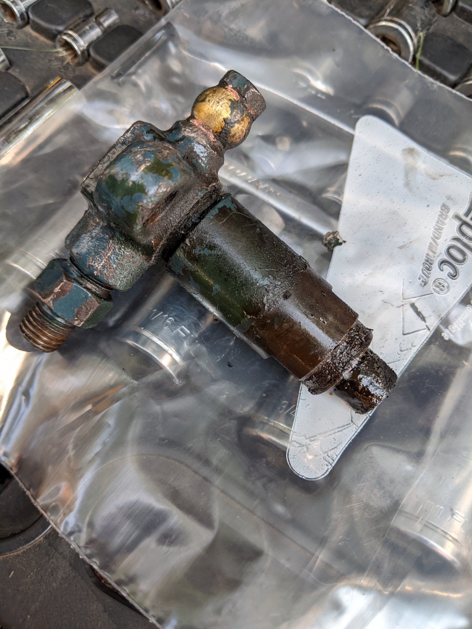

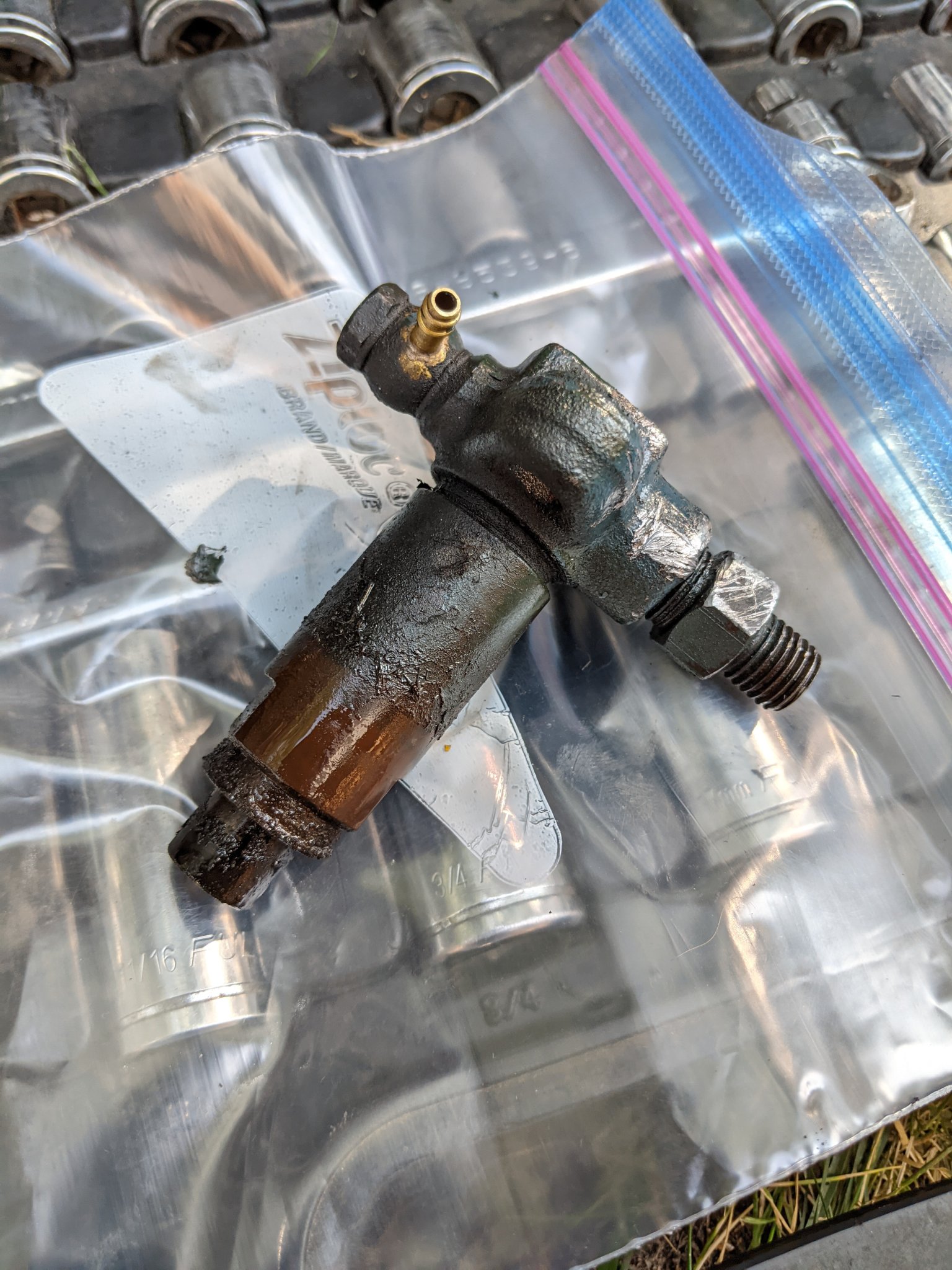

I pulled the injector closest to the operator tonight... It came out no problem. Both the return lines to the tank decintegrated when I pulled them off.
Externally it looks like it needs a good cleaning so I imagine the insides look the same.
The radiator side didn't come out so easy so I tapped it a bit and put some pb blaster around it. After the bit of tapping it started to rotate a bit but I didn't want to risk breaking it since they're NLA so I decided to let it soak for the night.

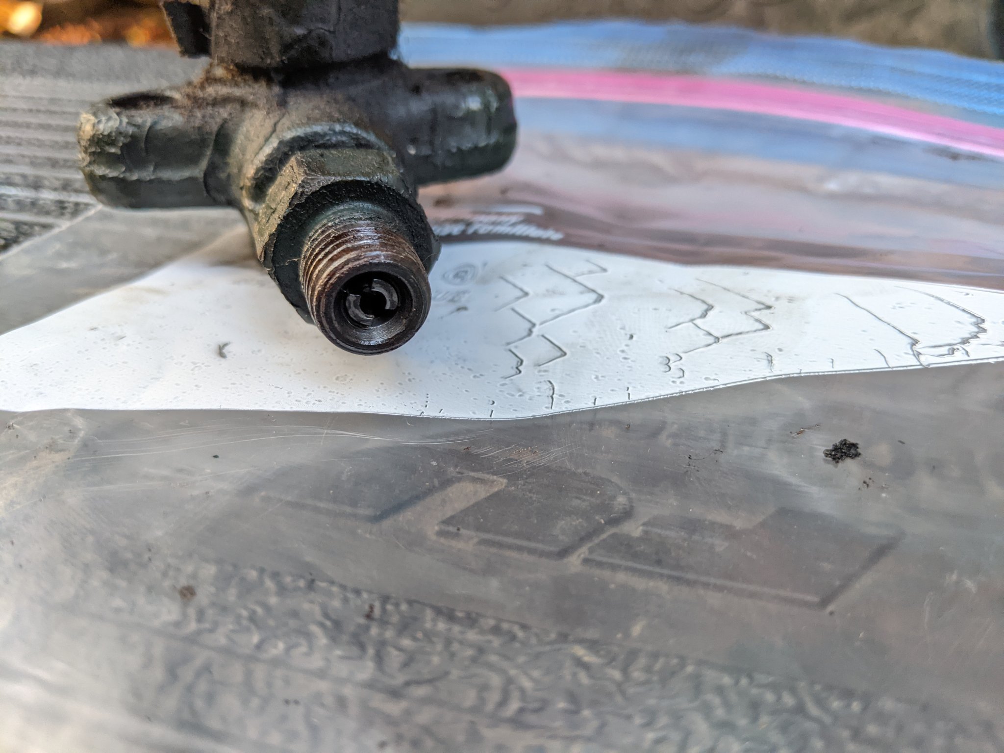

I got the other injector out this morning.
The PB Blaster helped a bit but I remembered reading somewhere that you can crank it over to use the compression of the cylinder to pop it loose. It took a bit more tapping back and forth and a few rotations of the crank by hand for it to pop loose.
It looks like this one may have been leaking a bit.

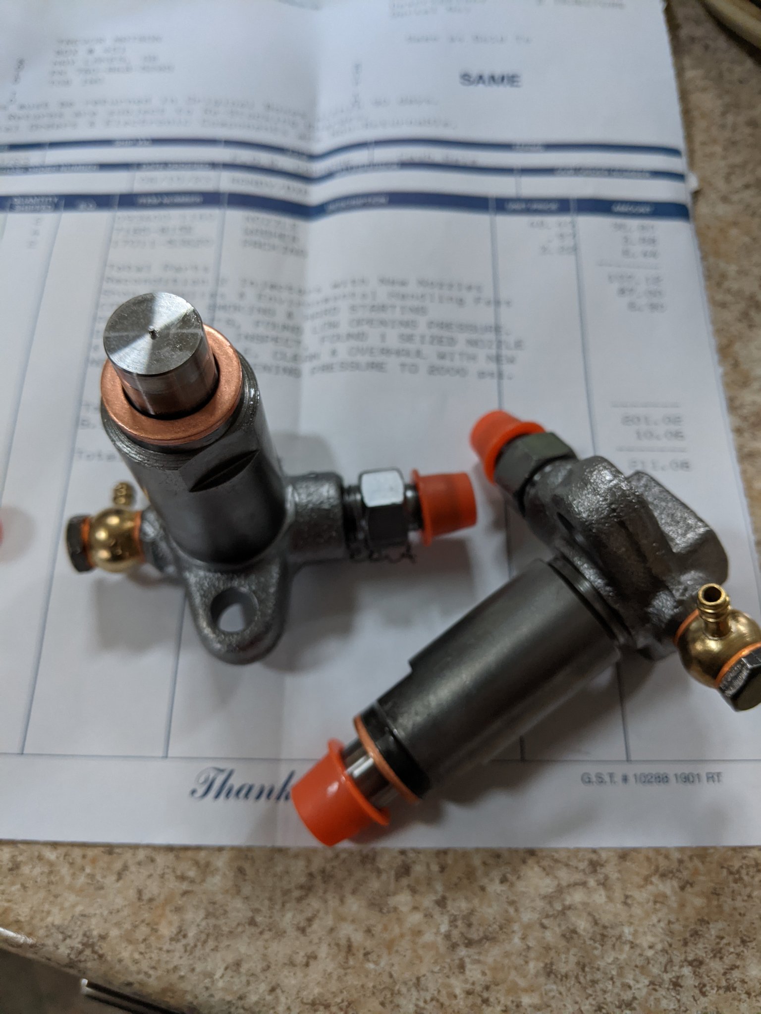

Dropped the injectors off at the shop this afternoon.
We will see what kind of shape they are in and what they can do to fix them up.

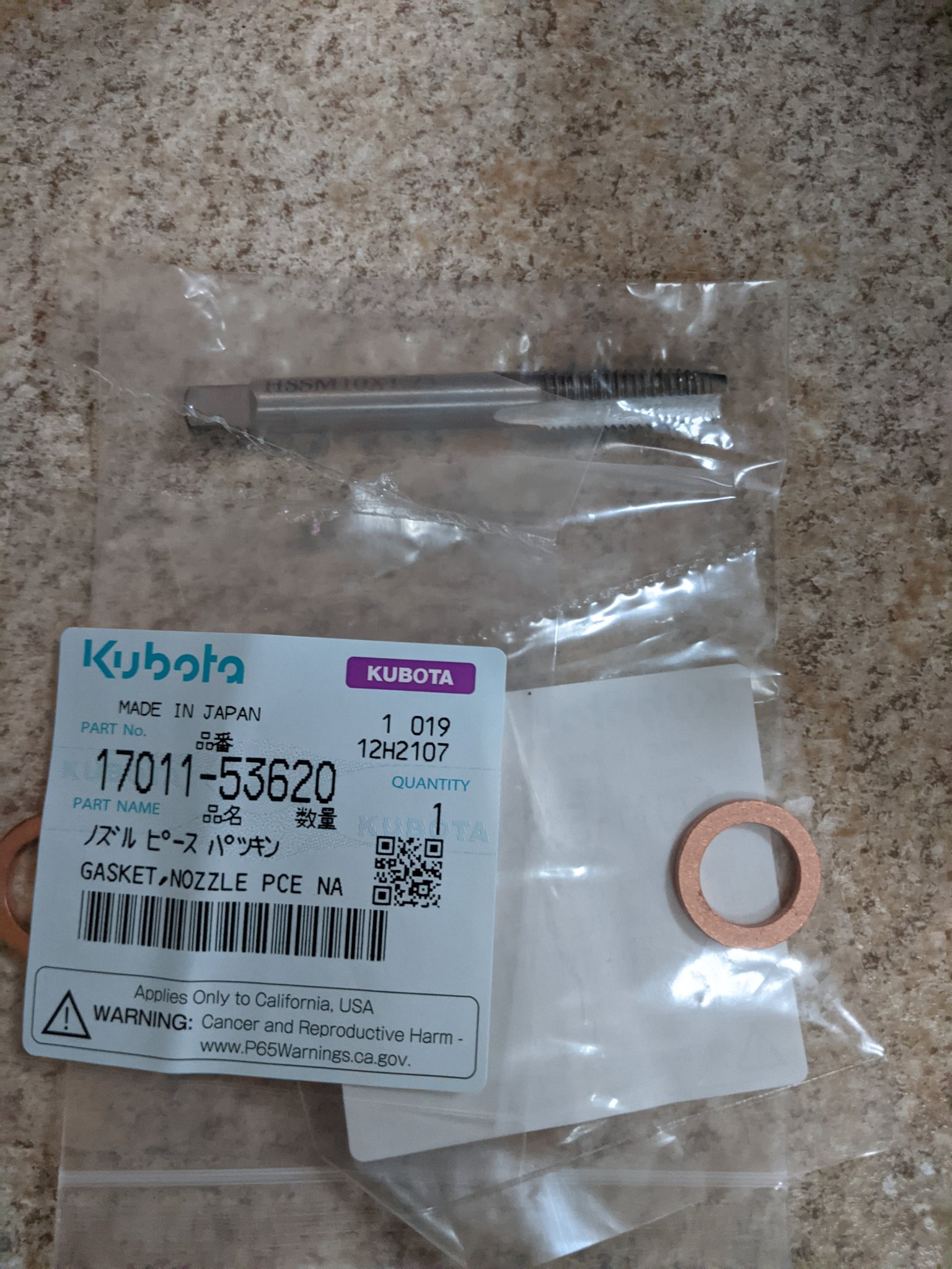

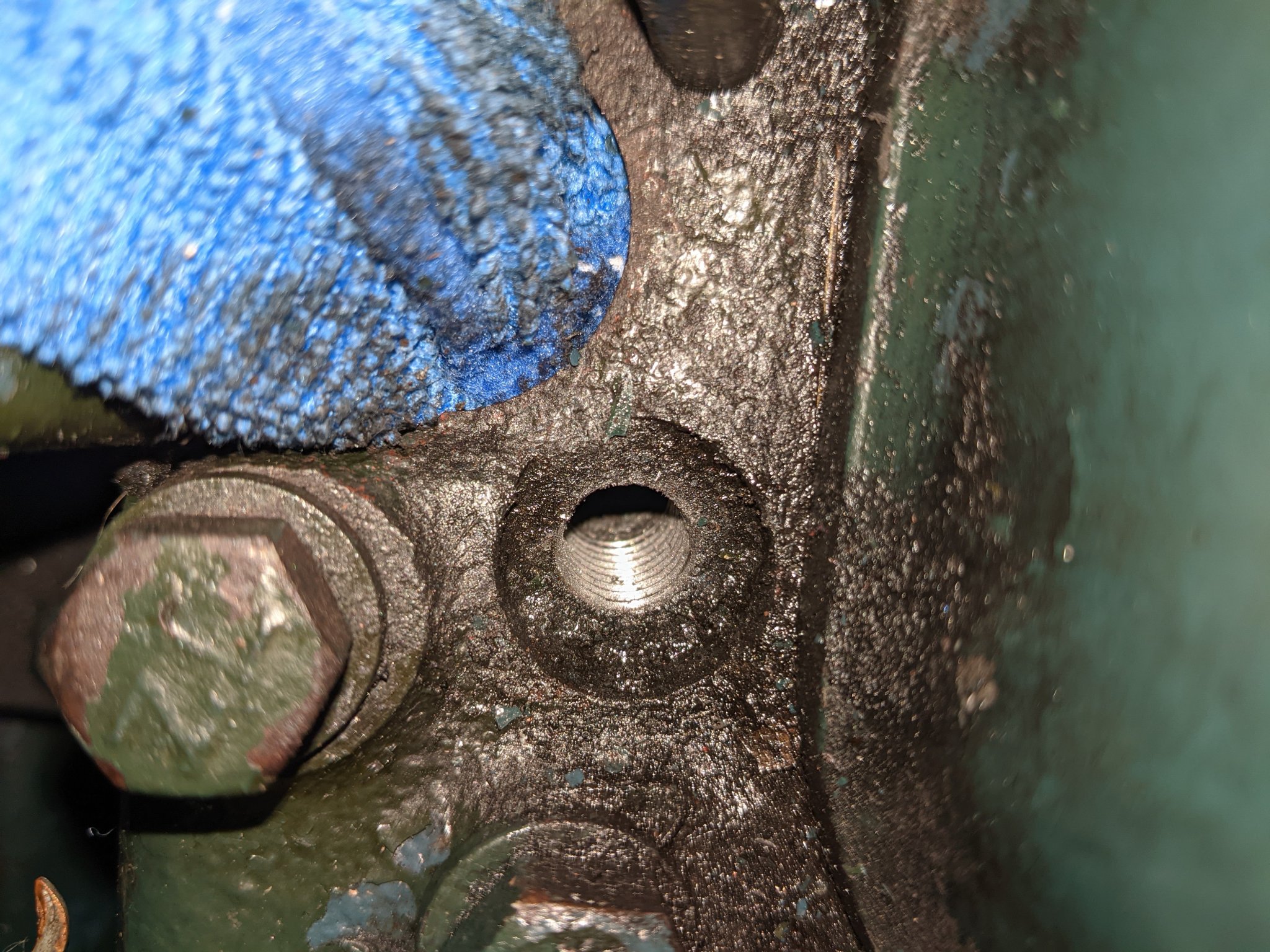

Also ordered an M10x1.25 tap to clean up the glow plug holes since they took a bit of effort to thread in and they're easily accessible while the injectors are removed.

I happened to be driving the Kubota dealer today so I stopped in and grabbed the copper washer seals for when the injectors come back.
I was going to start cleaning up the area around the injectors and clean up the threads for the glow plugs but it's raining here.

The Diesel injection shop called this afternoon and said they're ready for pickup.
I don't think I'll make it there after work before they close but I'll try to get someone to pick them up for me so I can install them on the weekend.

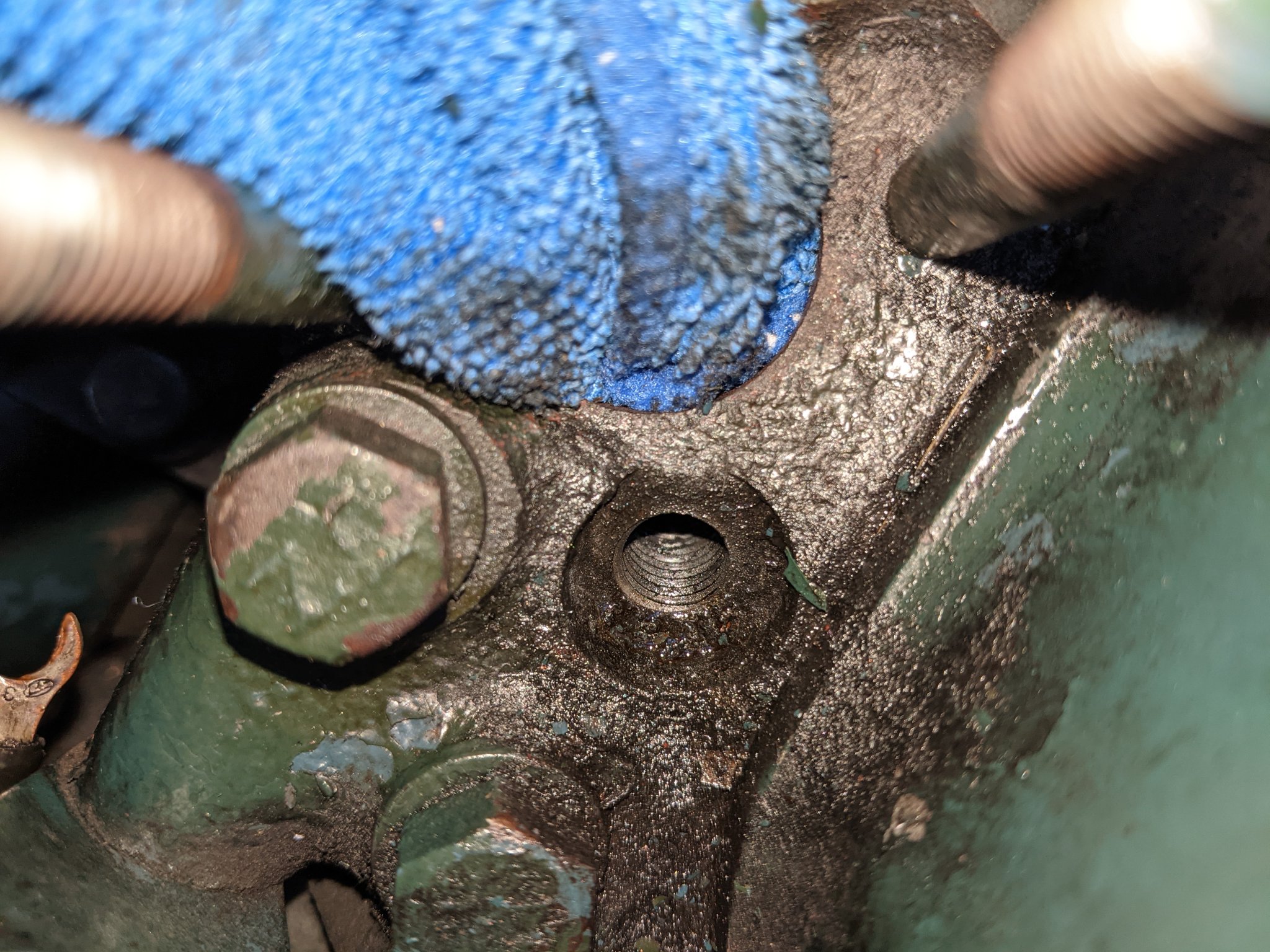

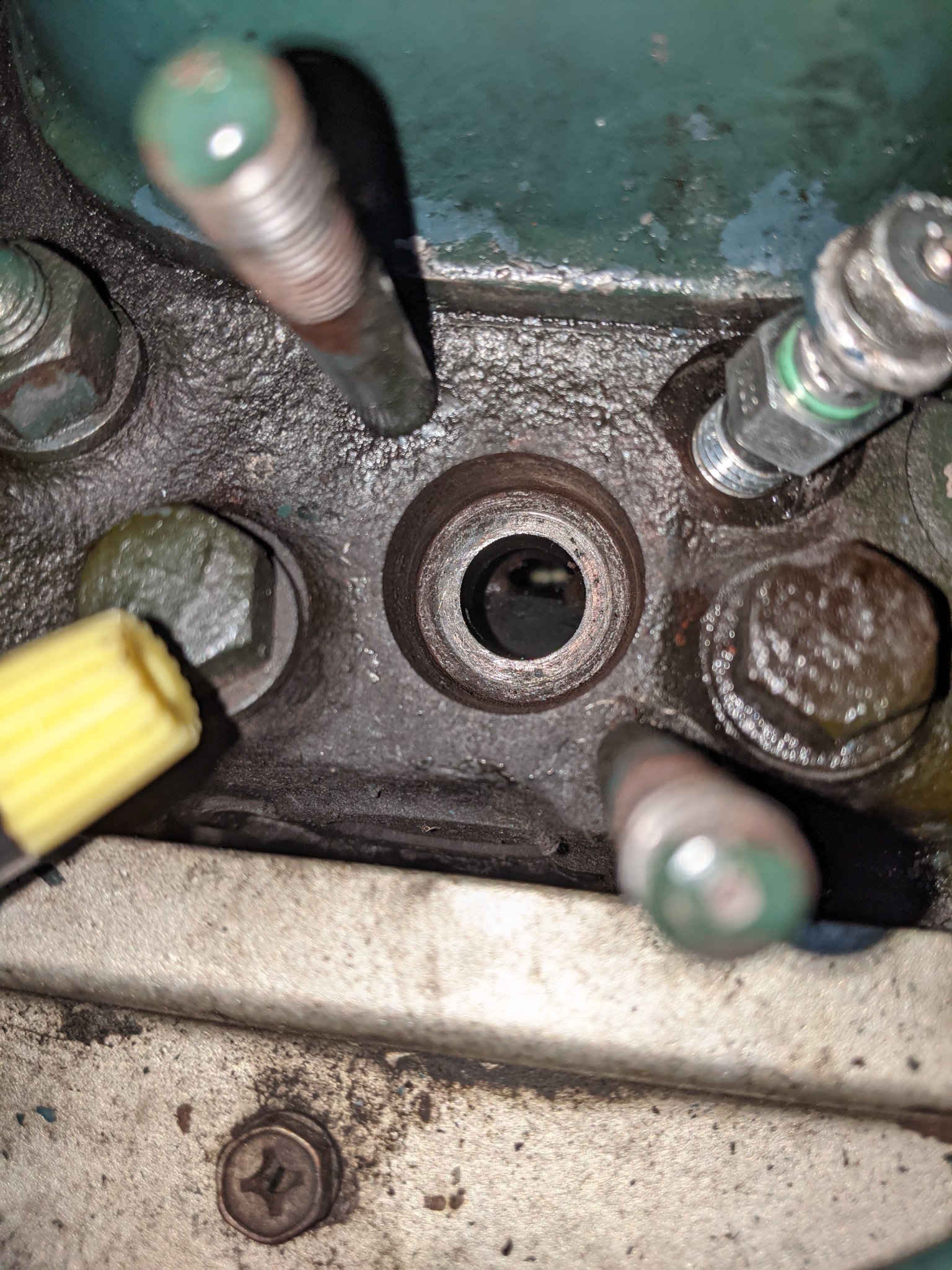

In the meantime tonight I cleaned up the seats where they go and cleaned up the threads for the glow plugs with the tap.
The glow plugs now thread in by hand until they bottom out.

Put anti seize on the glow plugs. ;)

I was thinking about using my shop vac and an adapter that I have that looks like about the same diameter as the injector hole to suck out any bits of crud that might have fallen in there during this undertaking.
I'd turn it the shop vac on and give it a few rotations of the crank by hand.
Shouldn't hurt anything I don't think.
The radiator side cylinder looks pretty dirty in there from what I can see.

Anti seize on the injector really won't help much as they don't thread into the head they have hold downs.

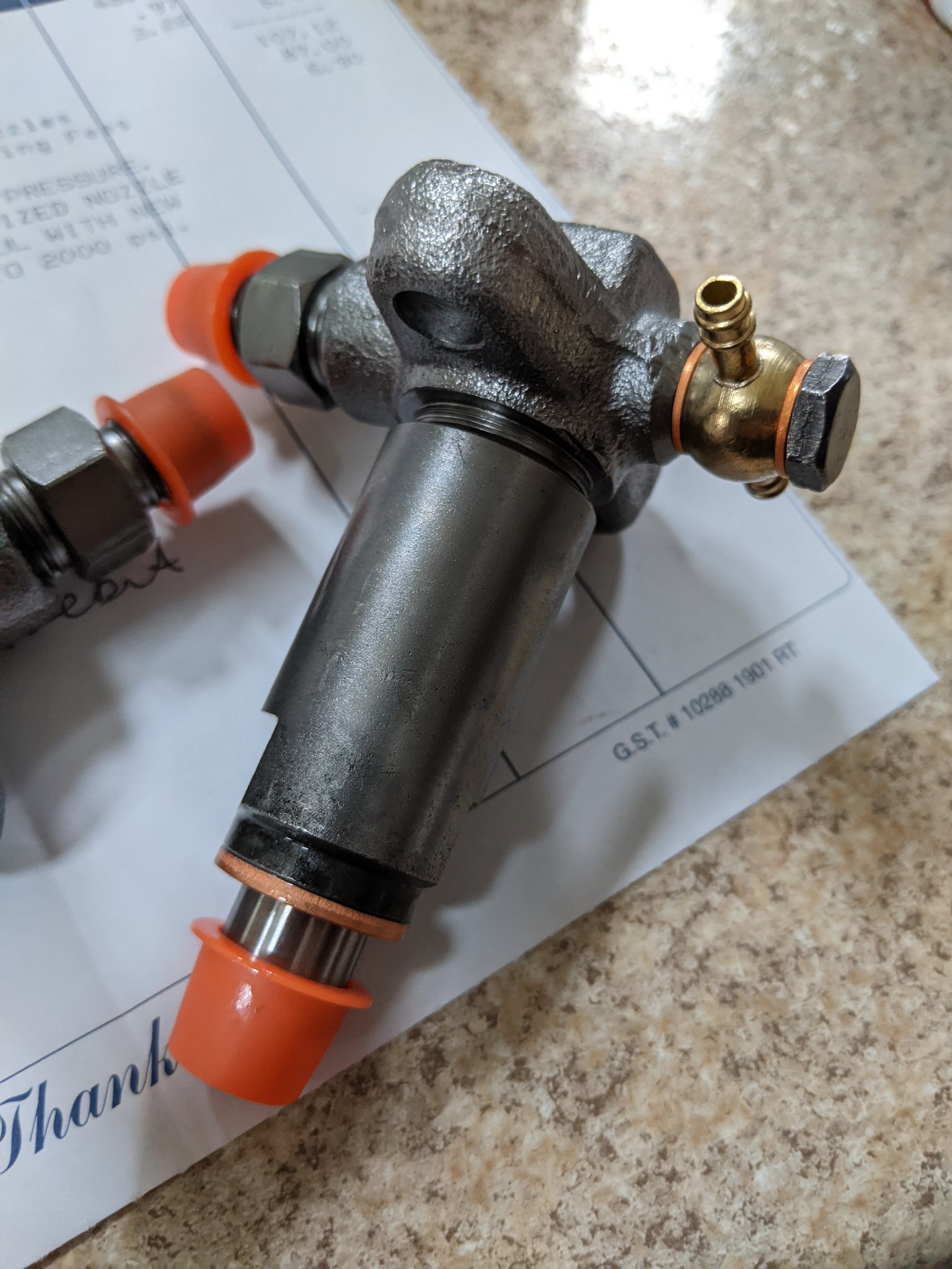

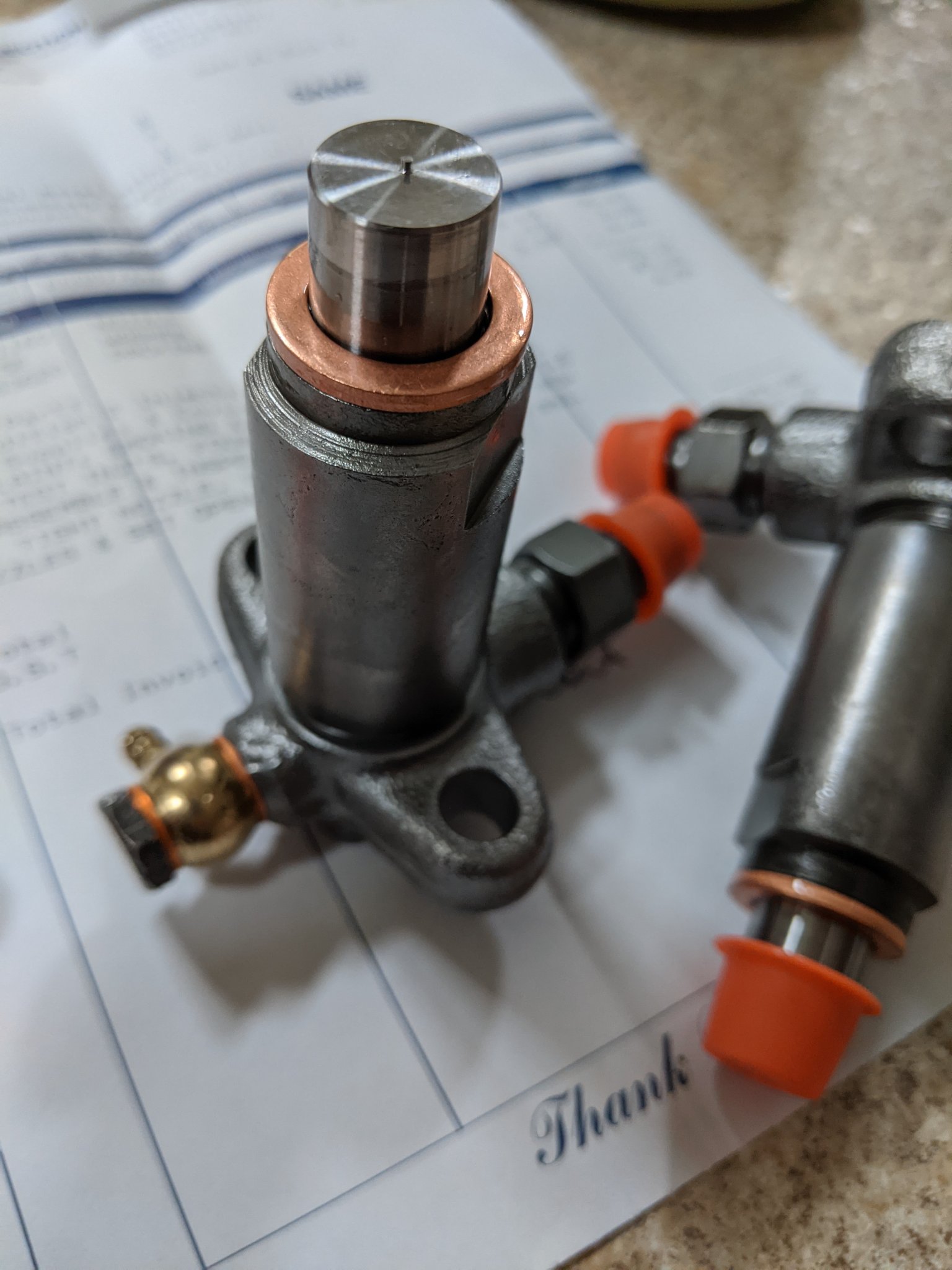

My father in law picked them up for me today.
It looks like they did a great job fixing them up, they look like new. And based on the report I'm surprised it started at all.
Should make a world of difference.
trevoroni
B6000
May 24, 2023
178
183
They even included the new copper gaskets from Kubota.
Another great service from a local company. (y)

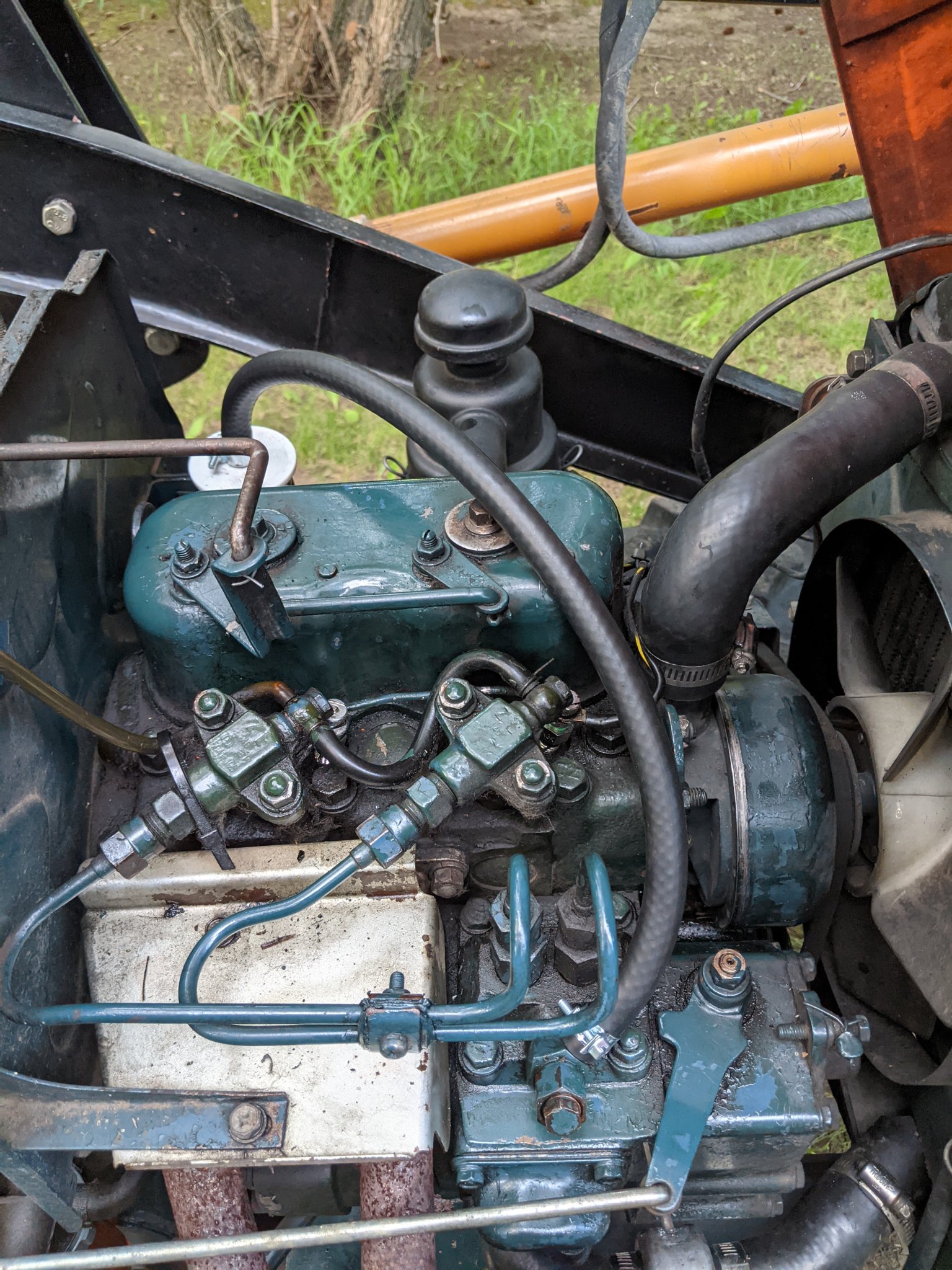

Got the new injectors installed.
It's a little bit better but not as much as I expected.
I think I need to bleed the lines some more.
There's a consistent line of bubbles in the return line to tank.
