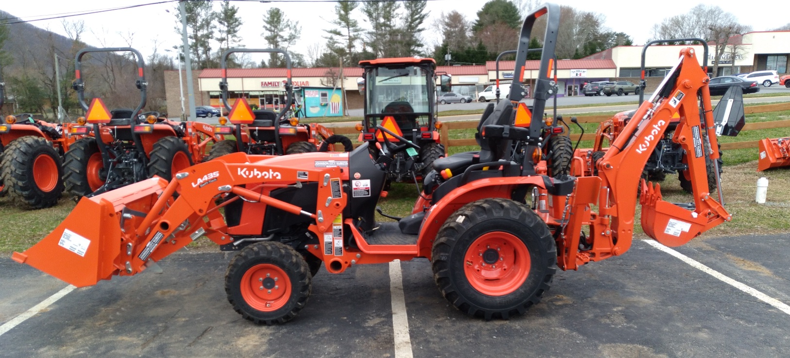

Hey all just bought it Friday it gets delivered this Friday.
They are filling the tires, I asked for wheel spacers and it is not an option?
Every old tractor I always had, flipped rear wheels or added spacers and filled tires.
I asked why? And basically they won't fit with the the backhoe...that makes no sense to me, travel is not 180 degrees so they won't hit,why is it not an option?
Also hope getting the modified tires that look like a mud truck tire wasn't a mistake, always have had R1`s
Everyone likes pictures, here it is in parking lot,thanks

We love our tractor porn,, nice rig,,, yes I put 2 inch spacers on mine with filled tires,, dealer said they would interfere with the MMM ,, nope works fine, you are moving the wheels outward not back, so the outriggers should clear, I dont see a problem,,, but then what do I know,, And welcome to the orange

As Skeets stated, the only issue could be with a Mid Mount Mower (mmm). I would get a second opinion from another dealer.

I have the 54” MMM deck on my B2601, I think wheel spacers would cause a conflict with the anti-scalp wheels on the deck. As to why you can’t use them with the BH, it would seem they will fit, but perhaps Kubota, or your dealer, isn’t a fan of spacers with a BH? I think you’ll need an L if you want adjustable width rims, although I’m not 100% sure if that, maybe it’s the non R1 rims that aren’t adjustable on the B? I know the R1 rims on my L can be adjusted for additional width.
As to the R14 tires, I have them. If you’re going to operate in moist to wet soil or mud, you will wish you had the R1s. The R14s load up really easily. I’d probably have gone with the R1s if I knew what I do now when I bought it a couple years ago.
