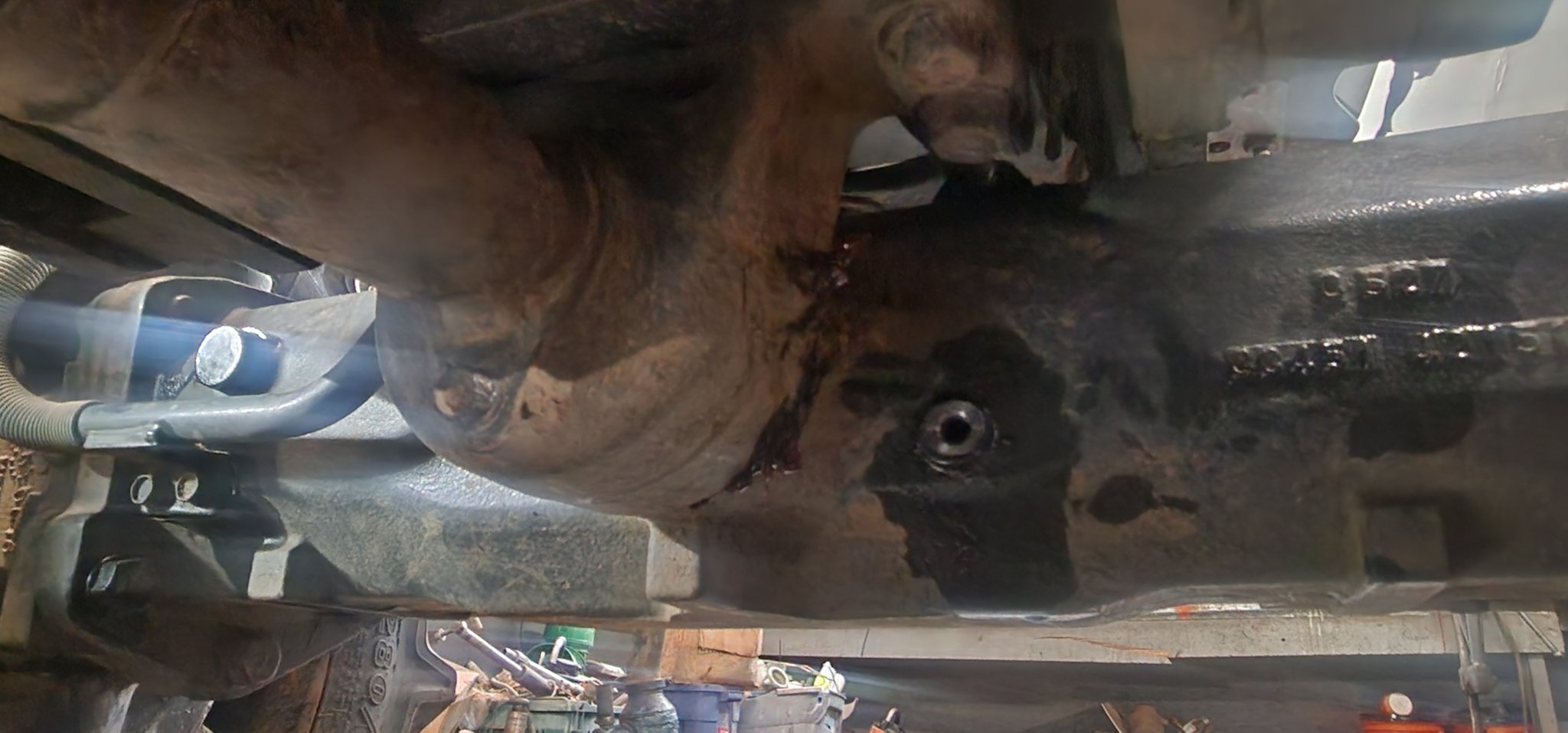

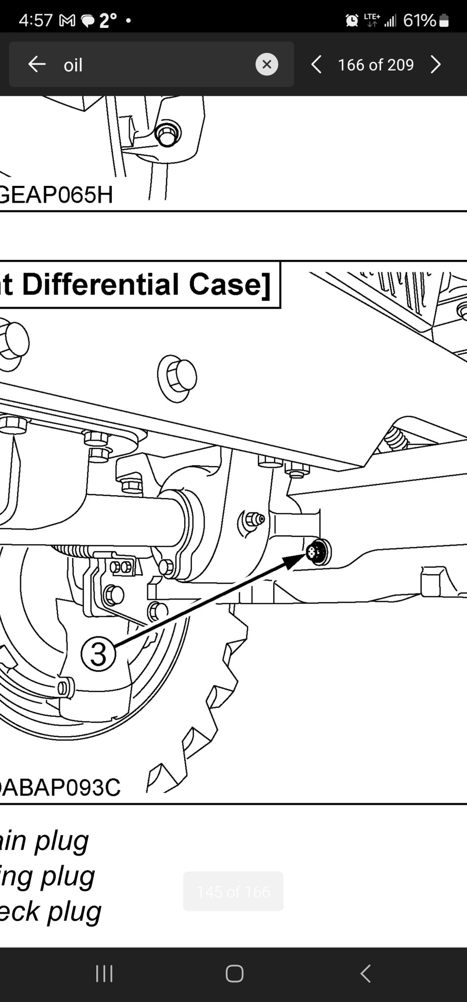

So..... was doing my my yearly matinance and checking my front end fluids the differential and what I guess would be called final drives is all connected so I usually check the sides and don't check the middle "check" plug. I was so confused at first because I couldn't find a drain plug for the front end but it drains when the sides drain and if not then someone forgot to put in a drain plug. Anyways...... to the point.

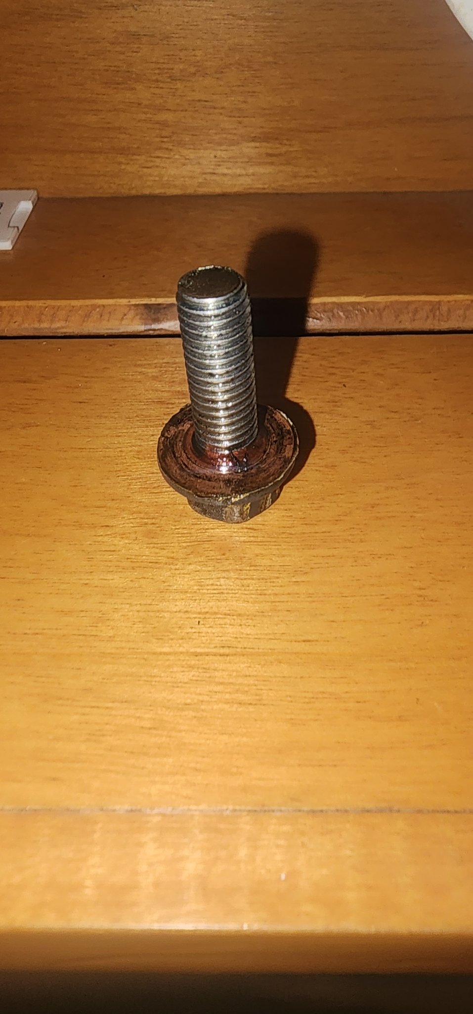

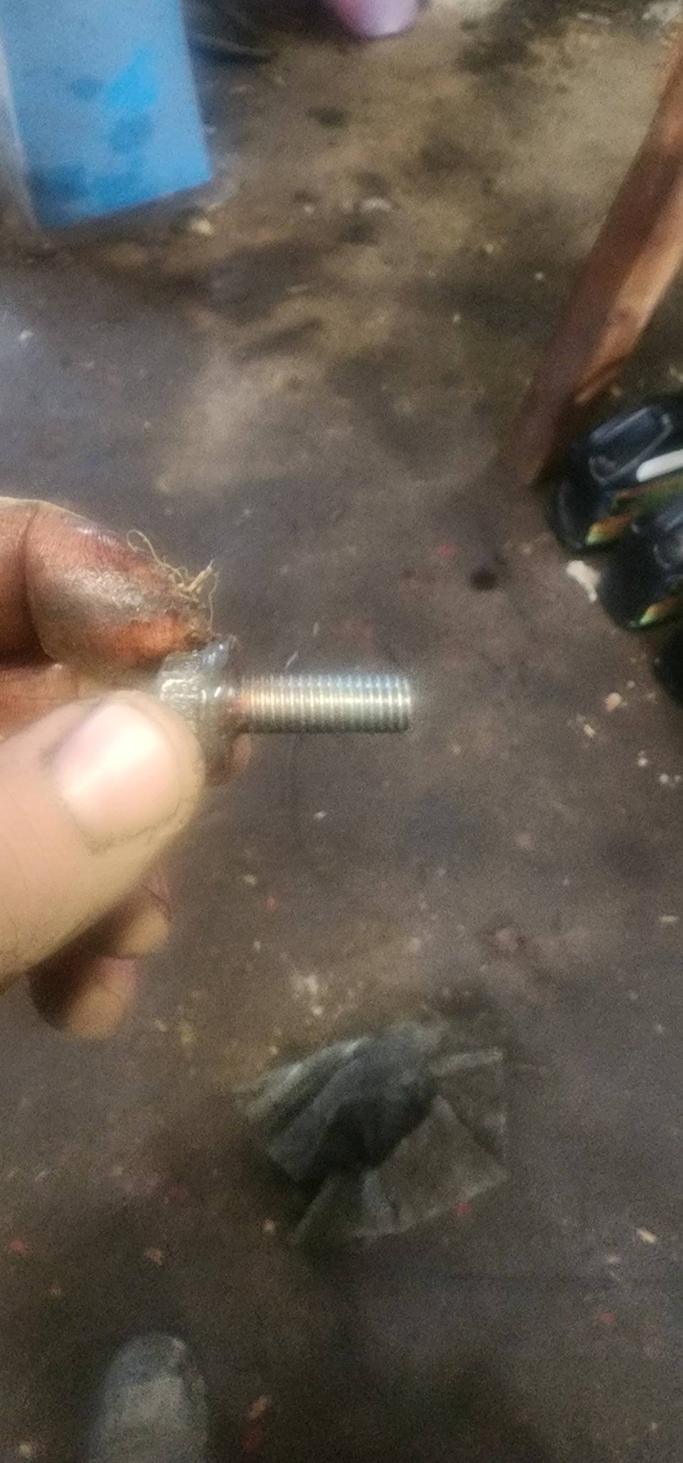

I took out the plug labeled "check" in the manual just to make sure oil was getting everywhere it's supposed to..... it wasn't a plug.... it was a bolt with a nut on it and a copper crush washer on this side. The hole is threaded but not for that bolt. So now theres a nut and maybe washer on the inside.... weird that the nut didn't just spin. It felt a bit strange when I was taking it out but it's what I'm supposed to take out to check it so I did.... sooo this is a new one

It almost sounds to me, like whoever did that removed that bolt that was there originally, and lost it. So they had a longer bolt, and in order to not have it extend too far into the housing, they put a nut on it to make it essentially shorter, and the crush washer on the inside of the nut, as if the nut was the bolt head…

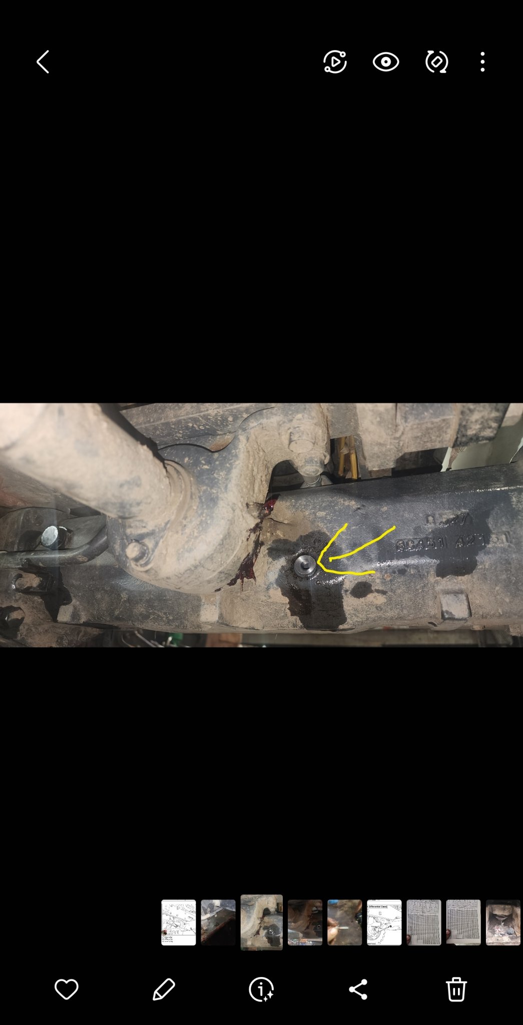

Turns out on the narrow version that's actually the drain plug, same position but lower. I kept looking for a drain plug and then decided to check if the axle was just thick. Stuck a screwdriver in and that plug is at the bottom just on the side not underneath. In this case the large fill plug is also my indicator which is not uncommon but not what my manual showed. Fill plug is also on the side for this to work. My large john deere is exactly the same except has a large drain plug on the bottom... fill is also the level..
All good information but dosen't fix the nut being in the axle.... the plug from the drains for the finals fits the threads perfectly whare a plug should have been

It is missing now.... the bolt that was used just sticks right in, is too small for the threads of the hole in the actual casing. I found this out because when I thought it was the level check plug as the manual suggests I went to put it back in as soon as I saw oil and there was nothing for it to screw into. It is in fact the drain, the regular non narrow M5 has alot of similarities so it must have gotten copied over. I kept looking hoping I was missing some hidden big drain plug so I could use a magnet to get that nut but unfortunately no large drain plug....which is really weird tbh

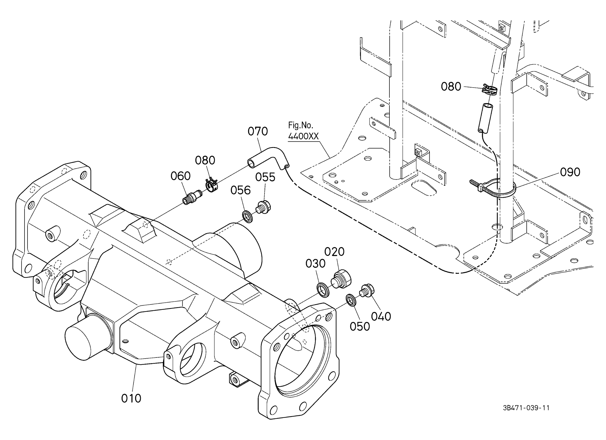

I'd be paranoid about a lose nut 'rolling around' in that axle housing and it 'magically' travel to the end and destroy the FWD gears ? Looks like # 055 is the proper bolt ??

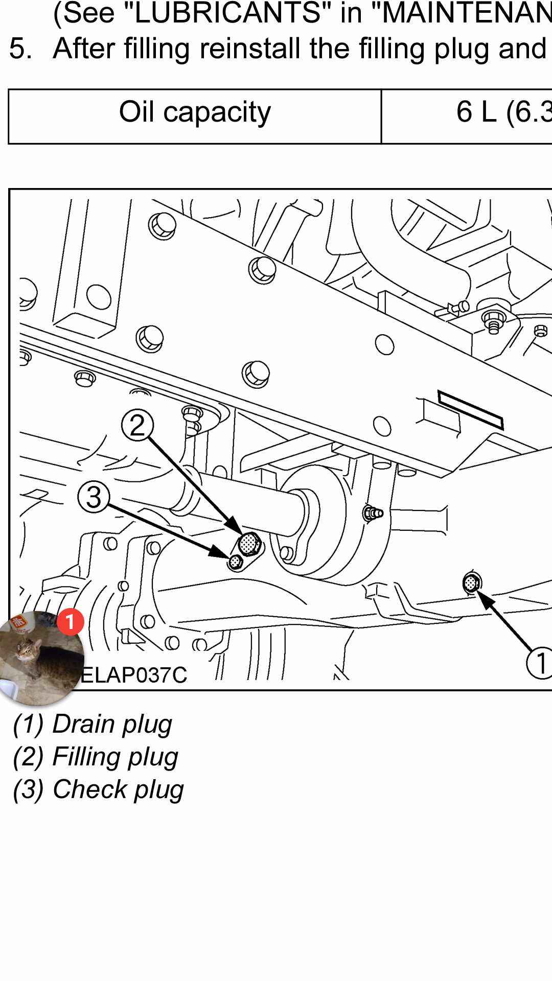

The manual even shows a 1,2 and 3 labeled fill, check and drain with pictures of the location of the first 2.... does not show a drain location. Sorry to have 2 things at once but that discrepancy irritates me

Fun update, took my bore scope to see if I could see the nut... theres still a couple inches of oil in there. That actually is the check plug... so whare is the drain plug? Is there some sort of flush cap hiding it? If I could find a larger plug I could get this nut but I can't see any lower plug. Anyone who has one of these know whare the drain should be?

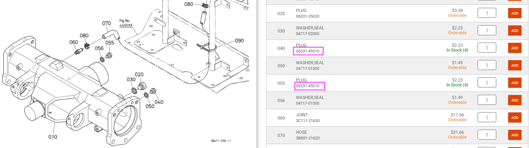

Looks like plug #40 is the same as your check plug (#55). You could use that plug to verify the threads of the check hole are good and correct.
