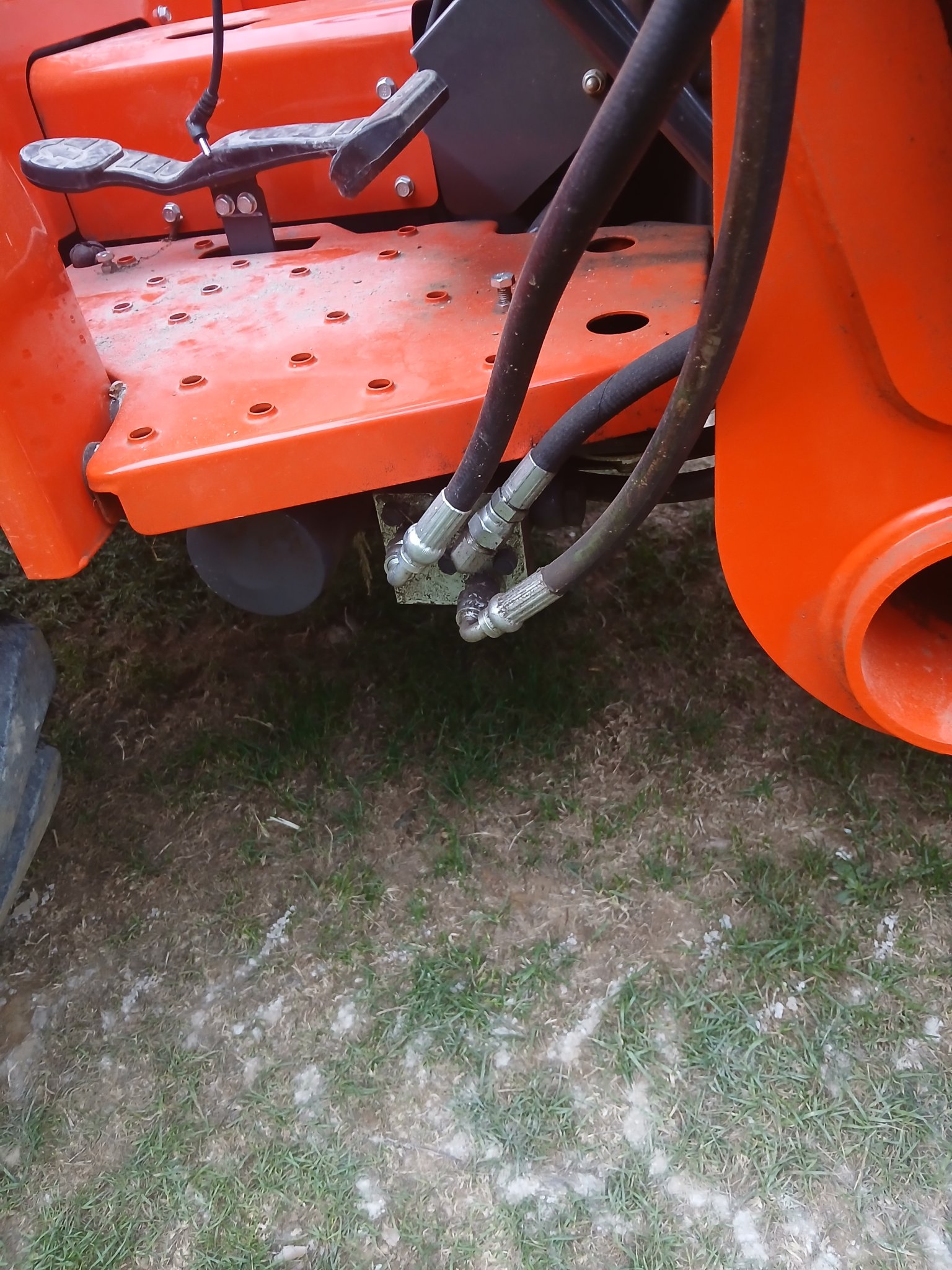

Its an easy test. The loader PB is hooked to P on the third function and T is connected to the hydraulic outlet block. Diisconnect both those hoses and connect the PB hose to the hydraulic outlet block - lower rigt port in the picture.
Now PB is going straight to tank. Start the tractor and test loader up/ down. Dont curl tje bucket because that will dump oil put the tank hose. You can put it in a bucket to be safe.
If the loader works plumbed like that the valve is fine and there is more detective work to do.

Use tje hydraulic outlet - its right there and both hoses have JIC swivels. Less than 5 minutes to make the connections.
