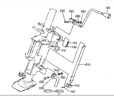

First: I don't think you mean its a main gear shifter problem, main gear shifter on a GST only controls N&1-8.
Now the shuttle shifter controls forward and reverse.
It also does not care about the Mechanical clutch, in fact you don't even need to engage or disengage the mechanical clutch to shift gears or to shuttle from forward to reverse.
Start with some simple trouble shooting:
With the tractor running and without ever touching the clutch pedal, and with the shifter in N try to move the shuttle to forward then back to neutral then back to reverse, does it move from forward to neutral to reverse fluidly?
If it does not, move the shifter to 1 and try again, again with engine running and without touching the clutch pedal, move the shuttle to forward then back to neutral then back to reverse. how does that react?
If it binds start with the mechanical aspect of the system, remove covers and look at the linkage and look for worn, broken or binding parts.

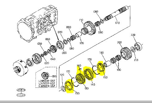

If the external is good then you'll be looking at the internal syncros.
If you don't have the WSM (AKA Service manual), send me a PM and I'll give you a link to download it. ;)

Sounds like you have a syncro that is worn or broken.
Did this condition start all of the sudden, or was it getting harder and harder as time went on?
How many hours are on the unit?
