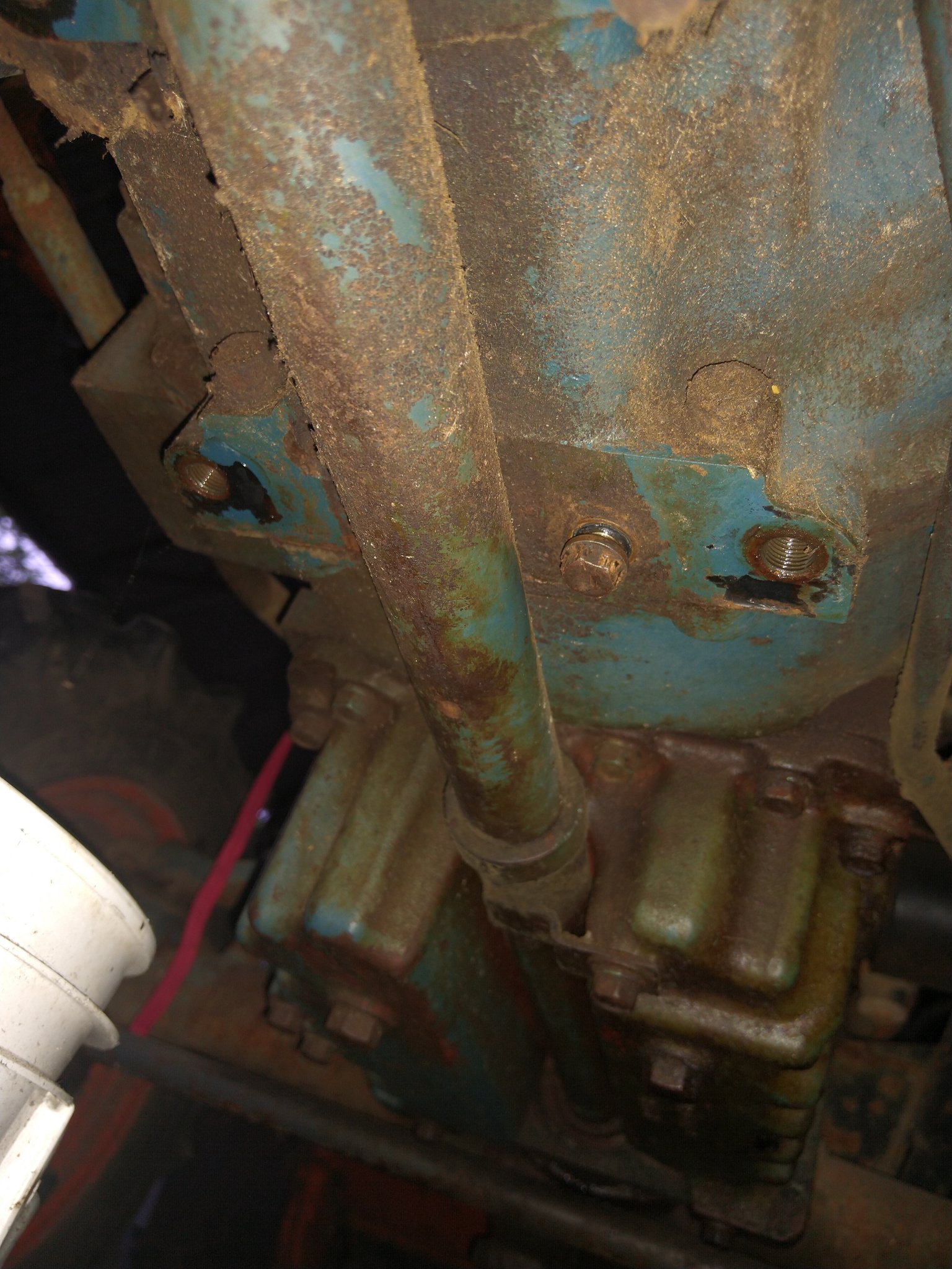

I've seen posts where people recommend filling the bell housing as much as possible with Coke to eat the rust, then draining and rinsing. I looked last night for a drain, and thought I might have found one right below where the clutch is, but the hole bottomed out just below the threads and doesn't go through.
It is a fine threaded 12mm head bolt, so not big enough to mount anything from. It's right where the FEL bottom part of the frame mounts, but has nothing to do with the FEL. It's halfway backed out in the picture below. It's almost as if it's there to be drilled through if someone wanted to have a drain.
Anyone know what this is for?
As bad as the surface rust is, there's no issue with disengaging the clutch to change gears. Just the PTO disengagement that's the problem now.

Any ideas on that bolt hole I mentioned in the previous post?
33,047
8,477
I don't find any mention of that bolt / plug in any of the prints I look at.
Could be that that housing was for a different model.

The 12 mm head bolt you refer to is a drain. I think if you remove it you will probably find it goes through to the clutch housing but is probably full of garbage. When these tractors were new we took the plugs out so that housing would drain.
I was hoping it was a drain. When I pulled the plug, it looked to be a threaded but not a thru hole. Clean metal is all I thought I saw.
I'll pull it again tonight and probe with a pick.
EDIT:
Yep, it was a drain. The clutch assembly itself must be very close to the bottom of the bell housing. I didn't see a gap but did feel it with a pick.
Thanks everyone for the help.
