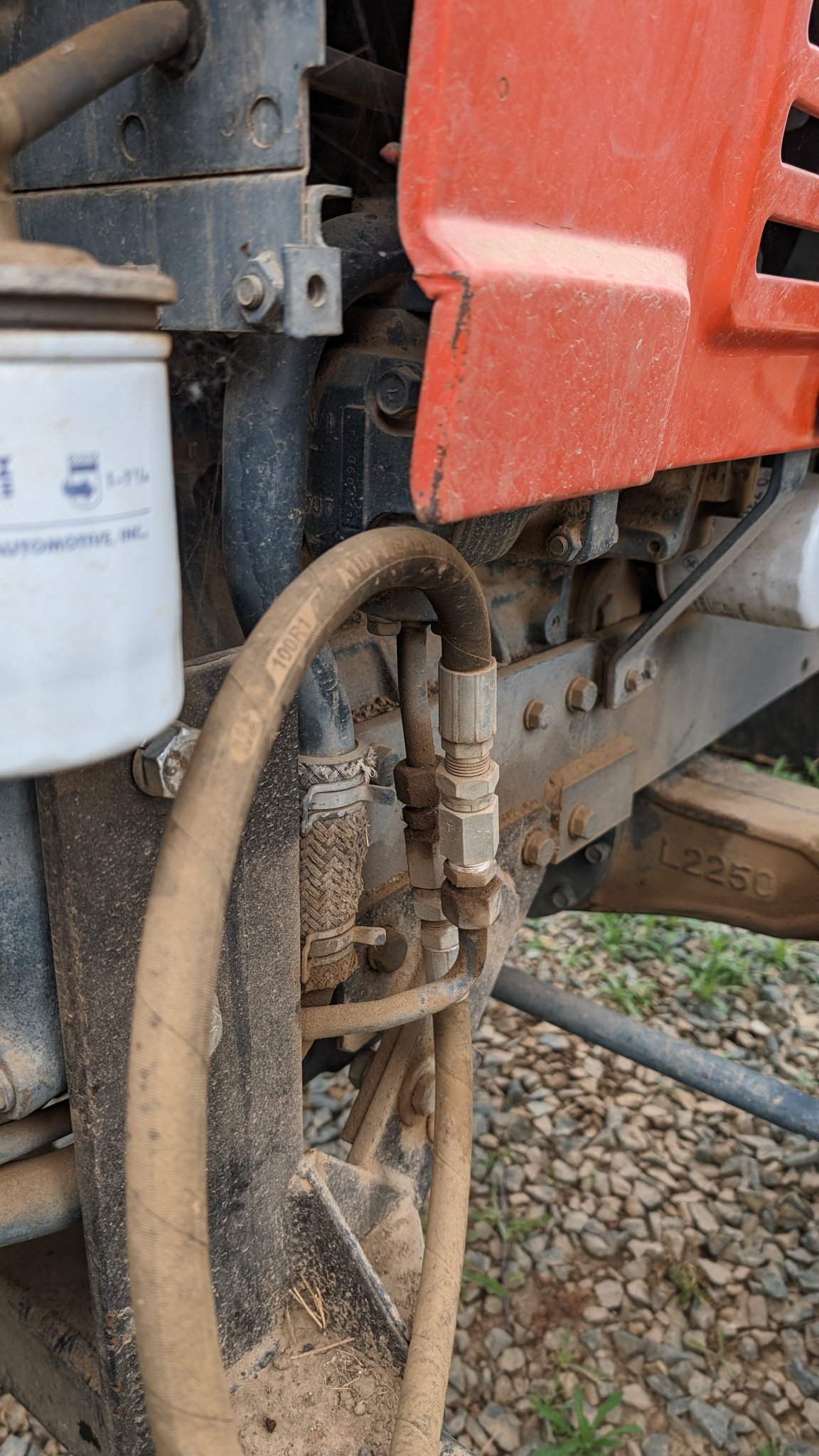

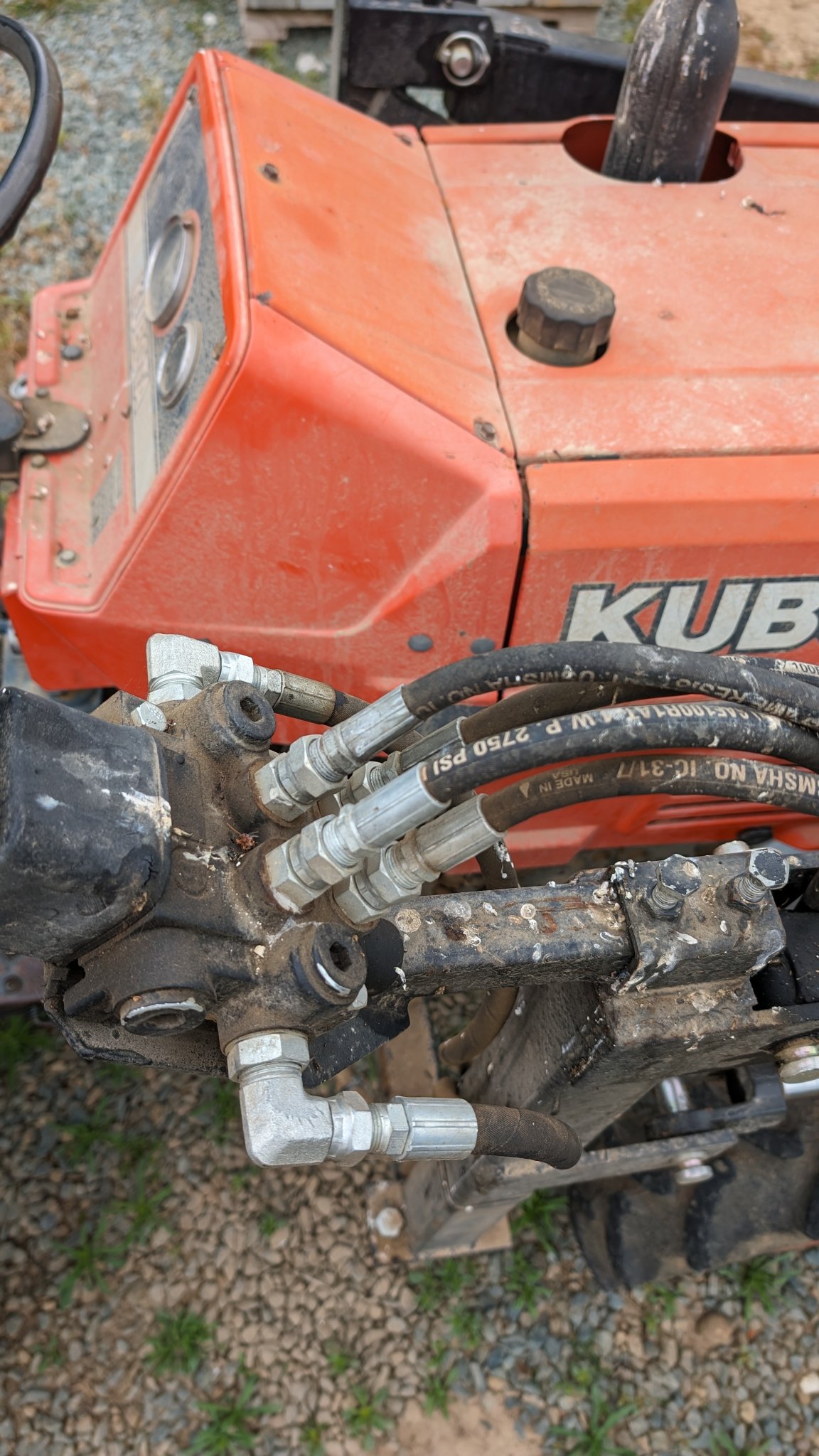

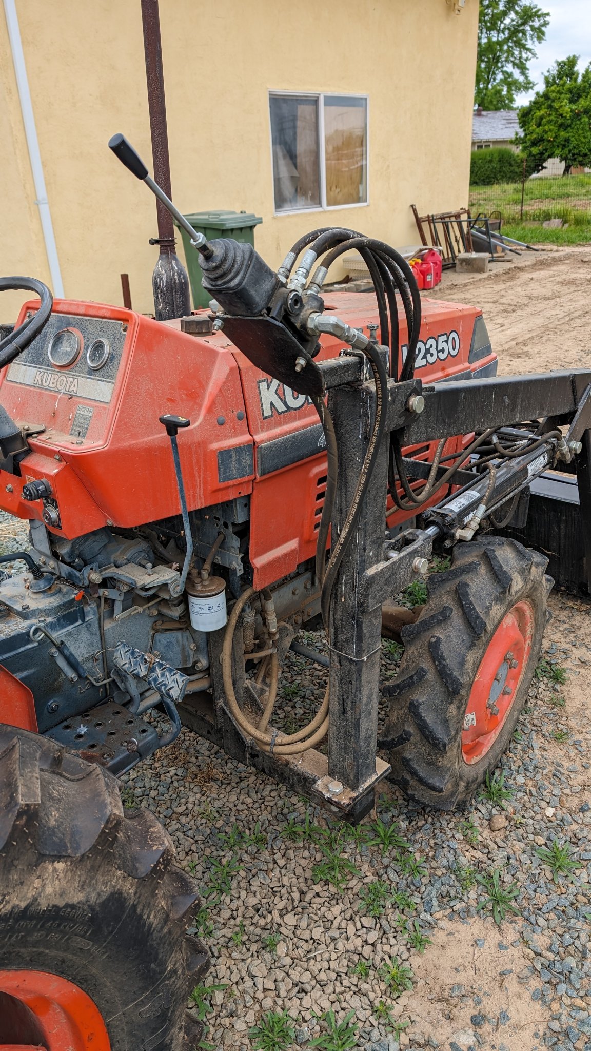

I attached a copy of the circuit I found in the L2350 Manual. The FEL is attached in-line just above the Hydraulic Pump. I cut the line. I'll send pictures later today. Would a picture of the loader controls help?

We know the circuit on the tractor. We don't know how the plumbing on your loader valve fits into that diagram. Just post a picture of the plumbing on your loader valve and it will answer those questions.
In the meantime disconnect the feedback rod from the lift arm and see if the shuddering stops.

Perfect. Your valve has an inlet relief but no power beyond outlet. Its feeding the PS and 3pt off the tank port.
Since its ahead of the priority flow divider stalling the loader will make both PS and 3pt inoperable. Apparently that has not been a problem for you.
it looks like the valve could be converted to power beyond and replumbed as it shpuld be but that wont fix the priority issue. The only way to do that is to move the valve supply to where it should be.
Since you have bypassed the loader and it did not fix the shaking problem the issue could well be feedback related. Adjust the linkage as NIW suggests and see if that resolves the problem. Hopefully it will.
