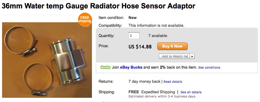

I bought a metal adapter piece that you cut a short portion from the center of the upper radiator hose and install it there. I found my adapter on Ebay.
This is on a B7100.

Here is a picture from ebay. You will need to measure the inside diameter of your radiator hose to know what size to order

There are literally millions of cars and trucks that have the temp sending unit threaded into the water jacket in side of the block, This is especially true of many of the inline 4 & 6 cyl machines, Considering that is more likely closer to the combustion chamber/process that is where the most heat is generated and stored, While the radiator hose sending unit is convenient it is isolated via rubber from the actual engine block and would most likely be a lower temperature reading in my opinion.
If you use one of the radiator hose adapters don't forget to connect a ground wire. They have a small tapped hole just for the ground.

Before somebody is running in circles with the hands up in the air, I would like to mention to measure the temp-difference. The water is moving and the temperatur at the radiator should be everywhere nearly the same.
