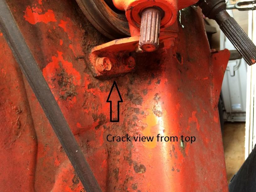

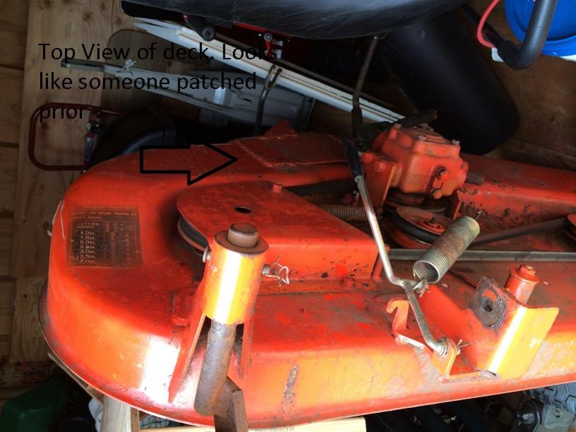

2) Mower deck is in a bit of rough shape. There is a 2" by 2" rust hole under the mower shaft. Also 3 sides are cracked around the mower gear box (Pictures attached) Can this be repaired? The middle blade also sits lower than the rest because of this.

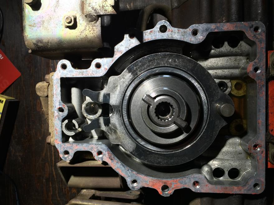

3) Drive shaft going into the hydrostatic transmission has a little bit of play in it. Very minimal. I hear no noise when using the mower and it functions as it should. Seller suggested replacing the Sub assembly cover (Part#70090-33030) Supposed to be a known problem with the hydrostat on this model. I looked for this part# on the Kubota website and did not reference to anything on the mower however I was told it is an updated part due to the fact that Kubota had issues with the prior model of sub assembly. What are your thoughts?

#2. Anything can be repaired with enough work, are your metal welding and cutting skills good?

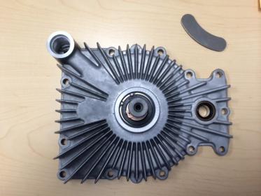

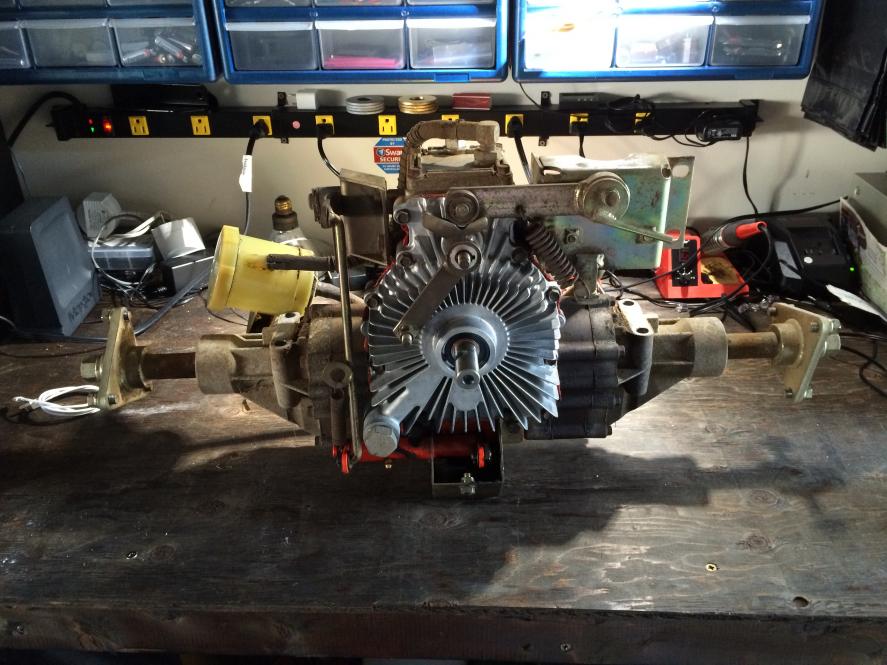

Removed the hydrostat from the mower and replaced the new updated cover. I have pictures attached of the new cover front and back. Also in the process found why the parking brake was not working. It was simply locked up.
I used Kubota UDT trans fluid. Seems to have good pressure in the trans. Did not have any trouble going uphill after the repair and no more play in the driveshaft.

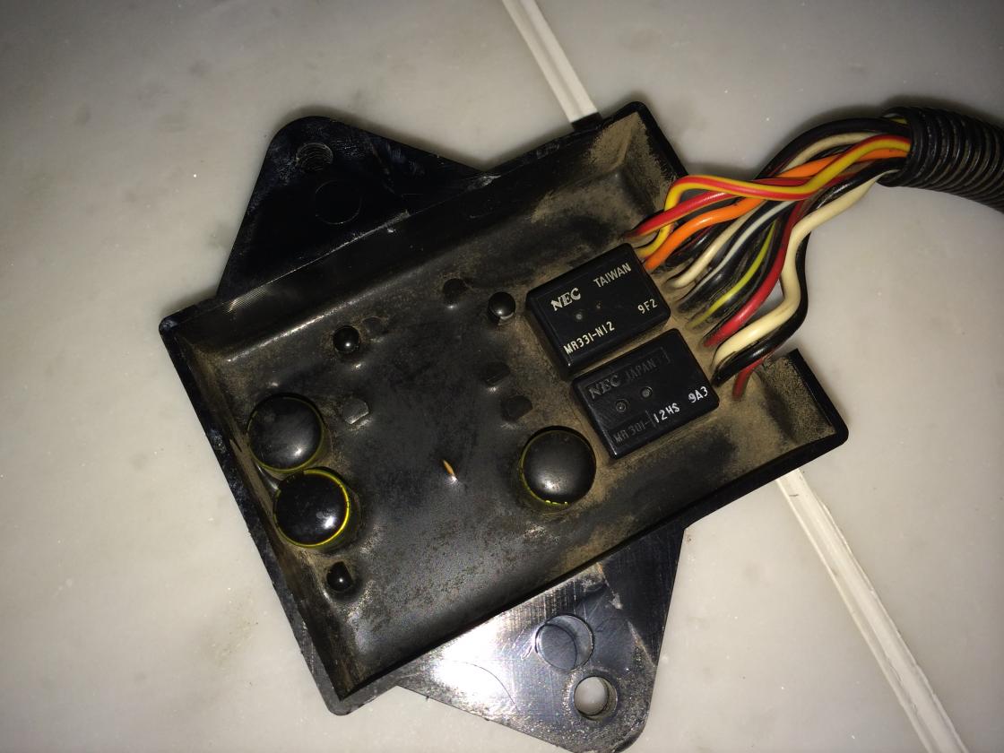

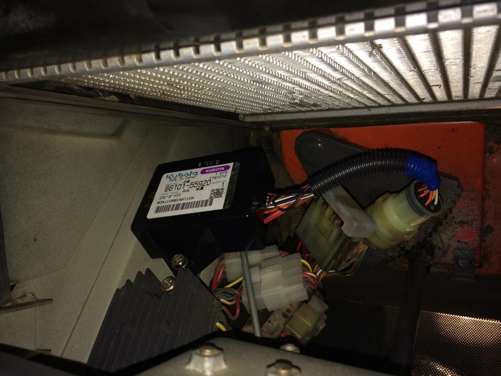

Where would the relay live for the diesel shut off? I think you are right about the timer because sometimes I will turn off the key and it will shut off after about a minute.
33,383
8,695
The relay should be behind or under the dash panel. ;)

There is a black box under the dash panel with 2 rather small relay switches in it. Does not look like they are replaceable. According to the circuit diagram, that directly feeds the engine stop solenoid.
Unfortunately I don't believe this part is available thru Kubota.

That is cool. Thank you. Already ordered. I could not find it.
All the switches (Seat switch, PTO switch, brake switch are providing the correct signals to the combination box. I checked with the WSM. So it should be the culprit.
My mower deck is in bad shape. Too much rust and also looks like it's twisted. I was able to order a new complete deck from the Dealer. Since the mower has low hours, hopefully will last me a while.

Don't totally give up on that deck. You might be able to get a few bucks for it from someone with some good welding skills. The cracks and sheet metal damage are relatively easy to fix if you have the skills and the equipment to do it.
If you have a friend with the skills, a case of brewski's or a couple of ball game tickets usually gets stuff like that fixed...

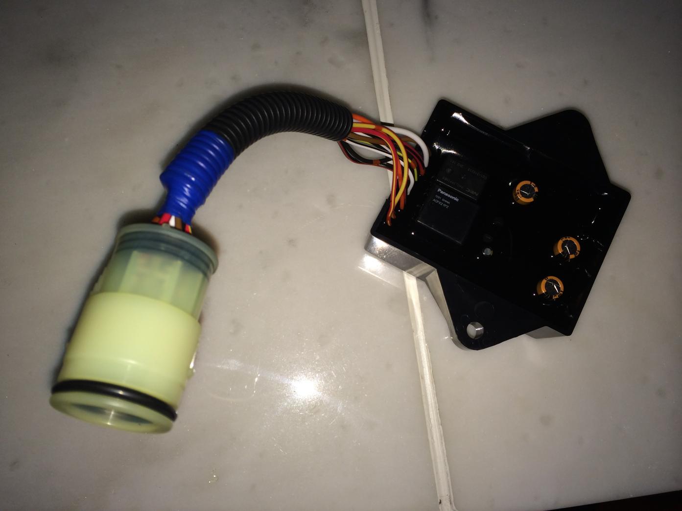

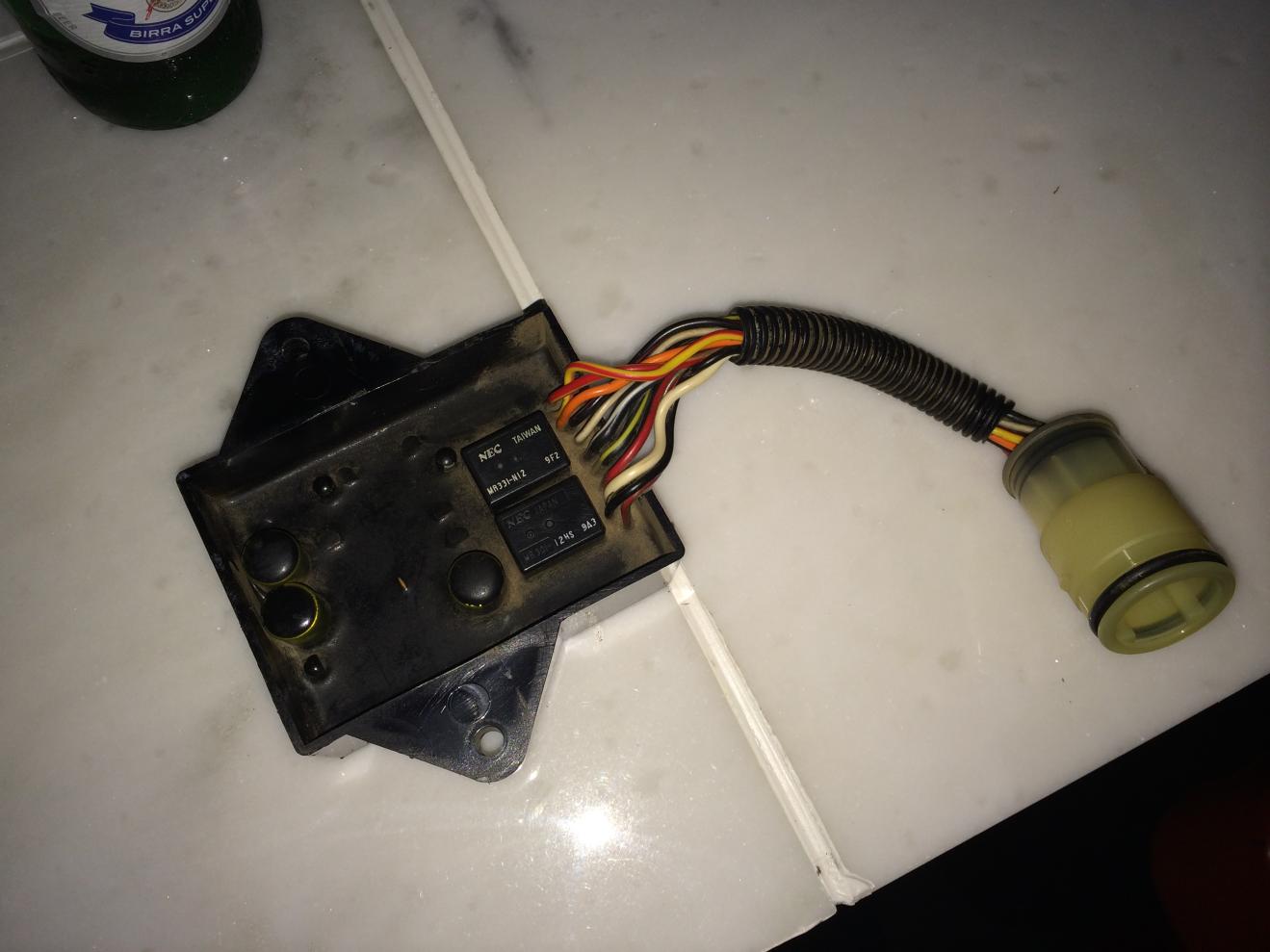

The combination box arrived today and installed it. It works great.
Interesting that the Kubota sticker on the front of the com box states "Made in Japan" One relay states "Made in China" and the other " Made in Philippines" I hope it holds to the vibrations and heat of the diesel Z482.
Since I know I had a faulty combination box, I am going to dissect the old one in hopes of finding a bad relay or a faulty solder joint.
As far as the deck, its rusted pretty bad. Looks like the previous owner left the deck outside in the rain. Its rusted from the top and the bottom pretty bad. There were chunks of rusted metal falling off it. It doesn't look that bad when you look at it but the cut is not even ether so it will take a lot of work and time to get it working again.

Deck cracks can be welded, but if it's rusted any, the welding process just prolongs the inevitable. I have a G1900, love it, but the deck is rusting. The more I fix cracks, the more that goes wrong with it. Fix one thing, couple weeks later, 3 more problems. Would love to find another GOOD 54" deck for it, and I might consider keeping it. Also have an older JD LX188 that looks, runs, and drives like a brand new LX188 did, so I have a backup...as long as JD offers parts for it anyway. Luckily I haven't needed much.
