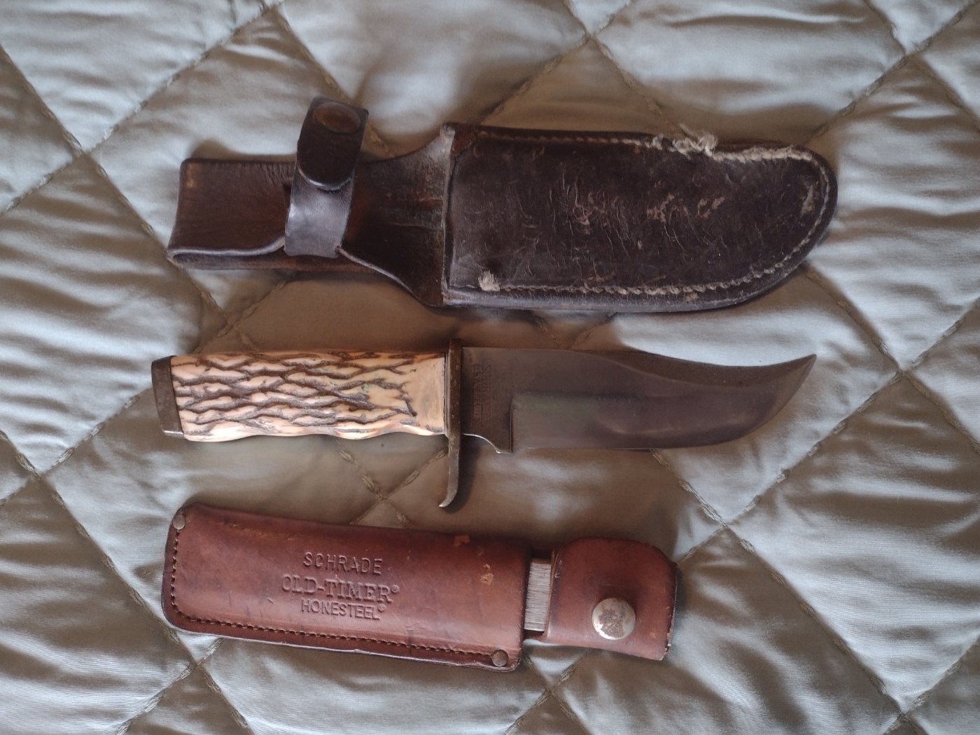

Not a collector but I have a couple of Schrade knives. One has been misplaced but should show up if I search long enough.
This is my favorite.

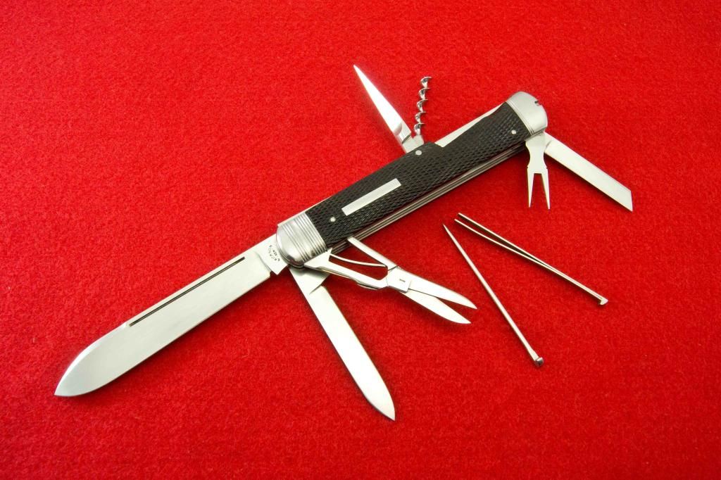

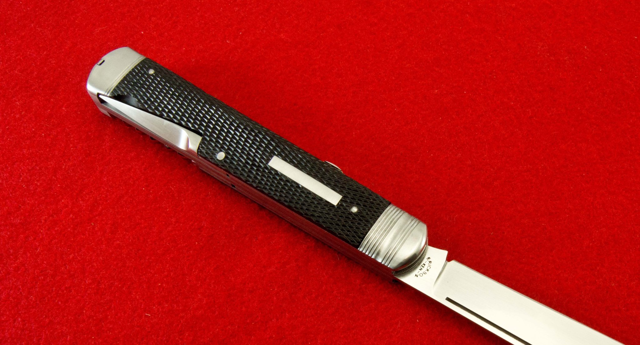

One of my most challenging builds. This is a large multi blade knife based on the old Sheffield patterns called "sportsman" knives. Keep in mind , every part, spring, blade is cut out from sheet stock including the frames and bolsters. CPM-154 for the blades and springs, 410SS for the integral bolster/frames. Springs and blades/tweezers/scissors/awl and corkscrew properly heat treated.
Making scissors at this scale and then having them cut and fit properly into the knife is a discipline onto it self.
The covers on this one is checkered ebony. Ebony is a very traditional material for knife covers.
If anyone is wondering the little forked implement is a cigar fork. Common on smaller gentleman's pocket knives from the mid 1850's to early 1900's..

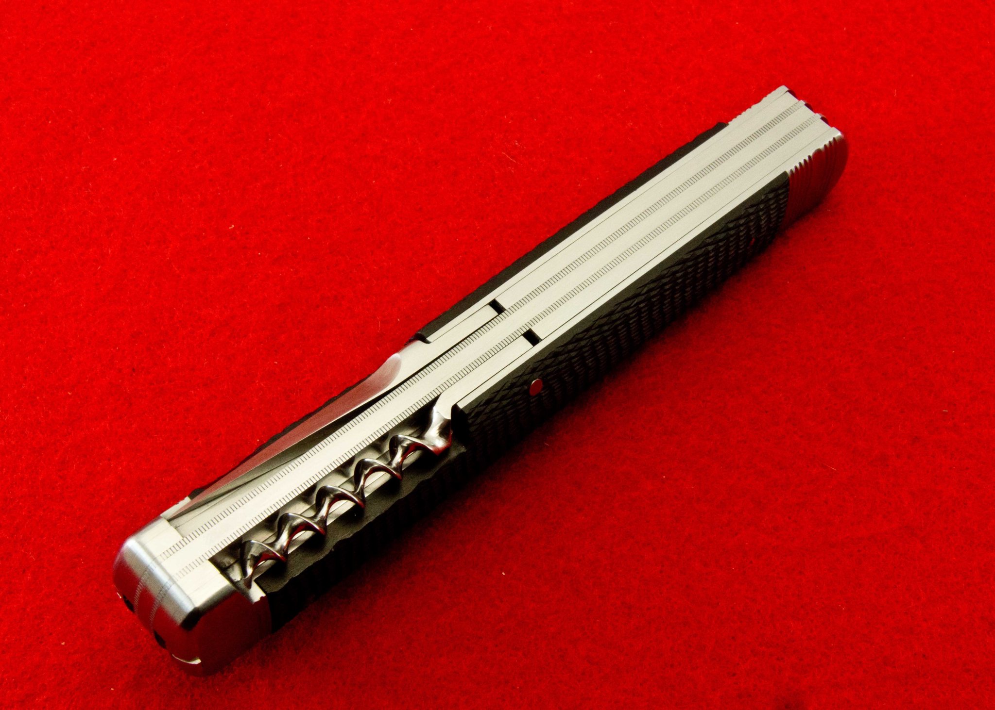

Wow!! That's some quality work there. Did you cut those serrations with a file?

Thanks!
A more proper term is "coined" edge. Coined liners where often used on the exhibition Sheffield knives. Think of a dimes edge for example. The liners are .040 thick and the way I cut them in is with a carbide straight cut knurling wheel . I insert a rod thru the center hole of the wheel as a handle and then basically roll the edges of the liners leaving the coining.

Coined edge makes a lot of sense. Amazing work! 😂

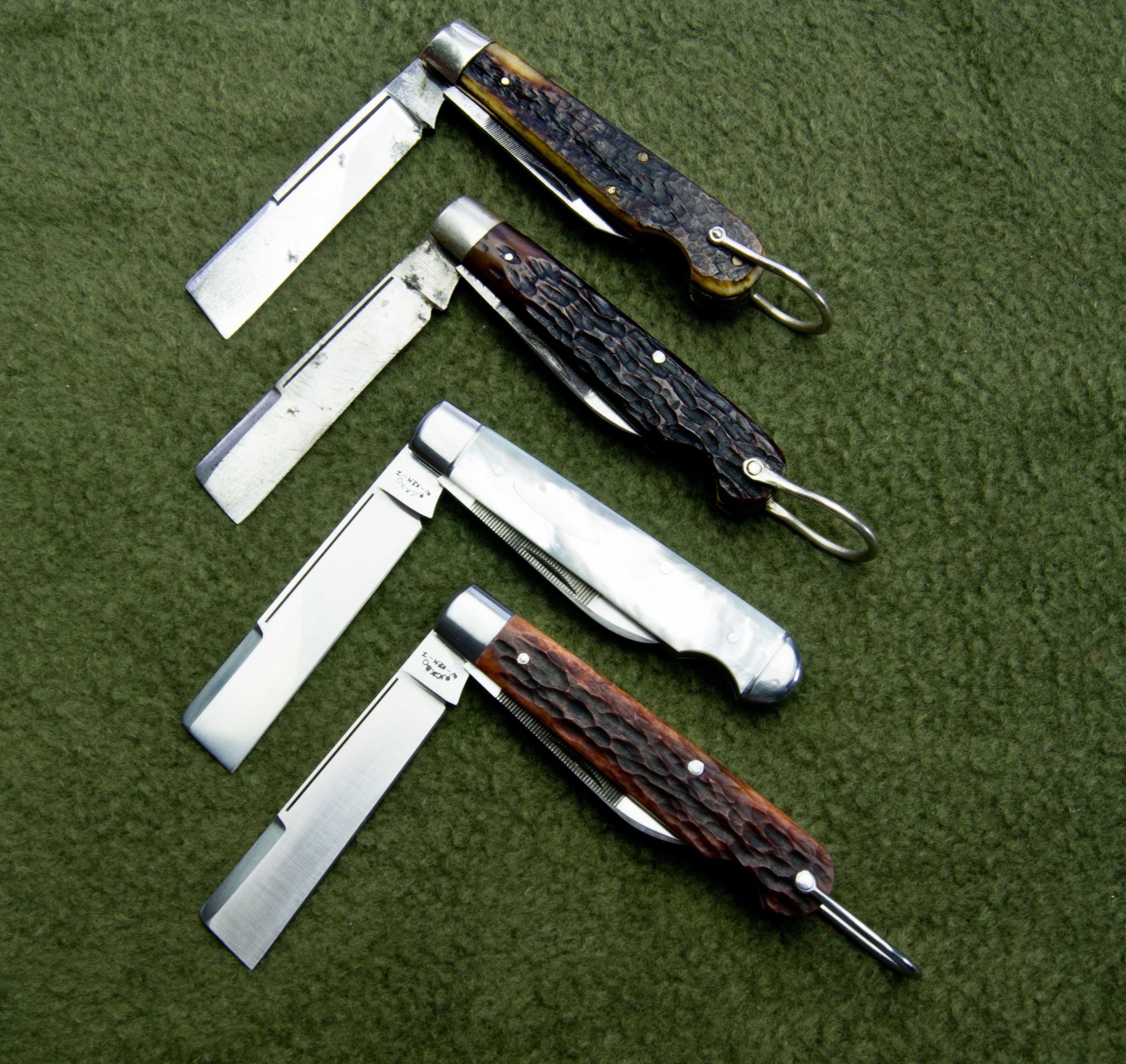

This is an interesting traditional pattern. Rope knife. These knives at one time were issued to British and American sailors. The master blade was useful for cutting ropes, the bail was useful for keeping them from going overboard :LOL: and the secondary blade is a pen blade with nail file. I guess it was important for sailors to have nice looking fingernails. Many rope knives will have a marlin spike in place of the pen blade. Marlin spikes are useful for un-tying tight knots .
The top two are original examples, the bottom two I made. A collector wanted a "fancy" example which is the Mother of Pearl knife while the bottom on is my rendition of the top two originals.

Your post got me thinking about a knife that was popular when I was a kid. It could have been a navy knife or at least a sailor's knife, but it had a blade with a rounded off tip and a stout, slightly curved spike. it could have been a farrier's knife too I suppose. I haven't thought about those knives for many decades. I'll have to see if I can find some photos.

Sounds like it could be a marlin spike. They come to a fairly sharp point but not needle sharp . It could have been that yours was broken off at the tip and perhaps rounded.
Interesting tidbit on the master blade on sailor or navy knives being blunt at the end. I have no idea if true or not, but the story goes this blade is shaped like this due to less of a chance of accidentally stabbing ones-self on a rocking/moving ship.

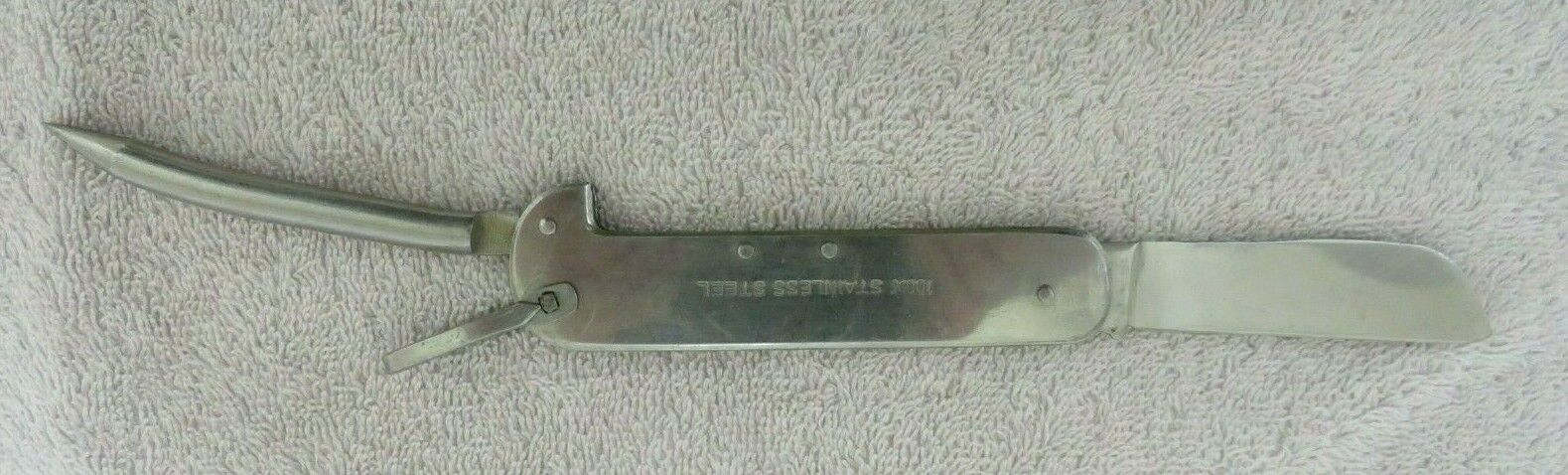

Thanks for the confirmation. I searched for marlin spike and found this WWII British Marlin Spike Knife which is very similar to what I remember, but there were no scales on the ones I wanted when I was a kid.

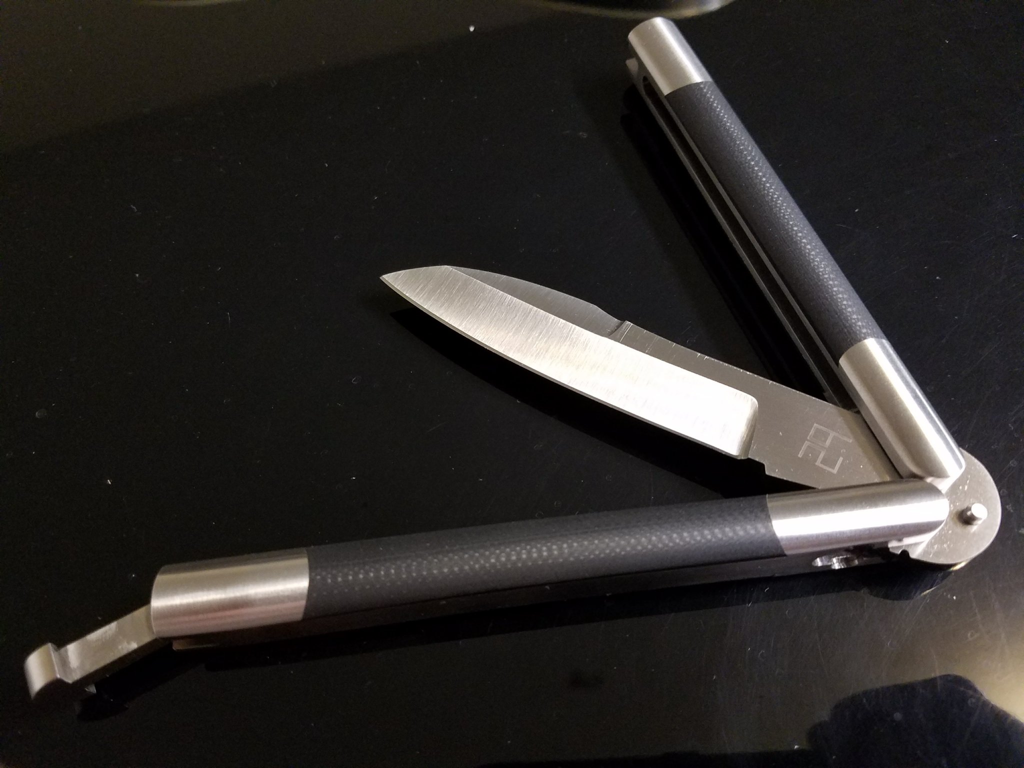

A Chris Olofson bali of 29 knives with a pira blade. No longer in my possession

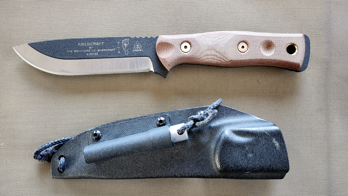

Awesome collection there. Can you list the makes/models from top to bottom. I really like functional, practical knives. One of my favorite bushcraft knives is this Fieldcraft.
