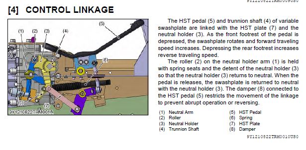

Look of the below diagram and check your linkage for binding / sticking points.

Yeah I need to get some PB blaster. I wonder if that little indent on the neutral holder has some mud or something on it keeping it from sitting in there. Thank you for the diagram I'll look at that tonight.

My 2650 has only 50 hours and I have this same problem. In fact, I came here to post about it and ask for help and I saw your thread. I am going to see if I can figure it out using the diagram posted by NIW. If it looks like I might do more harm than good, I will just call my dealer.

Not to ruffle any feathers but, this sounds to me like a periodic maintenance issue. Just something that needs adjusted from time to time. I am referring to the centering spring adjustment and adequate lubrication of the pivot point using the grease zerk.

Damper #8 could be causing the creeping.
The damper has 2 opposed gas-filled spring chambers that soften shifts and center the linkage in neutral. If one side's gas leaks out (common failure) the damper is unbalanced and favors one direction.
Disconnect the damper and see if it comes to rest in the centered position. If not, there's no fix - replace it.

A while back my B2650 HST pedal was getting just a touch sticky, not coming completely back to neutral position. All it took was to lube up all the linkage and pivot points that Wolfman posted for everybody, and it is as good as new. Keeping a little lube on all the levers and linkages and pivot points really helps everything.

So I crawled under the tractor yesterday evening after putting the snowblower back on because we are expecting over a foot of snow as an April Fools joke.
I couldn't get to the entire linkage mechanism and realized that I will have to remove the foot mat and some other parts. Not having the time for that, I spray lubed what I could get to and worked the pedal a few dozen times. Unfortunately, it had no effect on the creeping issue.
It seemed like either the damper was not soft enough or that one of the springs was not pulling the pedal back hard enough, but I won't be able to tell for sure until I can take it apart. It could also be a problem with the roller/neutral holder interface but there is no way to get at that from under the tractor.
