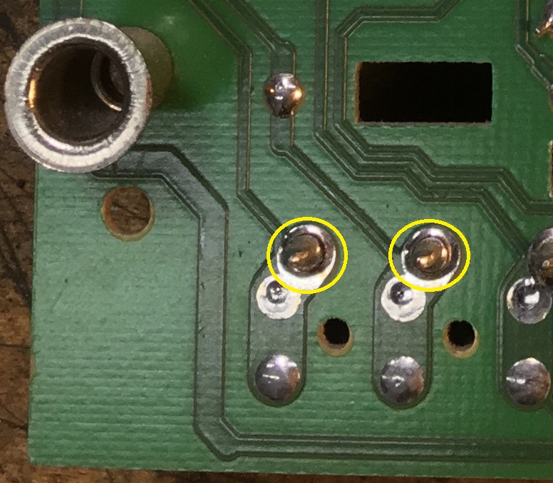

Here's the two solder joints that had let loose. If you zoom in on the picture you can see the circular crack all the way around each pin. The opposite side of those two pins were the screw terminals that the thermostat wires were connected two. (the small black screw terminal block in the previous post)
It was nice to find such an easy fix and have consistent heat in the shop again!!
I have a garage door opener that, I suspect, has the same issue. Apparently, lead free solder used on newer stuff is more prone to crack. Maybe one of these days I'll fix it so I can try to sell it.
Electrolytic capacitors from China have also sent many items to an early grave.

that solder -pin failure is common. All boads are 'wave soldered'..think assembly line ,where they travel across a sea of molten solder. Go slow enough to solder big pins, you can damage the little stuff...go too fast, big pins won't solder(too cold). They 'dial in' the speed for kind,just about right'.

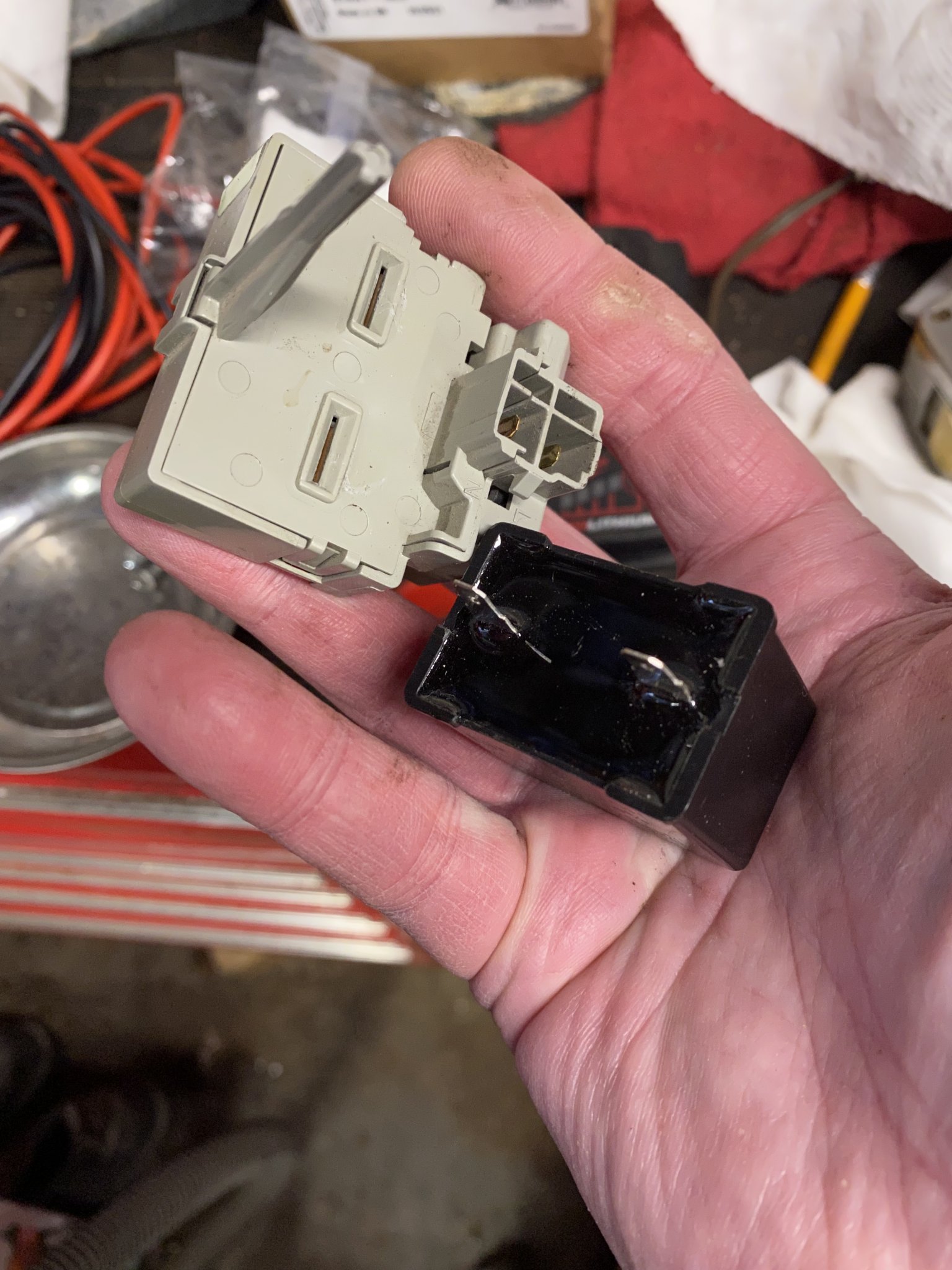

The saga continues....back to Maytag 'fridge.
Icemaker replacement went fine. Until.....
Started to leak a little water from icemaker couple weeks ago...just a little. Like cubes were melting, just a little now and then. :unsure:
Long story short, freezer was getting warmer. Fridge was holding at 40F. No sweat. We have another refrigerator in garage, and 2 other freezers out there too..
Our 2-car garage can also act as a large walk-in cooler this time of year.
At first, cleaned coils and reset control board (we've had a few power outages).
I could hear some clicking sounds from unit. Like compressor short-cycling.
After some internet searching, last night ordered new run capacitor ($10) and start relay ($50+). The two plug into each other at compressor...figured replace both at once.....either could cause a similar issue.
Capacitor due here tomorrow 1/29, but relay not until Wednesday 2/2...
Fridge was 50+F after work....OH...FUDGE.....🤬🤬😮😲
Boy, I'm hoping that clicking is a bad capacitor and not the relay...It should be a 10 minute fix after it's pulled out and back off......
Hopefully will be fixed by tomorrow afternoon.....fingers crossed.
Defrost timers are another thing that can fail and click. My expirience included one that failed in the defrost point. Before looking at it I figured the start relay or compressor. Sometimes you can rotate the timer manually and get it going until you get a new one.
bill
8,005
5,181
Yep - - pretty sure we got it. Been running 24 hours now. Didn’t want to declare victory right away….
SO glad that relay came 2-4 days early.... 🤞
Was literally a 5 minute fix. Took longer to put the friggin’ back cover on…. 🤬
Offending part(s)----- the gray-colored start relay was the problem. Could smell a little "burnt" after it came out.
Replaced the run capacitor twice, only because it ran with the funky relay for a few hours. For $10...why not?
$70 all in, and that includes an extra capacitor.

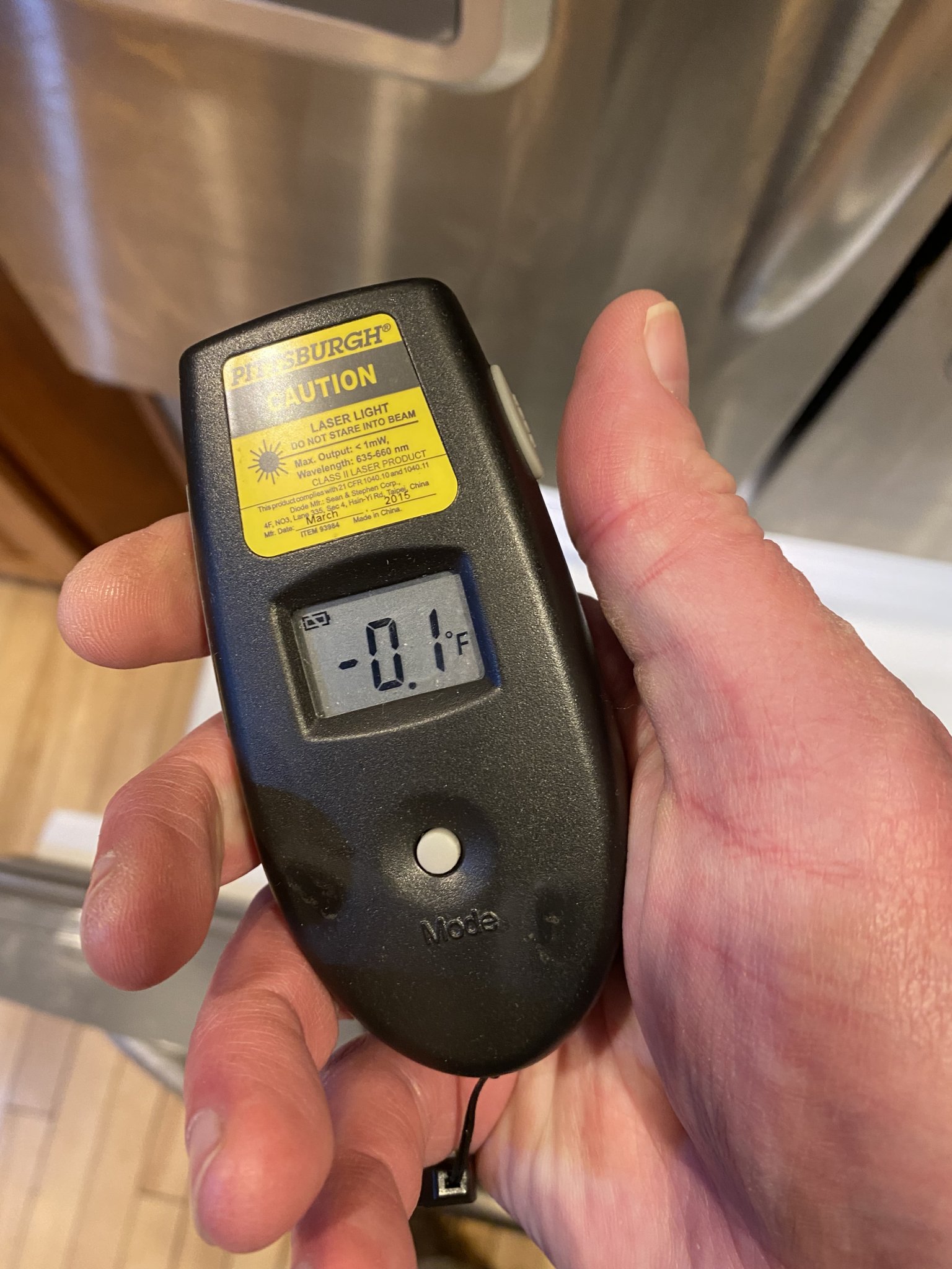

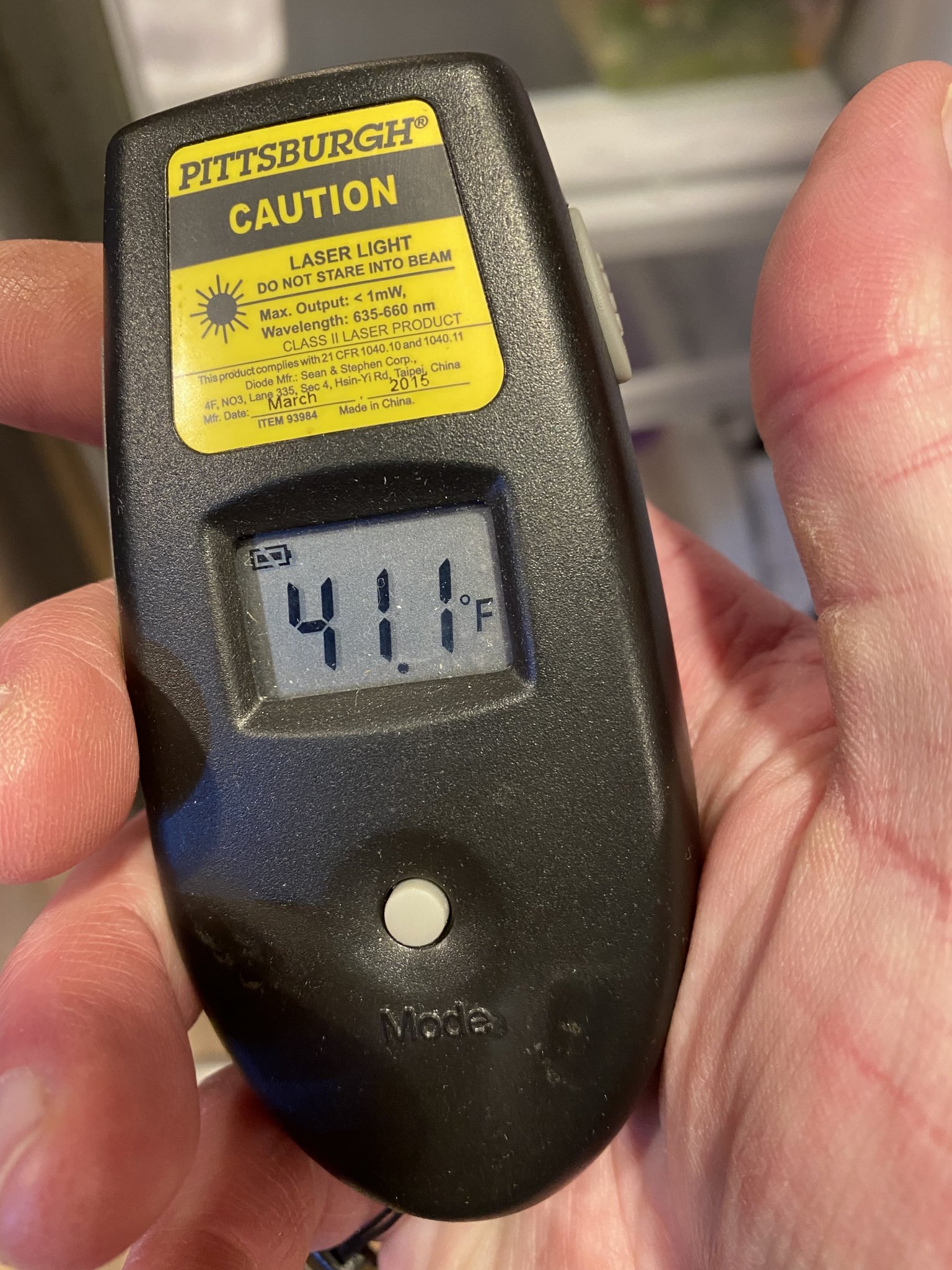

41.1 degrees inside the refrigerator?
That is definitely too warm!
Should be in the 35-38 degree area in my opinion.
10,183
7,073
Fear not....I was a Health Inspector for 15 years. Commercial cook for years before that. ;)
That's a $15 non-contact laser thermometer from Harbor Freight. I use it for a bunch of stuff, like the engine of my Kubota when my temperature gauge goes wonky. They're a very handy tool.
if someone here on OTT says their tractor temp gauge reads HOT, first thing many of us will do is to suggest they verify the actual temp with a laser thermometer like that.
Some degree of error when I "zapped" a bottle of Italian Dressing from 3 feet.
First time on a food item. I did disinfect the laser first.
Close enough I was confident it was a "fridge" and "freezer" again.
First 24 hours I also had a cup of water in the refrigerator that I checked with a "good" immersion thermometer.
Temp ran 37-38F. Fridge is set at 38.
I do sincerely appreciate you pointing it out. For some it may not be intuitive.

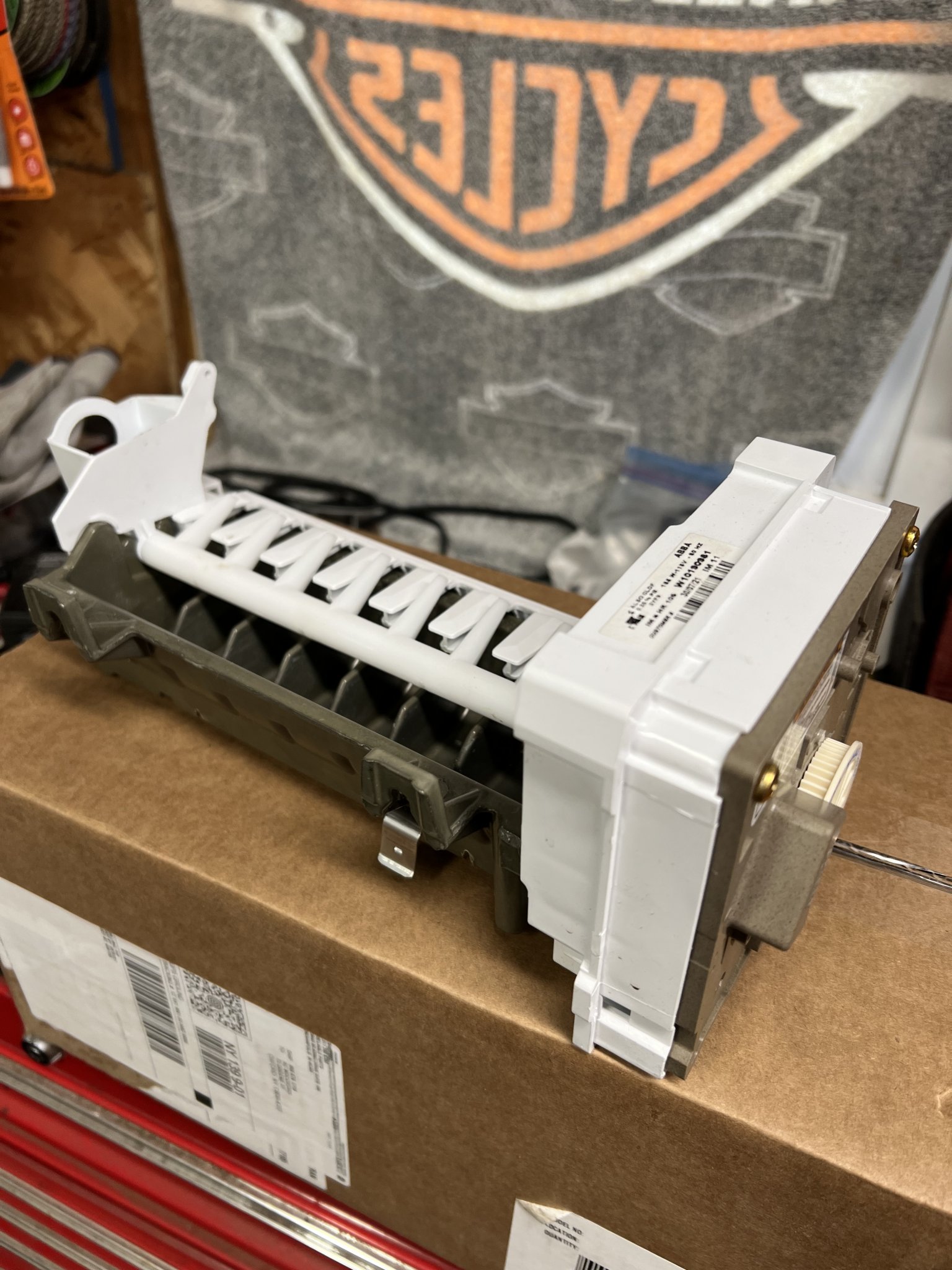

Had to replace icemaker on Maytag (Whirlpool) french door refrigerator again. This is #3.
Last was OEM at ~$180. Thinking about 2 years ago?!? $195 now.....:mad:
This time, decided to try some aftermarket. Bought one at $65, and another at $120. So, got 2 for less than 1 OEM.
The $120 version was delivered first and installed.
Didn't work.....dammit... That's what I get for aftermarket....:mad:
Pulled back out. Found a connector not-quite-seated....:p
All's good so far! Easy change, once you figure out how to take it all apart. Found a good youtube video with first change.
"They" say appliances are now 10 years, tops. Fridge is at 13 now....needed some work in time. Our last fridge was over 30 years before I replaced it with this one.

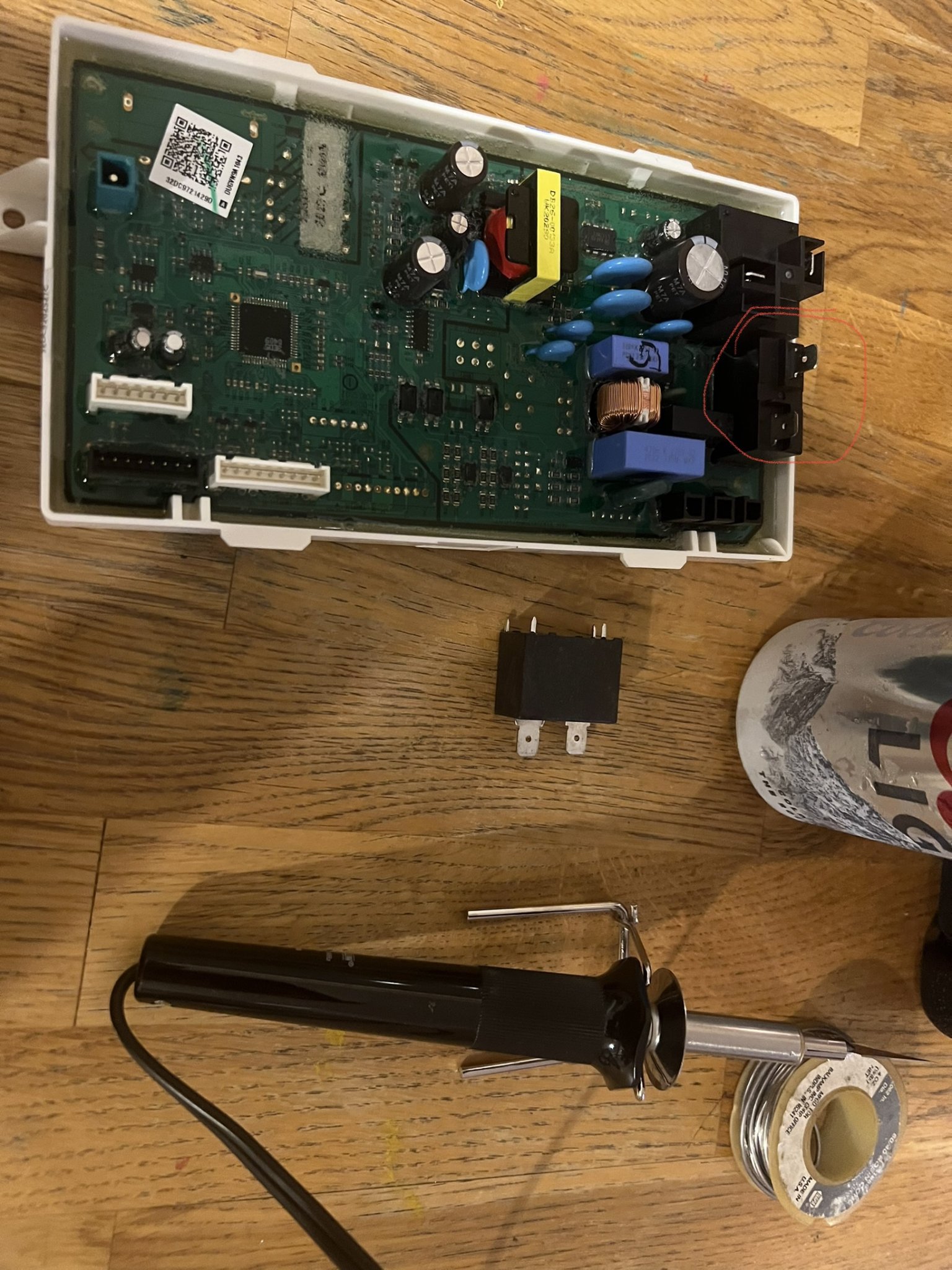

On Sunday the dryer decided it loved life so much, that it never wanted to stop spinning…the motor stayed on constantly, even with the power off, had to unplug it to get it to stop. 2 year old Samsung, was flashing a 3C code.
So I did what any normal millennial like myself would do and hauled it to the road and bought another one.
Just kidding 🤣
Went to google, found it was common issue, just replace the control board…boring and $300…
Find it’s just a relay on the control board that is stuck on
Ordered new relay…
gain access to relay
melt the solder and remove
Solder in the new one
plugged it back in and waited for the sparks to start flying 😂
estimated cost to repair
Relay about $15 (Amazon and 2 day delivery)
Hot knife-$20 (not really necessary but made it cleaner cutting the access hole)
Estimated time to repair
3 beers
