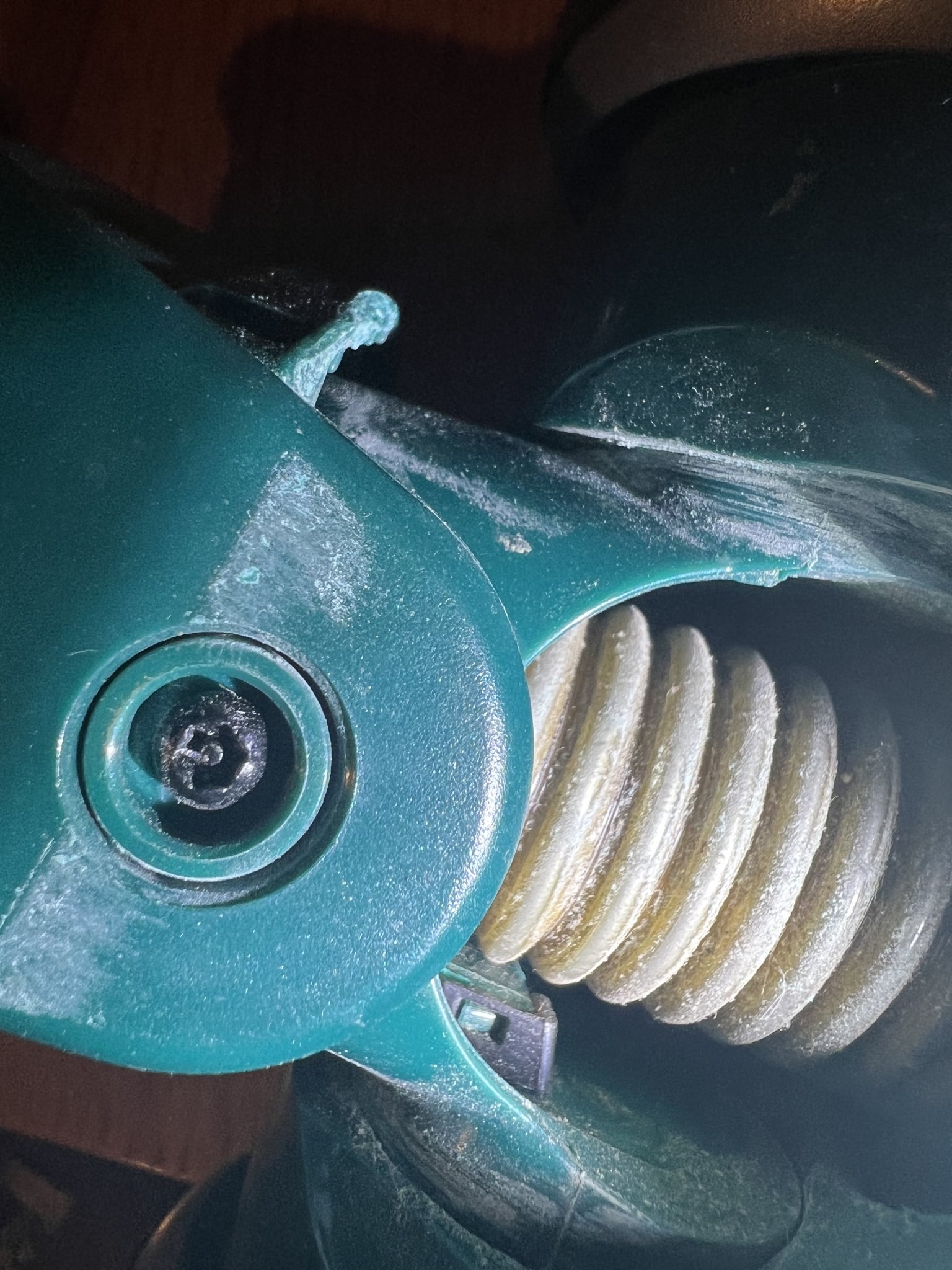

This really pisses me off.
I got the replacement hose for the vacuum cleaner. $10.
Can’t use it because I can’t take cleaner apart.
I’ve got almost every common bit I needed until today.
These look to be a Security Torx, maybe T20? Lord knows....That sucks.
I had a sleeve of security bits in my hand at Tractor Supply a couple months ago….$10.
I guess I should have gotten them….
Shark does this purposely so people will just buy another cleaner..sad.
I’d try a left handed drill bit that is a little larger than the hex. Then replace with the fastener of your choice.

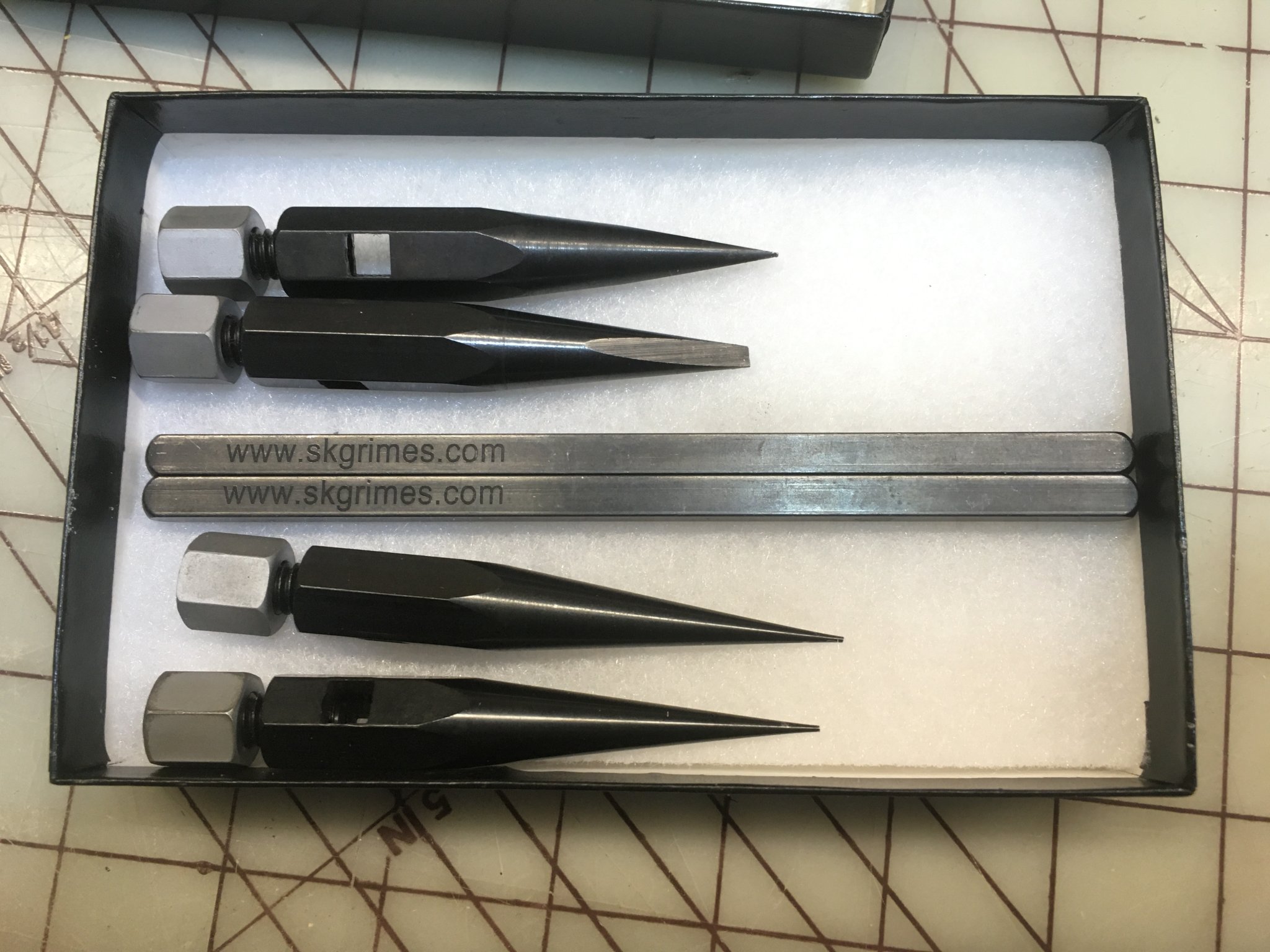

Here's a few of my oddball small tool kits that have foiled many a manufacturer's attempts to keep you from a repair/replace fix it job yourself. These are used for those odd little fasteners that you find when you're just about at the last piece to remove before getting at the part that needs replacing.
The first is a Sunex 9726 kit that has a nice selection of various types of bits. This kit is probably 15 to 20 years old and shows no wear. And it does get used often. Not too expensive today at around $30. Sunex makes a variety of these little kits.

And if you ever need a quality spanner wrench set to work on your optical goodies....this one made by
SK Grimes is top notch. This set has both a set of flat blades and pointed round blades. They can be attached to the spanner bar to both point inwards and outwards depending on the span needed.

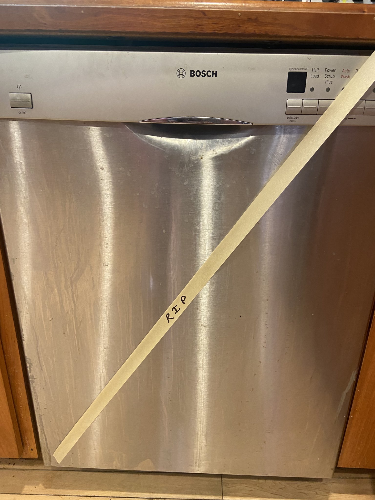

A few months ago I suggested to the Mrs. we consider new dishwasher and refrigerator.
I’m retiring and she’s not far off. Get them out of the way.
They’re both 15 years old and I’ve had to do multiple repairs on each.
She objected and looked at me like an alien….
Today the Bosch dishwasher crapped out.
I’m guessing pump and/or circuit board.
We’re shopping for a dishwasher tomorrow, and you can damn well bet I’m going to try like hell to work a fridge in the deal as well…..

10,183
7,075
Even though we bought new yesterday, my nature dictates I had to try one more time,.unsuccessfully….
RIP….
10,183
7,075
Rust in Peace...
Yeah, my theory is still pump and/or circuit board are shot.
Either way, I’m not putting the effort in a 15 year old washer.
Sad that the life expectancy is so short in this “modern” era.
