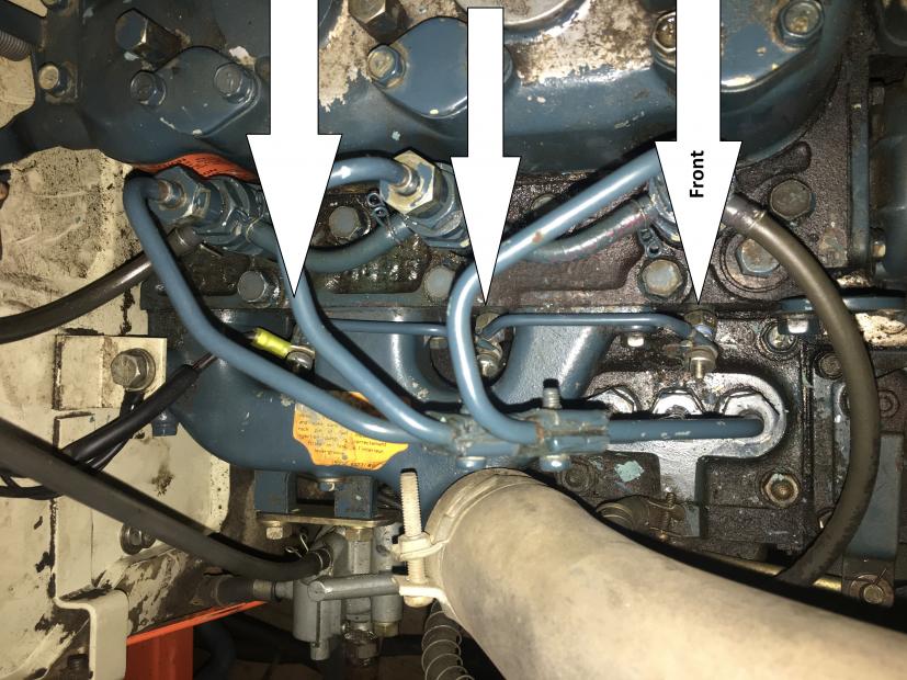

I wanted to clean up my glow plug connections - started with the middle one first and then realized that even as I unscrewed the "nut" - it hits the intake manifold right at the end (see red dot). Nothing is bent.....so what to do???? See picture.
And IF I wanted to remove glow plug(s) - socket will go there without problem? Anything special to do there for removal? Or same treatment as an old fashion spark plug when removed? Should engine be warm? or best to remove cold?

Some of the smaller Kubota Tractors I would almost always recommend removing the intake manifold if you are going to be removing glow plugs as the clearances are typically tight.
Yes, absolutely run the engine to temperature before removal.

85Hokie, why not take a die grinder or a hand file and dress down the threaded end enough to get the nut off? I think the intake manifold is only 6 nuts, and you can reuse the gasket usually....but I'd modify the end of the GP if you're just cleaning the connections.

The wires are just soft aluminum, loosen the nut then open the hook end and remove the wire.
If you want to remove the nuts or the glow plugs, you will need to remove the intake, and the injection lines and either one delivery valve or the entire injection pump.

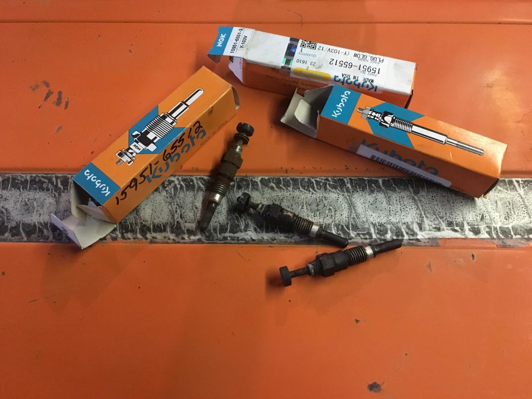

When your tractor starts poorly then you probably need glow plugs or cleaning up of the connections.
My connections were corroded with rust and aluminum oxide.
I just replaced my glow plugs last night, I did not remove the manifold.
Plugs X3 was about 40 dollars at my Kubota dealer.
The intake manifold was in the way of the first one,
The middle one was easy.
The front one was blocked by the injector line flare nut.
I took a very thin wall cheap 12mm socket and ground some of it off for the first one.
The middle one came out with 12mm socket and the front one required removal of the injector line and nuts, (then just normal tools).
ISSUE: My tractor is OLD and the new glow plugs had a longer threaded terminal end and that made the reinstall of the wires really tight and difficult.

Each glow plug came out and I did it with the engine cold. If you end up needing new, check out NGK as they are the folks who make the Kubota plugs. 1/2 the price of Kubota and can be purchased on Rock Auto.
Can you comment on how you found the correct glow plug on Rock Auto? I've never seen tractors listed in the applications, but might be missing something.
I'm guessing you used the part number search function, so can you comment on how you converted the Kubota P/N to a NGK#?
This info could help others who might be in the same situation and in need of saving $'s.
