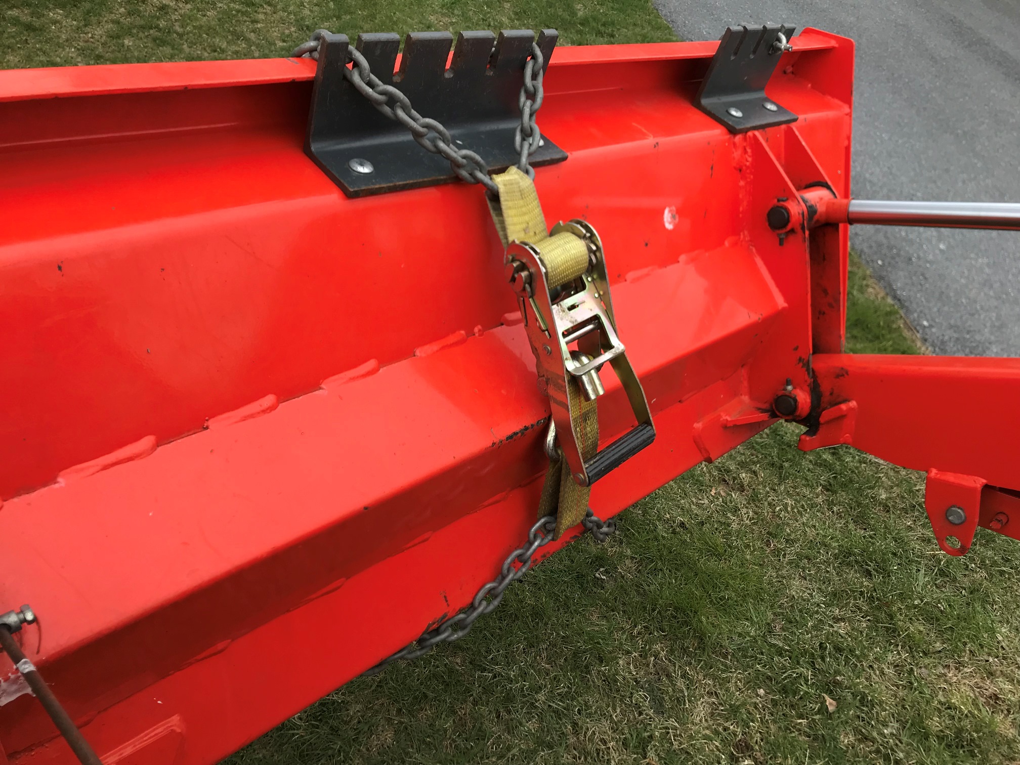

I'd cobble up a box and ratchet-strap it on the bucket. Skip the extra weight of the forks. Maybe a used $50 IBC tote? Cut and use the bladder as the leaf container or line the frame with something to contain the leaves.

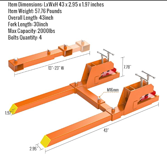

The picture I posted is just for reference, does not indicated what I intend to purchase.
I've had a few idea's on what to build for this "clean up box" but already having some very well built skids saves me enough to get the forks, I'll still strap the box to the bucket as I want to be able to tip it to remove the contents, leaves, branches etc. My biggest concern is "denting" the bucket..

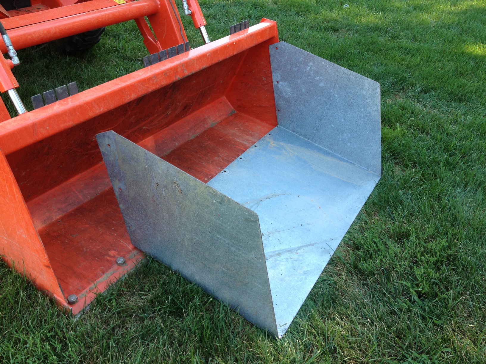

My first Kubota was a B7500 and the bucket was the right capacity for sand, gravel and dirt but way too small for hauling mulch and lightweight stuff. I had our sheet metal shop guy bend a piece of 10ga that I bolted to the bucket. It was a simple three-sided piece of galvanized. I drilled a few holes on each side (in the bucket and the extension) and 7 or 8 holes on the bottom that used the bolt-on cutting edge bolts. It was sturdy enough to pick the front of the tractor off the ground.
The picture below is NOT the tractor that the extension was used on. It was taken with Kubota #2 (L3200) that had a larger bucket just for illustrating the size for another poster here who had an interest in it.
Now that is a cool idea, I have some large sheets of steel kicking around... you're giving me idea's

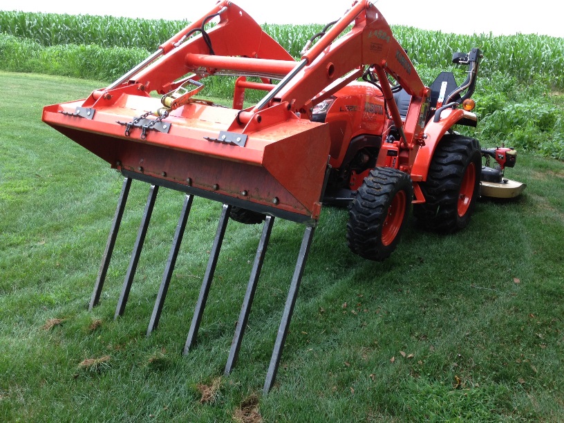

When I had the L3200 (pin on bucket) I built a set of forks that were attached via ratchet strap that worked pretty well. For the L4240 (SSQA bucket) built a HD set from bale spears on a QA frame. I never had skids to handle, so the tine spacing didn't need to be adjustable. Use them mostly for moving trimmings and brush.
EDIT: Same L3200 in both pics. First one was taken BC (Before Cab:) )
Yep. Even if you don't have access to a big press brake for bending, or a welder, corners could be bolted angle iron.

I found these forks and I think they calm some of my worries with the unique design compared to others I've seem. I doubt they will ever see a 1/4 of what they can carry..

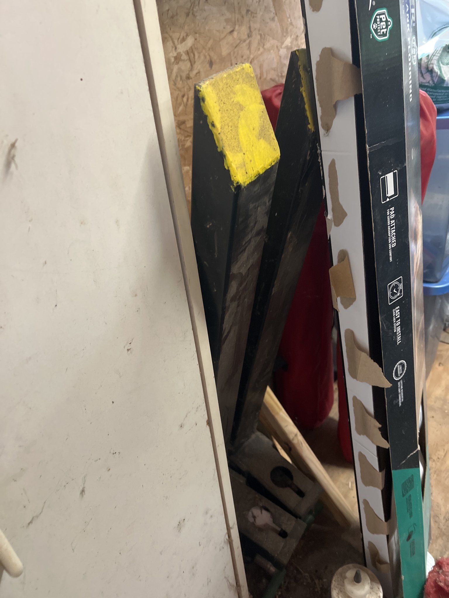

Mine are stowed away, but those look similar dimensions to mine. I tried longer ones before I bought these. The shorter ones are much better on a light BX.
Just a reality check, make sure they are not 58 pounds each, which you don’t want or need. With 2 screw mounts, they appear pretty stout.
Good Point, they state overall weight of 58 pounds and only 30" fork length. Funny their description shows exactly what I want them for.

That would be fine if 58 total. Just wanted to bring that up.
If I recall correctly, the longer ones I tried were close to 50-60 pounds each and longer of course. . Don’t recall rating.
I think the ones I have are about 30 each, but think they’re rated at 1,000 pounds but honestly guessing.
Like you said, 1,000 or 2,000 pound rating is irrelevant with a BX. Not getting close to that anyway.
