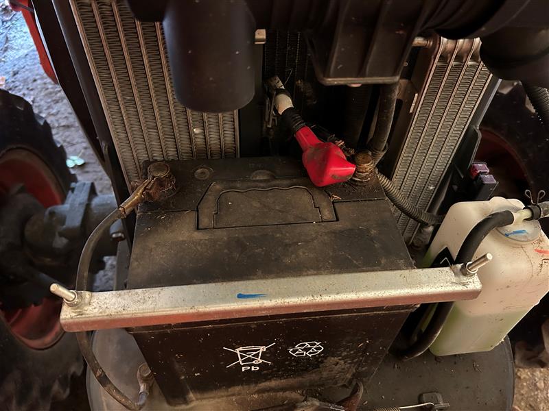

Thanks for the responses. It's a 2018 3301, I bought it at 250 hours in 2021 and it now only has 370 hours on it. I am unclear if this is the original battery or not. Not much in the way of markings. They dont appear loose but could use a cleaning for sure, including the ground connection to the tractor.

I had the same thing happen to mine, driving and it was like someone shut the key off. Started right back up. Did some poking with meter and found one of those slow blow fuses (near over flow tank) loose in its holder. Bent the tabs a bit and hasn’t happened since.
32,127
7,855
Any break at the battery would not do this, the alternator would keep it going.
Like @MOOTS said, check the main fuses for a good connection.
The other option is a bad connection at or in the main switch.

AS a cheap first attempt, remove both battery cables and completely polish any metal surface including the ground to frame.
I have seen worse "top of battery" photos but certainly your could be better!

The battery isn't going to go stone dead, and then restart the tractor 3-4 seconds later. Clean the battery cables and battery post. Check the ground connection.

curious, I downloaded the L3301.... WSM from kubotabooks. If it is the correct diagram....page 578 shows that both the battery and alternator feed a 40 amp slow blow fuse. IF it's not 100% properly 'seated', it might have vibrated out ? Would need to see the type of fuse, but easy to check.It should be 'hard' to yank out.
You describe 'dash went black', so NO power to it. Battery +12 goes to 50 a slowblo then the 40. so NOT the 50 amp fuse. If battery side was 'faulty', then we have been told alternator will run tractor, but dash is 'black'. No power
The only common point is the 40 amp fuse.
Now If the engine dies on the 'alternator only' test then it's NOT the 40 amp fuse, suggesting a bad ground from the battery.
do at your own risk test......
One interesting test would be to start engine, then pull the 50 amp fuse. if engine stays running, then the alternator indeed CAN run the tractor. WARNING !!!! Pulling that fuse might 'fry' the computer ! Check online or with expert first !!!! Some Kubota ECUs are known to magically die changing the battery.
