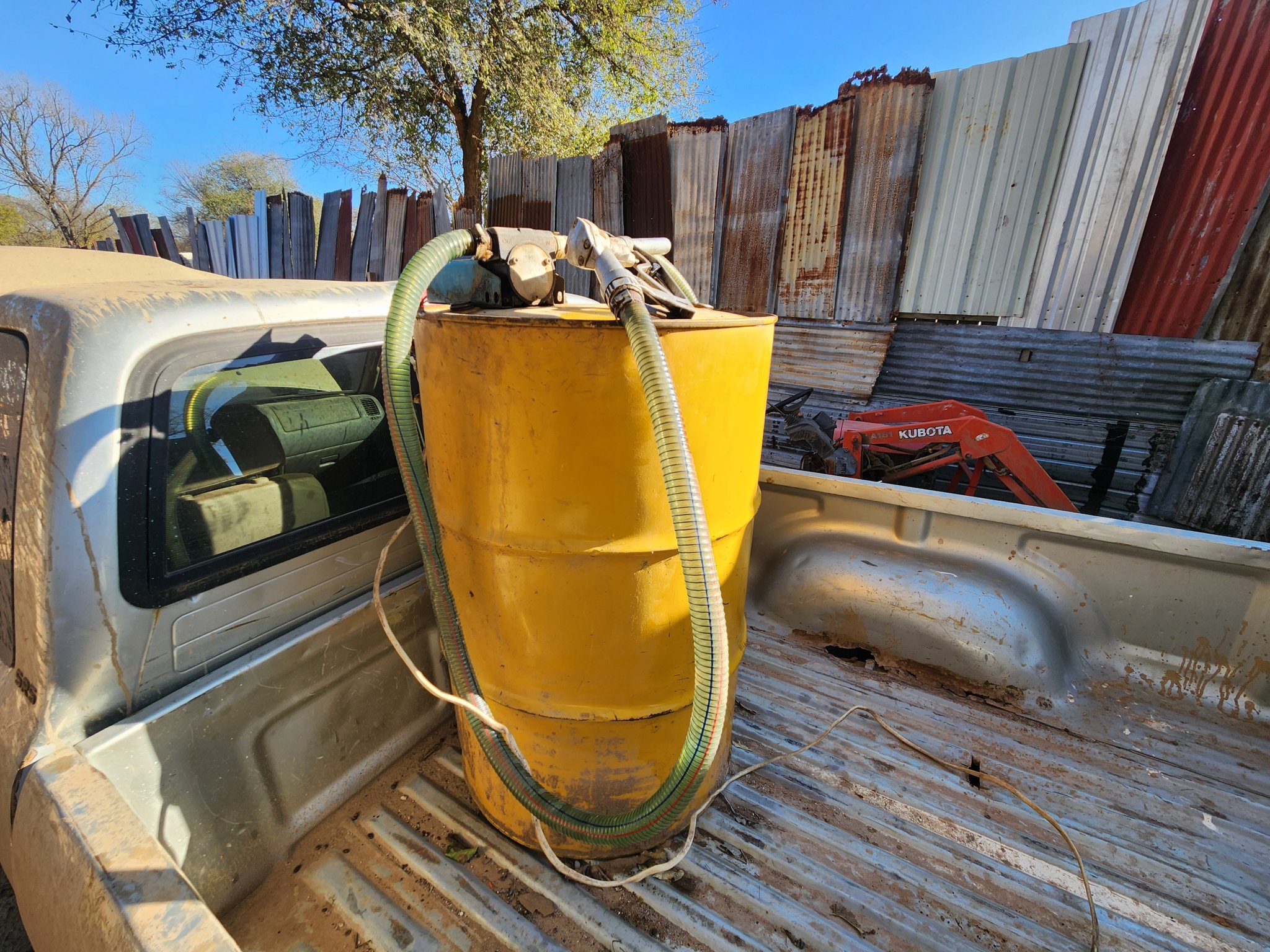

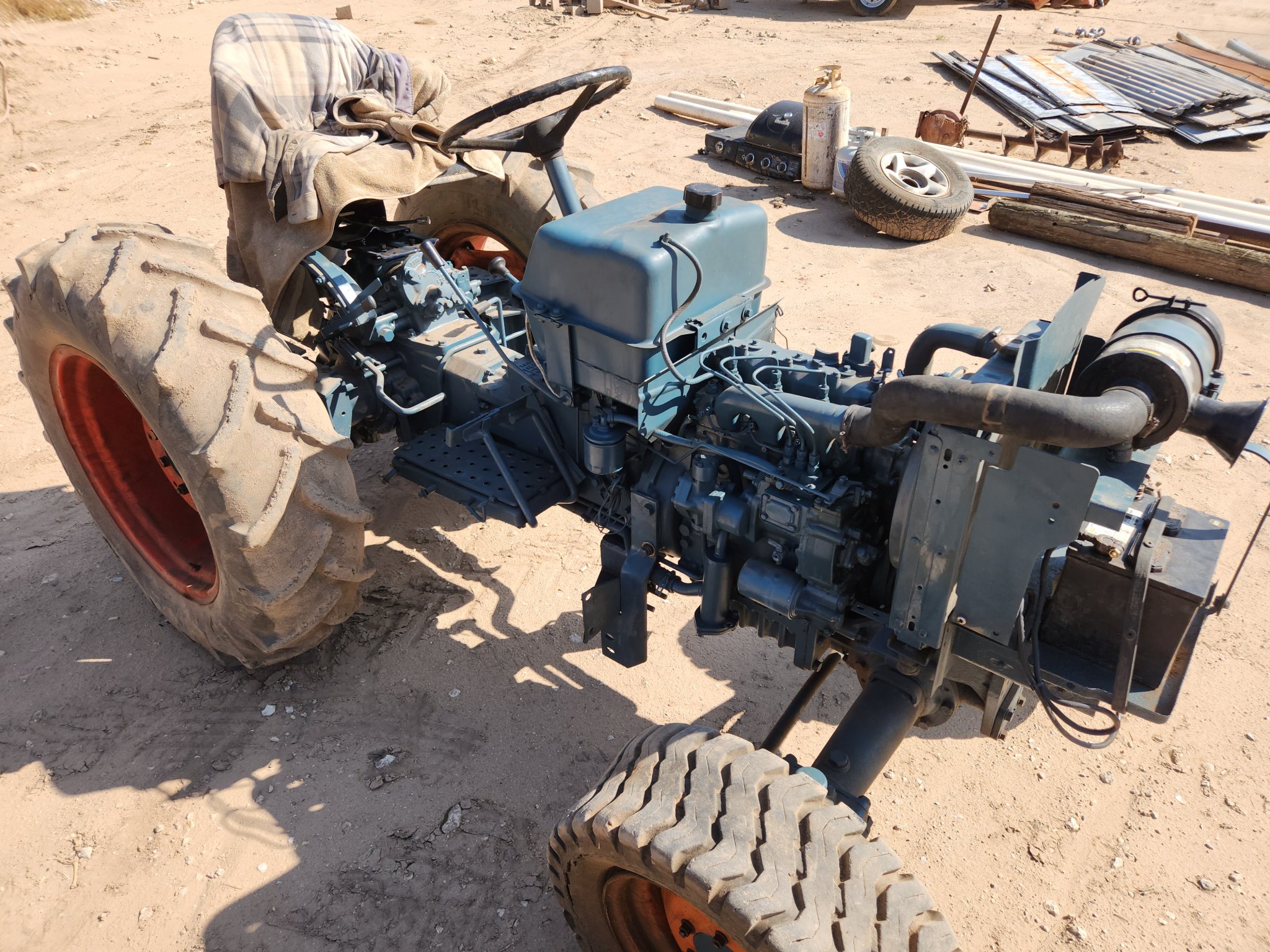

Got 30 gallon diesel ⛽, run tractor check for leak
went and got 30 gallon diesel, filled up diesel tank on tractor, get her running
got her started video is about 10 min after startup, clean all the oily areas with brush and solvent, hit with compress air
the level was a tiny bit below full, let her run for hours and hours, and see if it go down

video after 1-2 hour idle: purring better, i test it out with less diesel, and she less likely to shut off than before, chooching along...
I dont see any leak underneath, but let it purr while you go build shade
another task I can do: build up that front air box/holder/battery and put good wire on good battery
been working on the shade task while she idle 4-5 hour
oil pressure not getting below 50-55 psi, leak coming out of exhaust 2, and leak near governor out of gearcase tiny
exhaust 1 and 3 bone dry, exhaust 2 pushing out some oil, what could be the cause?
@L35
yes, I see that, 1 and 3 are dry, 2 spitting out some oil
@D2Cat
only solar electricity available, not strong enough
couple time I choke her out with too little diesel, check oil level, exactly where it was when started
keep idling, keep working on the shade

Little head gasket oil leak there, Or is it coming out of #2?

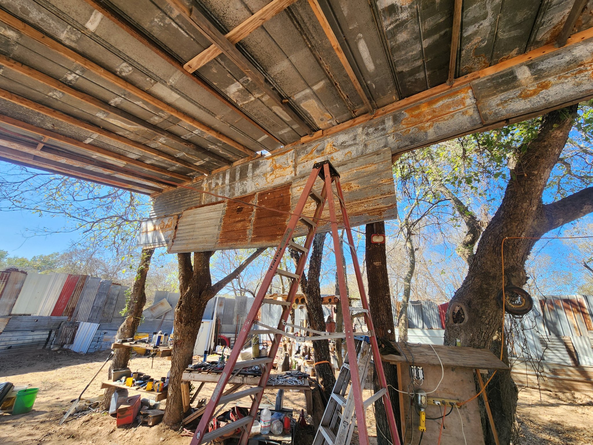

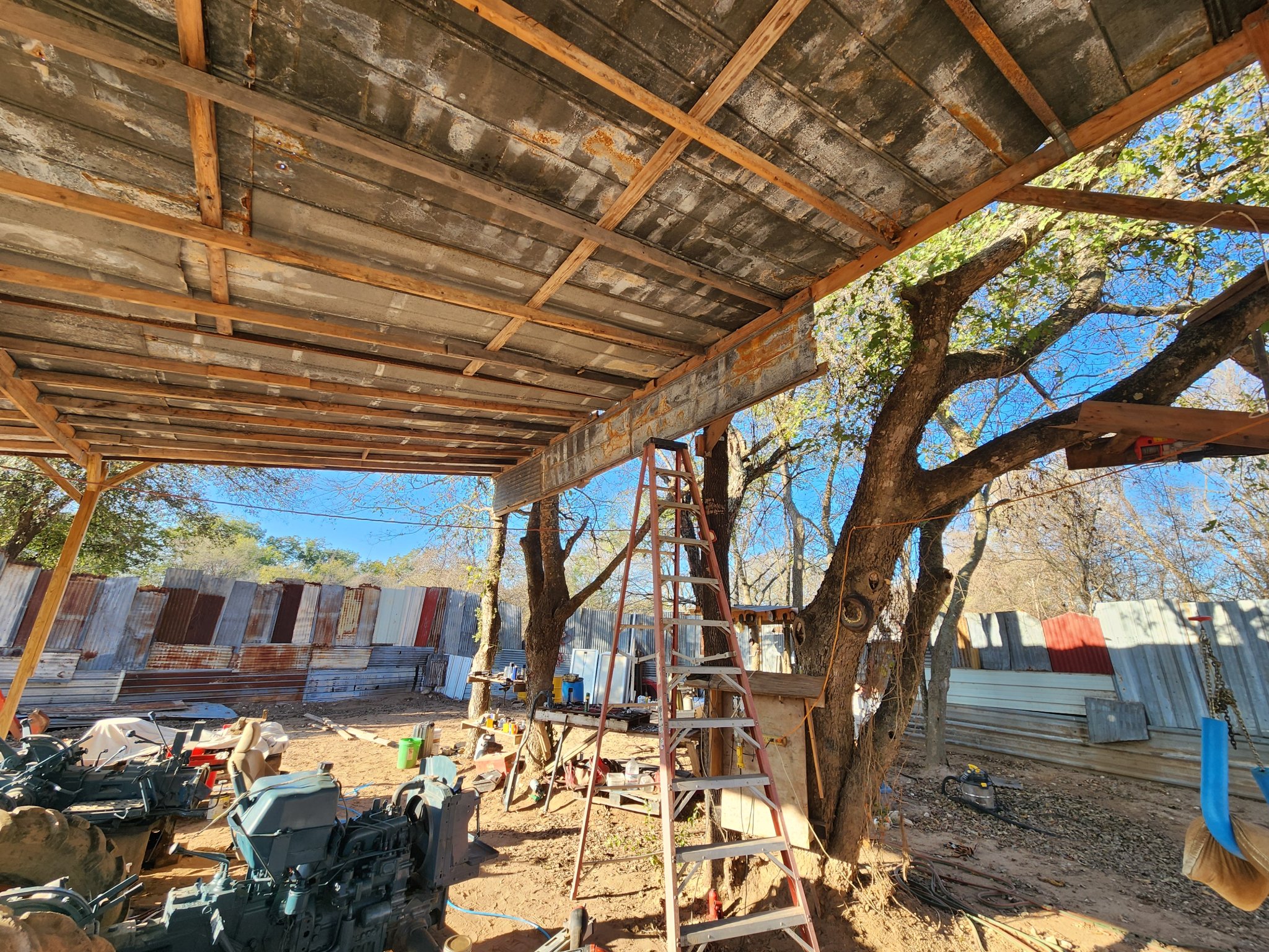

Putting shade up, decide what to do
while she idle, I put 1 and maybe 2 strip of metal to make more shade

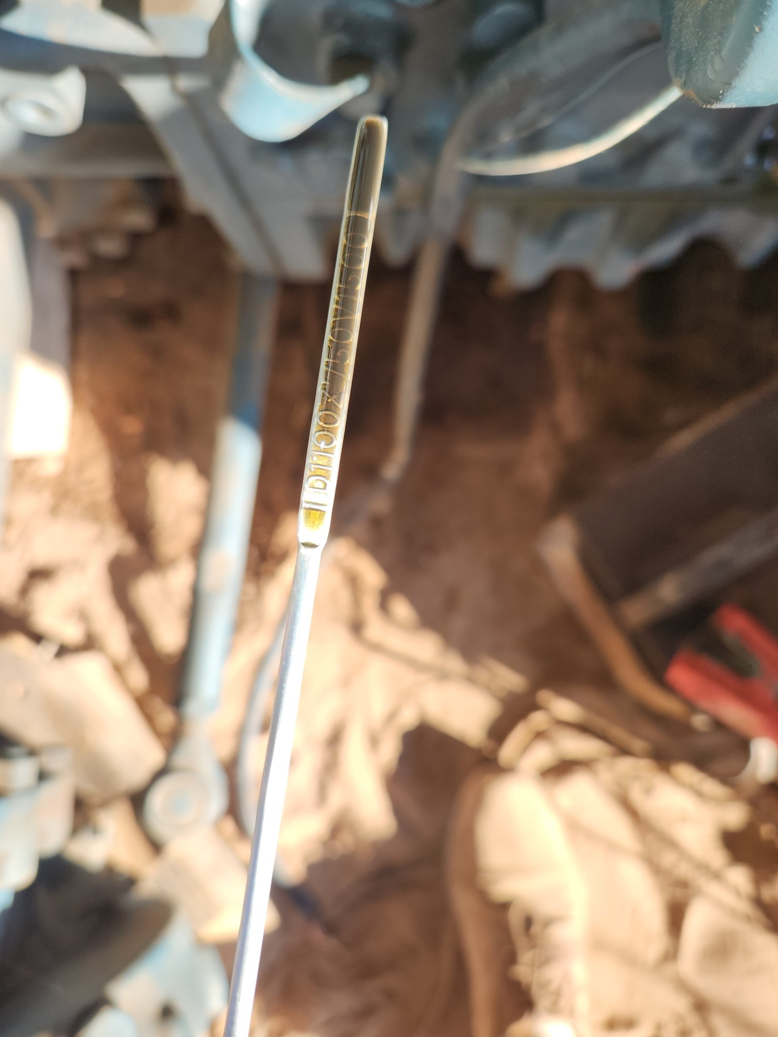

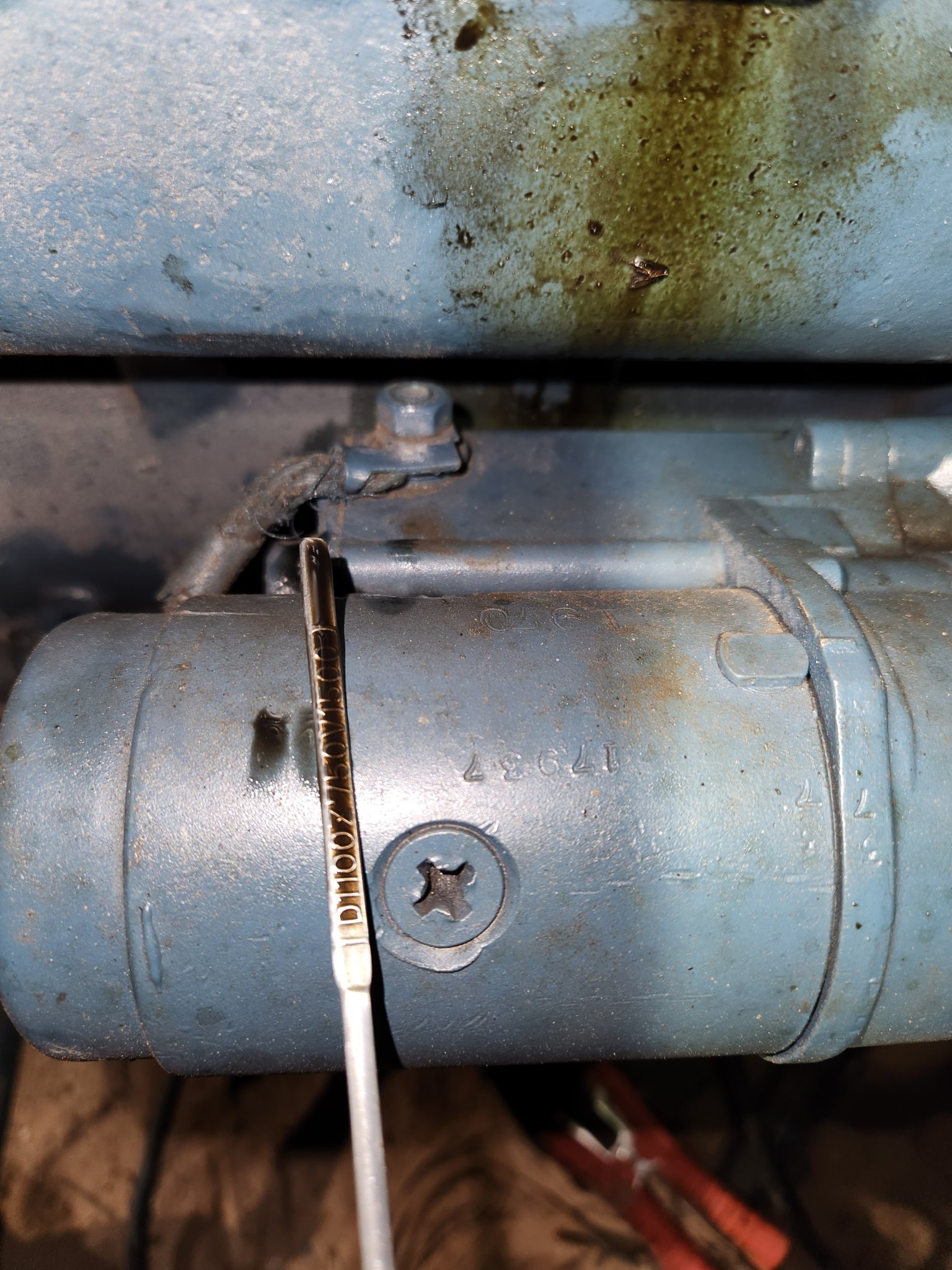

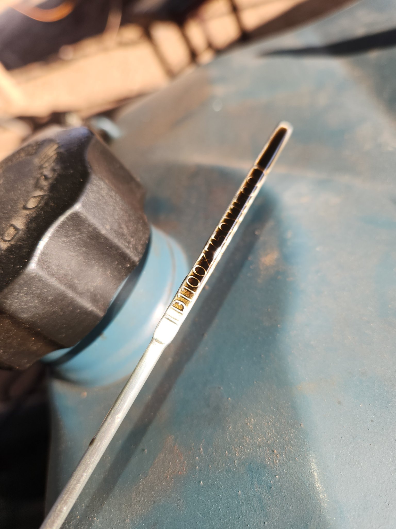

I try to show you where the oil level been sitting since she started idling, it is right below the "D"
not seeing any leak beside cylinder 2 and tiny gear case leak (jb weld did not fix it, it broke through)

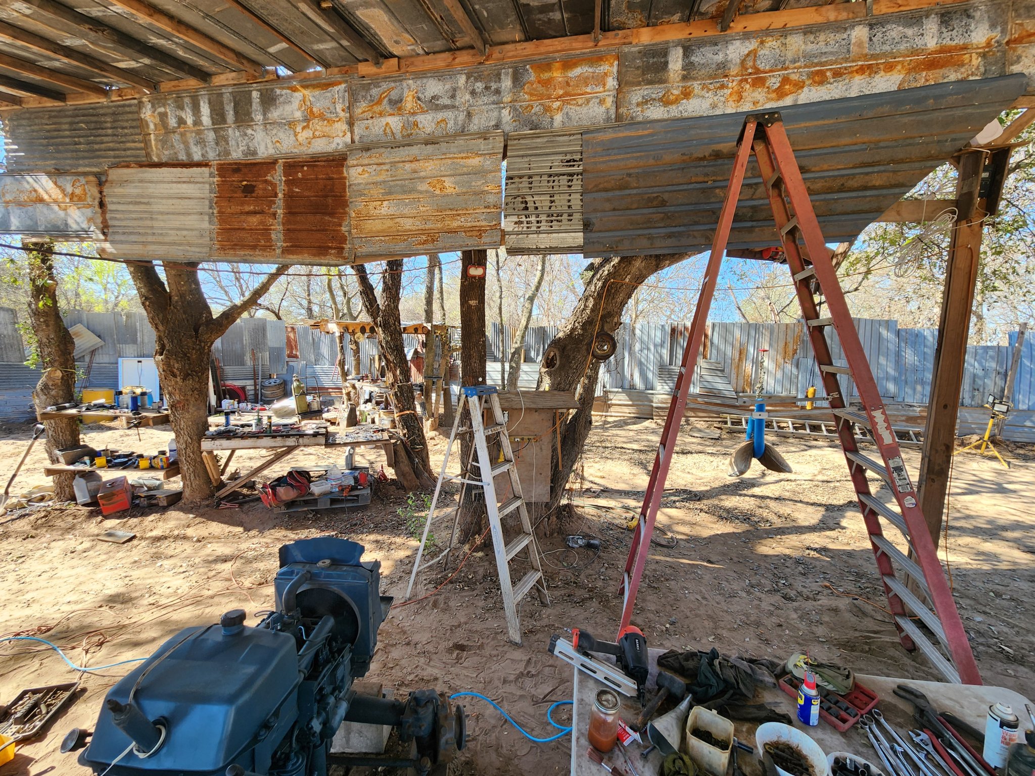

about 75% done with the shade task, doesnt have to be perfect, get to machine assembly
that should be enough shade, got the main work area, this task been bugging me since page 1 of the thread

lower throttle until she choke out, check oil, oil level exactly same as before 3-4 hour idle
now that I study the picture then the video, oil level look like it drop tiny bit, keep idling it, and keep studying it
what could be the reason it is pushing out diesel or oil from cylinder 2?
@L35
valve guide seal: I think this is it, they were rubber seal that I did not change on the head
it does look like oil, diesel runs better
thank you

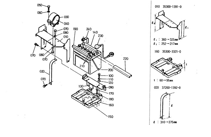

tighten all bell housing bolt, tighten diesel filter, study this image try to see why bracket not lining up properly
figured out bracket was upside down, diagram help
machine idle 5-6 hour today, close up of oil level, same level...

Valve guide seals if motor oil, leaky injector if diesel.

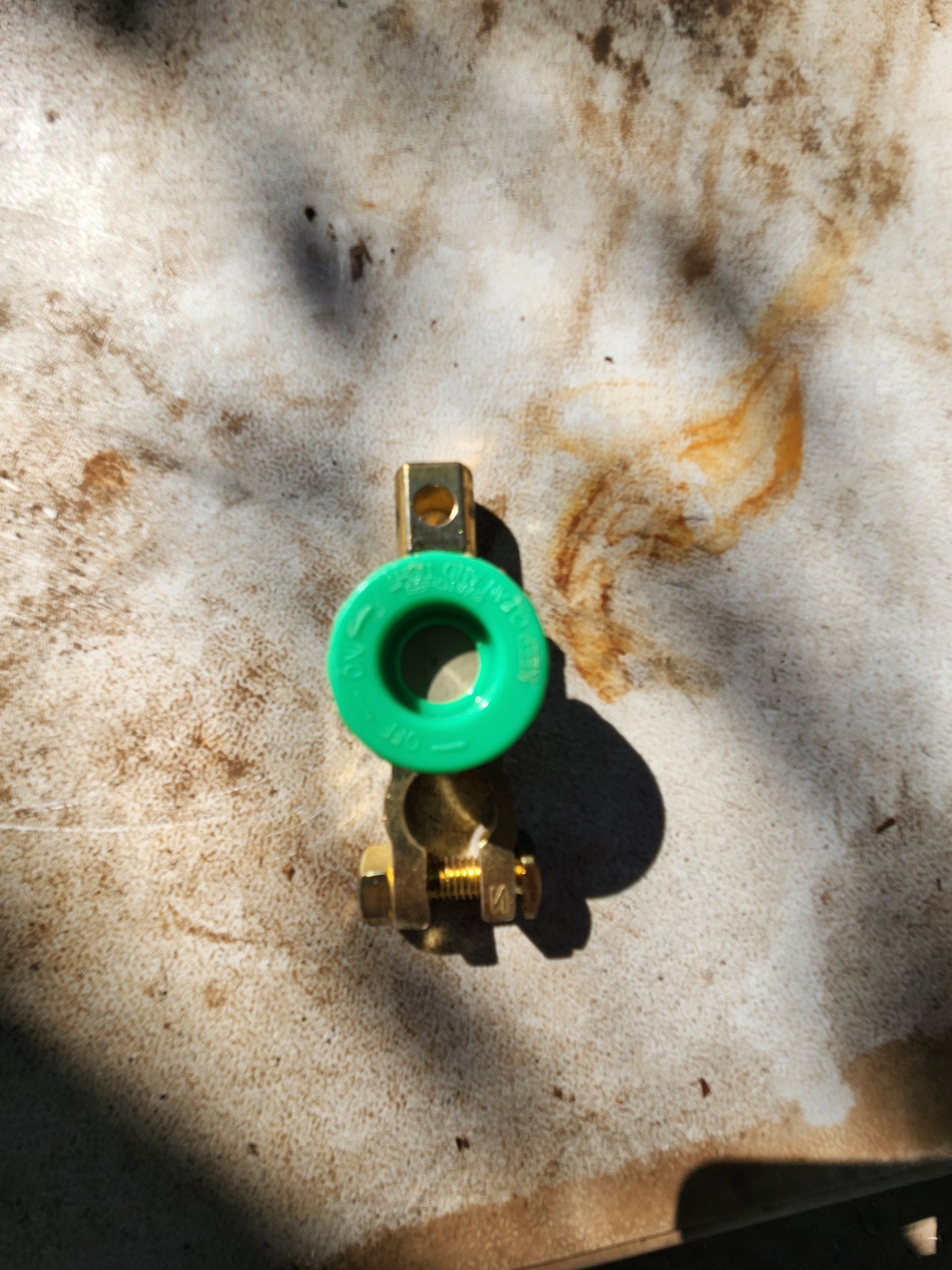

now: rig up easy setup to start tractor, dont fasten down that battery until sure it can take voltage, get 2 switches and hook them up to starter/glowplug, find/rig up wiring for alternator charging, check voltage once you get it running
later: put on front wheel, go and get loader with tractor, bring to work area
install 2 switches on diesel tank, left is starter, right is glowplug
glowplug - big wire - right switch - big 12 volt solenoid next to starter
starter solenoid - left switch
these are the pathways used for this simple solution

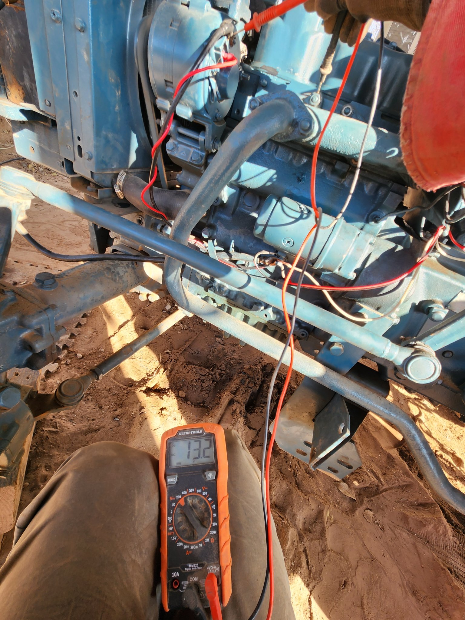

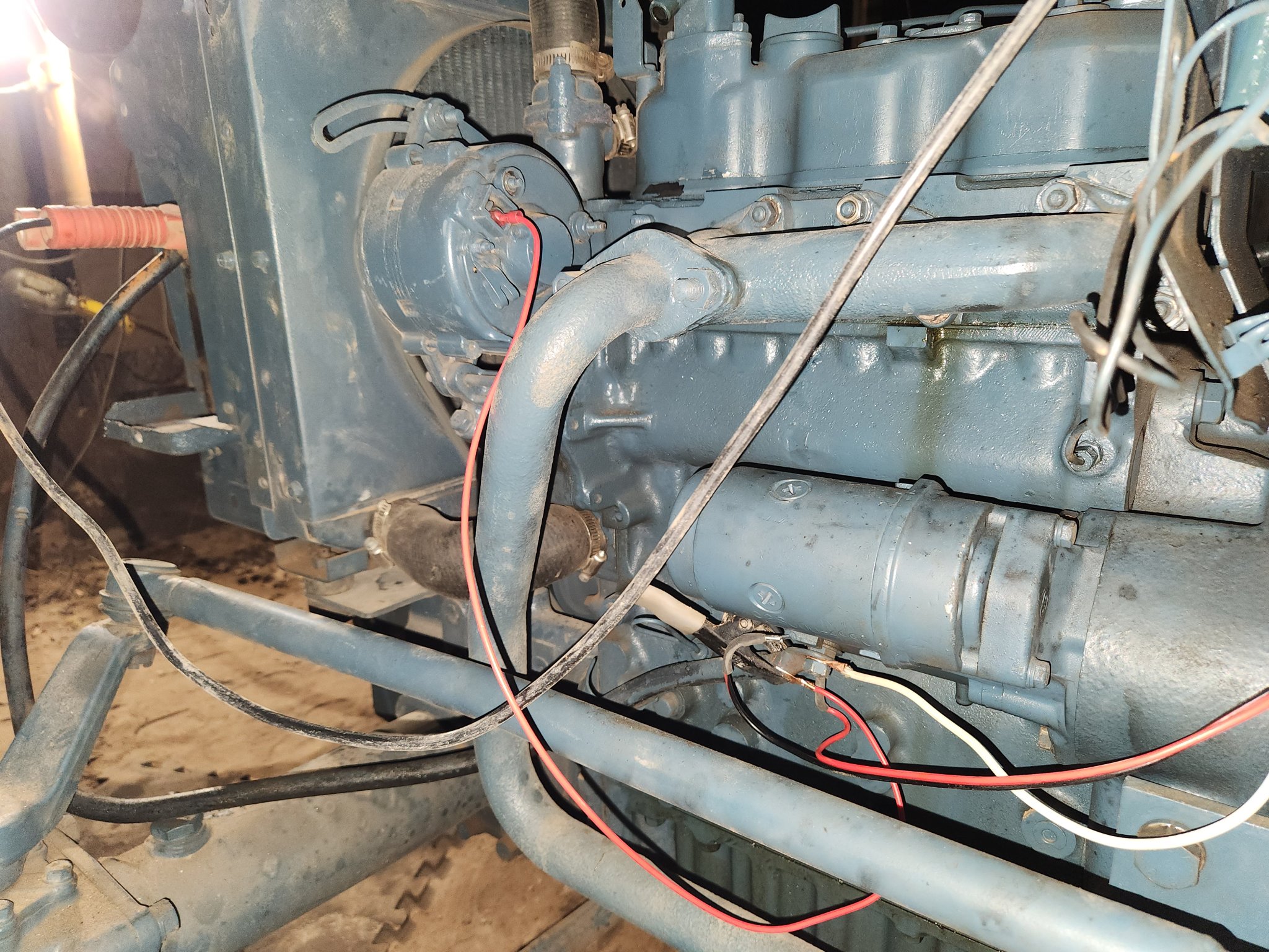

now: wire up big wire for alternator, test out the system, make sure it charge the battery
test out glow plug switch, voltage showing at glowplug
video: test out starter switch, works

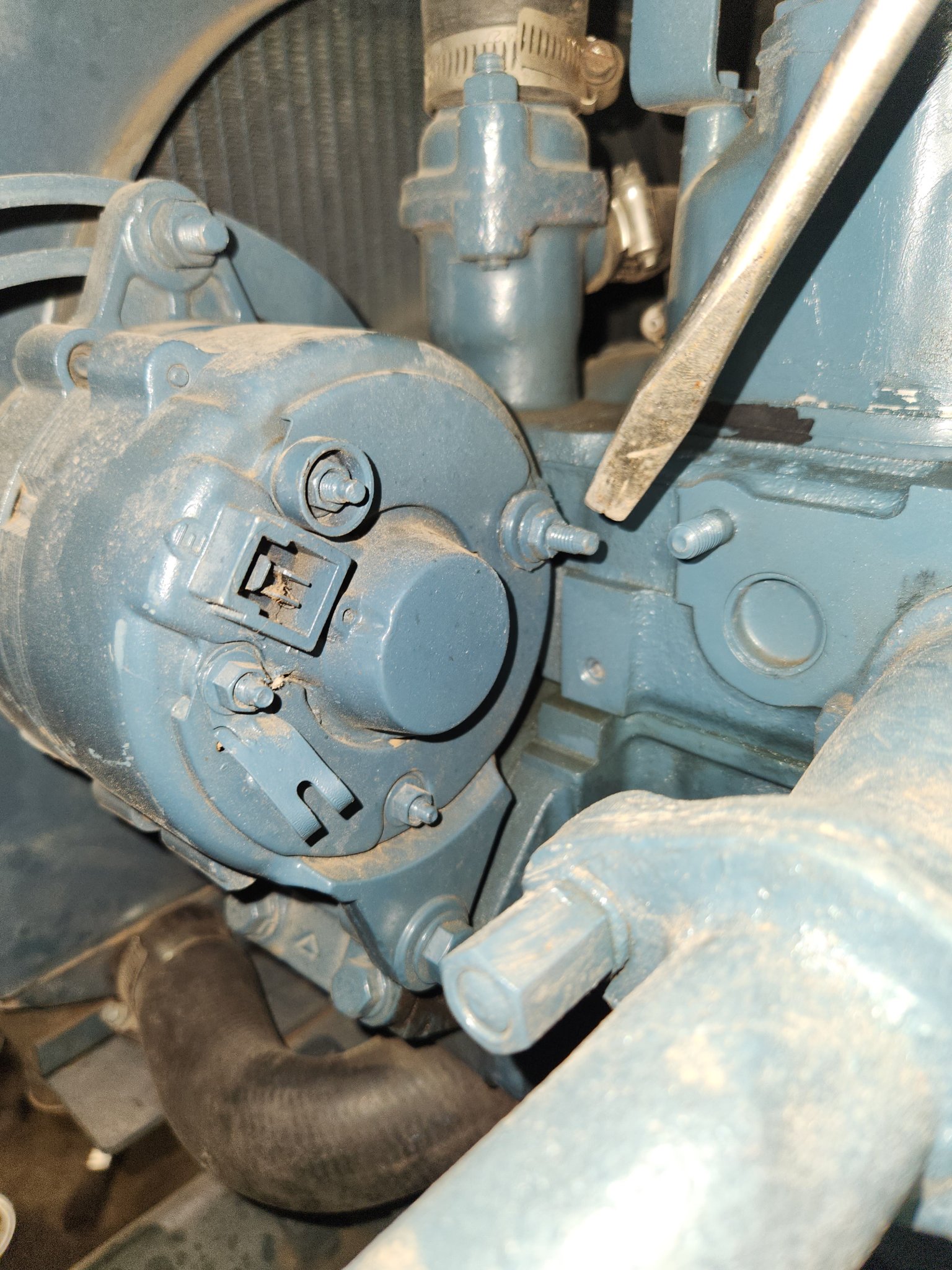

now: get it started, test voltage to see which terminal on alternator putting out voltage, run that wire to the main solenoid next to starter
used a volt meter to see which stud coming off alternator puts out the charging voltage
none of the leads, including the 3 leads inside the harness, show any voltage, except
tiny bit of voltage coming from lead I point to with flathead
could the alternator need a ground other than its frame being bolted to the engine block?
now: scratch them with wire wheel, and check voltages again

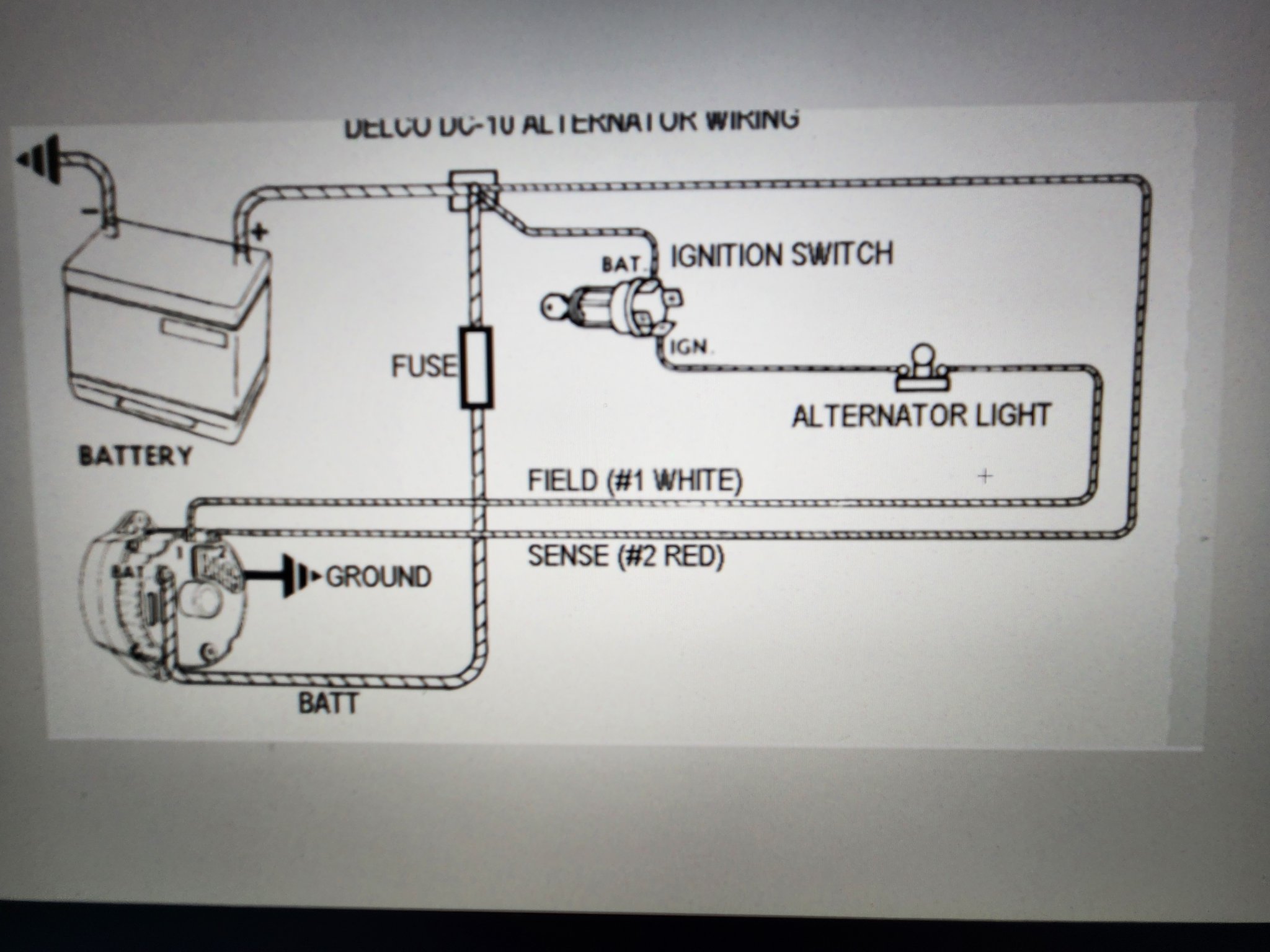

looked at diagram, does not label positive terminal
diagram off internet of how typical alternator wiring
it looks like that harness coming off alternator that go to fuse box has sense wires that need voltage
keep trying to rig up custom but if it is too complicated, maybe just re use all the factory wiring
now: experiment with putting in the harness that go into alternator and give 12 volt to those wire until she start putting out charging voltage
rigged up one wire from harness on alternator to constant 12 volt, now stud next to it putting out 17 volt, and
the stud i pointed to earlier putting out 28 volt, and if I connect those two stud, reading is 12 volt
looking at factory harness: run a wire from the stud showing 17 volt to the main terminal, and that shoud charge the system
let me know if this will work long term or there is a mistake

Oil level check after 7-8 hour idle, even with the small leaks it has, level has not dropped at all, still covers the "D" completely

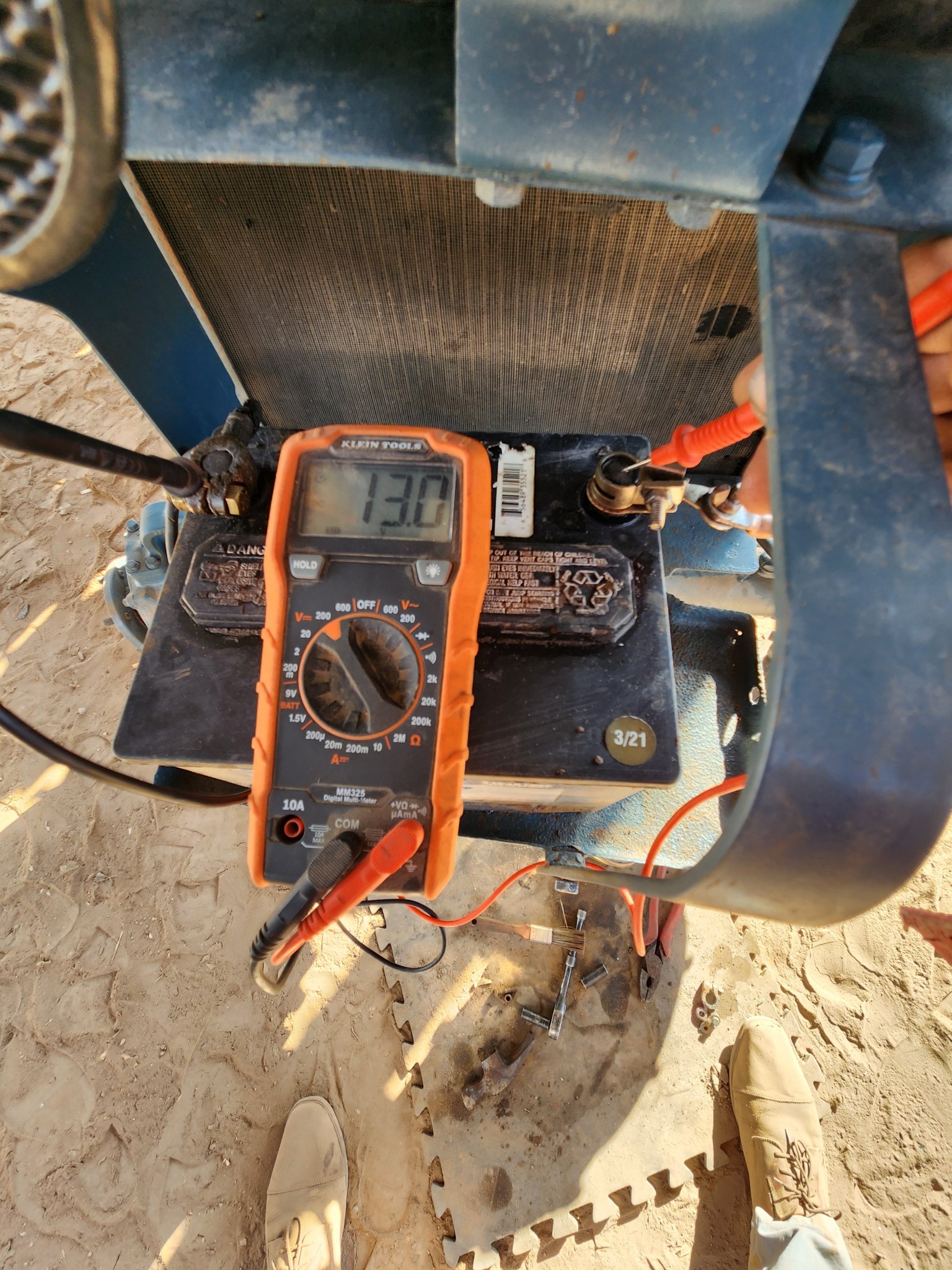

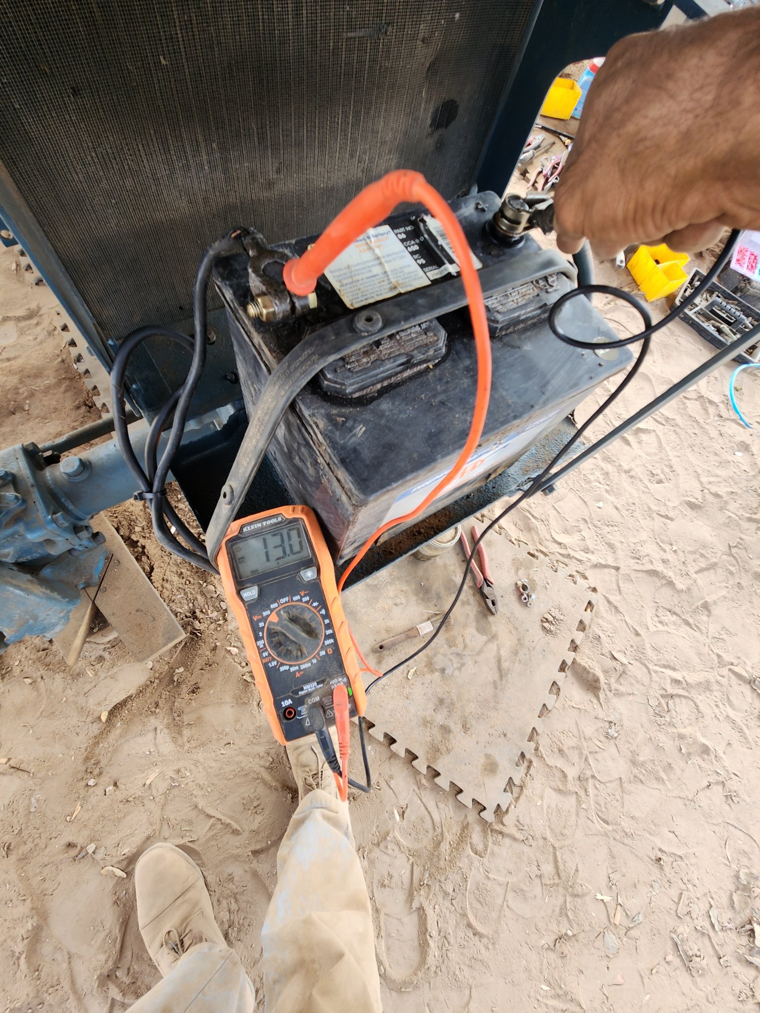

made a good 6 gauge copper wire to connect alternator to the main lug, tightened everything down
only concern: now that alternator signal wire always on, will that drain battery?
now I heat up glow plug and i show you cold start with the switches
confirm, charging at the battery, show 13 volt
confirm, charging at the alternator, showing 13.2 volt
cold start with new switches: glow plug for 2-3 minute, only thing i did before video: run it 30 second with no compression to prime diesel

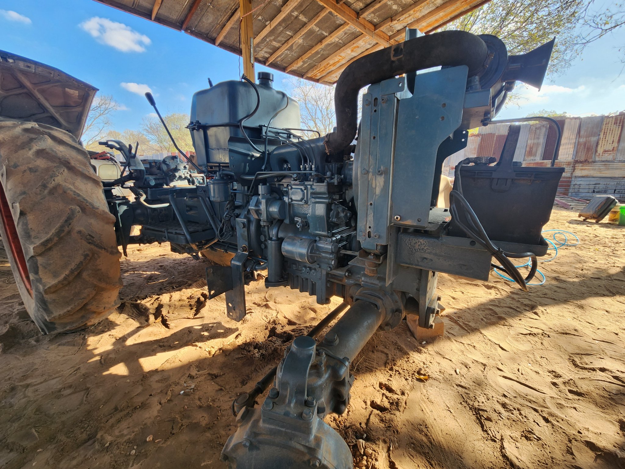

observation: after installing air filter and exhaust, see saw completely gone, and now idle might need adjustment, meaning
the seesaw idle from earlier has something to do with no constriction on its intake and exhaust,
with intake and exhaust, it is more balance the way it was engineered
at this moment, diesel engine purring, no leak, charging battery, have start and glow plug wiring installed...

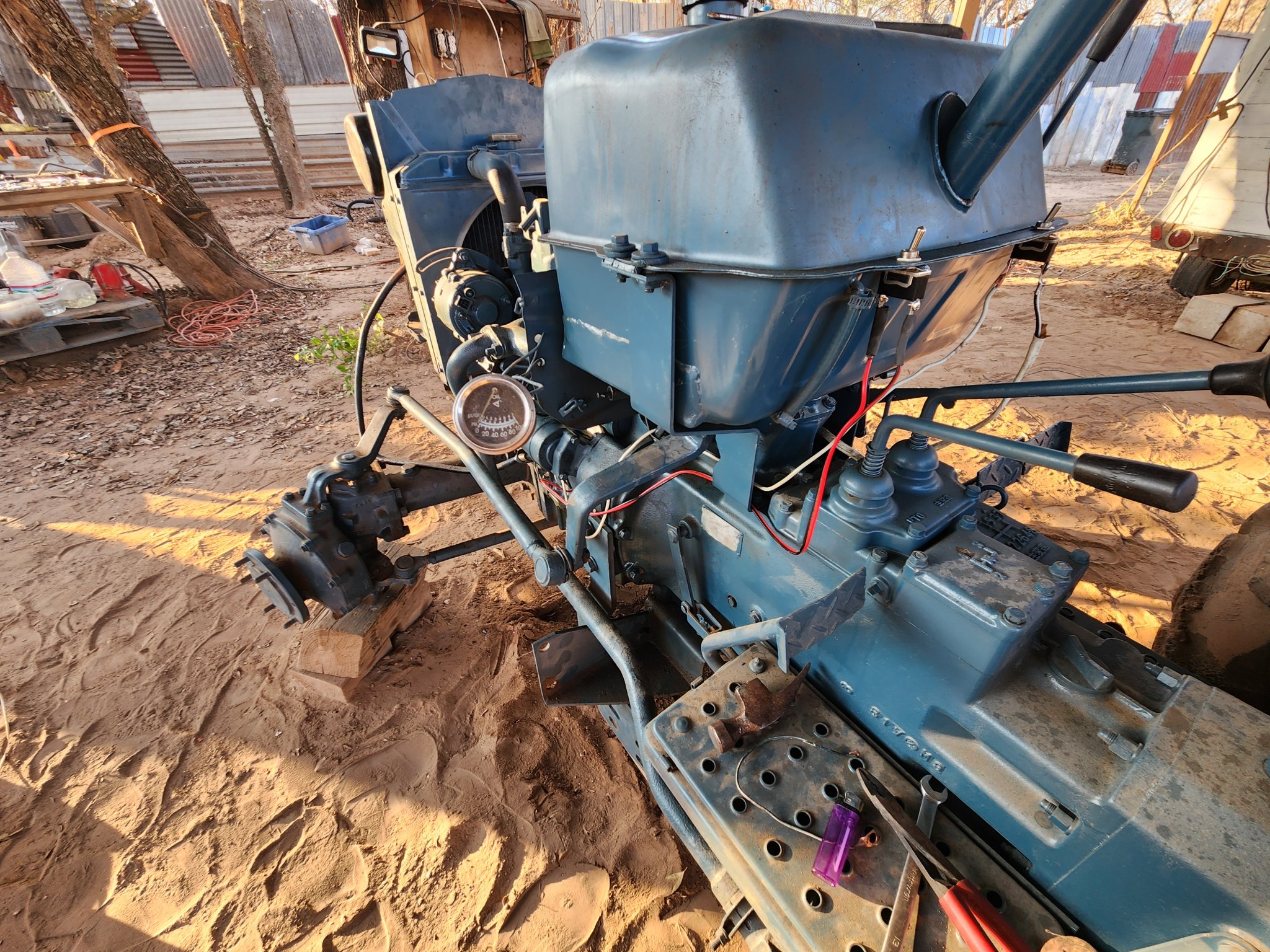

move show forward: put front wheel on, fix seat temporarily, fix steering wheel later but install it, get it moving on its own

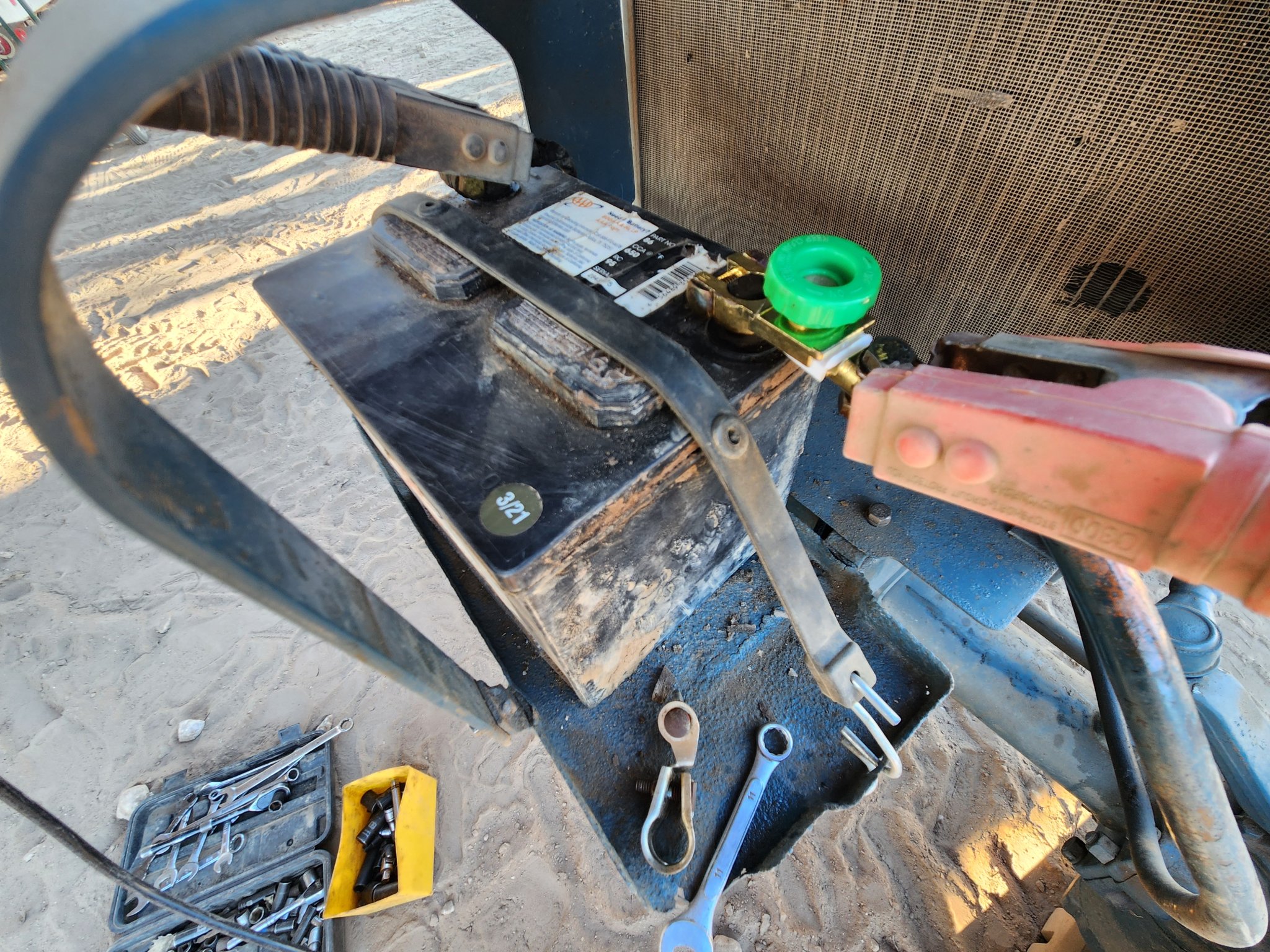

install front axle/propeller, strap down battery,
install propeller front axle
strap down battery, battery showing 13 volt, charging
go get front wheel, install them, temporarily put on steering wheel, put couple bolt on the seat,
also paint is about a day away, its solved
for first time in 5-6 month, she is standing on her own feet, ready to move on its own
only 3 task to operate: put all lugs in rear wheel, install seat and steering wheel
woah, there she is, idling in the sun, healed from her surgery, she got there all by herself
she almost die august 23, 2023, but november 13 2024, she back to life
She had her surgery 10-12 feet away from where the engine exploded, but now she heal

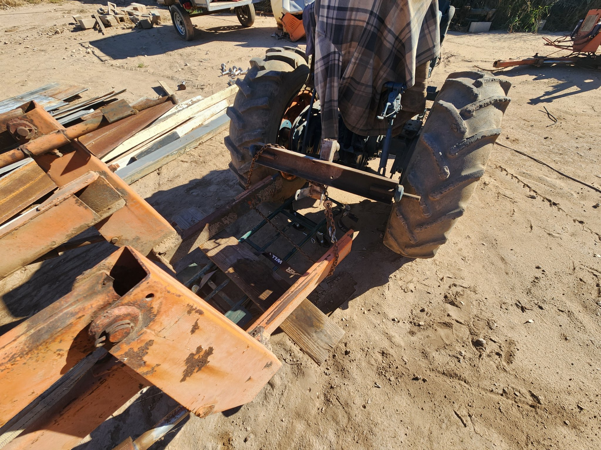

while video upload: clear out the work area, level the ground a bit with bx1500, take L295 that just got revived,
take it to the loader, lift loader, get L295 attach to loader with couple bolt, lift up on front of loader with bx1500 3 point hitch, hold up loader on L295 with lumber, bring entire assembly to shade
video: yes, you witness first ride since august 23, 2023

Just curious, why are the rear tires backwards?

Are your rear wheels on the wrong sides? Not that I am worried you are going to get stuck in the mud! But look at pic of tractors with similar tires, I think they will have the lugs the other way.

And what is the weird whistling noise as you walk behind the tractor?
ok glad you think that sound off, I think also that
it started that sound when intake and exhaust installed, they seem to be sufficating the engine a lot
very unlikely that muffler is clogged, and no sign of being crushed, but
I try to stick long thin metal, and scratch away at whatever is inside of it

battery completely, dead jump tractor with pickup
turns out, you cannot just give power to the alternator signal, it does need to have "ignition on", meaning
it does have a draw that will kill battery when tractor off, simple solution that I will likely do:
once I put components: I might just have to intstall the factory wiring and take out all the extra junk
or
(for now) put a master switch on the battery that I can turn on/off all power to battery, then
I would always have to remember to turn it off when turning off tractor
that would be hillbilly ignition
raise one end loader with L295 3 point hitch, get your dolly underneath
lift other side of loader with 3 point hitch, connect them, drag loader to the shade
hillbilly ignition: install this on the main battery terminal, turn off when machine off, turn on when you run machine
@D2Cat
yes, dinosaur always know something, i listen about the "diode"
could it be that simple, that diode can fix the issue? How could it know when to shut off that connection?
My suspicion: it does need a separate ignition, but nature will reveal the truth, per usual

3 point hitch and dolly to move big loader to shade
lift up on each side of loader with 3 point lift, get block under
install hillbilly ignition while charge dead battery

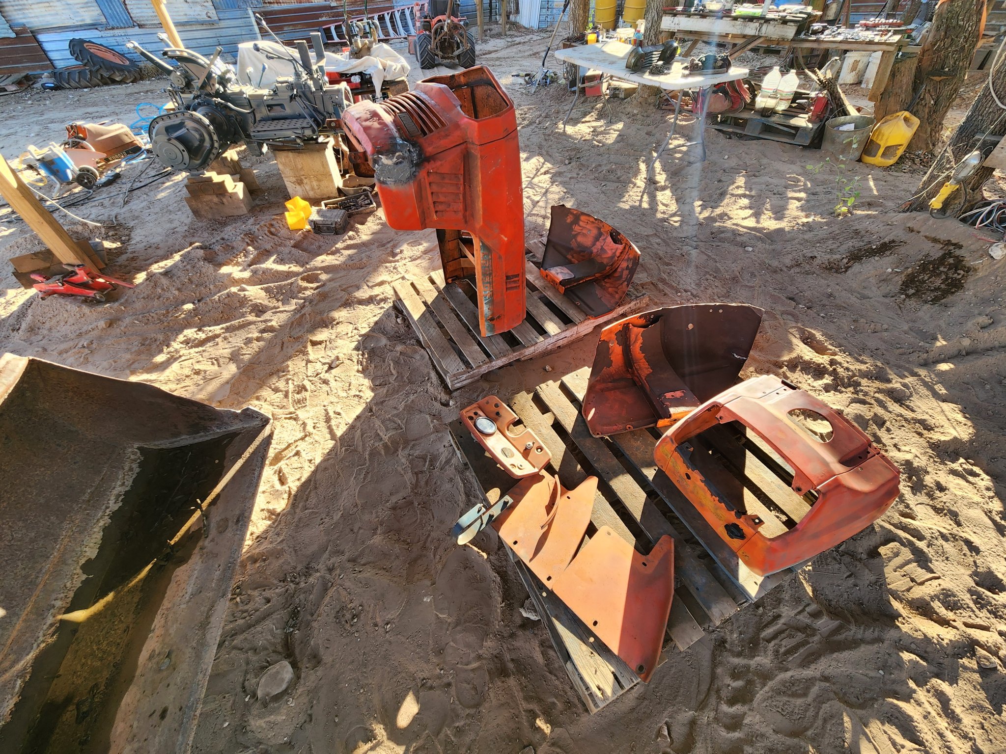

bring pallet close to loader, bring all parts getting orange
paint show up perfect time, you imagine that it will lay perfectly and you wont make mistake and matches properly, and
